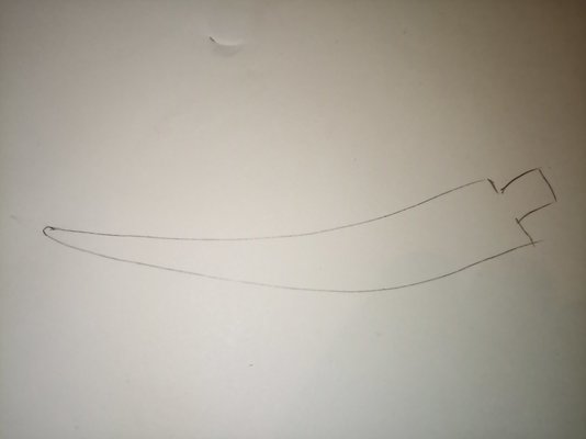

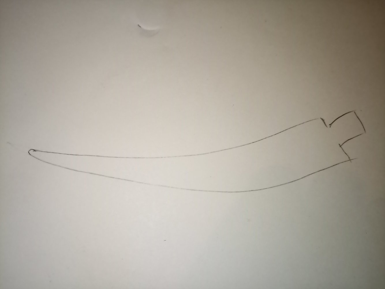

A banana shape type wedge is what you want for removing a gib key. Point at one end, with a widening taper whilst having a curve. Unlike a straight wedge, it'll keep roughly equal pressure on all of the key surface.
got a name for those? sounds useful
if it was suborn I'd tend to use a couple of flat bars with a chisel between
