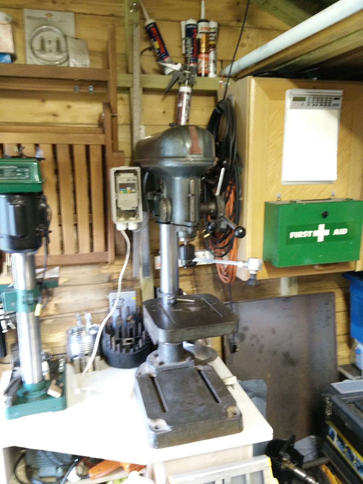

A nice drill from Pressbrake thanks

]I have no idea what it is there is no namesA Meddings?
not quite the same but very very similar, but who knows what was changed and when.Looks very much like the one I bought from Cheb - 3-phase but running through a converter
