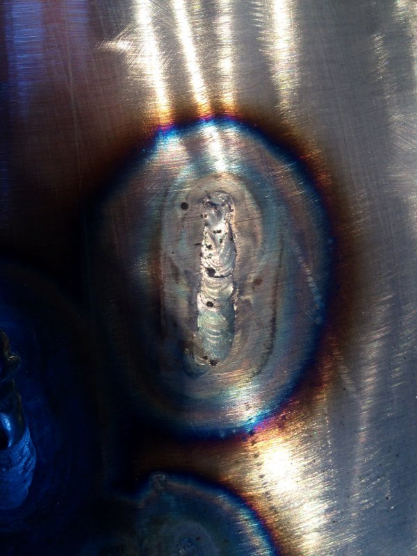

Good call Richard.. But no I wasn't actually welding then I just took a quick snap of it as I was sure someone would ask.. I normally have it set between 5 and 8 lots at the bottle it's set to roughly the same.. And by putting the little bell glass over the torch before I start welding it's normally close, poss 1 ltr down.. I do get through a huge amout of gas though.. But I guessed it was down to me having to re do so many welds..The picture you posted with the regulator and flow meter, does the pea shooter flow meter feed the torch and was it being used when the photo was taken?
The reason I ask is that the flow looks to be about 2 lpm in it and I had trouble with steel once. It would spit when welding due to not enough gas coverage which in turn contaminated the tungsten and made things worse. Tried cleaning etc as you have and nothing worked until I noticed the gas flow was too low and turned it up.
ok will try some when I'm up and about tomorrow.. XNoods I know your fed up mate but there is something clearly wrong with your set up not your welds! Doesn't matter how good you are it's just not goin to happen. Please show us some beads on plate.
Will do give everything a wriggle .. Annoying.. Yet to get a good weld from a brand new welder in a year.. Mind you it's likely to be me I guess .. Lol xAs said, try wiggling the torch / torch cable / gas hose where it enters the torch when laying beads...could just be a bad connection inside the torch or a hose kinking when your doing joints but not beads on flat plate...sometimes its something annoyingly simple, albeit hidden from view...

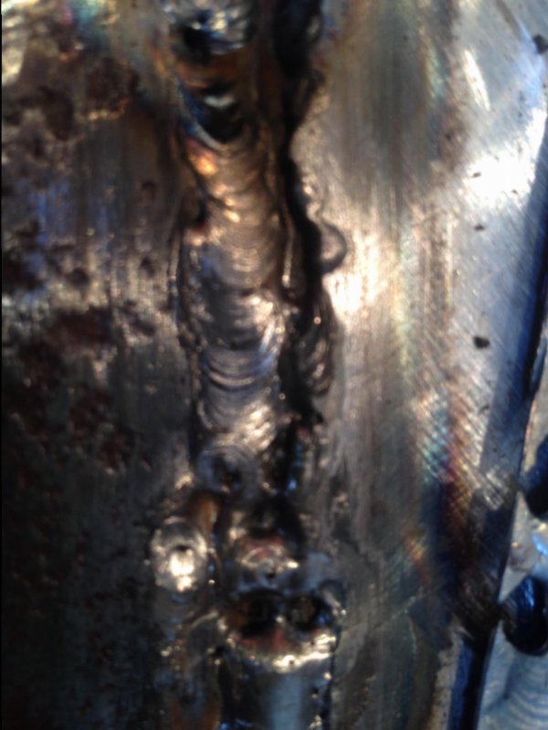

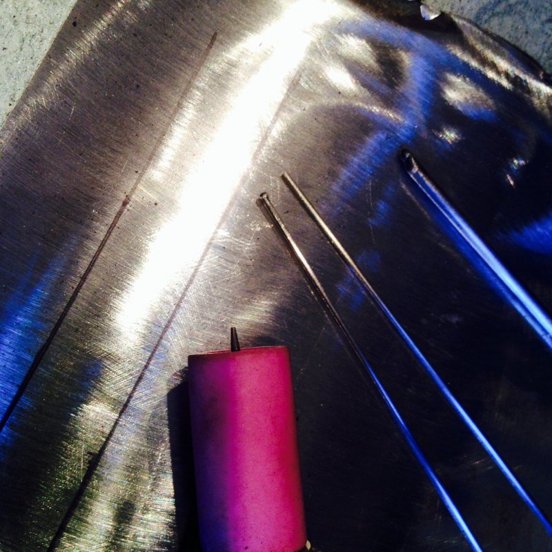

Even by trying a single lap joint it's messy and crap.. Gas from elmdale .. I've used a diamond tip cutting wheel and a bench grinder to sharpen rods.. No changes really what ever I use.. View attachment 64729

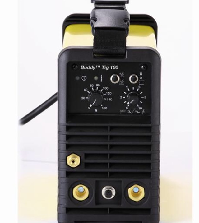

This is my tig.. Earth lead to right lower... tig torch gas connection to centre.. Tig torch conn left lower. And just above that gas in connector ..
