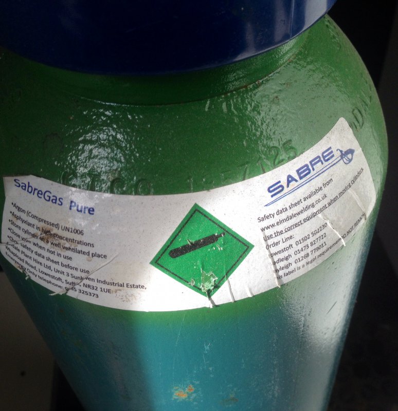

Ha.... Oh great one.. Where have you been?
I hope your well and busy...
Yes mate the hat went to the bin while the esab hung around for more abuse..
As for now? Who knows what's going on.. Not sure if it's me? My set up or crap steel.. Could be all three I guess..
My tungsten tips needed improvement and I remembered as you said about keeping a seperate grind wheel etc just for them.. Use acetone and flap
wheels too..
I've a esab warrier helmet now.. Adj 1-10..
Your wisdom is always appreciated..
