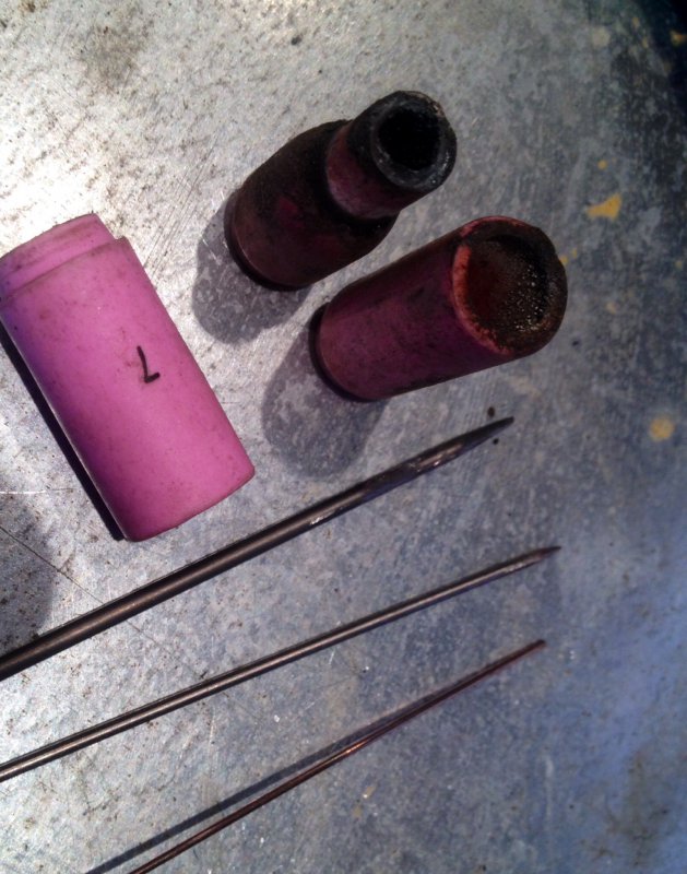

i would knock the acetate on the head if thats the case and your electrode could be sharper
I think he means acetone. The tungstens in the picture look like they have been in contact with the weld pool or filler rod and the "weld" looks like it's been done from too far away.
