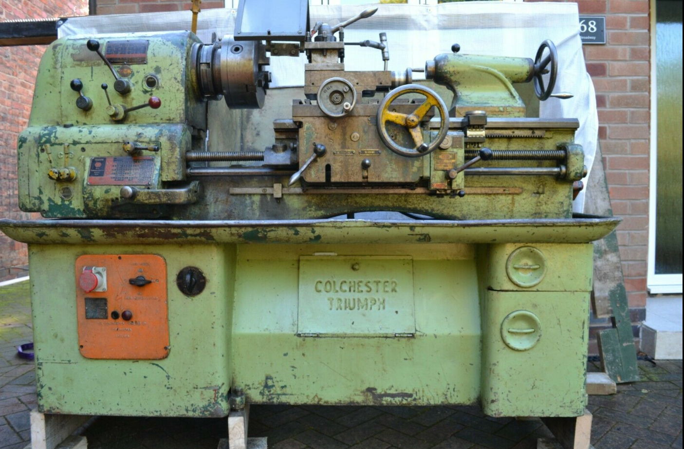

Other than the simple 'string' inverters, which are being phased out now and were never really a thing in UK, they are typically a two stage conversion, DC-DC to ramp up the voltage and then DC-AC which is where the grid synchronisation comes in. it's also the same system used for diesel fuel injectors where a high (~160 - 380VAC) voltage is required to get the fast switching on the Piezo's
ETA - just to muddy things even more, BEV's use bi-directional inverters to control the drive motors and charge the batteries during regen. braking!
other than the solar has a fixed range of parameters to work with (in terms of the output stage) whereas a vfd will need to constantly change these and its the input side which will remain constant (ish)...
you only have two motors on the Triumph, the main drive motor and the suds pump. You could replace the suds pump with a 1ph or drive it with a seperate cheap-as-chips VFD.
