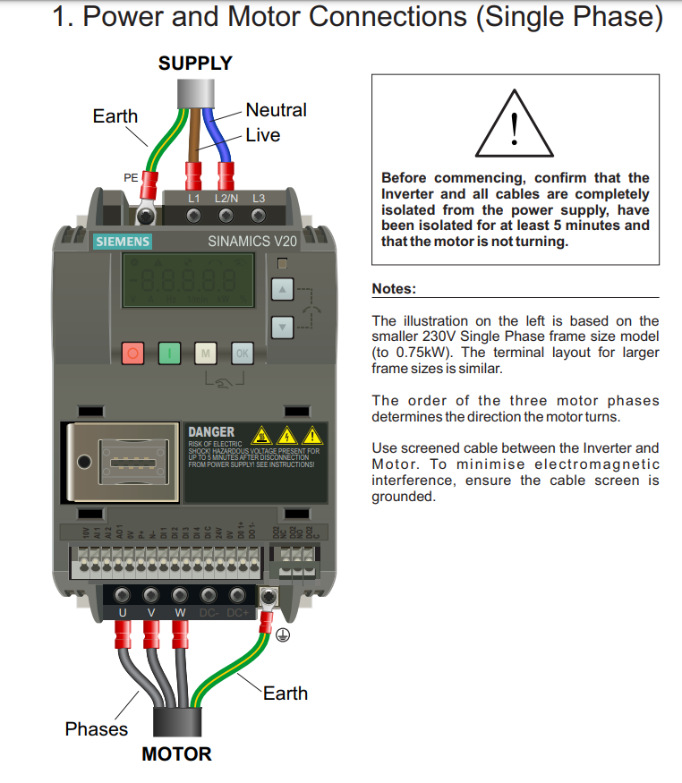

This has piqued my interest, I've just found this for a Siemens V20, which can take either 1ph or 3ph input, the quick-start guide suggests the output voltage is switchable to suit the motor - which would be ideal if you want to have three-phase sockets or equipment hardwired to a three-phase DB without needing frequency variation.
The 1phase or 3 phase input are different inverters (ie when you order it you specify which), the manual is for both. On some you can use a single phase input on a 3 phase inverter but you have to derate the output, but I’m not sure if this is one of them. For sure you absolutely will not get 400v out of a single phase 230v in vfd unless it specifically states that - those that do will have a step up transformer inside and are quite expensive normally.This has piqued my interest, I've just found this for a Siemens V20, which can take either 1ph or 3ph input, the quick-start guide suggests the output voltage is switchable to suit the motor - which would be ideal if you want to have three-phase sockets or equipment hardwired to a three-phase DB without needing frequency variation.
How are you going to get the higher voltage out from 230v in? The transformer is required to boost the incoming voltage to a level where the rectified dc voltage is high enough to give 400v out. The output transistors are most likely all the same rating for 230 or 400v operation (I would think it’s cheaper to use 1 common component, but maybe they do use lower rated for 230v operation, I’m only guessing?), it’s the dc bus voltage that’s the limiting factor.Yep, I appreciate they're different models and it's a composite quick start guide, I'll see if I can find the specific setup for the single phase input one.

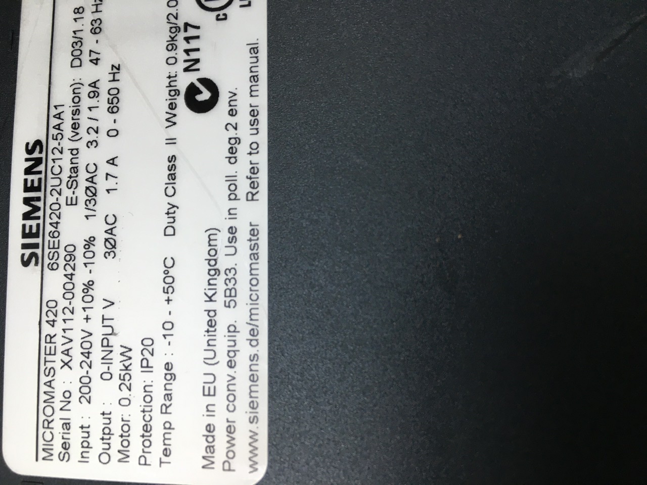

I guess we're looking at the same equation (P=IV) from different sides, there's always conversion losses, even on a rotary generator, I know that, I find it hard to believe that something that to my mind, is relatively simple, and *should* be commonplace, just isn't. Of course, you can have anything you want if you're prepared to pay for it, the parts of the world you'd think would be crying out for cheap versions already have three-phase pretty much everywhere there is electricity anyway.Here are pictures of 2 vfd I have sitting on my desk, a Siemens micromaster and a Mitsubishi. The Siemens can take single or 3 phase 240v the Mitsubishi is single phase only 240v. On both you will notice the v out is only the same as v in.
Yeah It’s not conversion losses though, like you said it’s p=iv.I guess we're looking at the same equation (P=IV) from different sides, there's always conversion losses, even on a rotary generator, I know that, I find it hard to believe that something that to my mind, is relatively simple, and *should* be commonplace, just isn't. Of course, you can have anything you want if you're prepared to pay for it, the parts of the world you'd think would be crying out for cheap versions already have three-phase pretty much everywhere there is electricity anyway.
