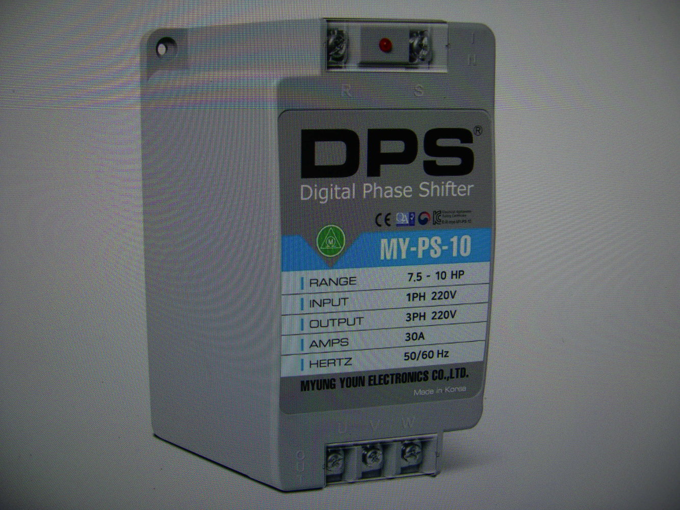

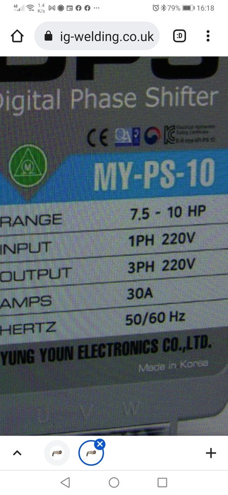

Unfortunatley no one makes 3 phase 380-440v inverters in the same price range as the VFD's despite being simpler.
To keep the lathe as its intended you'll want a 3ph 440v inverter or transwave rather than a VFD.

I see , looks like Ronan has it powered Via VFD so that route may work well actually and easier cheaper than transwave or inverter

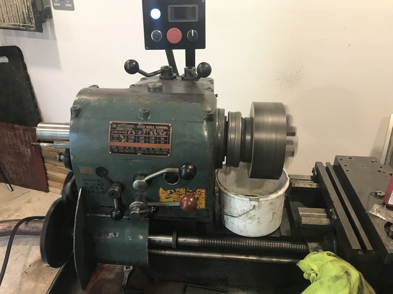

Fantastic stuff , my lathe has the two speed motor which may complicate things slightly but seems a good chance it'll work and I would't need the two speeds could just use the VFD for that anyway, is that a 3 phase 240 volt VFD running yours or is it the 440 volt one. If you not mind getting a pic of it whenever that would be great aswell.I have a vfd on my lathe which is the same as yours. I used the original start stop buttons on the front as inputs to the vfd to start and stop the motor. The only other thing is the suds pump, which i wired up to single phase by putting a capacitor across two of the legs of the pump motor, works fine off a three pin plug.
Looks neat and I'll definitely have a read of the thread to get some ideas to steal for mine , is that a RPM readout taken from the headstock or just calculated with gearingAs mentioned above. I did a thread recently on my student. I managed to re purpose all controls to function my lathe in the same way it would normally. The switches just become signal switches rather than being power switches.
I also added some extras with a potentiometer and a jog function etc. all inexpensive. Just a little bit time consuming if you attempt to make it look factory like I did.
