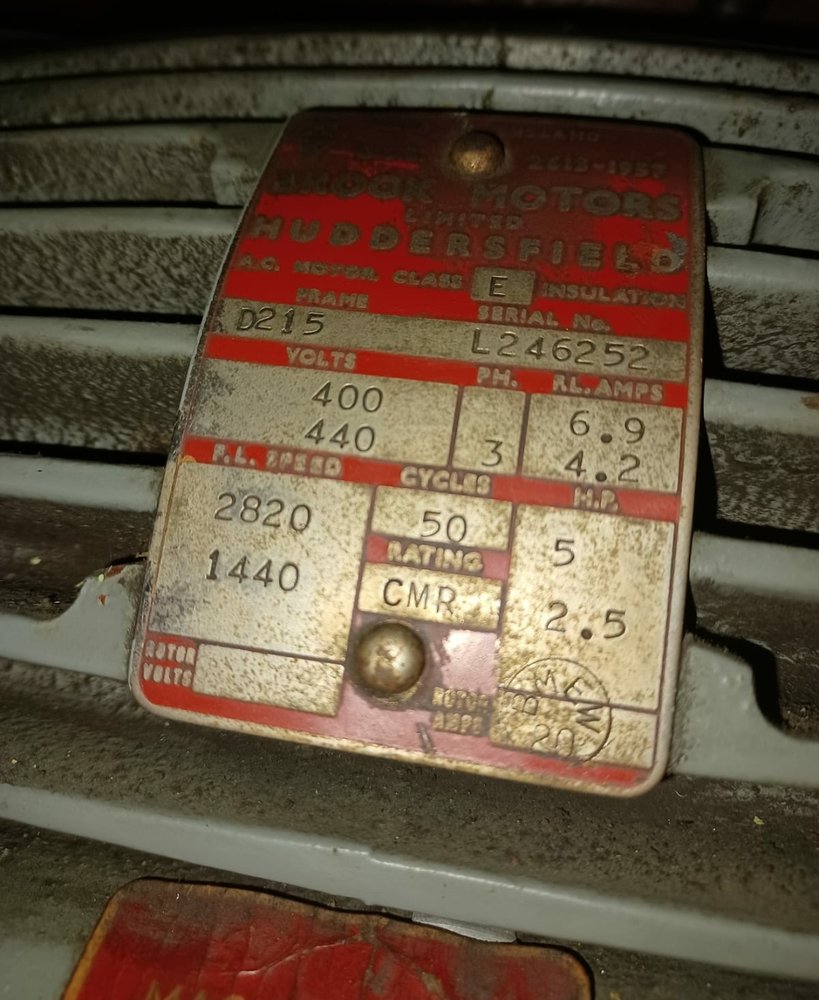

motor definitely has two speeds, but doesn't necessarily mean you have to use both. It might be possible to rewire only for the higher speed and control to suit via vfd frequency?
don't know, just thinking out loud.
My thinking was that you would get a bigger choice of cheaper vfd to run a dual voltage motor rather than having to use a step up vfd to get 400v out. Probably go some way to offsetting the cost of a motor, plus you’d get a new inverter rated motor as well.Replacing the motor with a 230v one wouldn't really be of much benefit as you would still just have a single speed motor, exactly the same as you would if you chose one of the speeds from the current motor.

The lower speed on your motor is half the power and half the speed. You will loose nothing by connecting it up for the higher speed and using the vfd to adjust speeds.
Often the lower speed is done to get a higher torque and similar overall power, but not the case with yours.

Do you really need the low speed?That's what I was hoping use the VFD function for dual speeds
Think it depends on the windings so will open the box and have a look when I'm home
Typical electric motors theoretically are constant torque, so you don't lose torque as speed drops, you lose power as the motor isn't spinning as fast (power = torque * speed).that was what I was thinking, ok you'll lose torque as the frequency / speed drops, but seeing as you only need half the the power/speed anyway, it would probably still be sufficient. Worth a try anyway.
