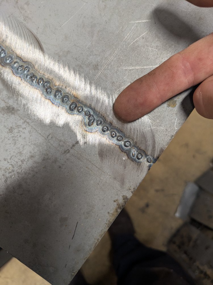

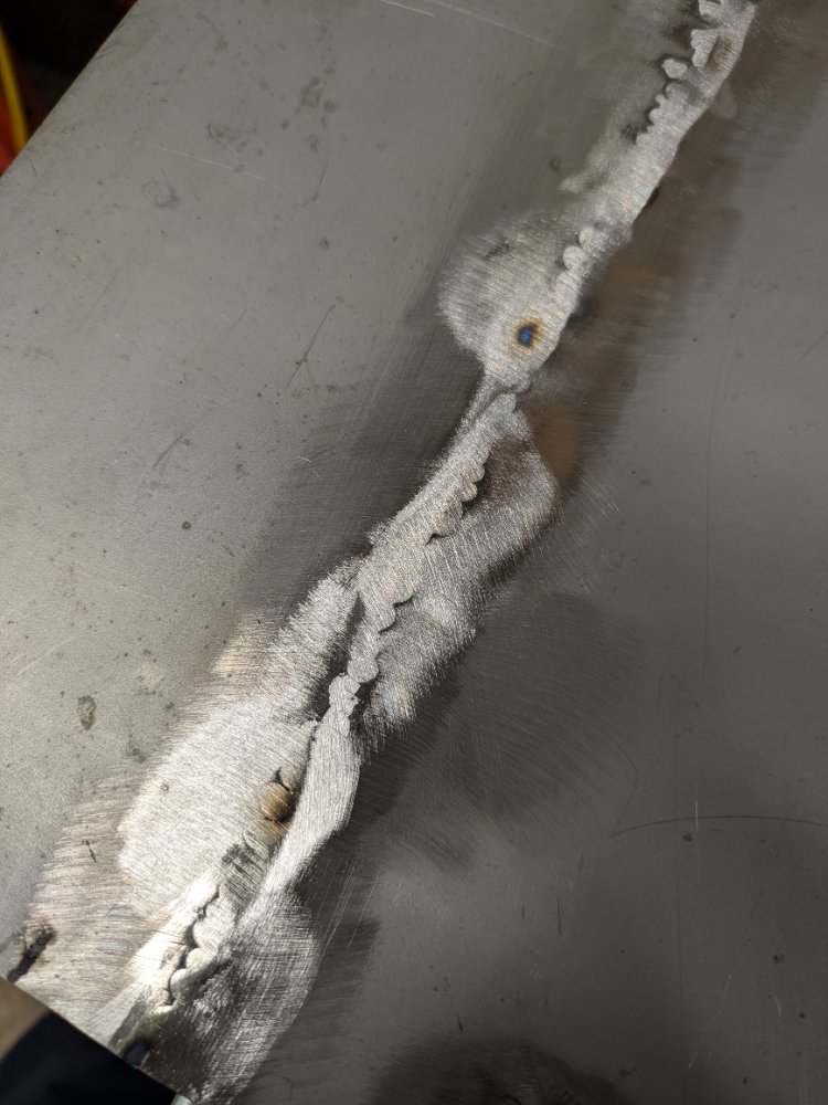

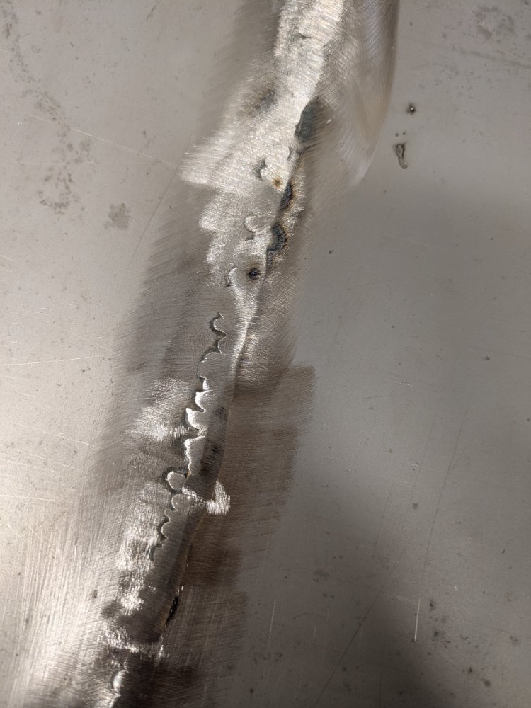

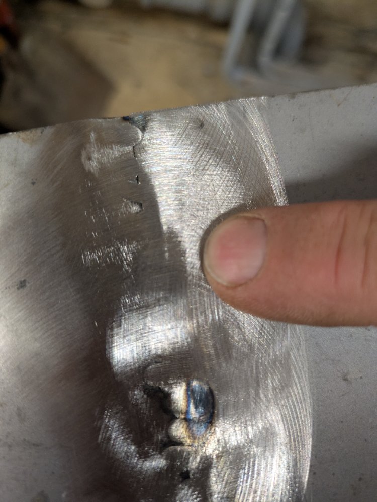

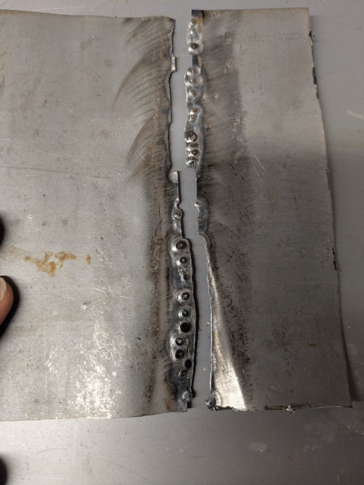

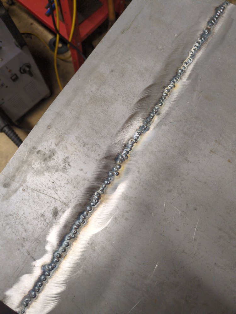

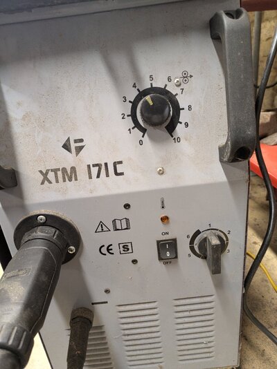

that break has happened around the welds, not through the welds which is a good sign. those welds are 'strogner' than the parent material so from a structural point of view, they are fine.So bending didn't break it. I hammered it flat again and then hammered the line of the weld over a piece of H beam (anvil) to bend it and it came apart like this. 3 little sections where I hadn't put any weld down but other than that it's come apart on the outside of the lone of weld. Is that a good thing?
