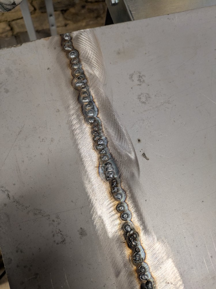

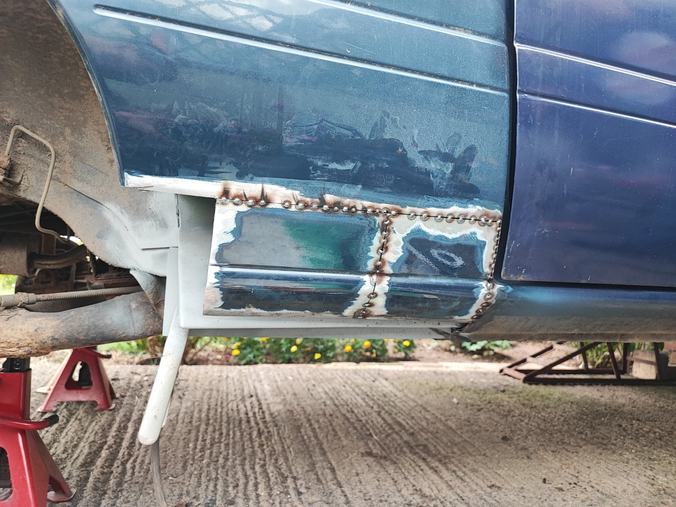

Had to look up peening?!Why are you waiting for the heat to cool down ?
Try quickly peening the weld as soon as you finish it.
I was waiting for it to cool down so I didn't blow holes or distort the metal more. I suppose hammering (peening) the weld while it's hot will make it easier to get it back in shape? Cheers
