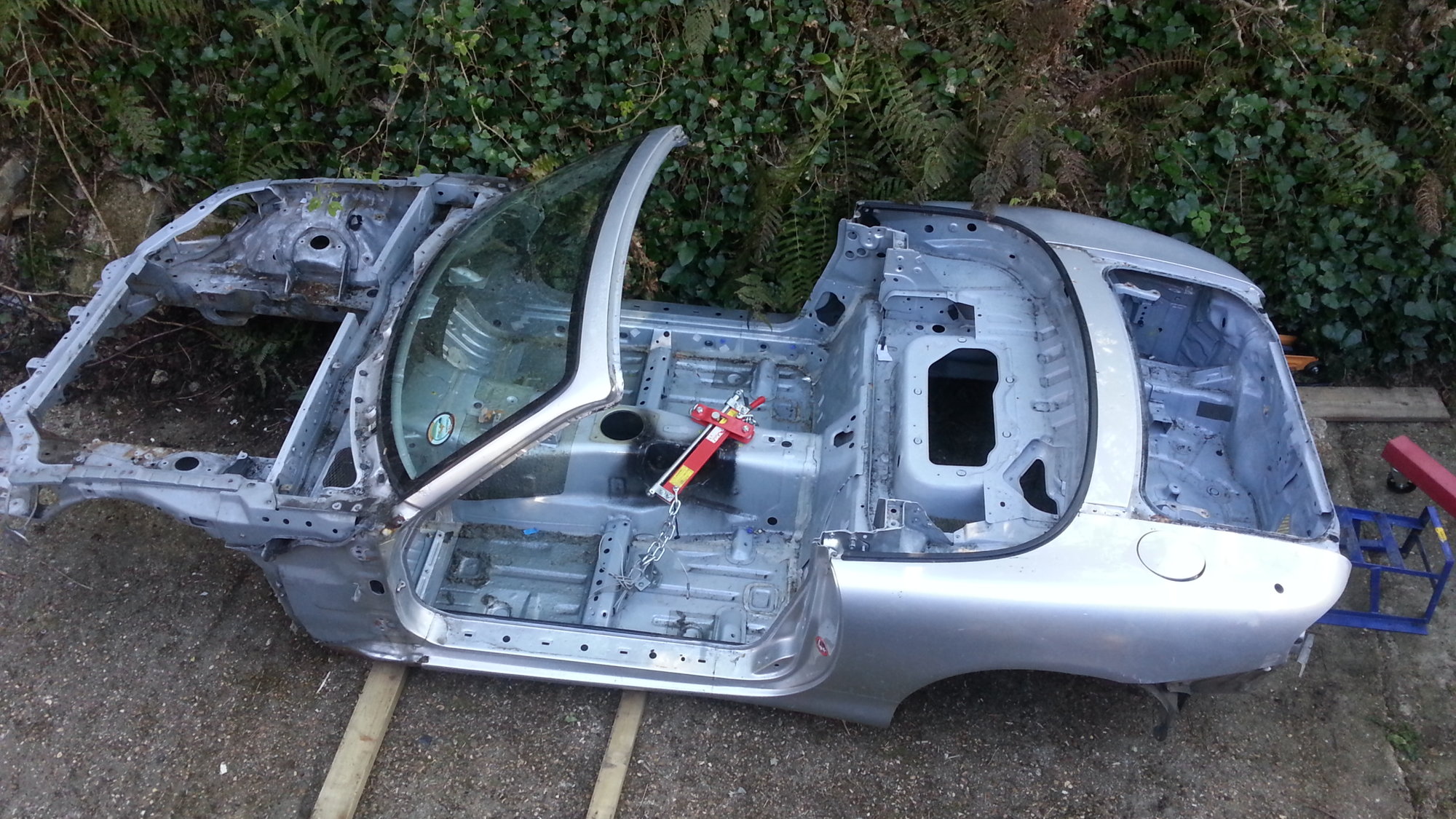

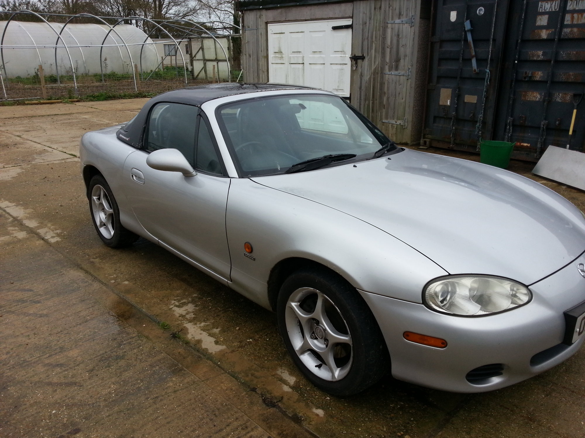

  19. Wightsparks
    Wightsparks Forum Supporter
    Messages:
    1,310
    Location:
    Wight
    Mine was 2002 "Arizona" version - came with leather seats and an LSD that did indeed make good money. Also it was silver, so again popular. It was immaculate despite a fair chunk of mileage. I sold the seats, hard top and front bumper+lights within a few days - they alone paid for the car. Someone even paid £15 for the user manual!
    Not much left !
    One on ebay at the moment - £900 with a hard top and leather...
