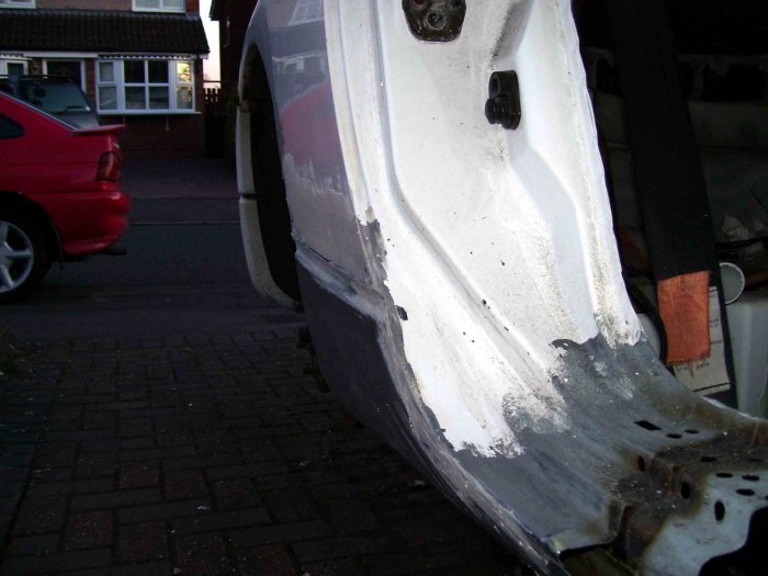

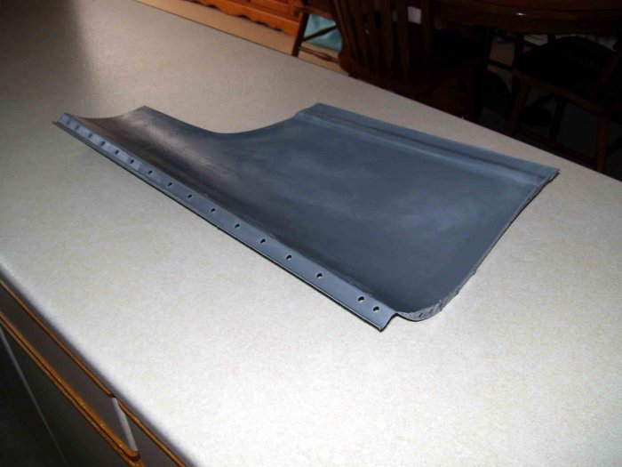

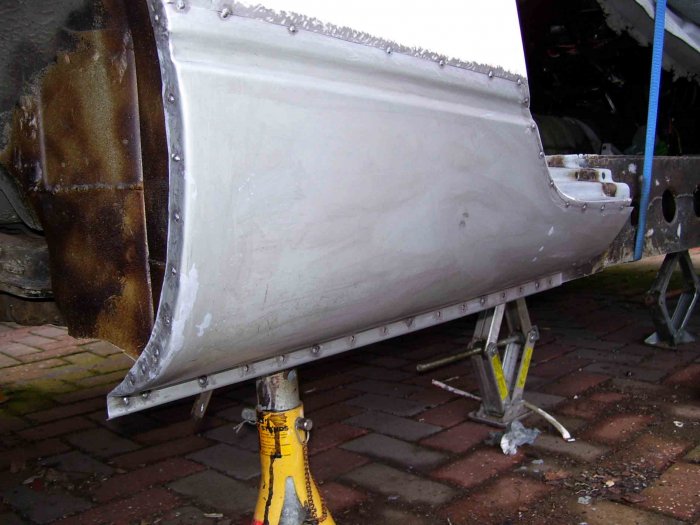

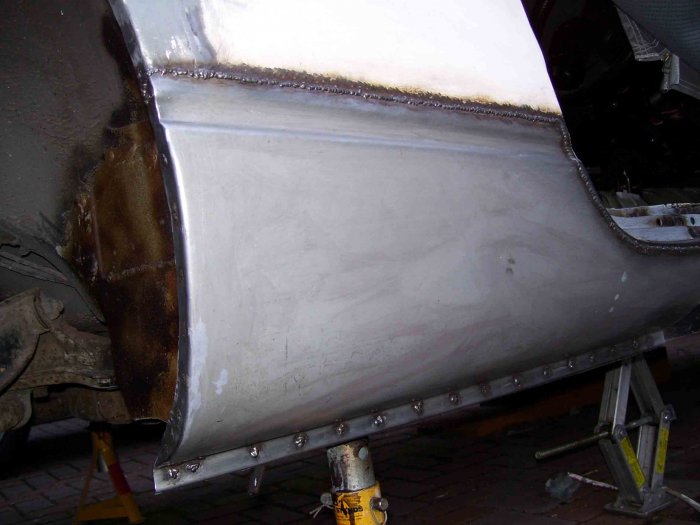

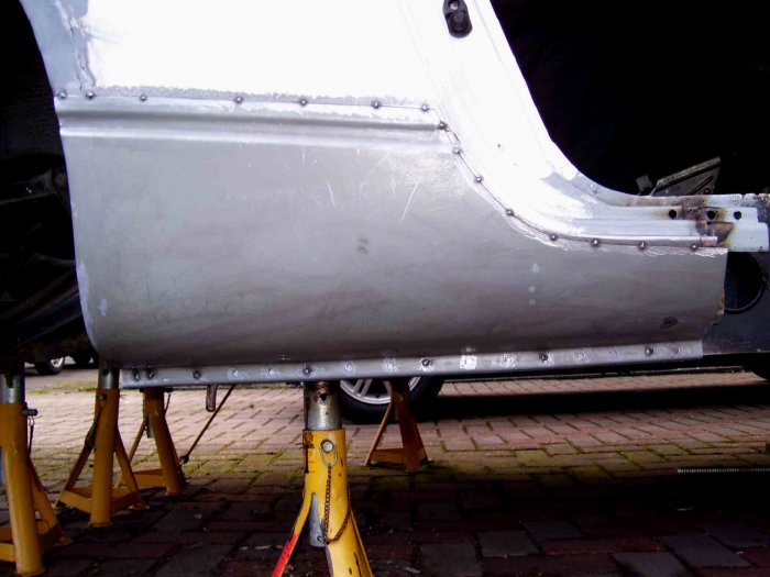

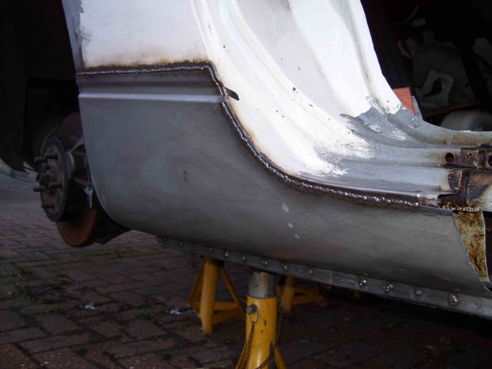

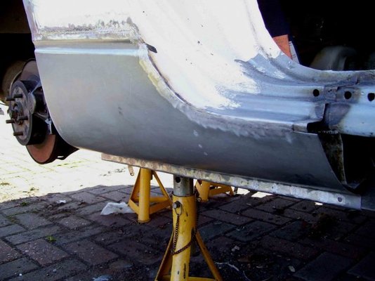

Prepped all the internal areas with bilt hamber wax, (except the welded edges in case of fire)

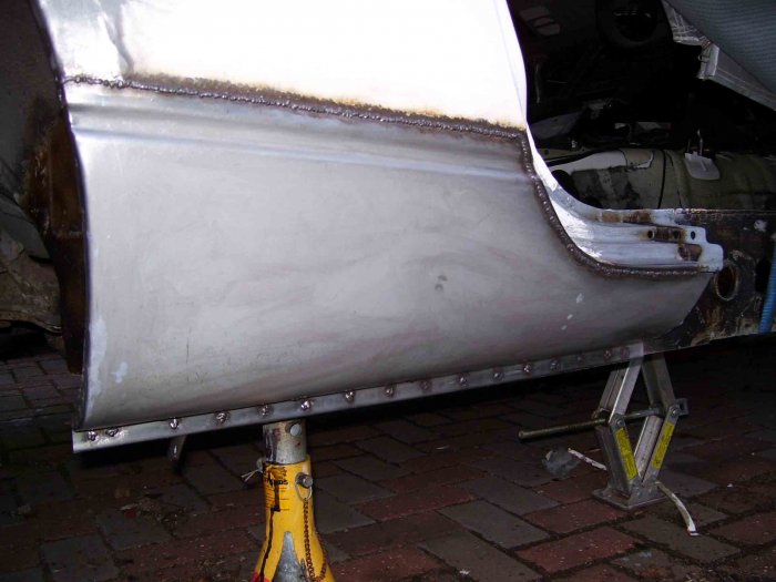

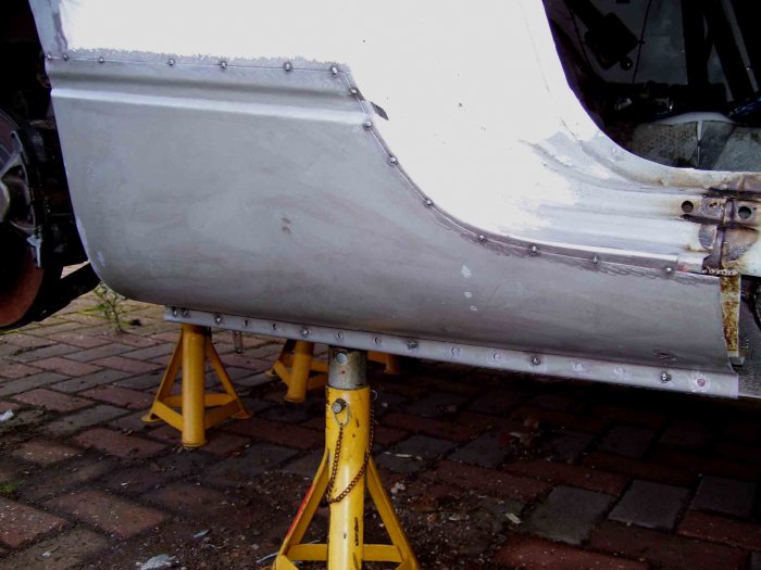

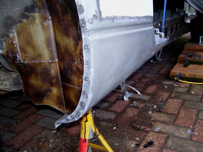

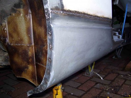

Primed the inside of panel with acid etch primer followed with 90% zinc primer and ground up all edges and plug weld areas (panel and mating faces.) No going back now so I spot welded panel into place.

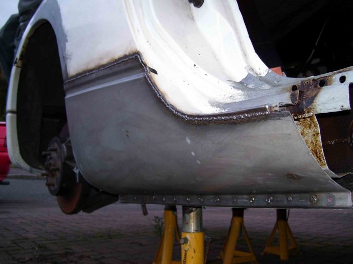

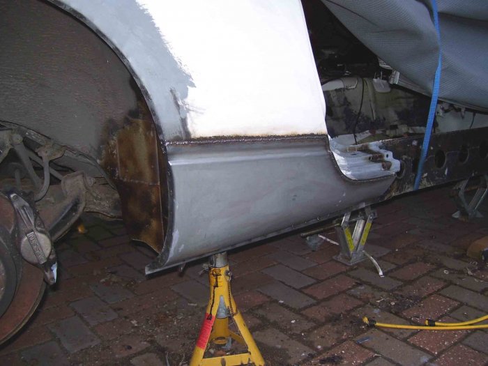

Next is the worrying part, I thought I might alternately add one single stitch at a time rather than a run of single stitches in one go so as to combat the dreaded heat and distortion. What do you guy's think? Hoping to finish off tomorrow.

I take your point about the ease and safety with regards to overlap joint but I am worried that no matter how good my handy work might be, there is a chance of water getting in the seam. Due to my handwork not the technique I hasten to add.

I see what you mean about looking from the inside, I took the seatbelt unit off and I can access the inner arch.
I shall, as you say, wax from there as well. By the way, as you said, with but welding there is likely to be a little distortion. But what amazed me most was, so long as I followed your advice and was patient and letting everything cool down in between runs, most of the distortion came good.

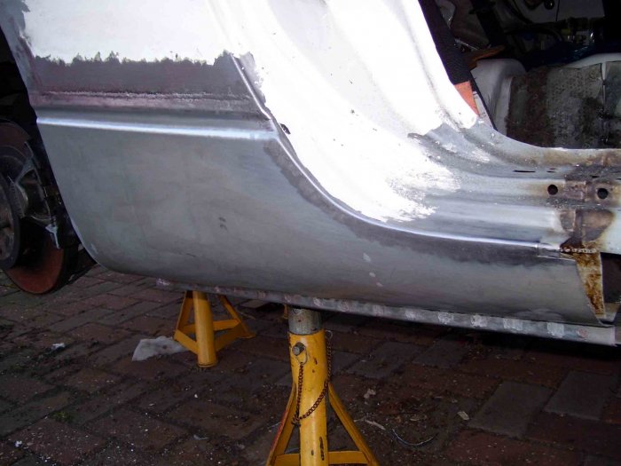

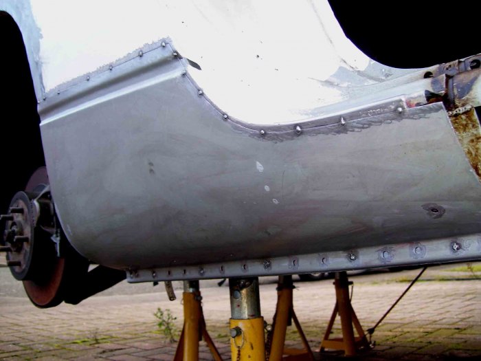

Agree, looks great! Just one observation though. The inner wheelarch area just behind the sill. It looks like waxoyl over paint over the welded repairs. these areas are high impact, stones, mud, driving rain, snow, road salt grit etc and I would use anti stonechip coating in these areas, then paint, then waxoyl.
I have just relied on waxoyl over paint in the past and found high impact areas need more protection.
By the way chickenjohn, I have only wax-oyled temporarily so as to stop any moisture getting in. I plan to seam seal and Schultz gun stone chip later so as to allow me to concentrate on the metalwork, I do appreciate you pointing it out though. I have not done much homework regarding which type/brand of stone chip to go for so any tips would be most welcome.

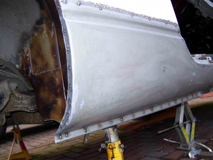

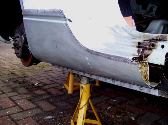

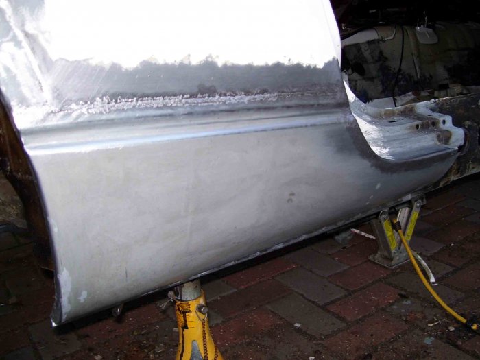

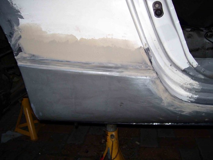

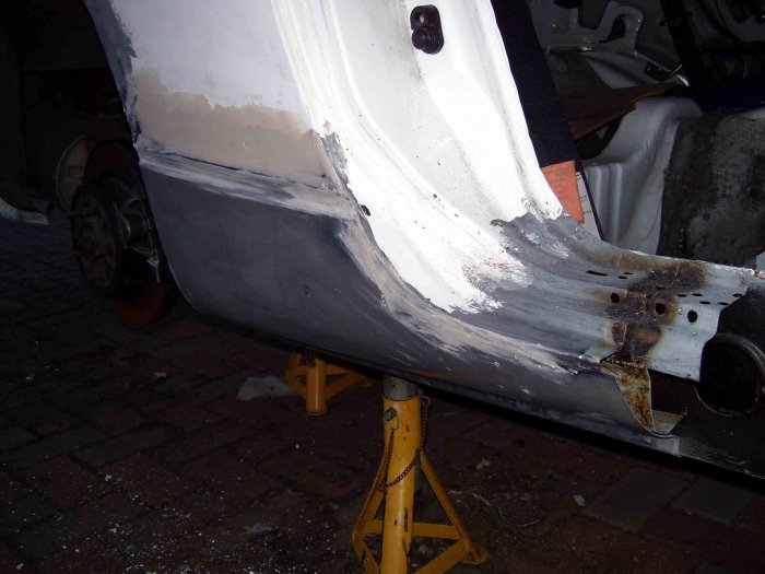

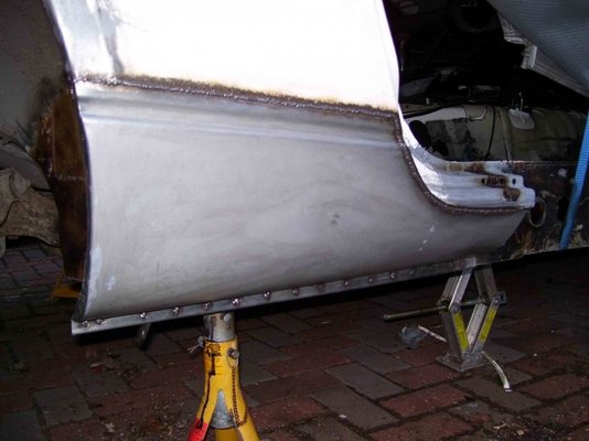

but I just needed to satisfy myself that what I had done so far would be OK after filler. So I ground back the welds so as to be flush, or just below the final contour and skimmed with filler.
Time run out as to regards sanding though, which is not a bad thing as I am not sure how to smooth the surface and keep the profile, Any suggestions would be most welcome.
Hope to tack in position the front outer sill next week. Mind you, it is Mothers Day so I might have to for go it.

If, as I am sure I will, have to make multiple passes of filler, will I need to rough up the surface or can I just fill over smooth? I notice that you sand dry, Is that a preference or is it not advisable to sand wet so as to not encourage the dreaded rust? Again Many Thanks!! By the way, Links are great.
Appreciate your advice and will put it into practise this week end Hopefully. Mothers day permitting.
Still not sure how to maintain the vertical profile though,
( quite a subtle curve ) I can see how to keep the horizontal lines by way of a straight edge etc' I supose it may just come down to hand and eye with plenty of practice. Still, if it does not come right first time at least I can add more filler untill happy.
