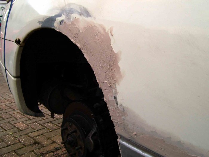

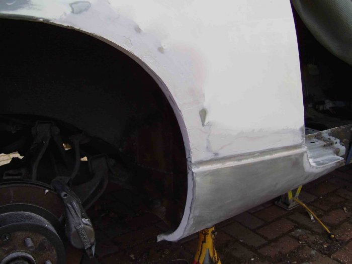

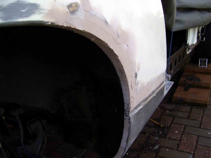

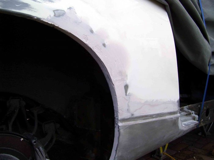

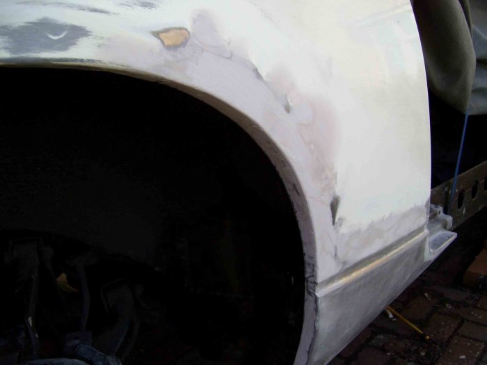

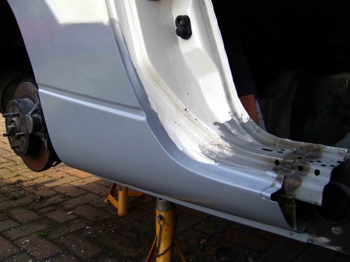

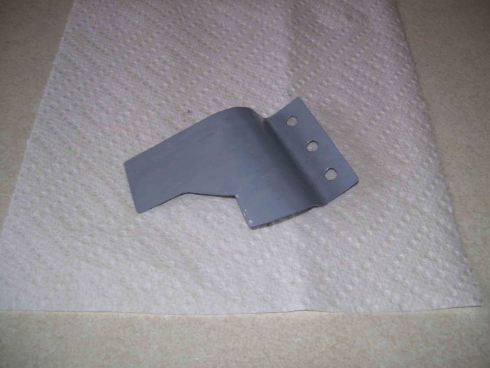

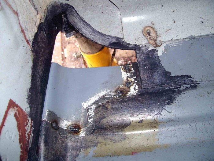

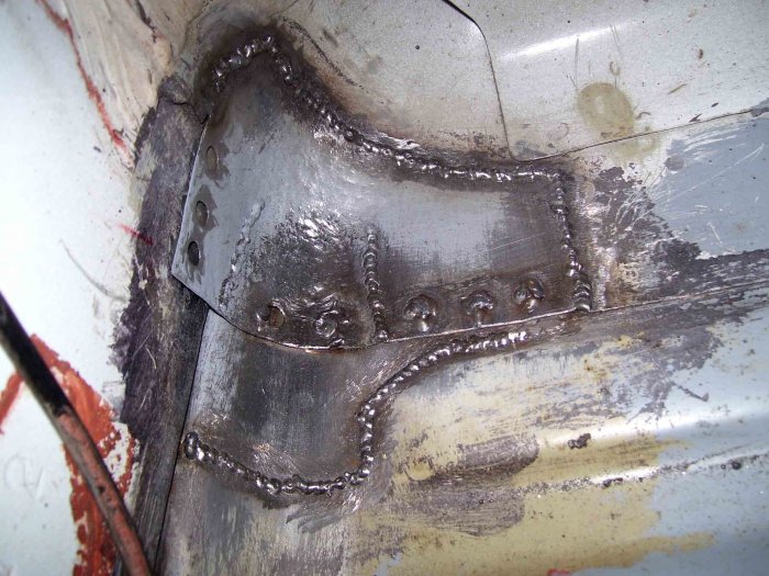

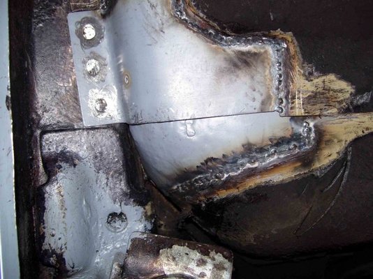

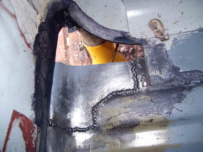

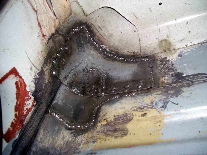

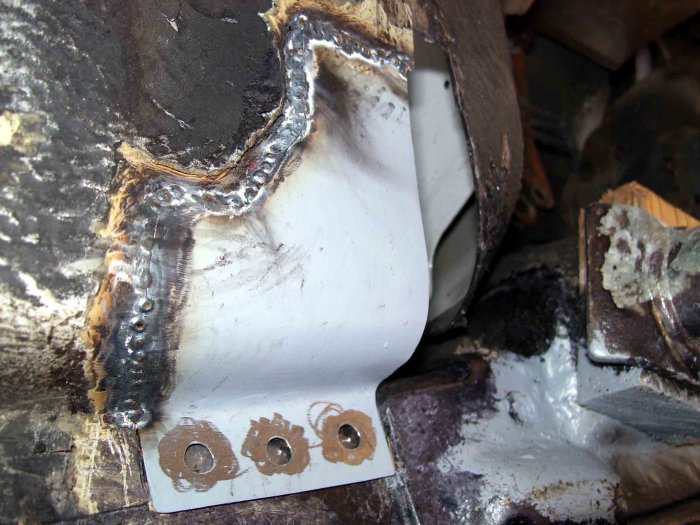

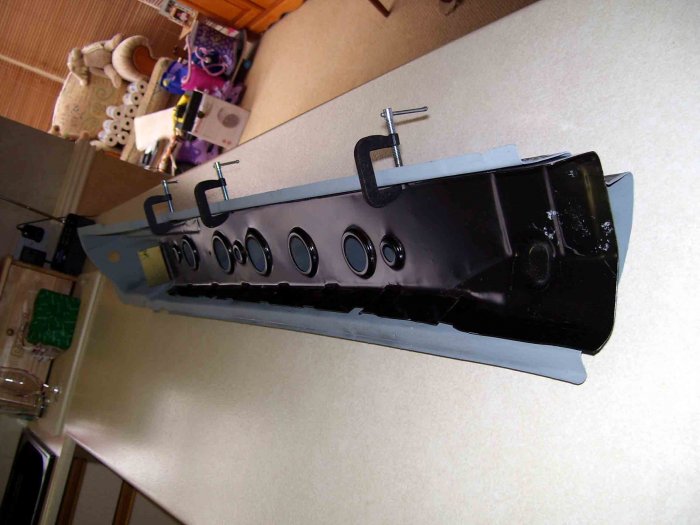

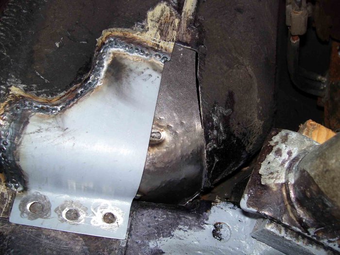

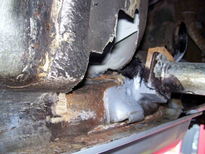

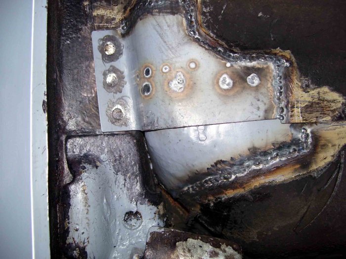

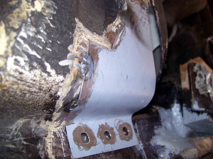

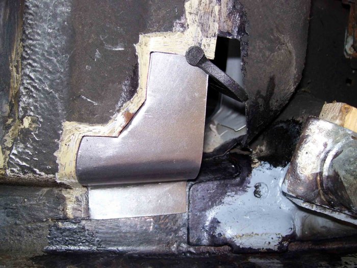

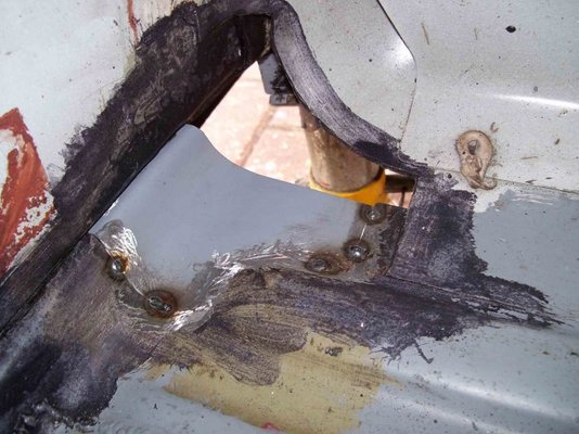

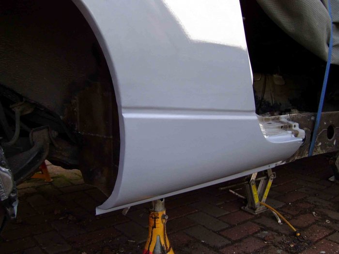

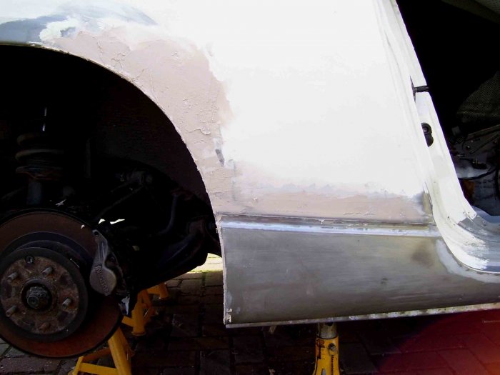

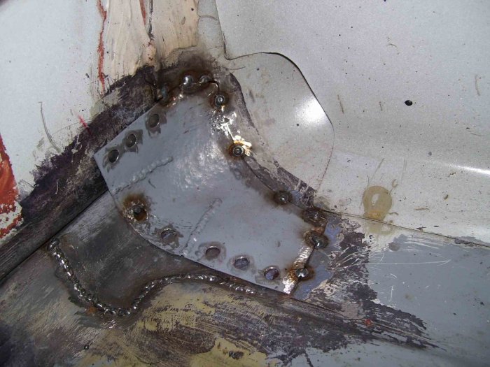

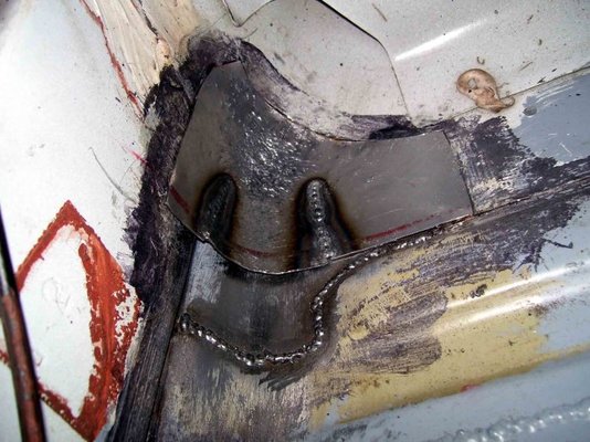

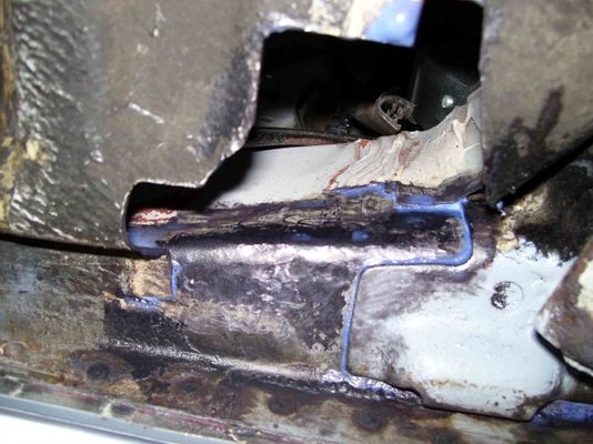

Well Guy's.

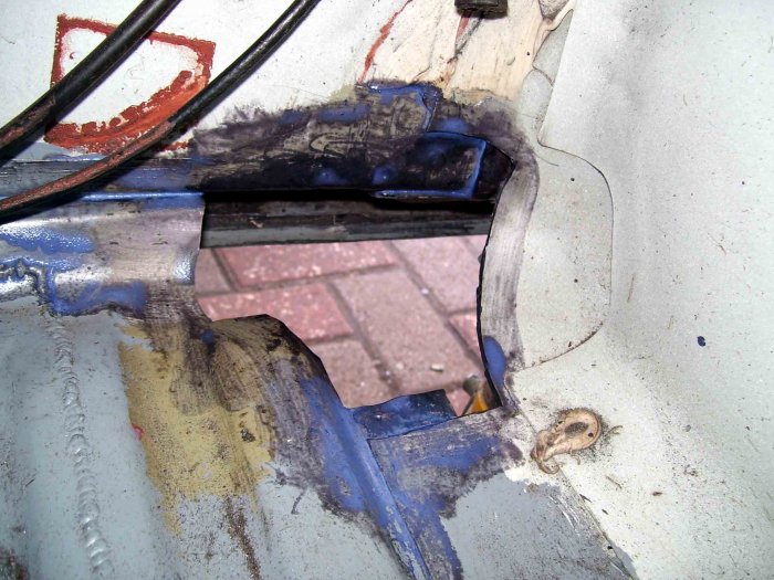

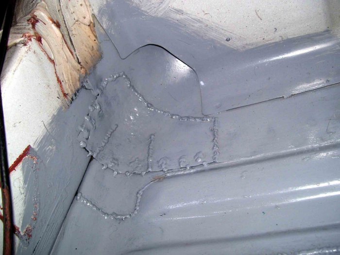

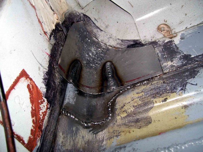

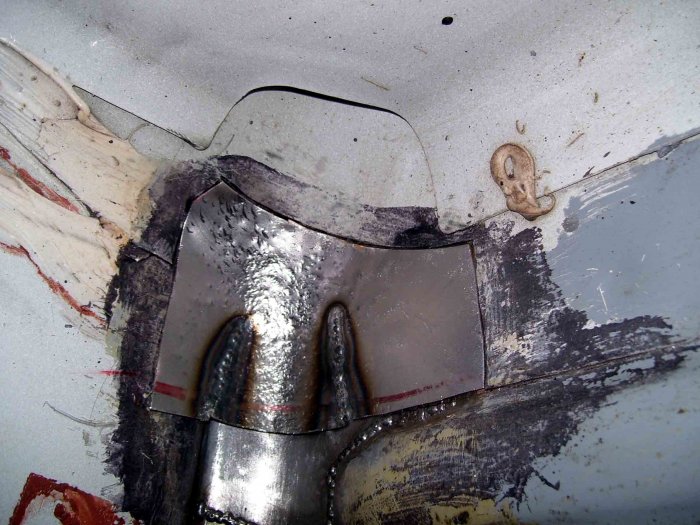

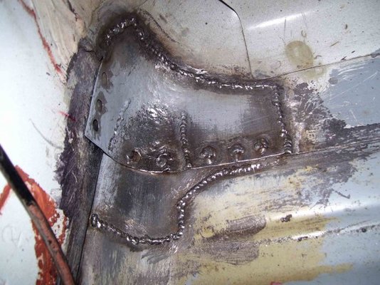

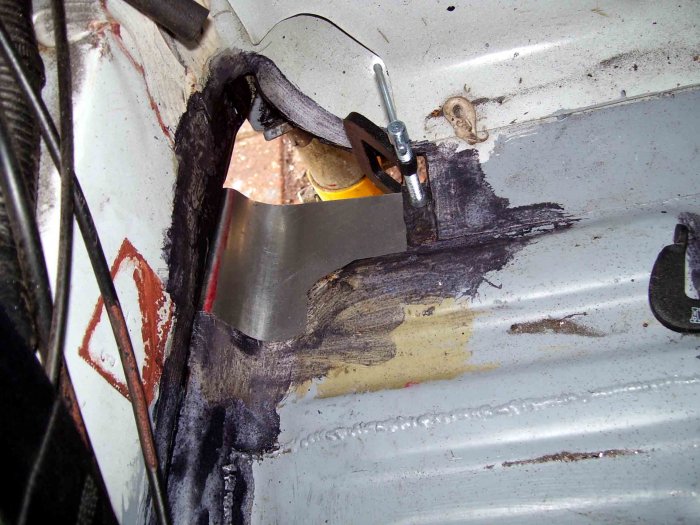

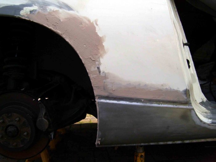

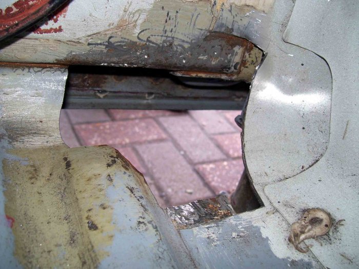

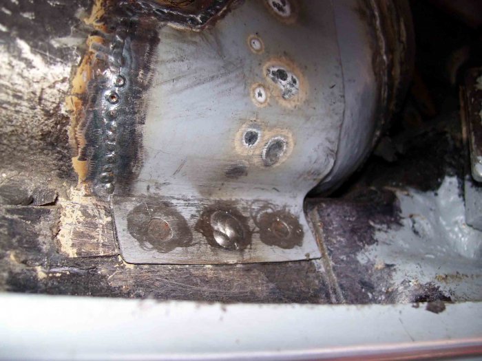

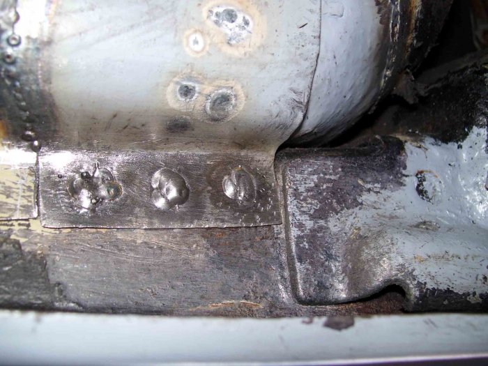

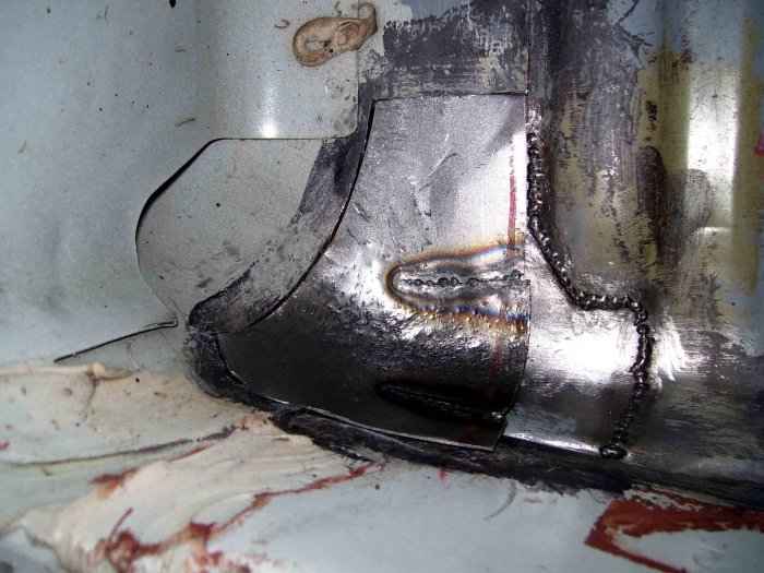

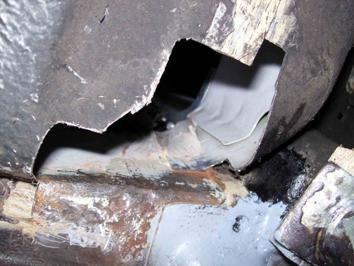

Took on board all your comments and advice,(Big thanks by the way.
) and managed to achieve some reasonable results. It took me several attempts mind,
but I hope you will agree that it's not to shabby. I know I've said it before, but sincere thanks to everyone involved with this forum.
By the way, Sorry if I got a bit carried away with the photo's

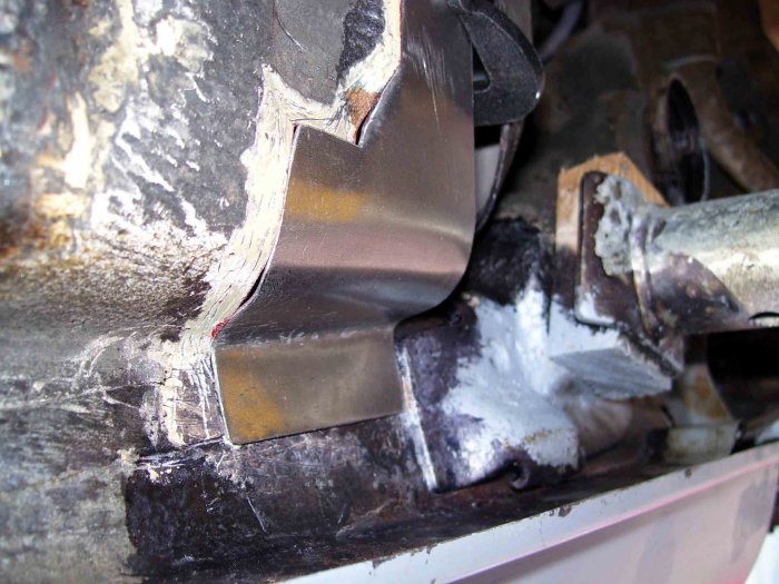

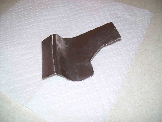

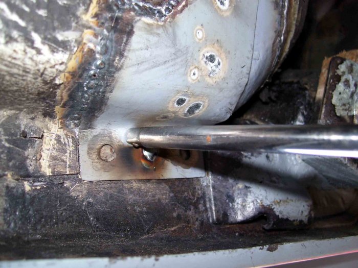

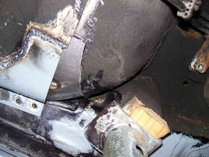

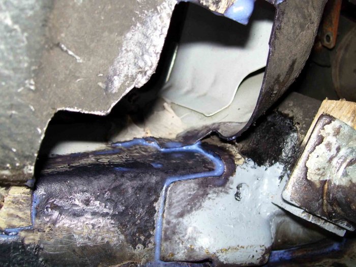

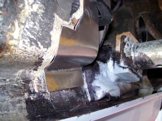

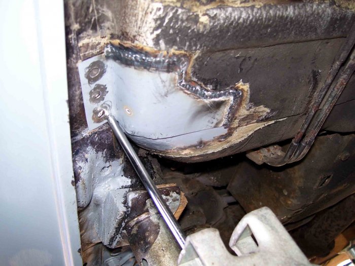

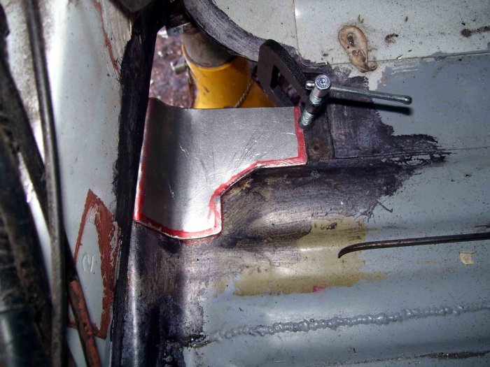

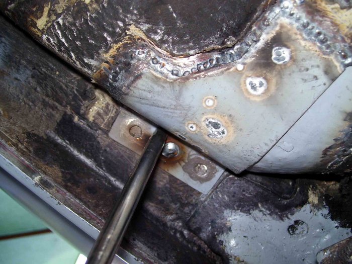

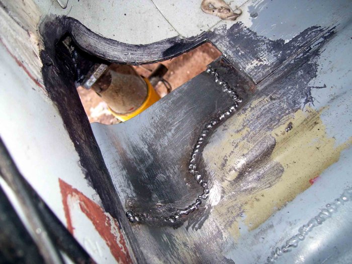

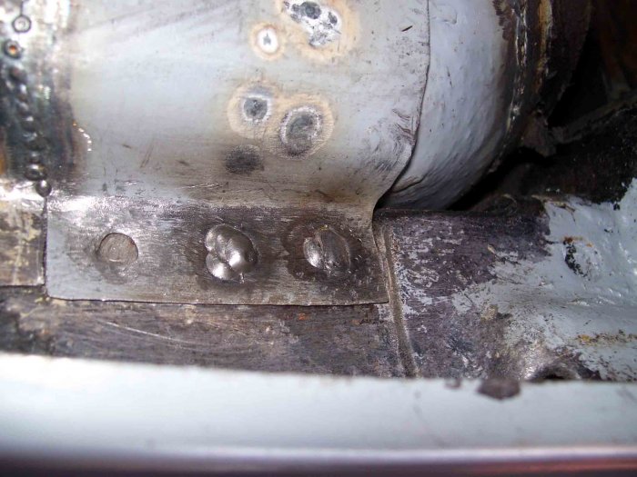

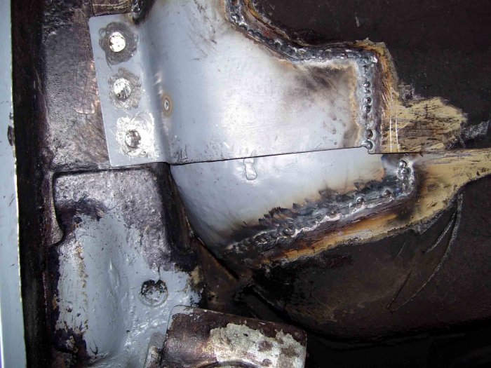

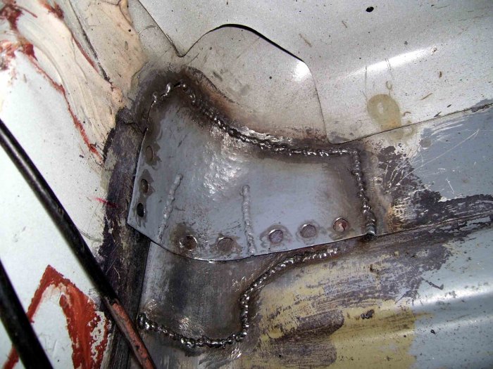

Mainly cutting out some tin worm from rear floor section. Worse than I thought.
Still, cut back into good steel and treated affected areas with bilt-hamber.
Who ever said welding was 90% preparation and 10% welding was not far wrong! Just a thought for anyone doing the same, I was lucky I decided to finish this repair before fitting the front sill, I have treated the inner rear section with waxoyl and will be able to spot any flames should they occur.
