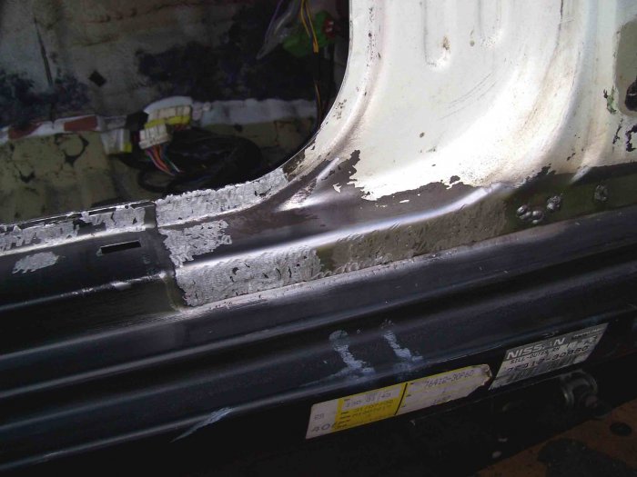

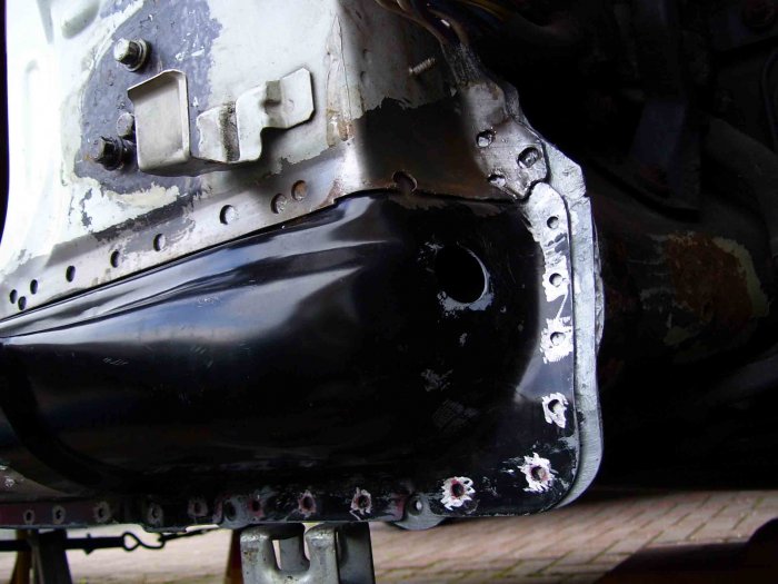

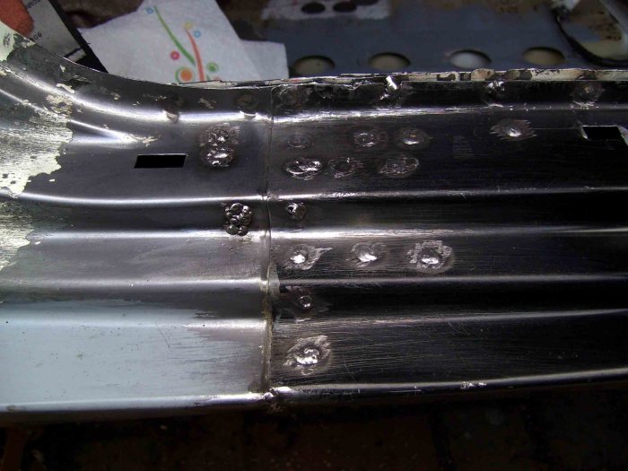

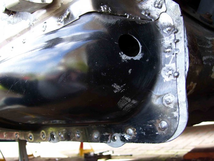

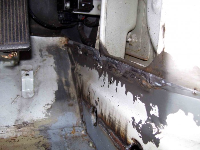

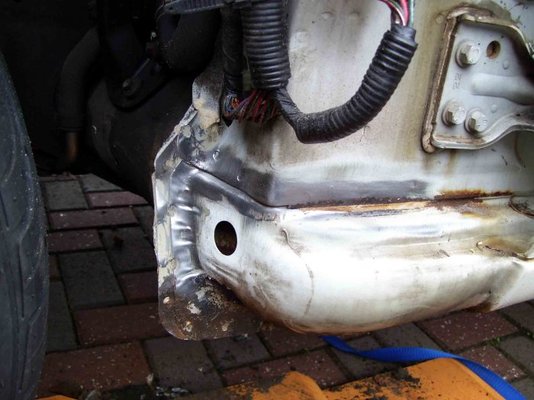

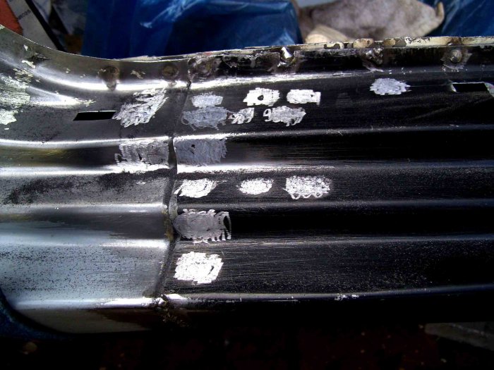

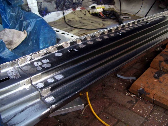

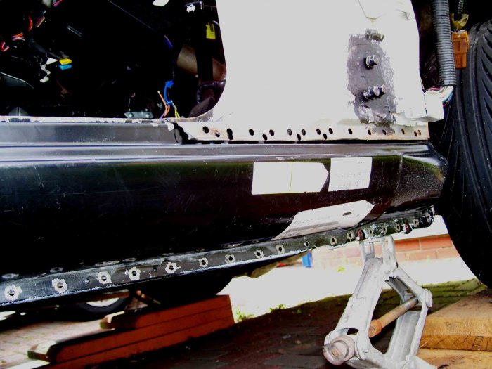

I managed to get the plug welding finished off today without starting a fire,
the first 2 went OK but the third was a little poor. the sound of the weld just went from sizzle to a buzzzzz and formed a large blob.
Any thoughts anyone? By the way chickenjohn thanks for the tip regarding the jack idea, worked a treat.
I agree with being comfortable and relaxed when welding upside down. I was cramped and uncomfortable and should have made more of an effort in positioning myself,
Another lesson learnt.
I should have as you say, taken the time to re-position the jack as I went from plug weld to plug weld. I will have remember to take more time in preparation as I only get one first chance at the weld itself.
Just impatience i think.

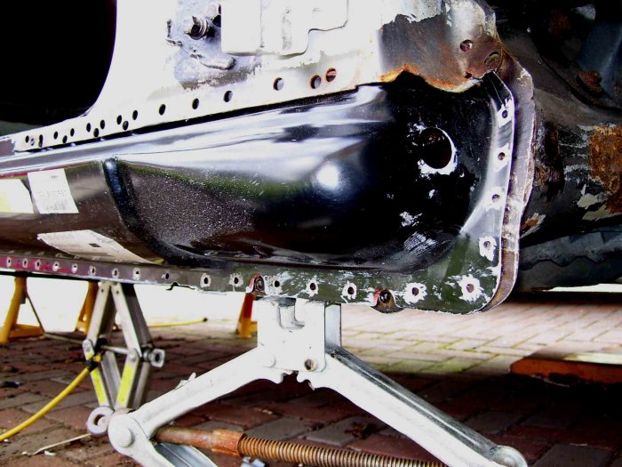

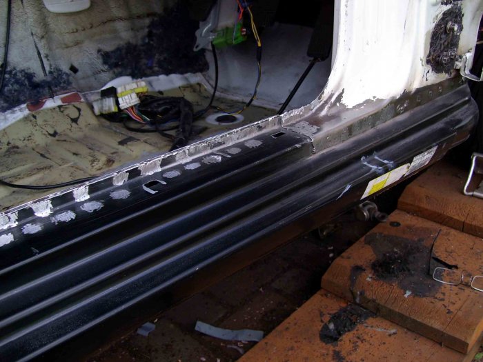

I am about ready to plug weld the outer front sill in to position, so all of your advice will come in very useful as there are many plugs to weld and i really want to get them right.
Thanks again for taking an interest guy's and if there are any more pointers before i start welding, hopefully at the weekend, please let me know. i would hate to mess up at this stage.

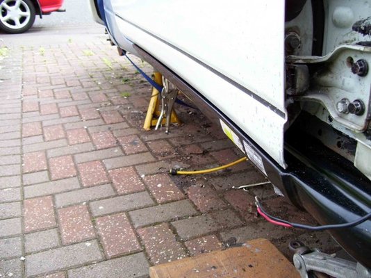

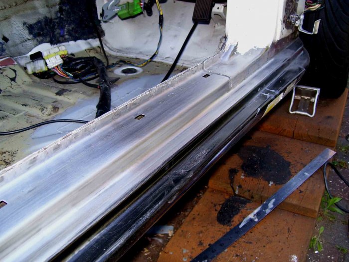

Wrestled with door today and managed to get it mounted so as to obtain a reasonable gap,
not quite as good as original but good enough I think.
(may look better with some white on the black?)

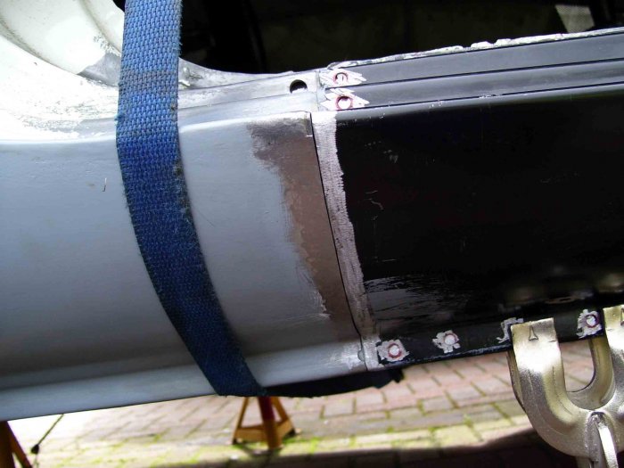

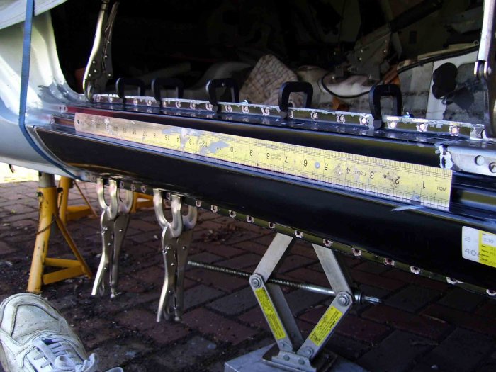

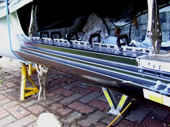

I pre fitted the sill as well and managed to get clamps to all areas.
( by the way,thanks for the link Pedrbedro
) Hope to fully prime with 90% zinc tomorrow and as Chickenjohn said, grind back at the welded areas for good contact.

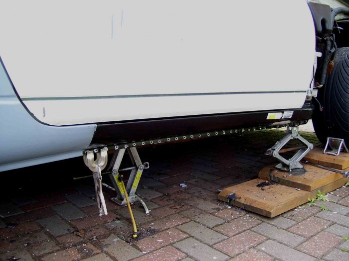

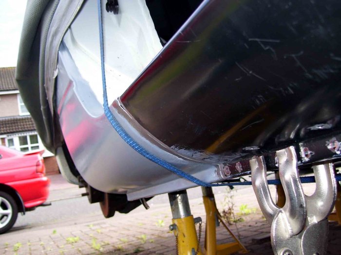

Just about ready to start tacking on the outer sill and the heavens opened up.
Still, has given me time to consider the options as regards to how to approach the pattern of tack welds.
So guy's, will you please take a look and suggest the best approach so as to minimise movement and distortion etc'
Also, I have varying thickness' of panels (multiple layers) and I want to be sure I get a strong weld as well as a neat looking one, Should I work on the premise that for each millimetre of panel I use, the higher the power setting? IE 1mm=1A 2mm=1B etc' (Clarke te135 by the way)

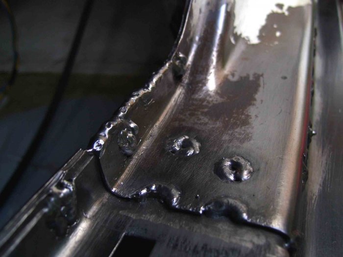

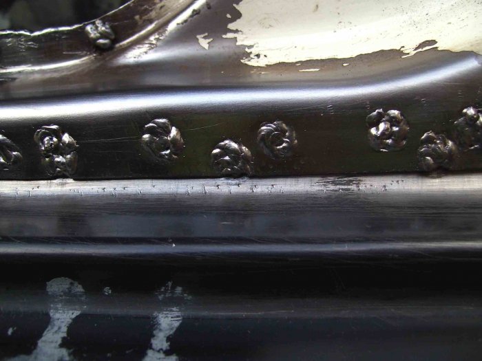

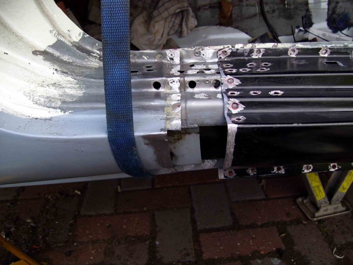

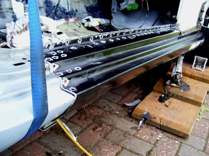

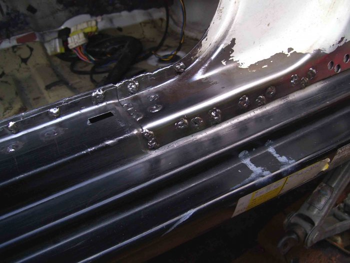

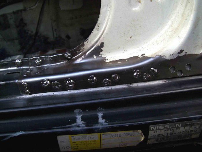

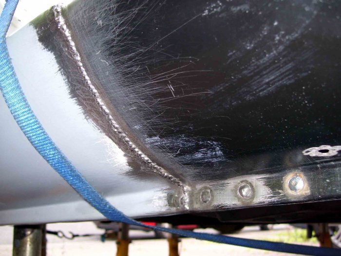

Managed to weld 2 thirds of the outer front sill,
A combination of settings due to the varying thicknesses of metal tested me a bit but managed to get what I think are strong welds,
What do you guy's think? Suffered again with this strange phenomenon when welding upside down and came up with the conclusion, that gravity affects the molten wire from coming into contact with the object panel,
Therefore builds up a blob in mid air. I may be wrong though. Added a few photo's of todays efforts for interest, feel free to comment.

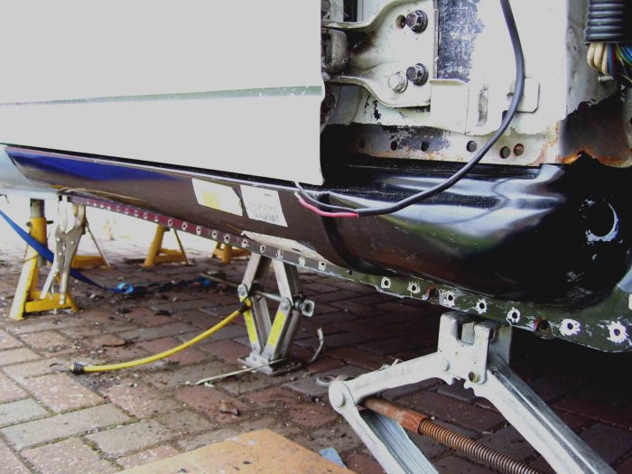

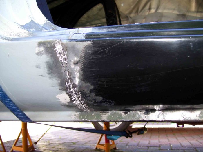

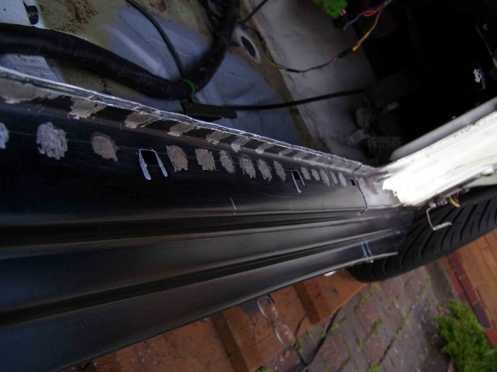

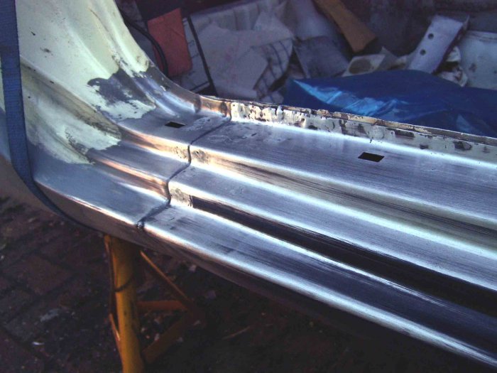

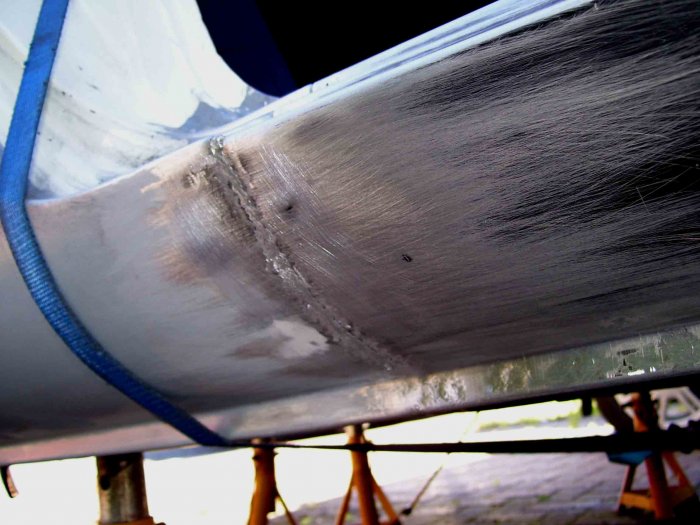

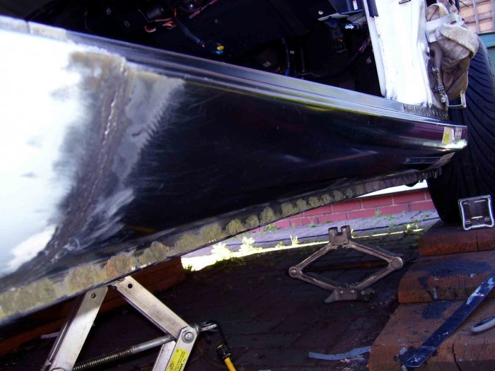

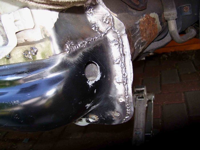

I managed to finish off welding the front outer sill today.
Then set about the thankless task of grinding back the welds ready to prep with filler and primer.
Got fed up after a while though,
so will have to finish off next weekend. Thought you might like to see some photos of my progress,

I do have one suggestion however about the spot-welds: Do you bump the power/wire up on your rig when 'spotting'?
Have you tried starting the spot from the center of the lower panel, holding the torch momentarily untlil you see a weld pool, then draw the weld out in a spiral motion toward the top panel.
-snip-
I do bump up the power and feed when spotting, but as yet have not been able to master the spiralling out from the middle,
everything happens so damn fast.
My technique, (if you can call it that) is more of firing the weld dead centre and letting it fill out wards naturally,
not the best i know.
this has mainly been down to my poor technique and that the lower panel has sometimes been considerably thinner than the one above, especially at the A pillar to sill area where the sill goes behind the thicker steel. I am not saying this is the correct way, just something i was able to manage so as to hopefully achieve some strength in the weld.
Any additional comments you guy's would add to mine above would be most welcome. good or bad
I wish my welding was as good as the advice though.
I have a feeling that i am over compensating for my limited ability with too higher wire speed.
Probably making everything happen to quickly and preventing a more flatter weld.
looks like a bit more grinding.
now that i have more of a feel for MIG welding I think I will do some test pieces over the next few days with different speeds.

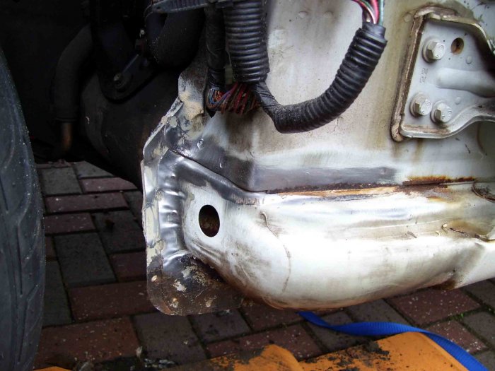

However, there are some areas around the rear arches and some more on the inner front arches.
My aim at the moment is to get her back on her wheels and re fit the interior so I can run the engine up.
Once that is done I will tackle the arches. The end goal is to go for a total re spray and chip the engine a little. (400 bhp should do.)
