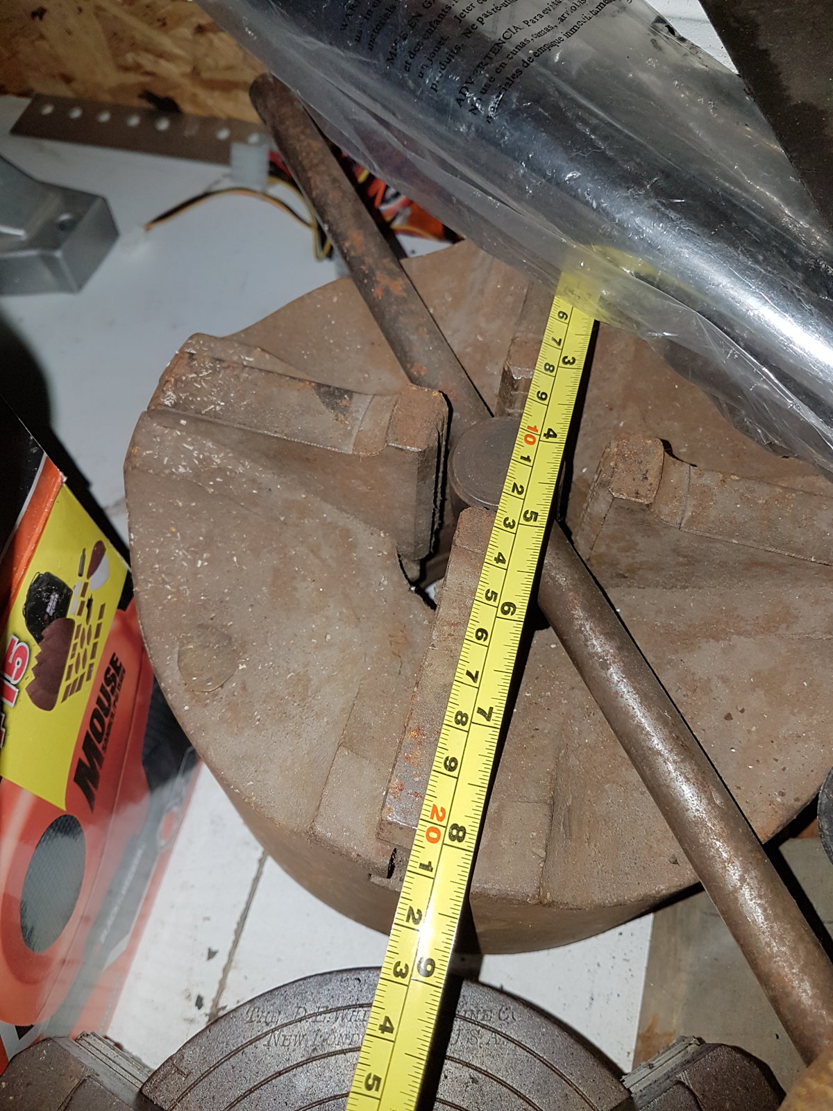

Yer they do weight some. It's the same size as mine. Faffing heavyIncidentally, I can confirm it is bloody heavy!
You still got it. Pm sentThey are a lump!View attachment 158036
I got this along with a job lot of goodies a while ago.

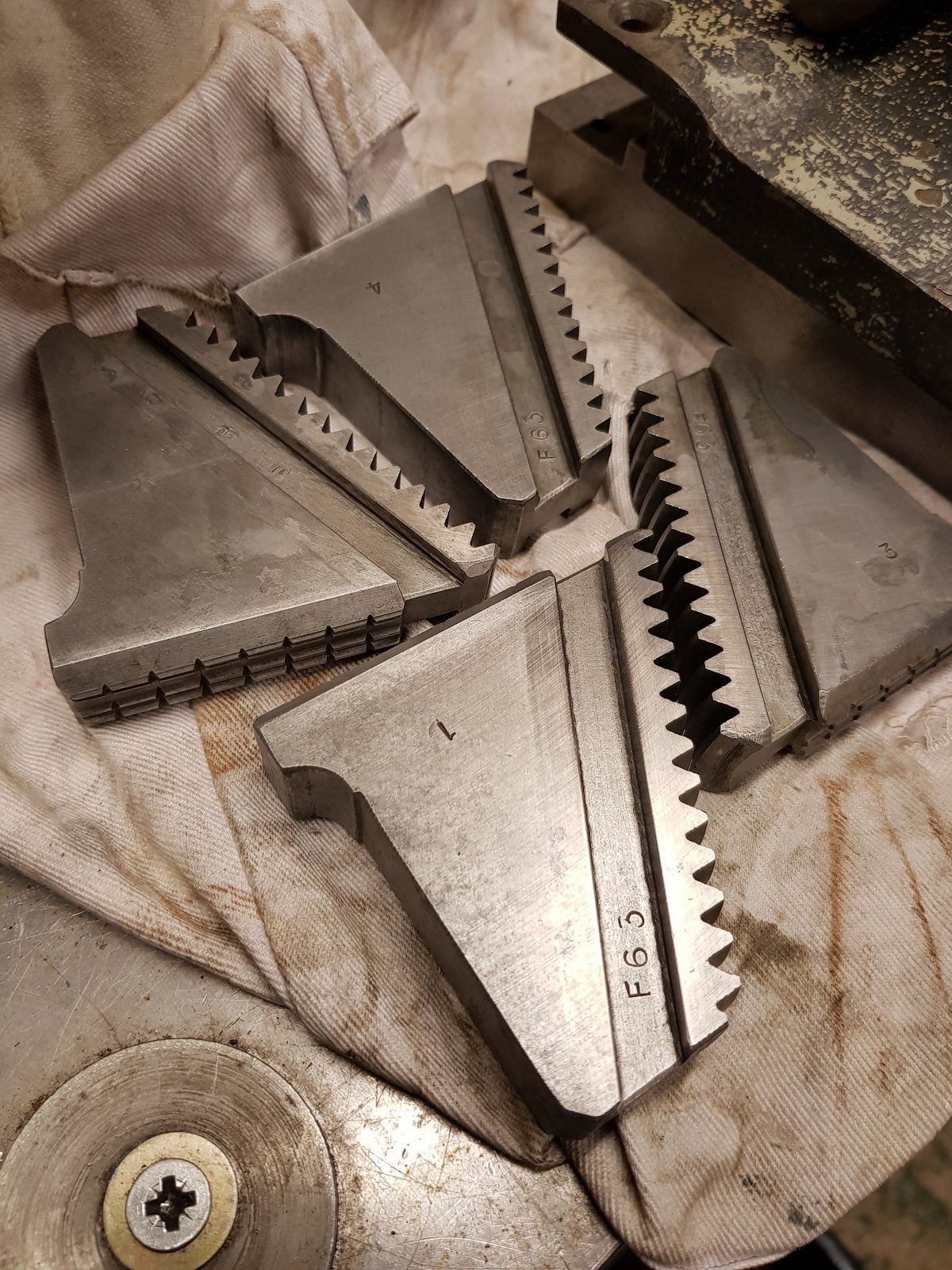

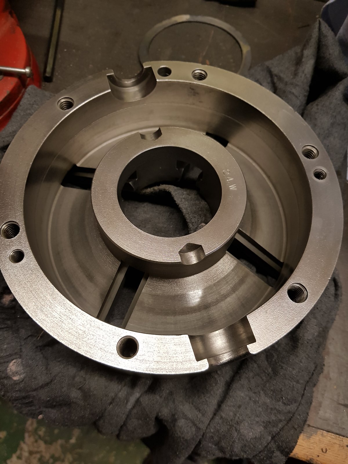

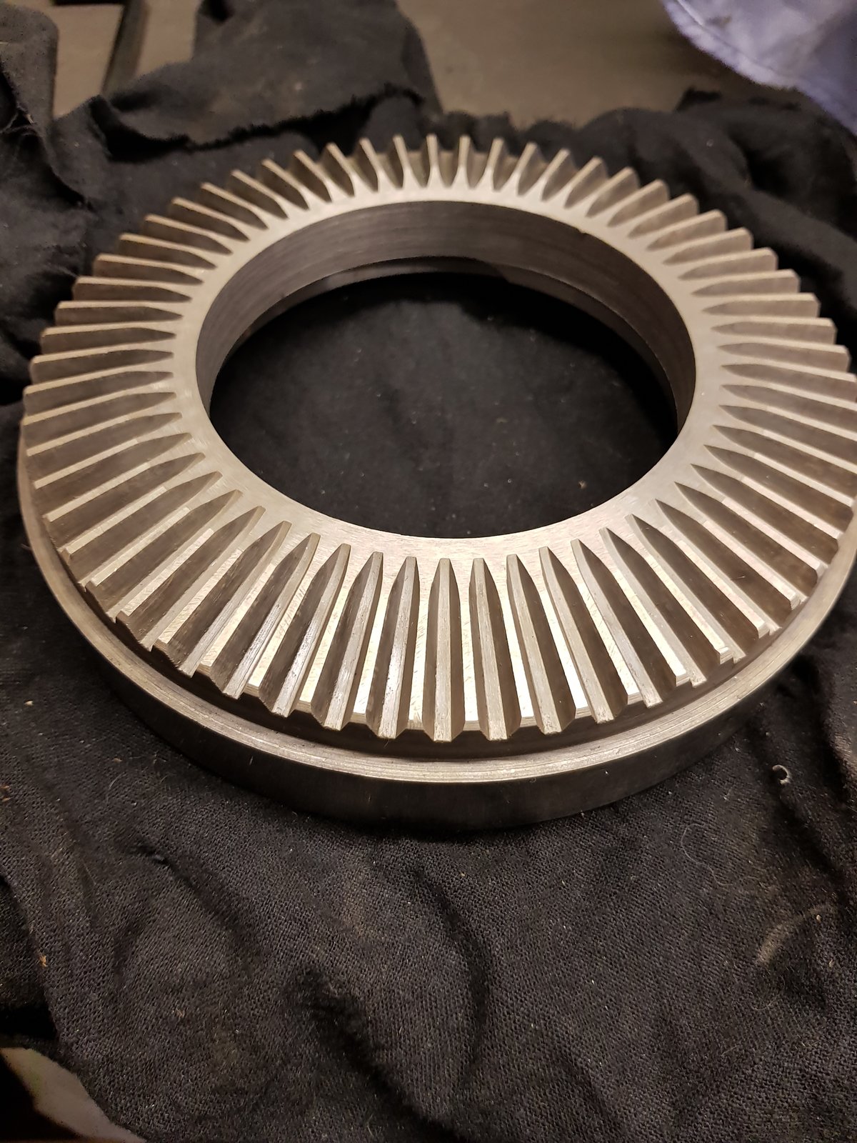

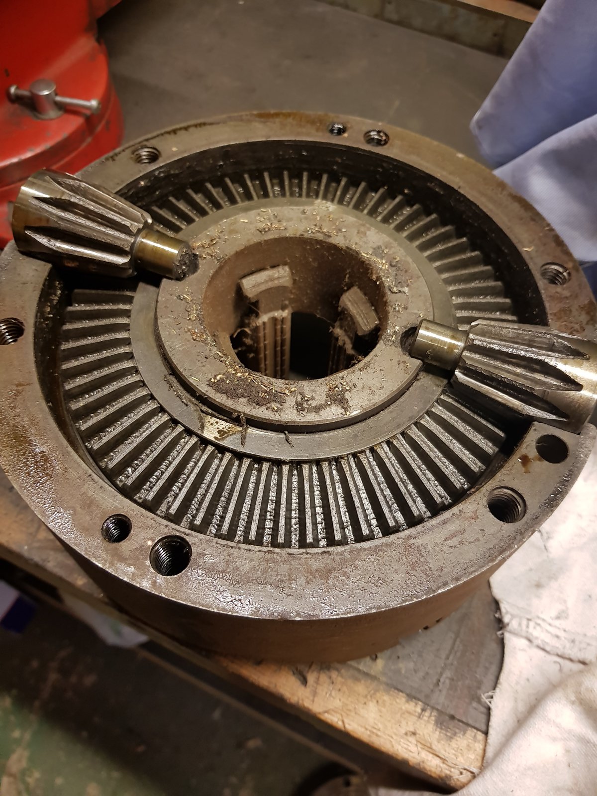

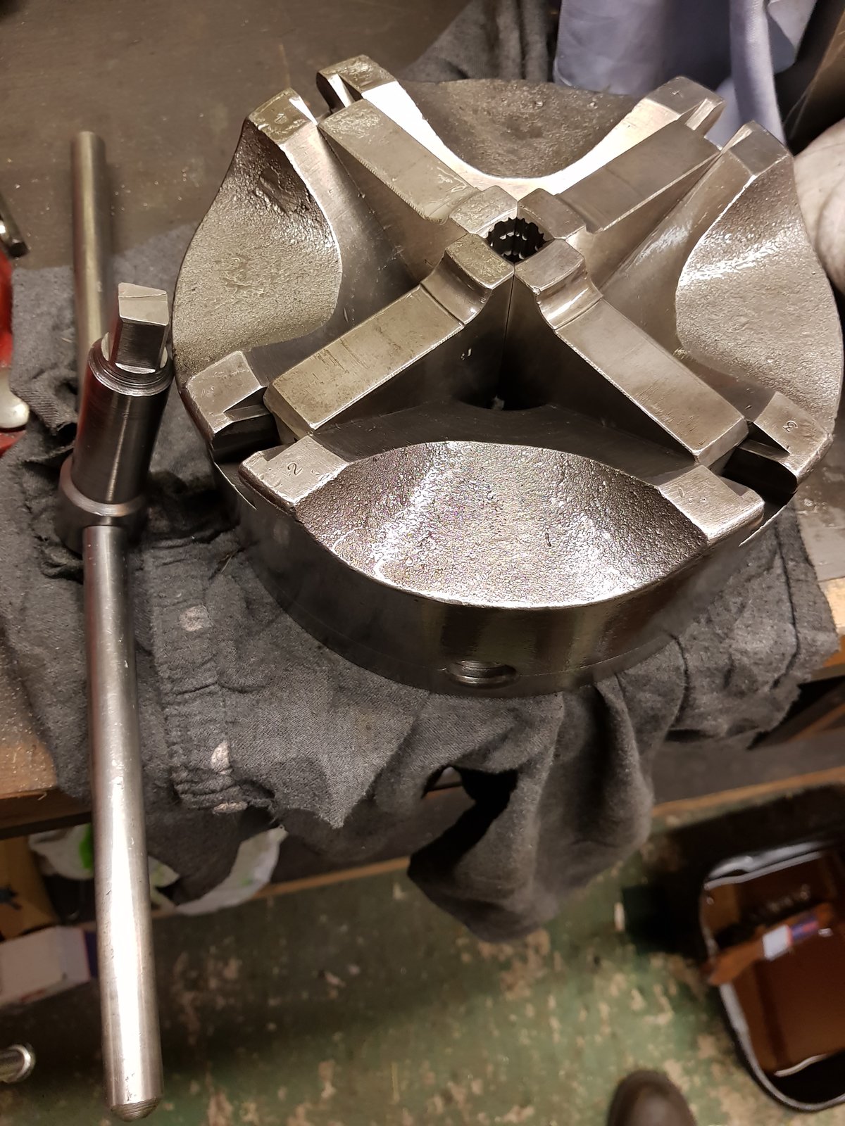

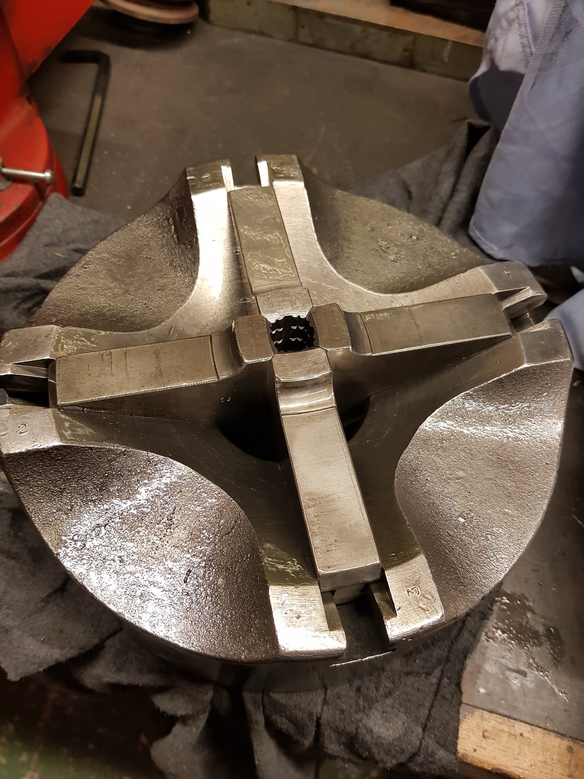

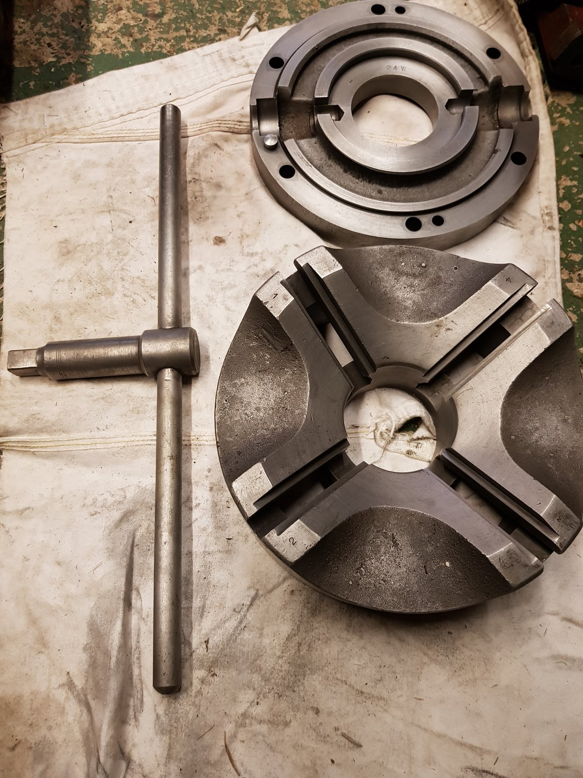

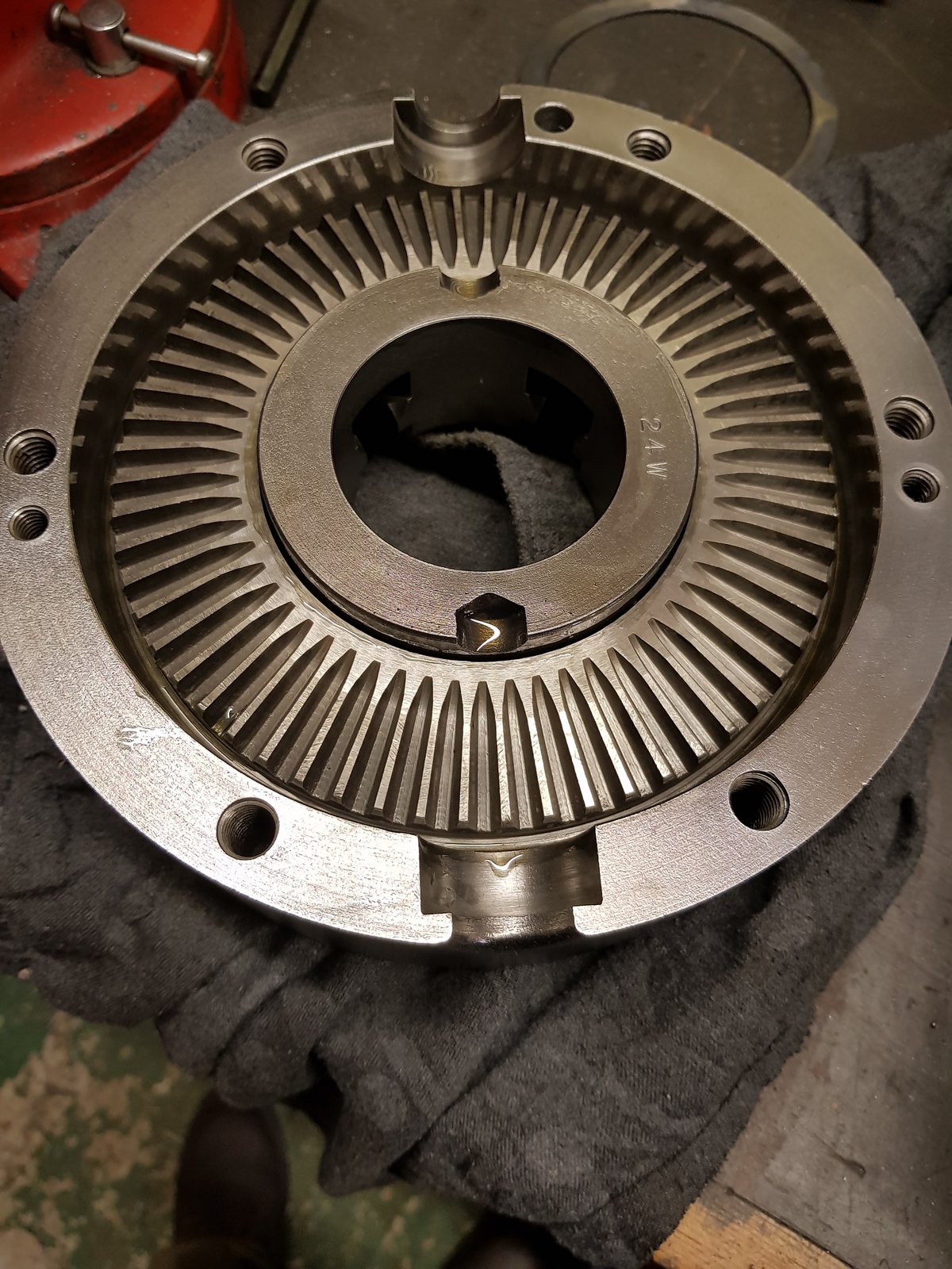

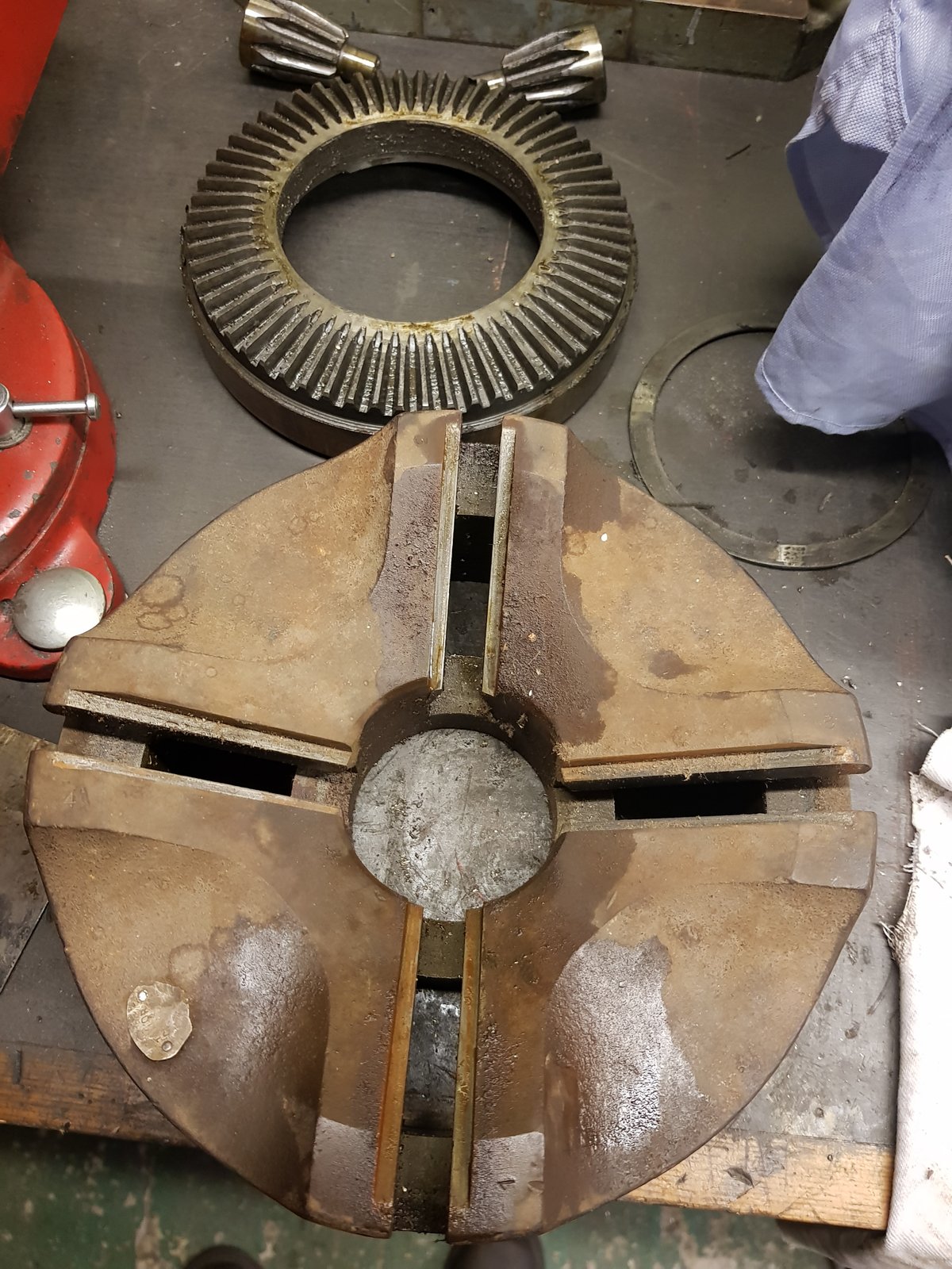

Carrying on from the 8.5 three jaw I am now doing the four jaw. In great condition. It's been degreased and cleaned. Tomorrow I hopefully should have it built.
Indeed mate it is.It's very satisfying, isn't it.
And the scroll form is twice as strongIt is in effect conical. The scroll is cone shaped and the jaws are drawn into the chuck, as they tighten, providing a much higher gripping force than with a conventional flat scroll.

It did cross my mind on the three jaw. May well do when it's up and running.They look nice Spencer.
I wouldn't be able to help myself - I would HAVE to pull the jaws and re-face the flats and re-punch the numbers
