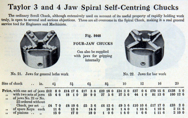

Linseed oil for it's final finish. I will also make a new Taylor chuck badge.
They are capable of far greater clamling forces and stay accurate longer.Can't fathom these chucks. No perpendicular surface to set work too.
Regularly use parallels to set work away from the chuck body but don't have the option with these.
I would love to find the four jaw Taylor but these are impossible to find. But I shall not give up.They are capable of far greater clamling forces and stay accurate longer.
But like you said a pita.
Id like a 20" one for my big lang
Damn handy on production work on square stockProbably the least practicable type of chuck as far as I'm concerned. It has neither the versatility of the independent 4-jaw nor the tolerance for handling out-of-round stock of the self-centering 3-jaw.
I agree .It's strange that the four jaw is self centering and not independentProbably the least practicable type of chuck as far as I'm concerned. It has neither the versatility of the independent 4-jaw nor the tolerance for handling out-of-round stock of the self-centering 3-jaw.
