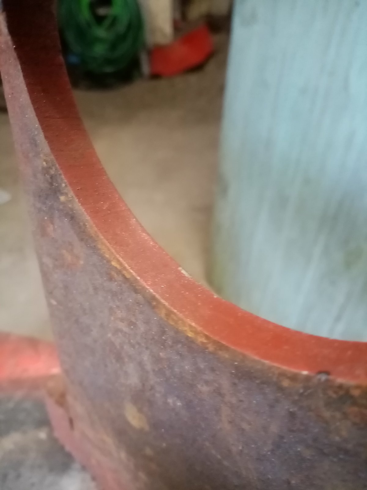

Yep machine does all that automatically.When I hand cut with plasma, to take into account the slight taper, If i'm cutting a circle that I need, I cut clockwise,If the outside of the circle is needed I cut anti-clockwise, Easy to remember, the circle is like a clock face so cut clockwise, And obviously if you want the "hole" cut anti-clockwise.

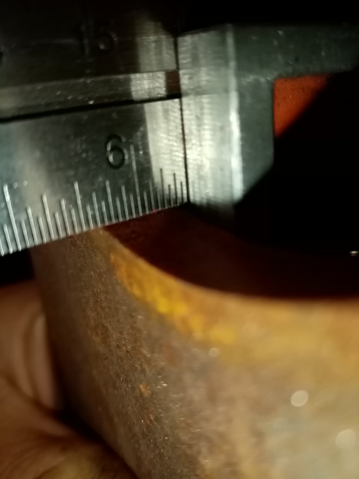

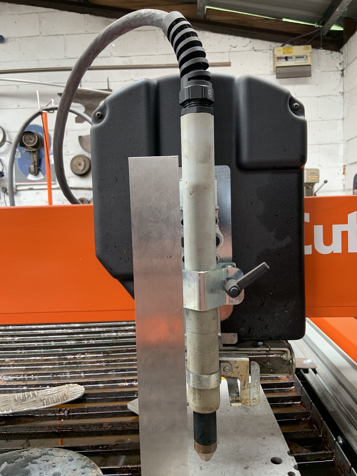

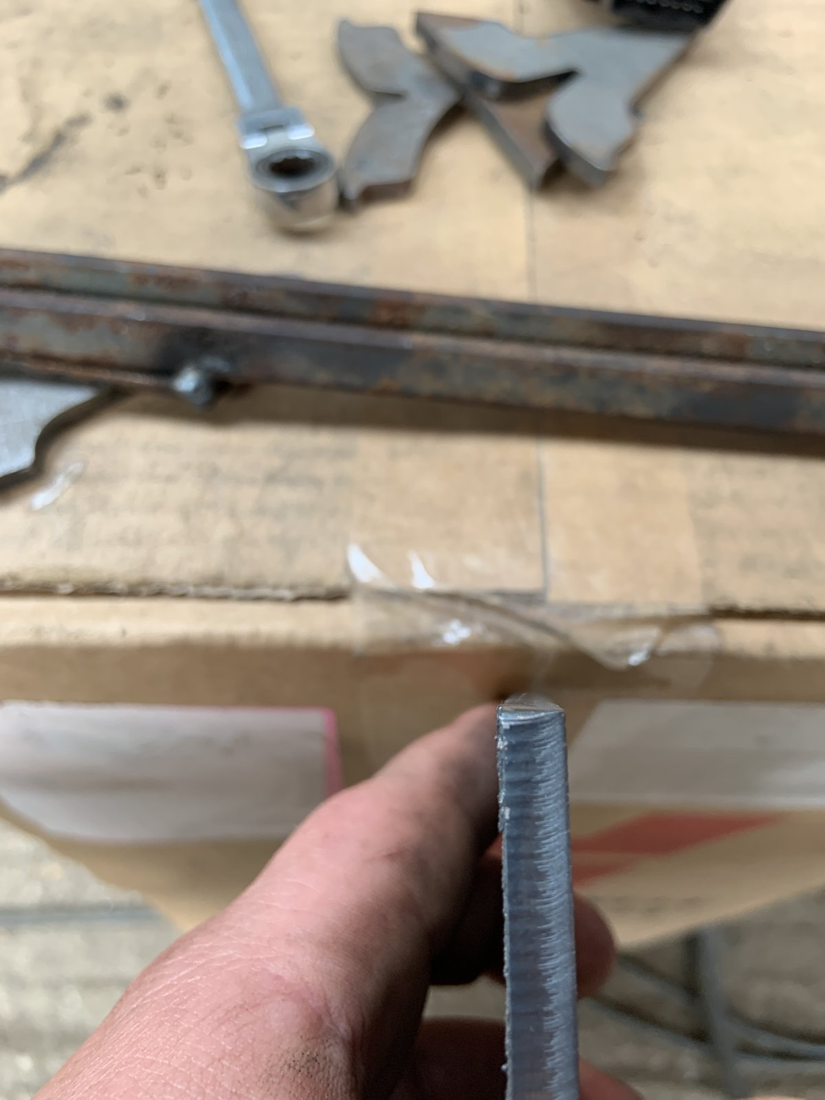

I’ve **Language** around with feeler gauges, and got within 3.5 - 4° of taper all the way round the part.
Think that’s the best I’m gonna get.

No idea. It’s a very dumbed down version of Mach4 that gets supplied.I'm thinking it could be the THC setting the torch too high or low. The plasma "flame" is not parallel so if it's too high or low the cut will be slightly "V" shaped. Can you vary the THC voltage during a cut?

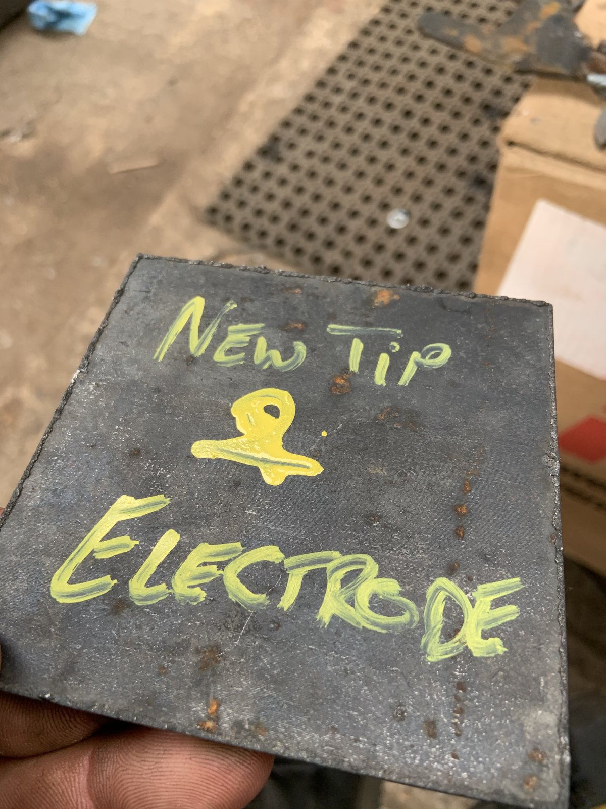

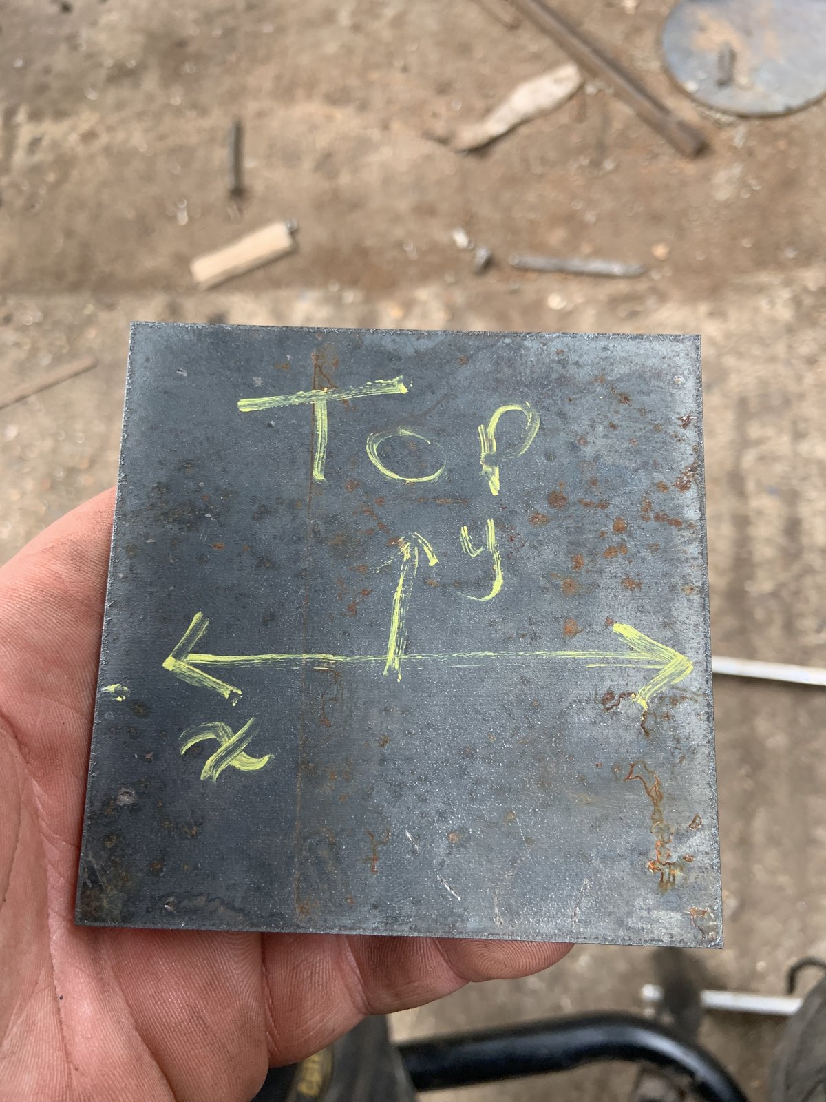

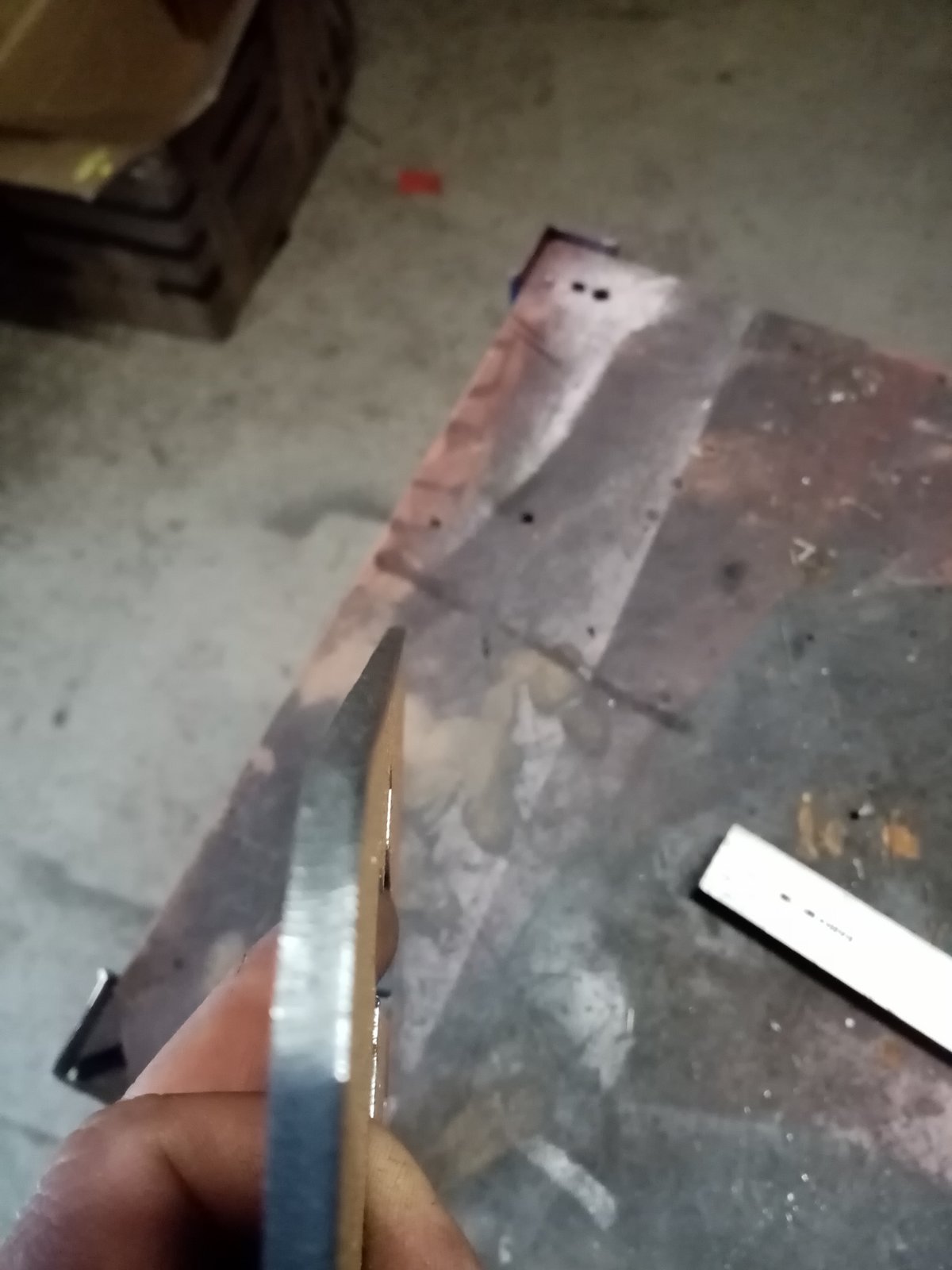

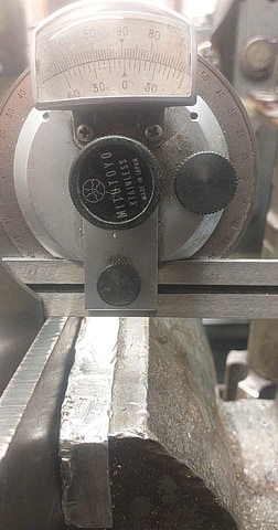

This is 6 mill with new cons and a little bit time experimentingI’ve **Language** around with feeler gauges, and got within 3.5 - 4° of taper all the way round the part.
@doubleboost John, I’d be interested to know what sort of taper you are getting on 5mm steel.
