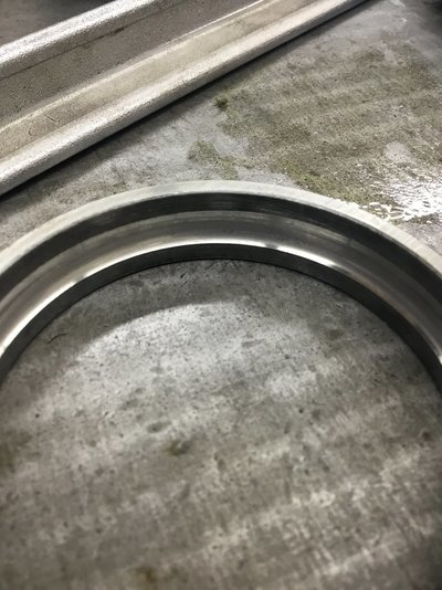

Its a perfect job for the surface grinder if you have one or know someone with one.
. It was needed as well... one axis of the uj was very tight, you could get both circlips in but it was stiff. So ground a few thou of the bottom of the cups (2).

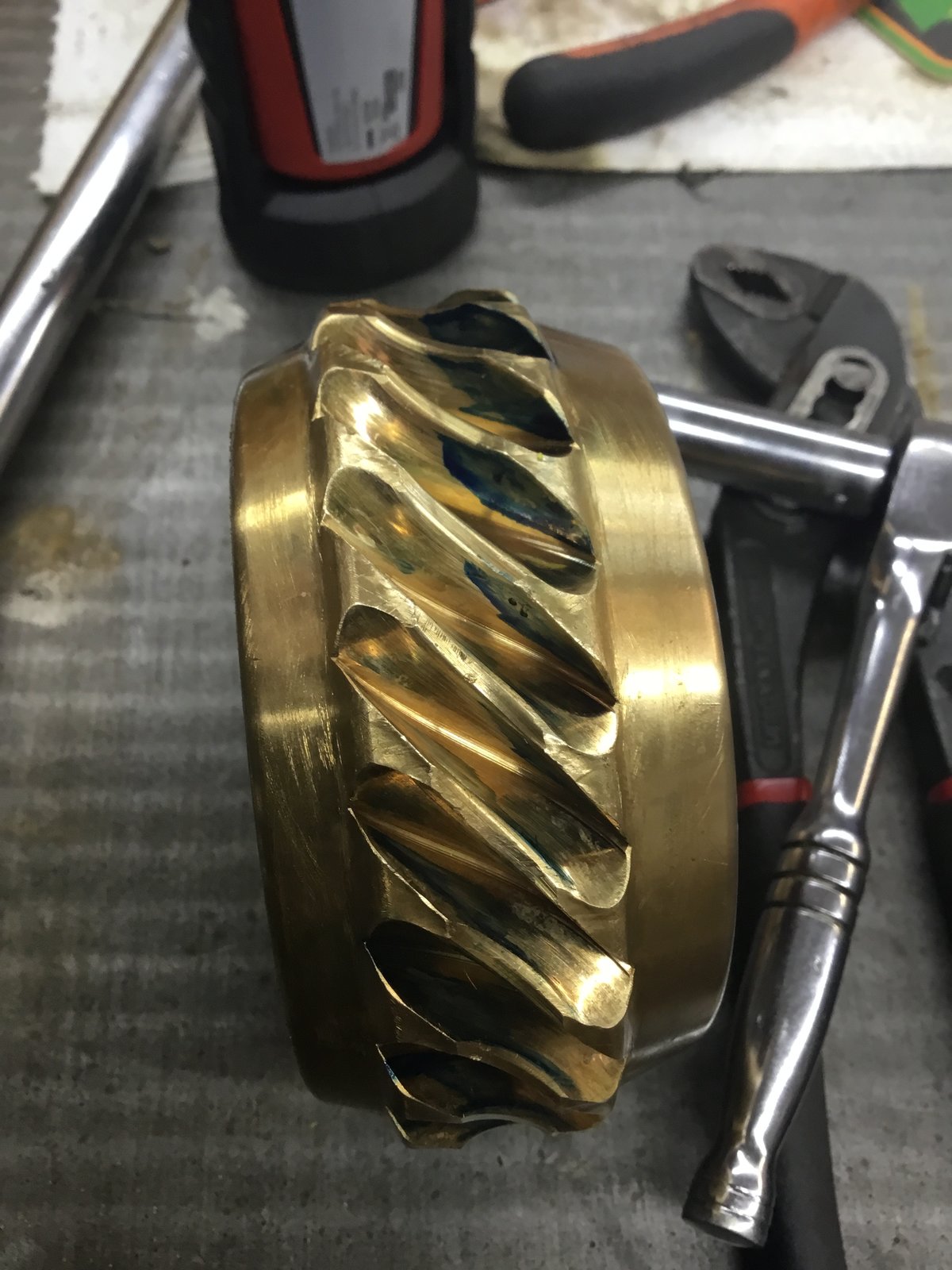

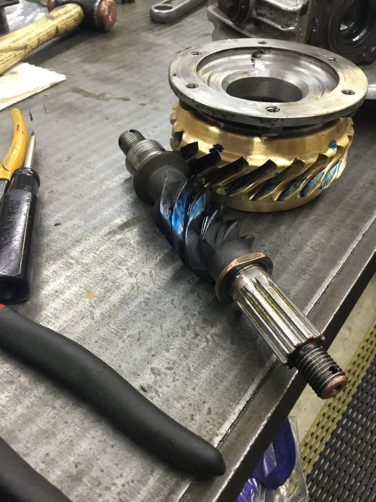

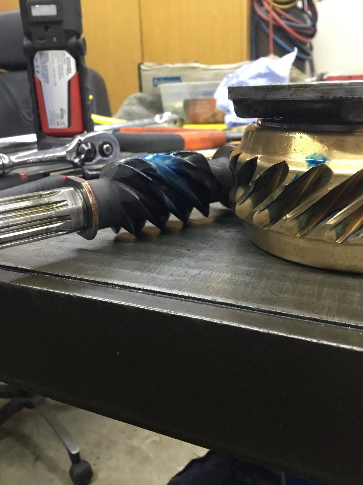

To be fair to (myself) the bike, I would have gone through all this regardless. I’ve been bitten before believing someone’s abilities/statements, so would rather check it for myself, then if it goes wrong, its my fault.
....every day is learning dayYour worm is a lot better than mine was, which was nearly knife edged, it never made a sound ASAIC.

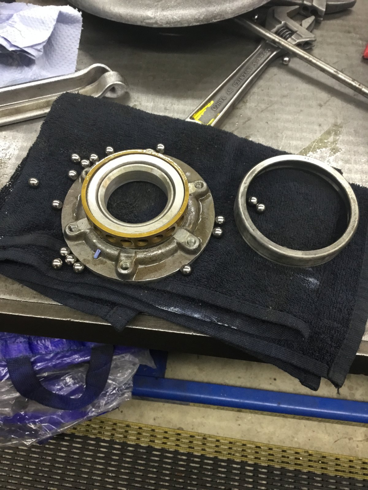

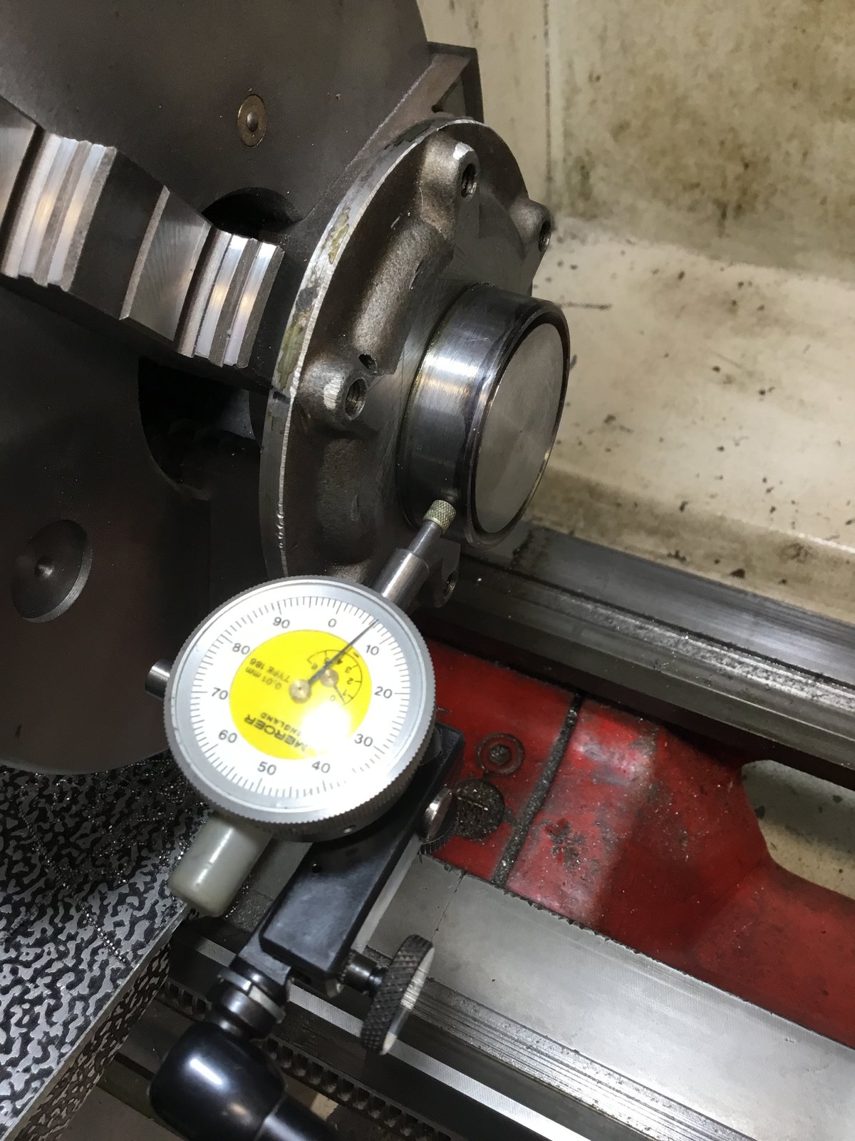

Someone must love me today... She’s called Lisa at the local Bearing suppies.
I need 3 bearings 2 Hoffmann deep ball thrust, and a parallel sliding roller. Total cost around 375quid.
Lisa just rang me, in stock tomorrow. 120+vat![]()
Result ! Probably old stock and being Imperial, they want rid.
