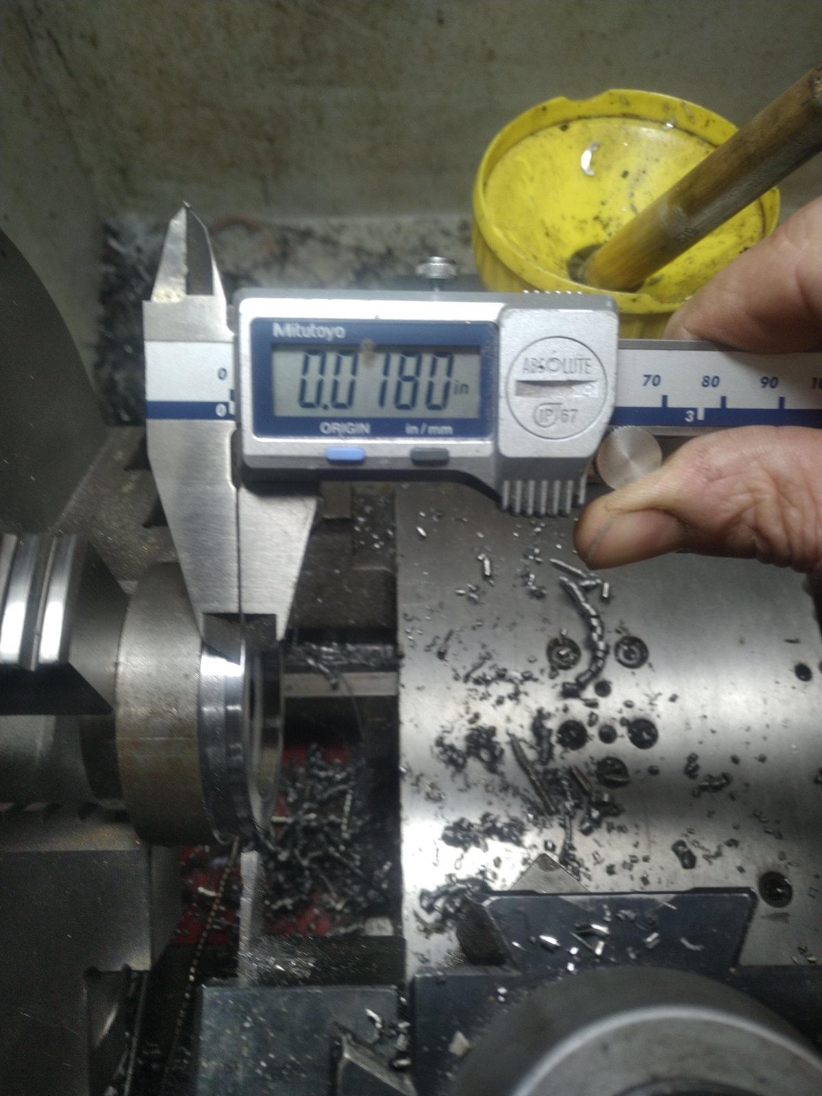

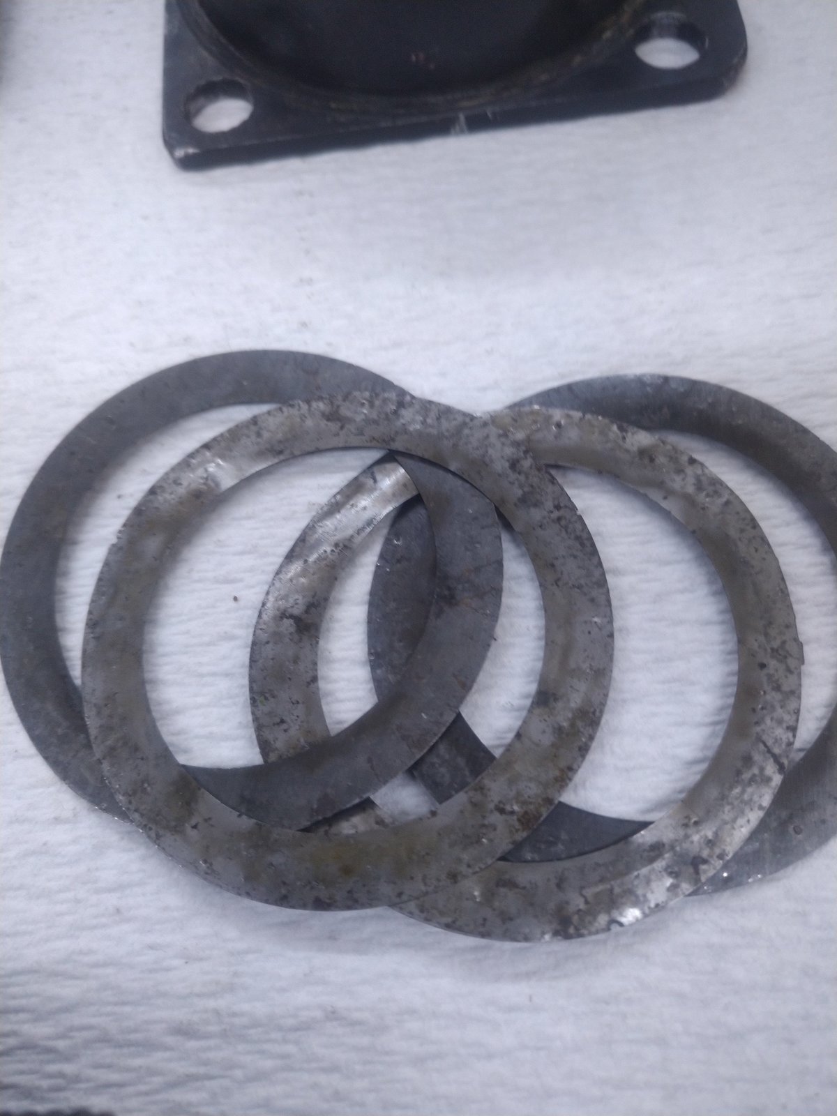

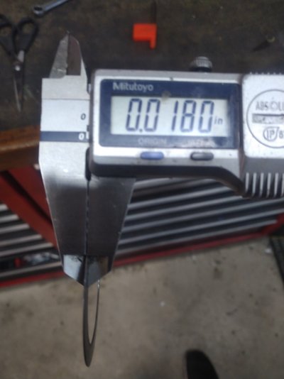

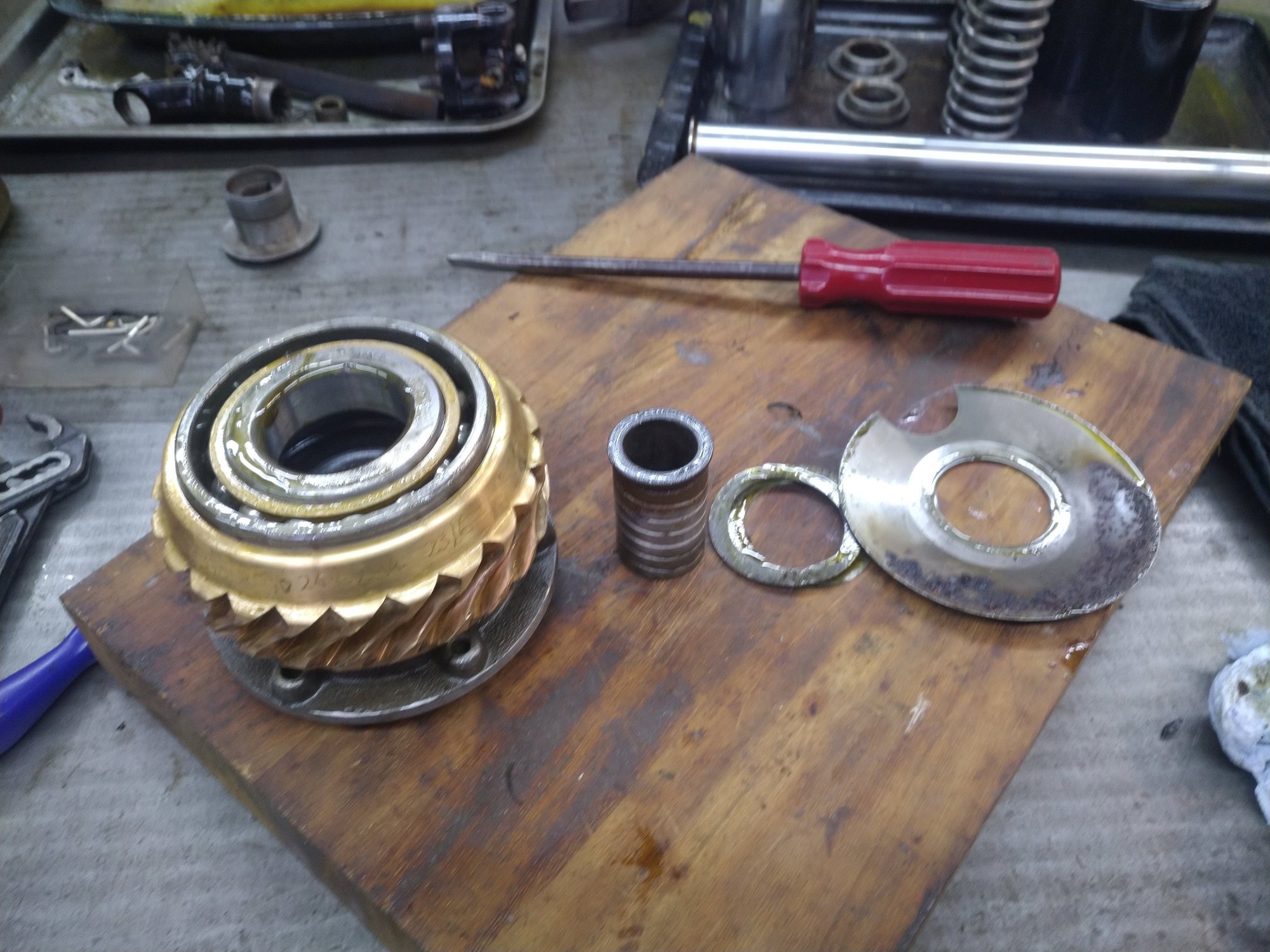

Nice machining work! How do you make a shim like that?

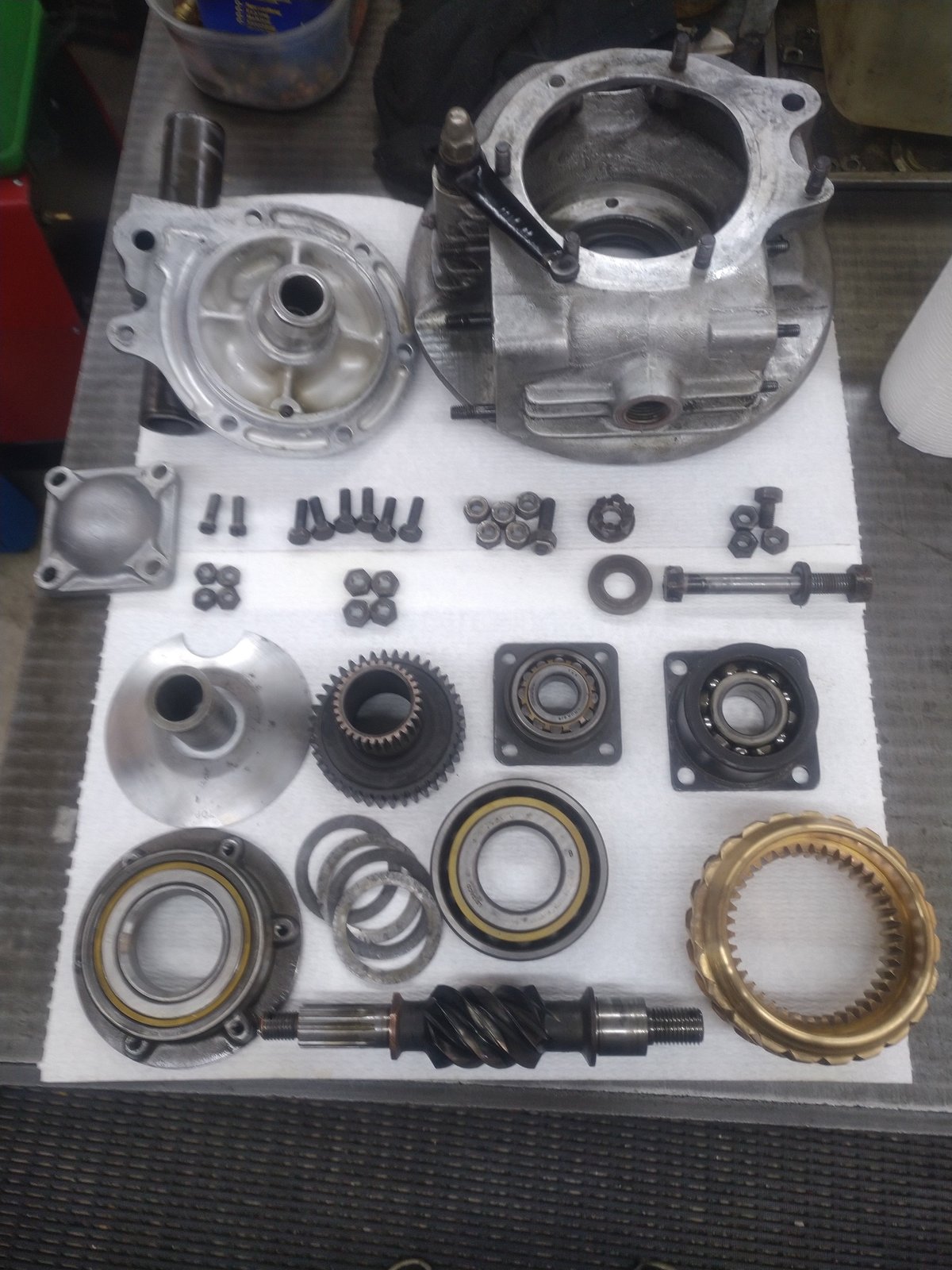

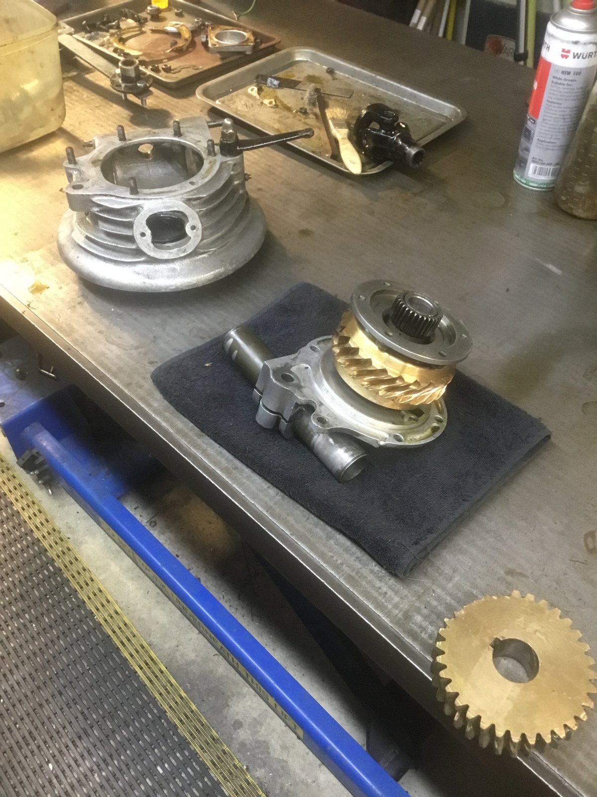

So if the final drive didn't go SCRUNKLE what did?
