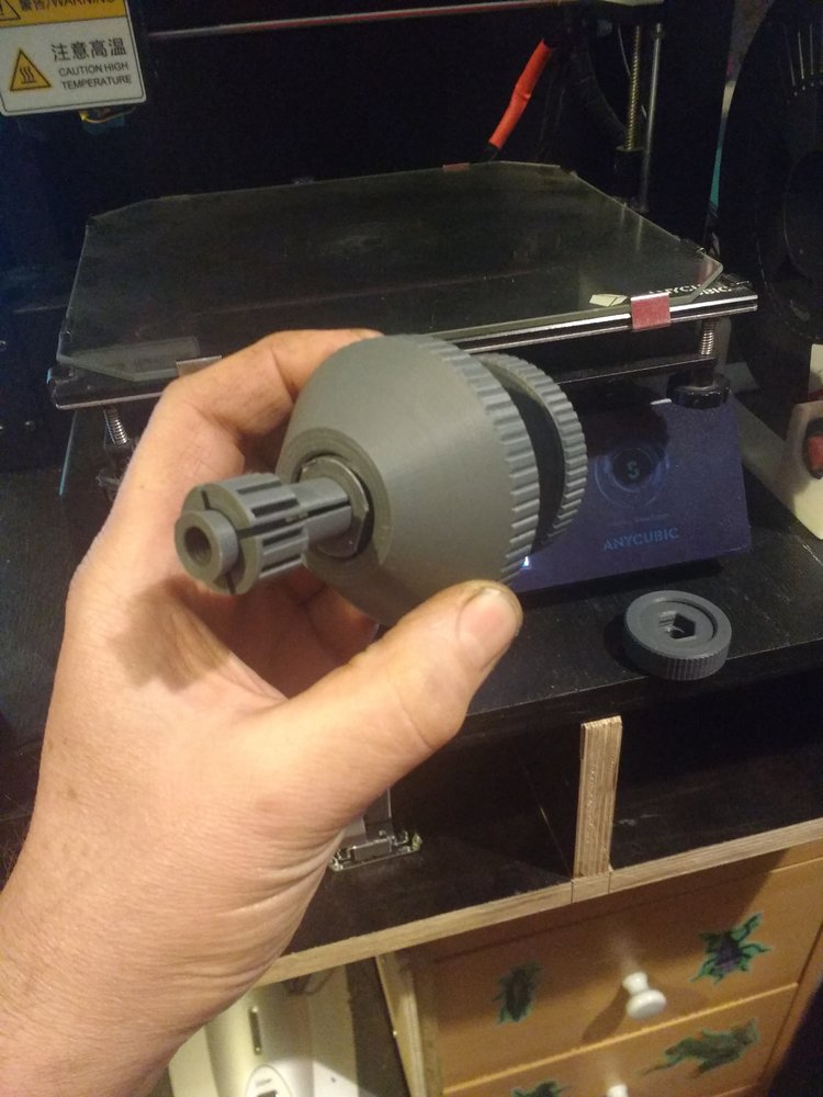

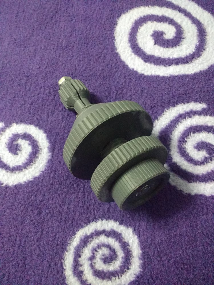

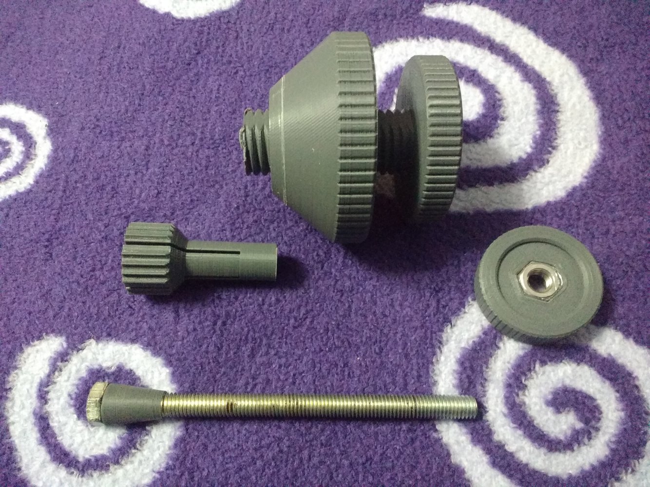

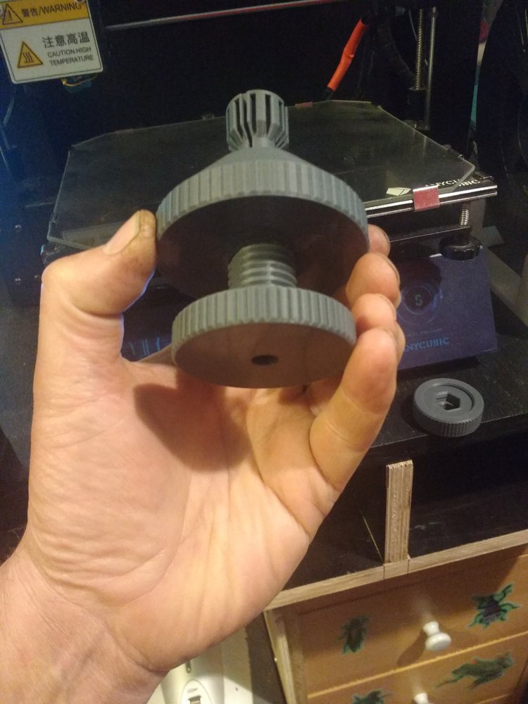

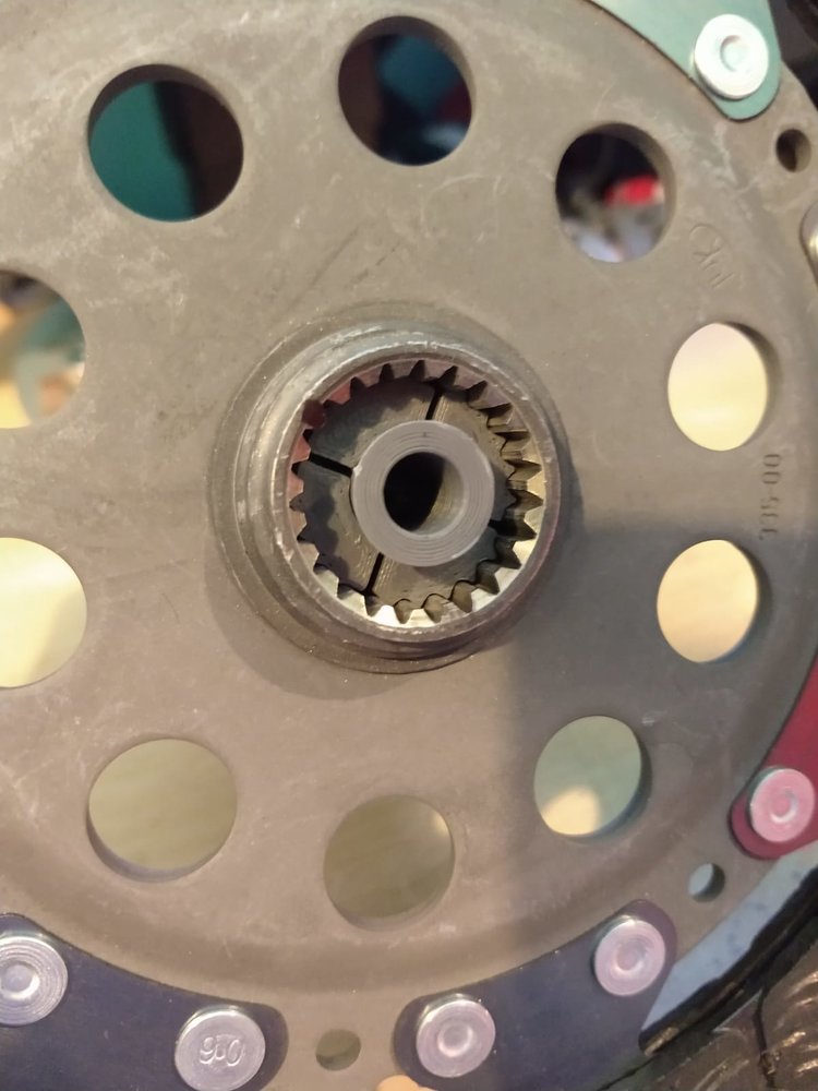

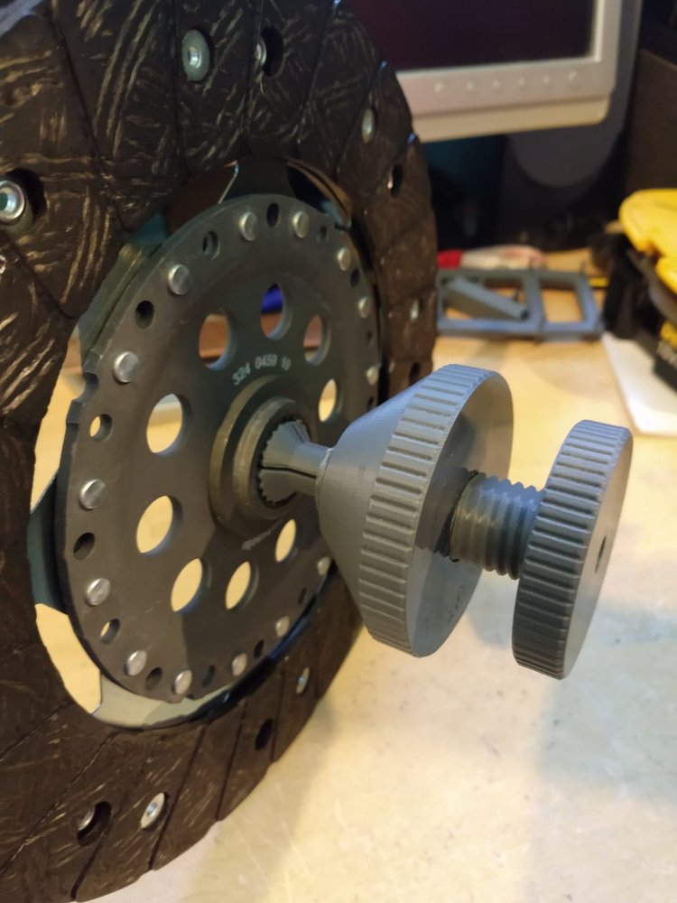

It comes with 3 different expanding adaptors but I've gotten him to detail one up which should fit exactly, the 23 spline Mondeo clutch:
I have to a ask: 23 splines and four regularly-spaced slots for expansion?
It will have one slot either at the root or tip of a spline and the rest will have no relationship to a spline. That is the beauty of 3D modelling: with thought the slots could be unequally spaced.
For what the alignment tool has to do, there is no benefit to it being splined.
Broomhandle wouldn't work on a spigotless gearboxA case of can we, not should we!
