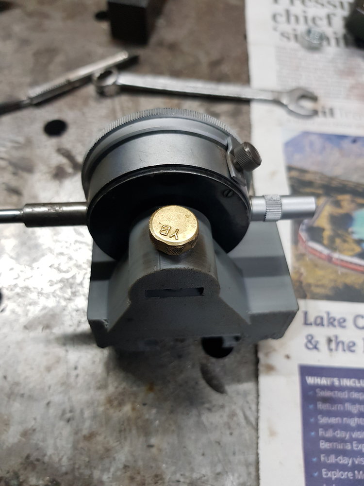

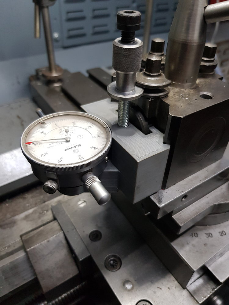

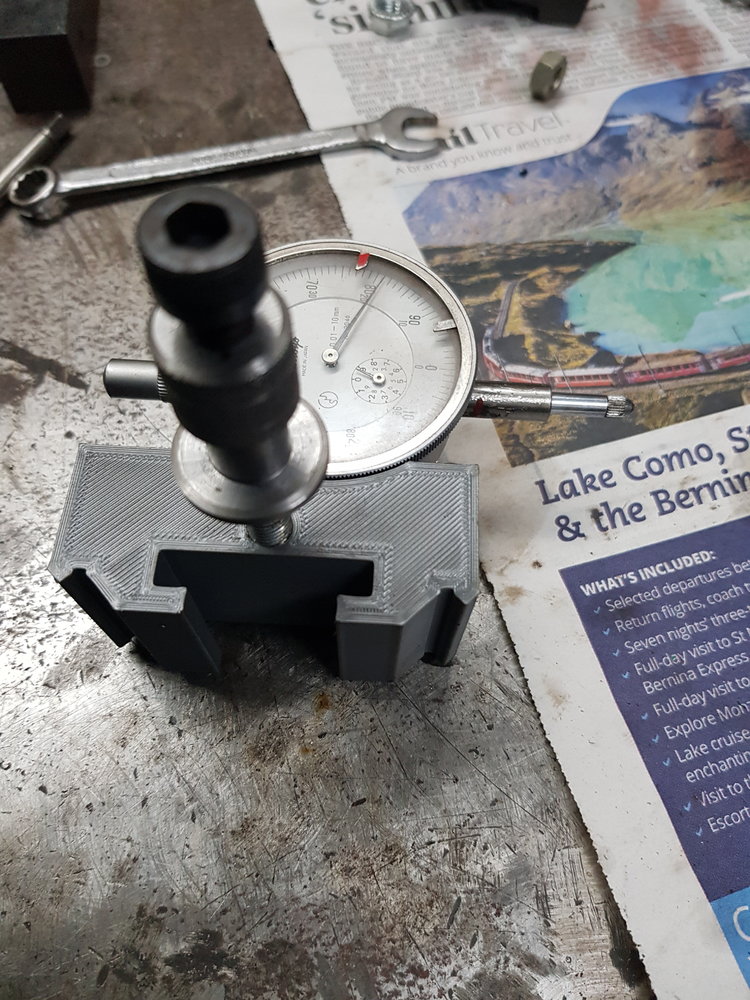

Ooh I like that. Is T1 Myford size? I could do with something like it to free up one of my holders.Modified a T1 holder i found online so that it will hold a rear mount mitoyo DTI
Can upload to Thingyverse if anyone interested
View attachment 387328View attachment 387329View attachment 387330
Hi probably not I think the toolpost that fits myford is T0 , meassure the width T1 is 73mm wideOoh I like that. Is T1 Myford size? I could do with something like it to free up one of my holders.

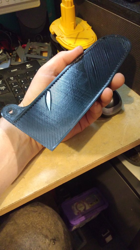

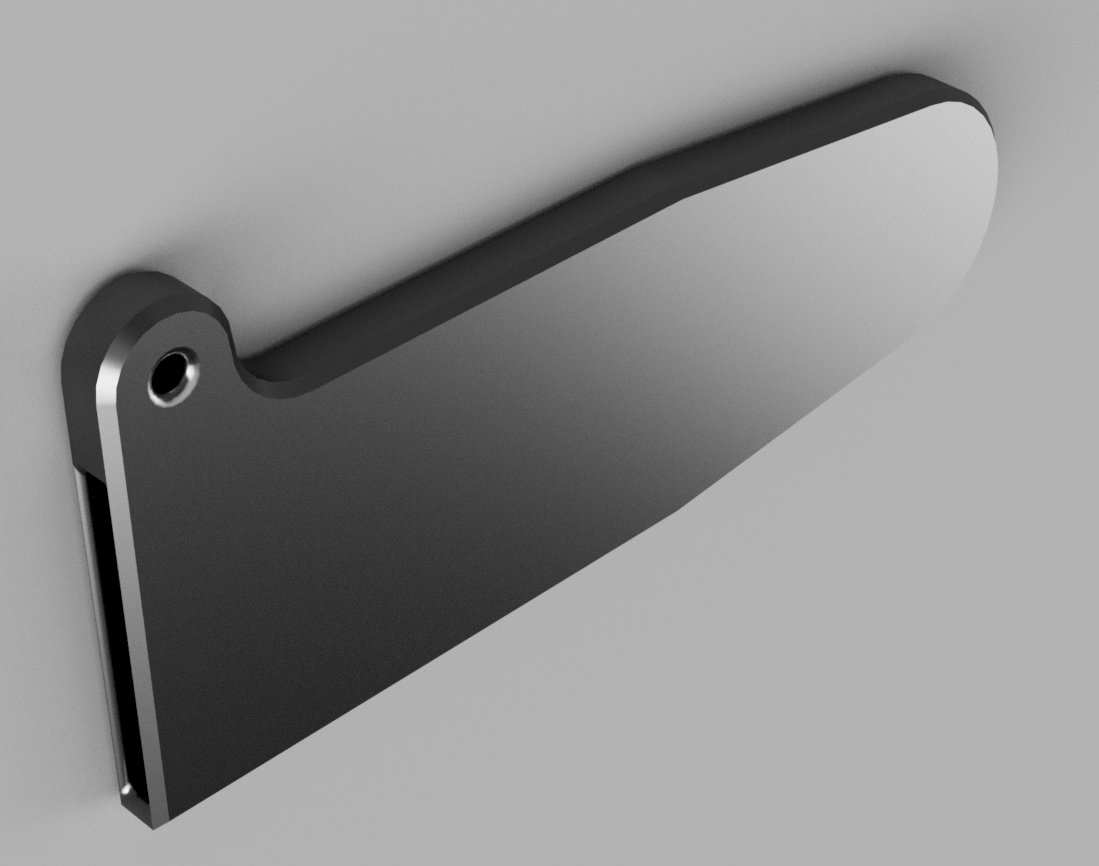

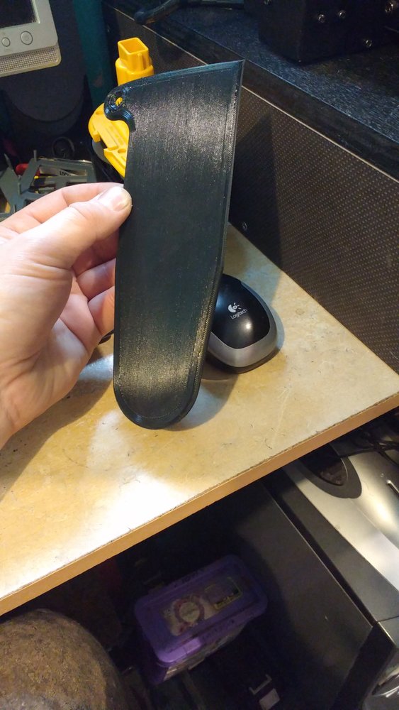

I would try tweaking the design so that can be printed on edge, and therefore no need for support.. Adjust the wall thickness so it's a multiple of extruded width.4 hours into a black PETG print for @Kram (chainsaw scabbard) and it warped and lifted off the bed. Maybe not enough 3DLac on the bed?
Starting again, 10% in as of now. I'll send the warped one so he can see the support structure inside that will need to be dug out.
21% in so leaving it to run its course. Quicker to print too. Just had a play with the supports turned off it'd have to bridge about 6mm unsupported. 6mm bridging will be no problem - my greatest concern would be it getting knocked off during bridging or if the end curls up under shrinkage. Certainly would need a brim.Quicker to print too. Just had a play with the supports turned off it'd have to bridge about 6mm unsupported.
