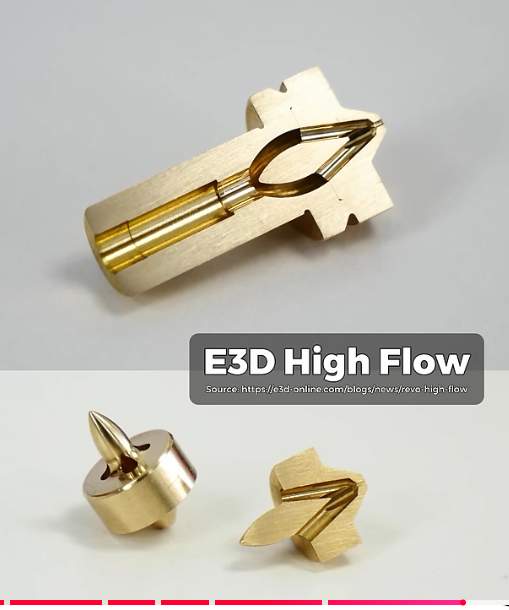

so worth the money then?Holes, plural! They converge at the tip. Lad's run his own tests and it lays down a much greater volume than the standard one.
A couple I have purchased come with extra nozzles. I have not tried those yet anyway.It is a complete hotend. By comparison the standard bambu hotend is £14.
You don't just unscrew the nozzle like on an ender type printer.
You seen the price of them now? But they still seem to have no stock. lolSee my post 279:
My lad changed the stock 0.4mm nozzle on the X1C Bambu to a "Hardended Steel vs E3D 0.4mm High Flow ObXidian" (one of his Chrimbo pressies):
Did a couple of "torture" test prints. They go from 15 mm³/s to 35 mm³/s. New nozzle on the left, stock one on the right:
Printed in Bambu Lab PLA Basic Green.
It really puts some volume down and smoothly too!
A cut away of the new nozzle shows how the filament gets "pooled" then extruded through 2 (maybe 3?) channels to massively up the flow rate by something like 60%.

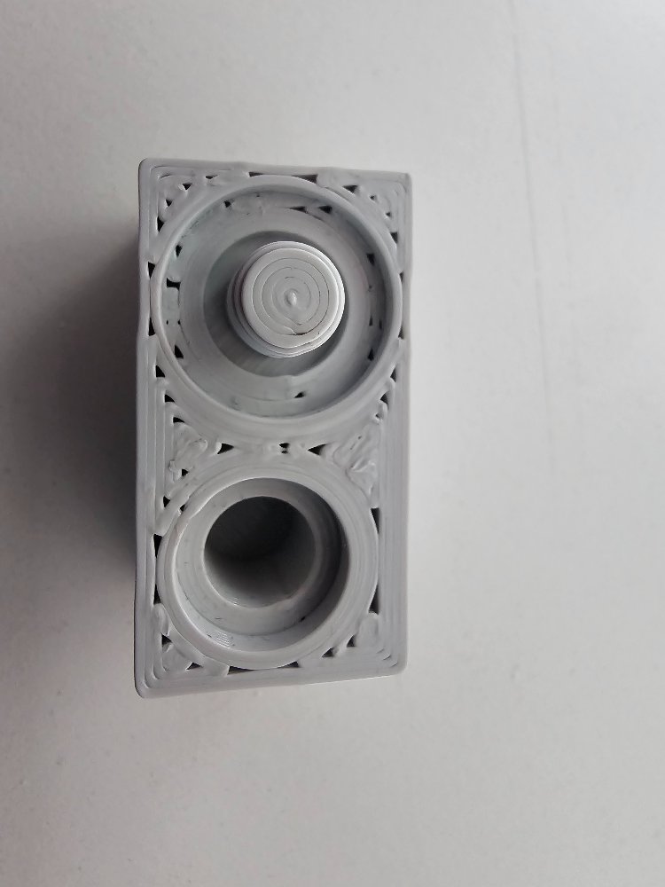

looks like the 0.6mm nozzle is to big for the size of part your trying to print?Been having a problem with small holes in the top layer, specifically on parts with lot's of details and lot's of direction changes of the nozzle, anyone have a solution?
Printer is a PrusaXL with a 0,6mm nozzle and the cheapest PLA i could find :-), part in the picture is 10 by 30 mm for scale.
Could you expand a little more or point to a video that shows what you mean with check your result with the slicer?I agree with @Dozzer, nozzle too large. Check your result with the slicer.
This video at 2:40 onwards...Could you expand a little more or point to a video that shows what you mean with check your result with the slicer?

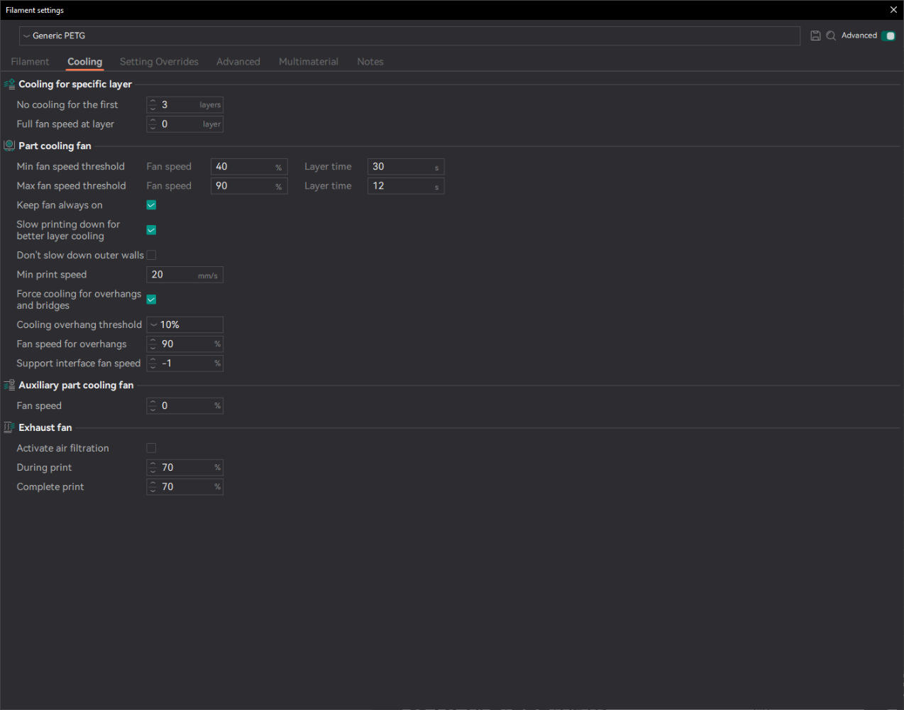

I shall try these later hopefully. I was informed last night the big grandson., who is back at school tomorrow has 14 tasks he should have done...set by his new school the cheeky buggers. I was only told on Sunday after they went through his rucksack.....@ukracer my lad's settings. He's writing a list of suggestions too:
View attachment 511094View attachment 511095

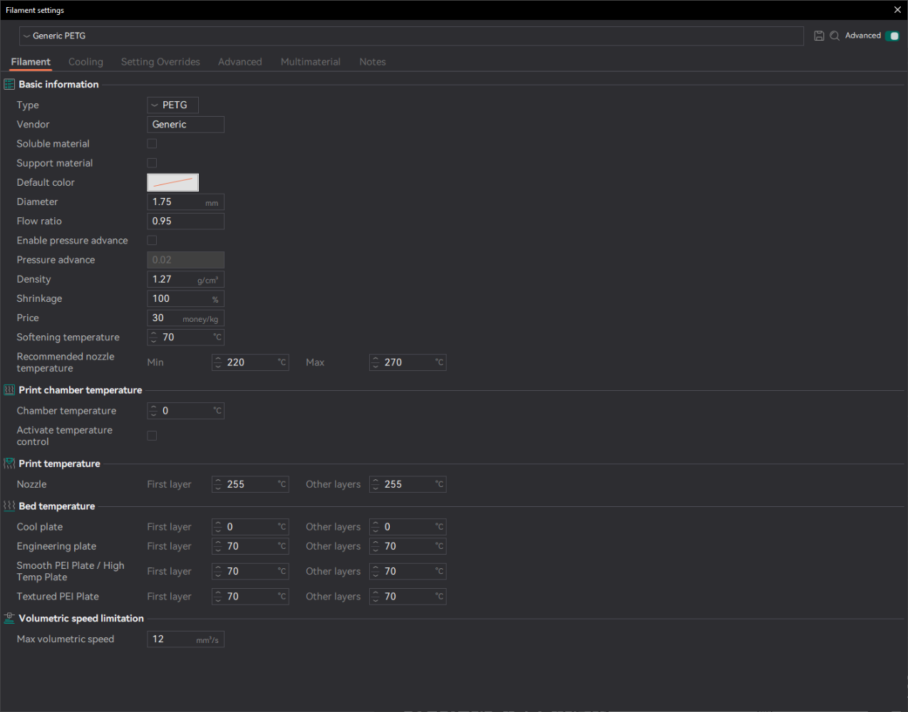

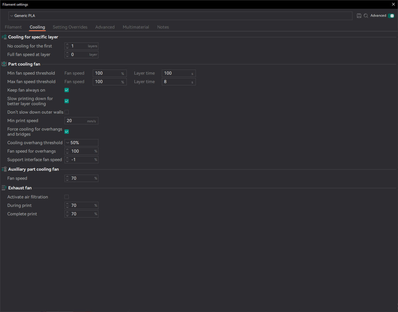

@ukracer my lad's musings. He's just off shift and about to crash so just jotted this down as it came to him:
• I've done PETG model with PLA interface and PLA model with PETG interface many times. Works with both a stock 0.4mm nozzle and an after market nozzle. Also mixed multiple brands with no issue.
• You said the filament sometimes failed to retract when changing materials which seems odd and I would expect an error message. Check that the tool head filament cutting blade isn't dull. Check the filament isn't brittle to the point where you can snap it by hand as it could be breaking inside the feed tube. If it does seem brittle this can be solved by drying the filament.
• Regarding supports being in the wrong place. In Bambu Studio you can use the support painting tool to specify where to put supports.
• When printing PLA make sure you keep the door or lid of the printer open to avoid high air temperature and heat creep. The lower the air temperature the better when it comes to PLA.
Also make sure the tool head cooling fan is working to prevent heat creep. This is separate from the part cooling fan.
• If filament is getting clogged/jammed make sure they isn't any debris on the filament that is getting pulled into the feed. Perhaps try a 'cold pull' to clean your nozzle.
• Make sure you have enough flushing volume between filament changes to clear the old filament. I normally use around 400mm^3 for multi-material assuming a prime tower is also being used.
I will try that . Its a new one on me that.• Interface settings. Select 'Bambu Support For PLA/PETG' as your second filament and click yes on the dialouge box to modify support settings. Then change the second filament back to your actual filament
This will ensure no air gap between the layers which is better when using dissimilar supports.
• You could try using a dedicated support filament. Bambu sells some on their website but for me personally PETG/PLA actually works better than the dedicated stuff and its cheaper too.
This was why I thought the PetG was sticking in the Nozzle. But whilst it was definitely stuck the first time I had issues . But after that I had 3 or 4 breakages in the tubes. even had an inch of filament inside the Hub. lol Not of them were the same but I was operating the printer remotely with my son removing prints (He was working on a car at our house) So I could not see the AMS working etc• The 'glass (something)' you talked about is Glass Transition Temperature. It is the temperature where a filament starts to soften.
If he wants more details on something ask me. i find it crazy he is having so many jam issues on a bambu printer.
