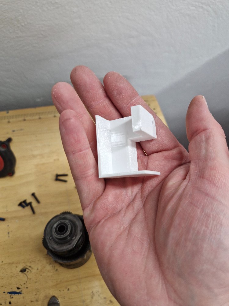

Custom white PETG internal corner caps for 50x50 trunking to go in at high level in my garage
Slight curved edges on the outside means they fit with no need to fix.
Ill be making my own external corners and end caps too. The electrical place was closed on Friday (they werent supposed to be!) But doesnt matter when you can make your own and probably alot cheaper too.

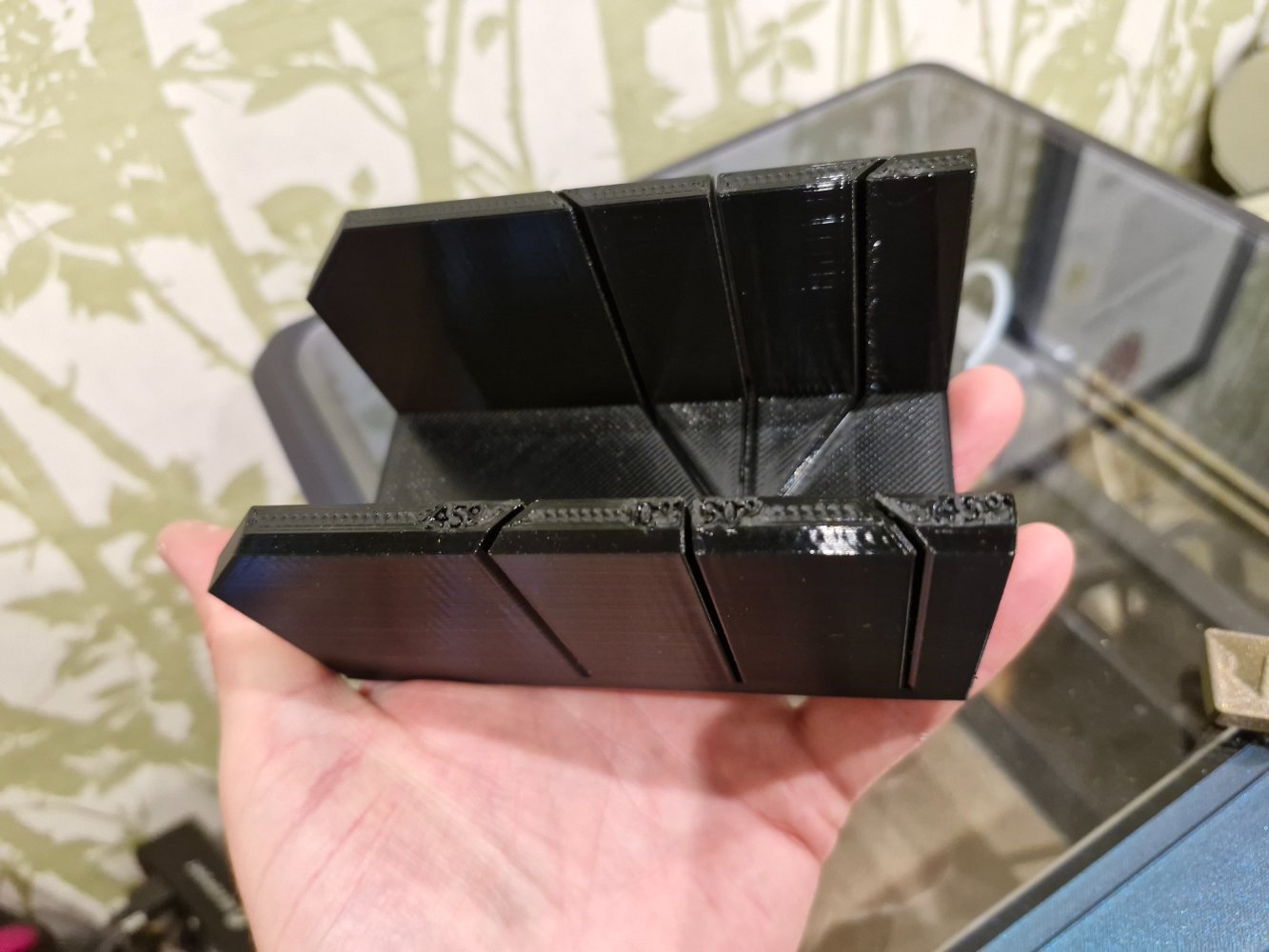

Plus a small mitre box from black petg for cutting said pvc trunking
(From online .stl file which I modified size wise to suit)

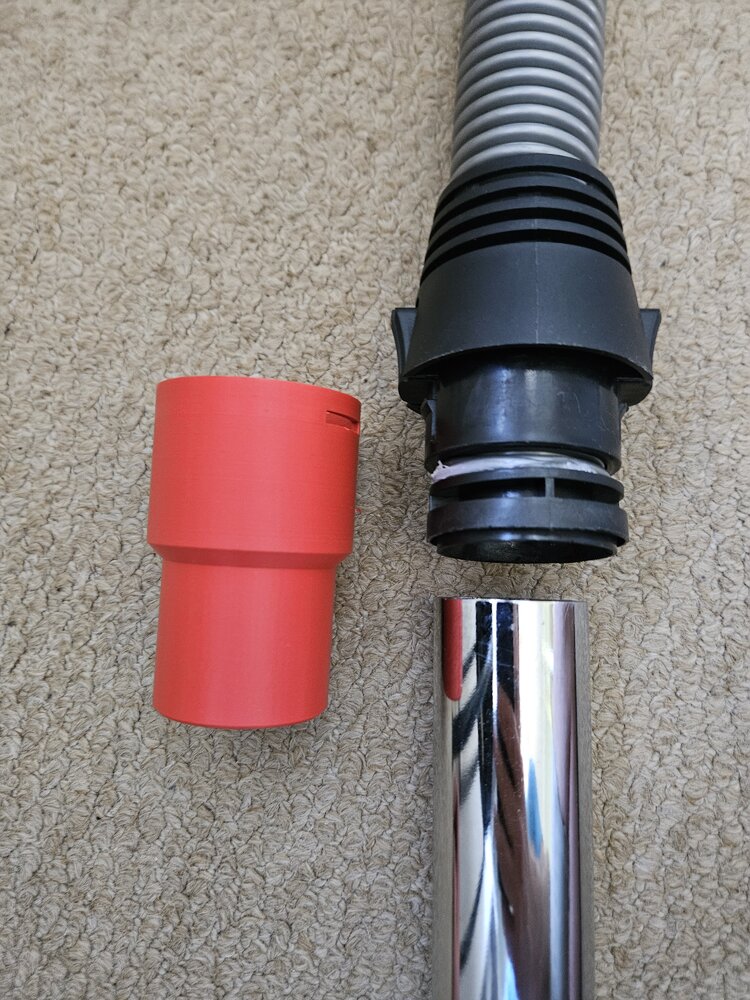

Little adapter for friends industrial vacuum cleaner, metal handle is push fit into a shallow taper and hose side is fiction fit with the locking tabs

Can you post the dimensions of the adapter for I suspect that like me several guys want an adaptor to put on to various machinery and use it to put the vacuum suction tube in ( I have a TITAN saw bench that needs an adaptor making or buying. )
