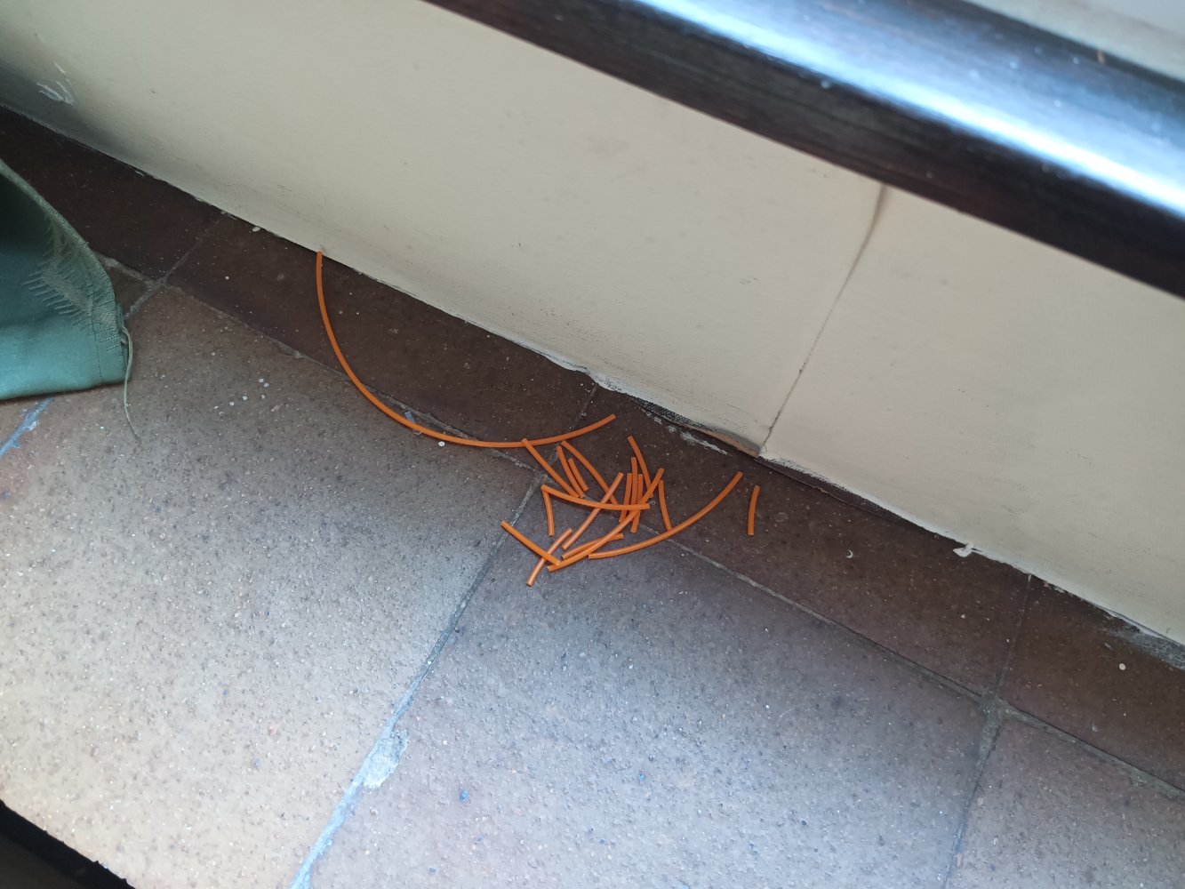

Today, mine has made me despair.
T'would appear one of my older rolls of PLA had turned brittle. Bar the hotend/printhead, I've had to fish bits of broken filament from most sections. These are just some of the ........ fragments.
Damp filament is the cause of that.
Do you vacuum seal your spools in storage? Do you have a mains powered filament drier?The remainder of that roll's been binned now. The others will be checked with an "if they snap if I bend it" test before they go anywhere near the printer.

@MattF - don't despair. IMHO PLA doesn't absorb moisture like PETG and therefore doesn't need the drying out process. I've got numerous rolls of PLA which are pretty old and brittle but they still get used and print beautifully.
Strictly speaking, you don't need a "proper drier". Yes, it's a good idea to have a means of drying, but that could be a domestic oven or, if your printer has an enclosure then you might get away with just bunging the reel in the enclosure and turning the bed on.Anyone with a 3D printer needs to have a proper drier and vacuum storage bags.
I bought a "proper" drier (i.e. a drying box designed for drying filament) but it only goes to 50°C and that doesn't seem enough for PETG (most things I've read have recommended 60°C) and I've never had great results with the drier so I tend to wait until two or three reels need doing and then bung them in the kitchen oven.
Driers are relatively inexpensive I have a Creality single spool item that cost £50 and has suitable temperatures for all filaments.
In the long run chucking spools, wasted prints etc will cost you more.
The AMS unit has a drier built in. I do also have a standalone drier. Plus vacuum bags. That roll of PLA was simply several years old. It's gone in the bin.
