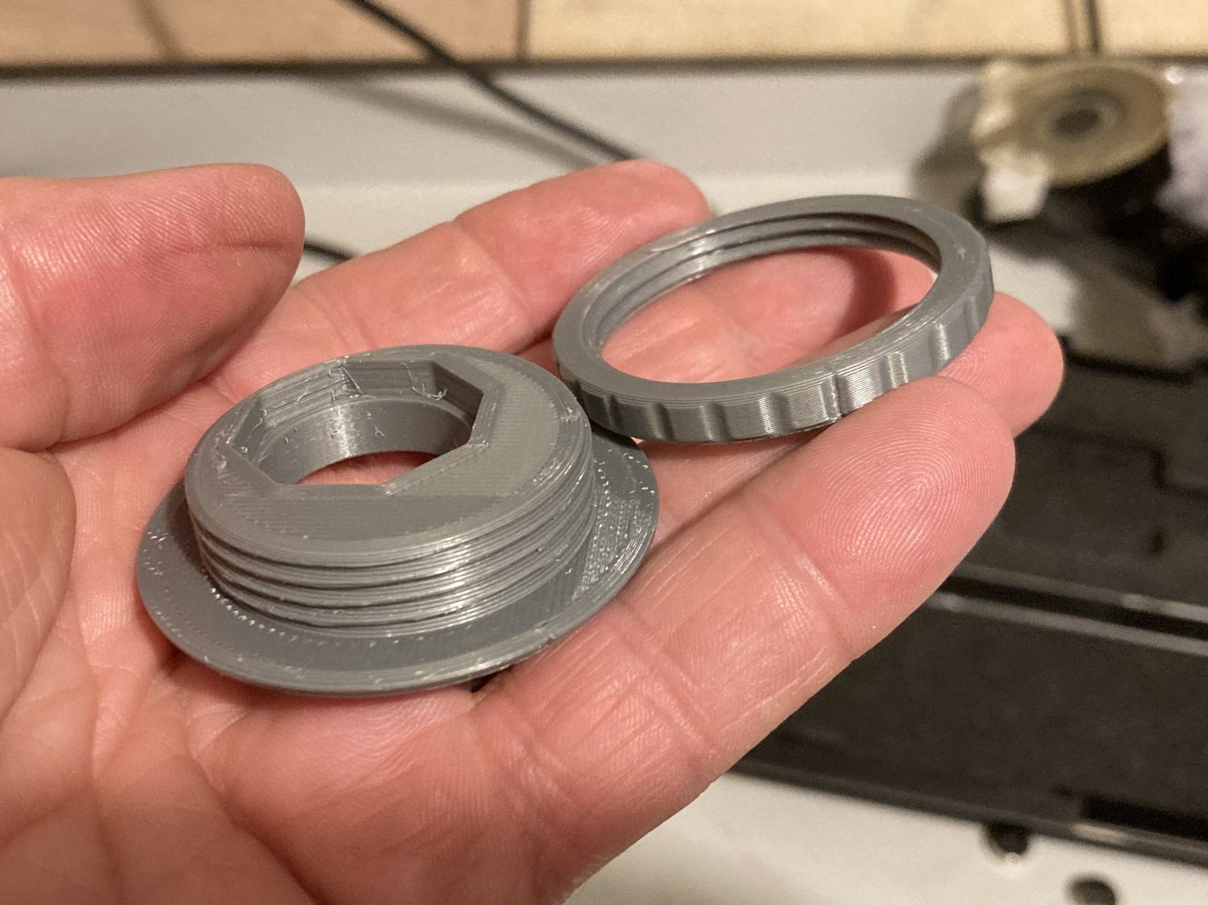

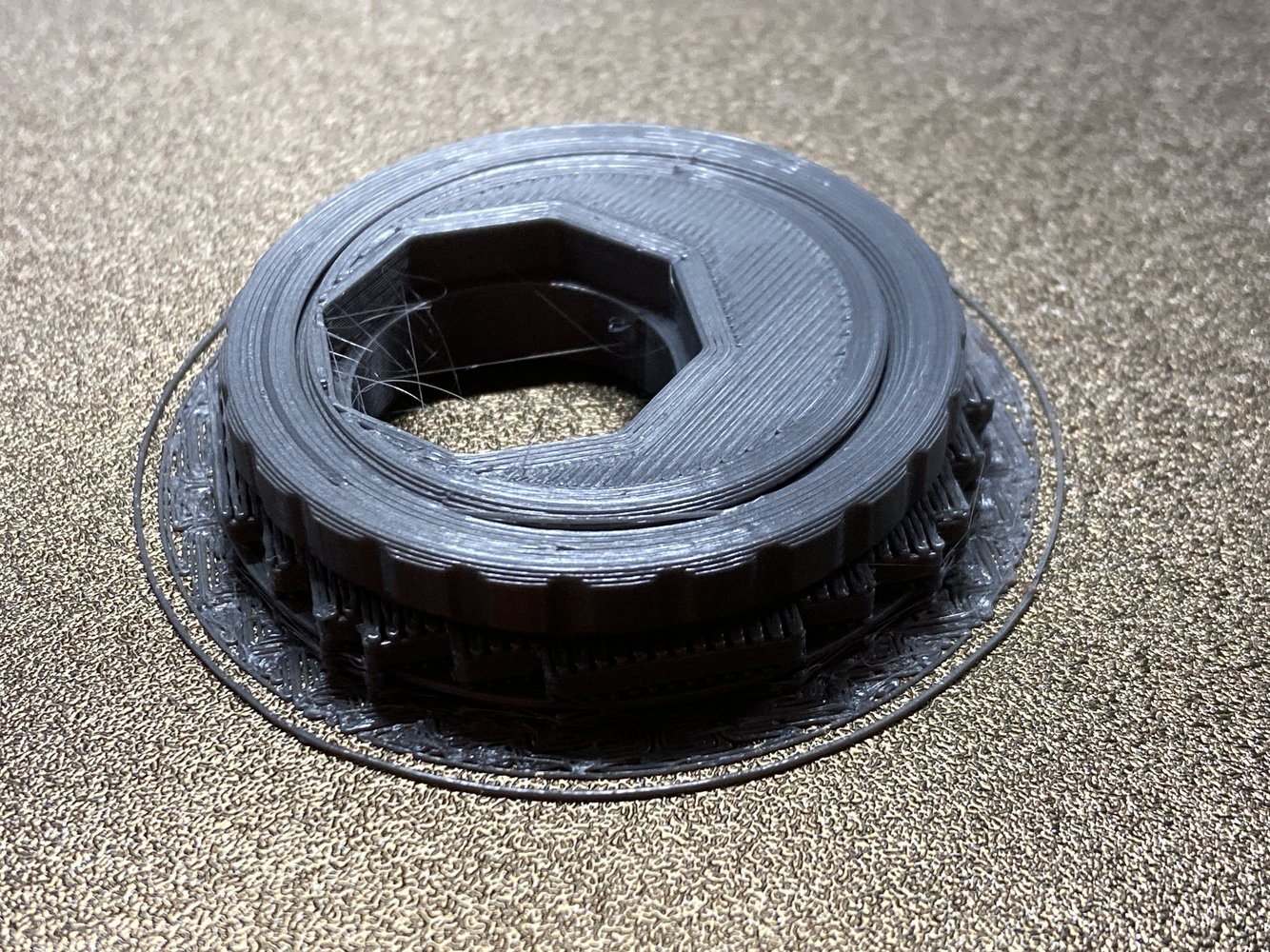

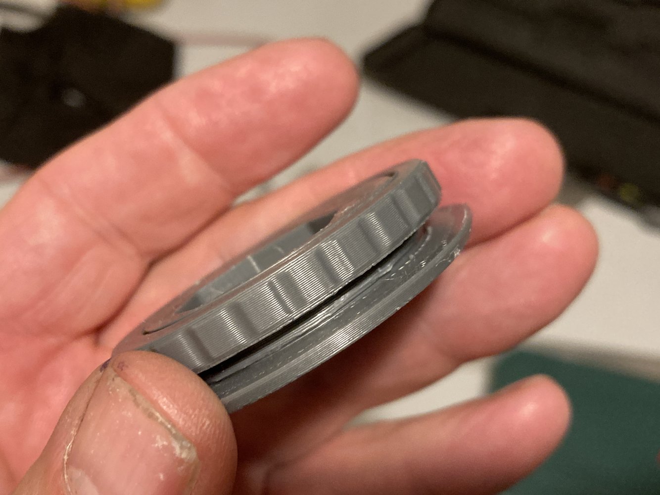

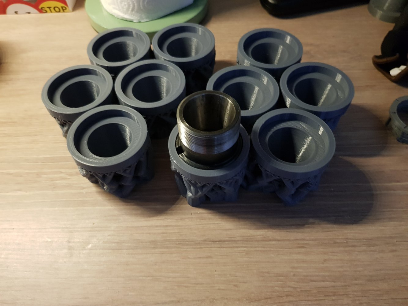

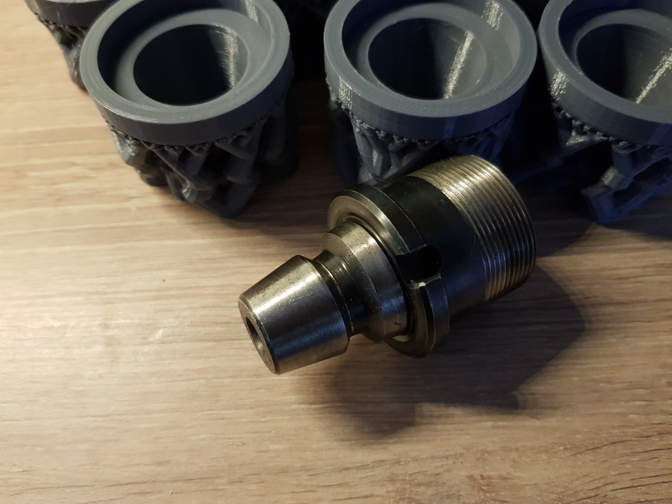

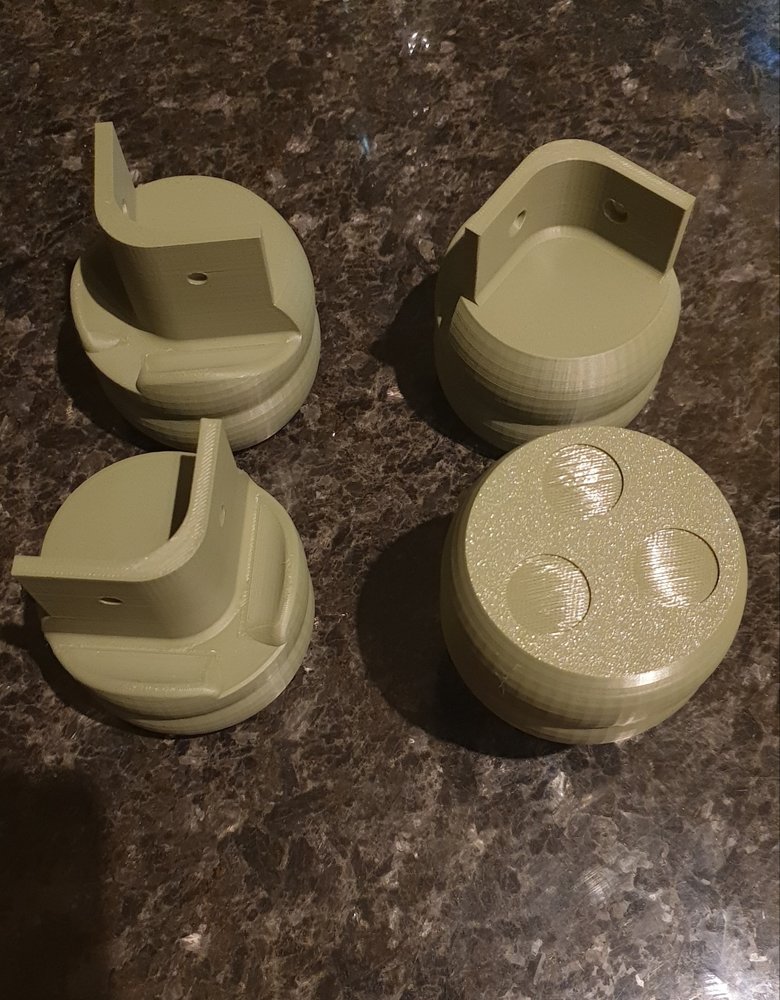

Printed that orientation for a smooth internal face? Might have been quicker flipping it and using pla/petg/pla interface or sharpie pen interface trick?Making a storage unit for my Easychange tooling but didn't like the rubber grommets' they had before so a few lucky measurements knocked these up got 23 to print so doing in batches
They are threaded underneath and got to print out the nuts next but very pleased with the fit
View attachment 486396View attachment 486397
Yeah i should have flipped it really , originally they had a solid bottom so made sense to do it this way but agreed there was a better wayPrinted that orientation for a smooth internal face? Might have been quicker flipping it and using pla/petg/pla interface or sharpie pen interface trick?
EnjoyYeah i should have flipped it really , originally they had a solid bottom so made sense to do it this way but agreed there was a better way
whats the sharpie trick ?

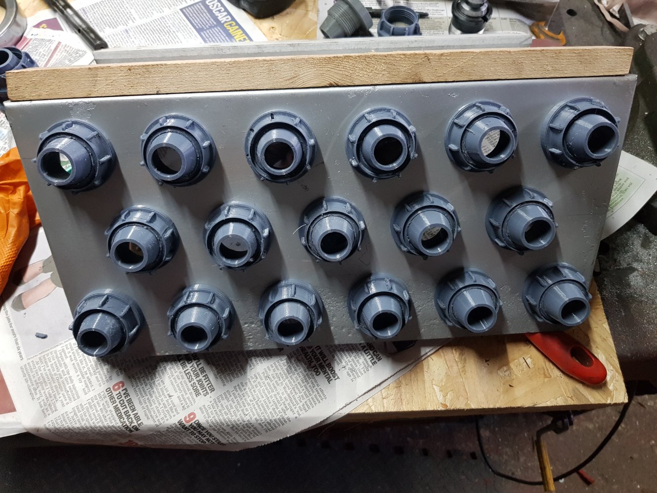

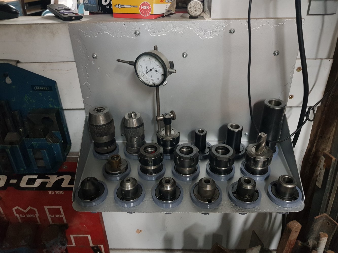

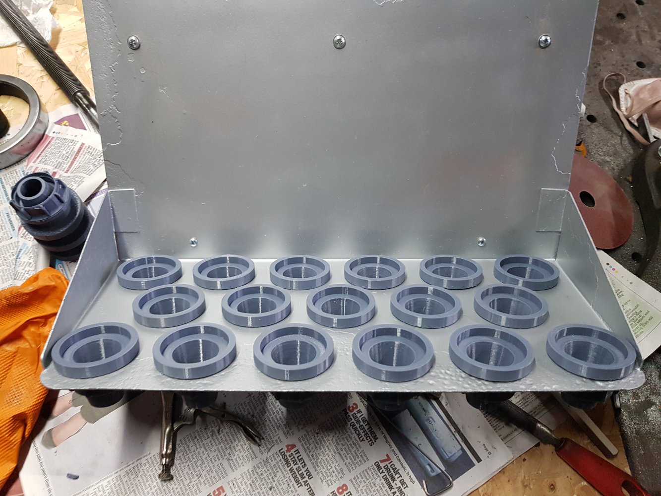

Finally finished my Easychange collet holder for the Bridgeport
Now it is done, consider the benefits from a debris-collection point of view of turning everything upside down. Or print some hats for everything.
All the ER holders have a decreasing taper the way they are shown, so anything that falls in will collect. With the Easychange taper, if that is uppermost, it is an increasing taper, so will shed anything that falls onto it.

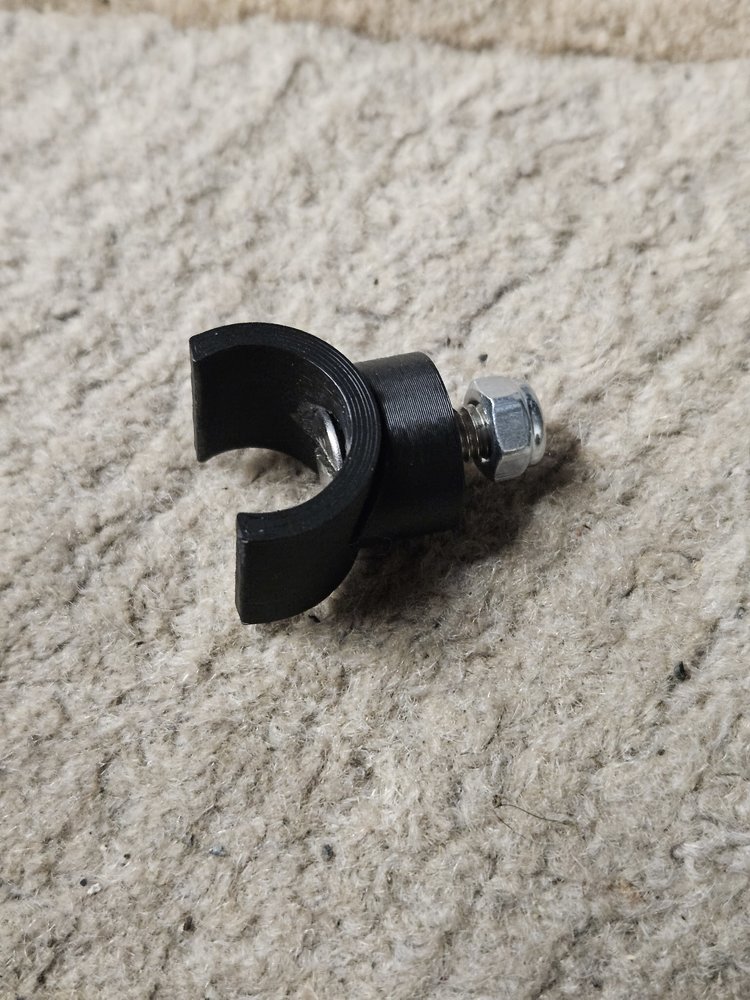

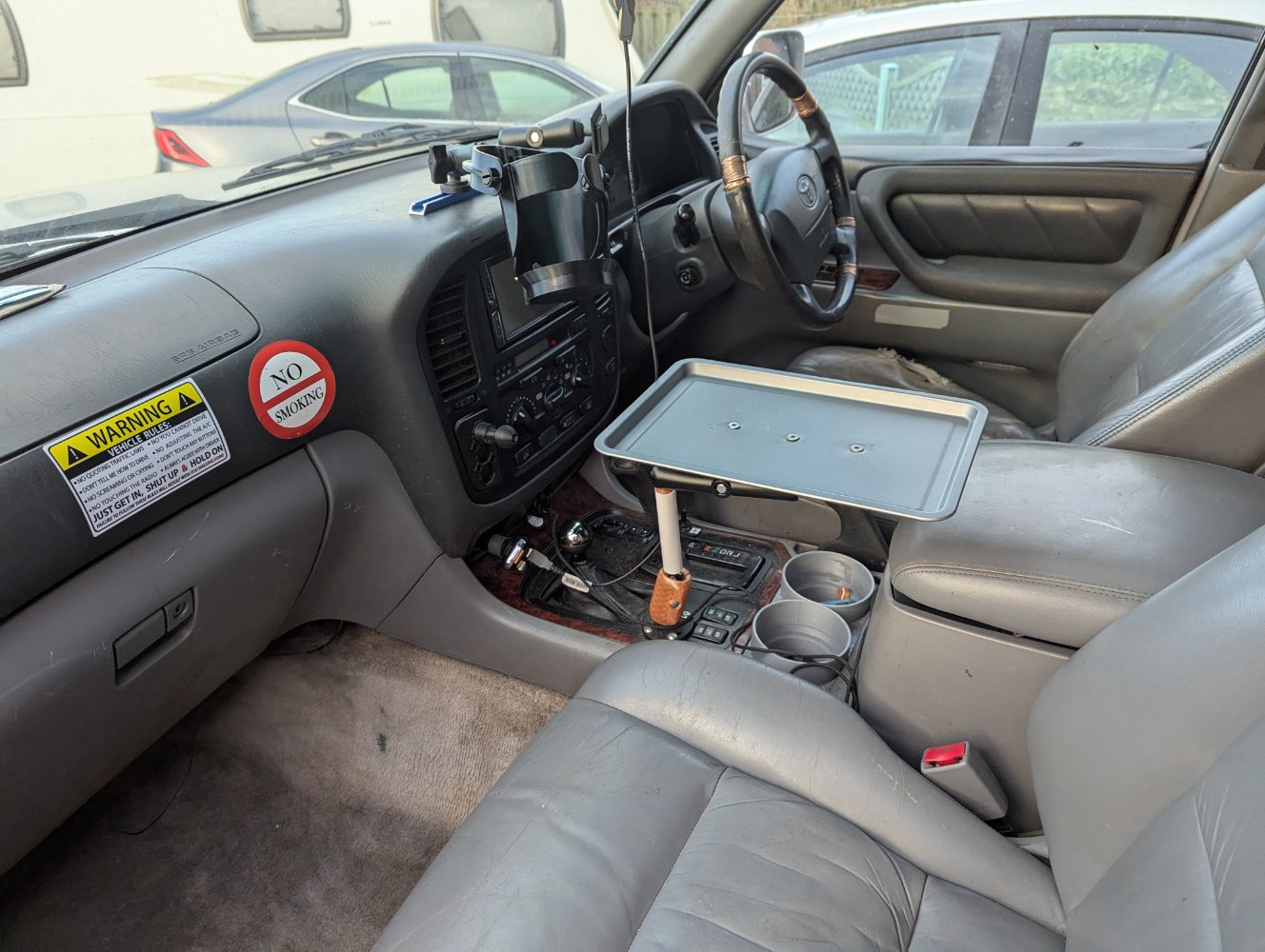

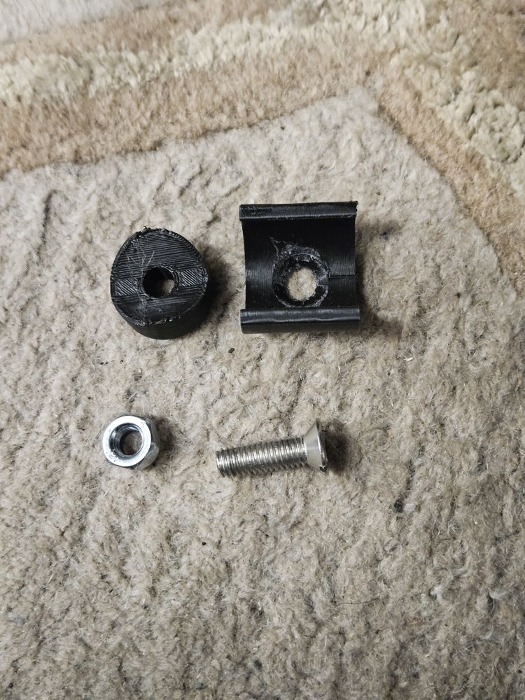

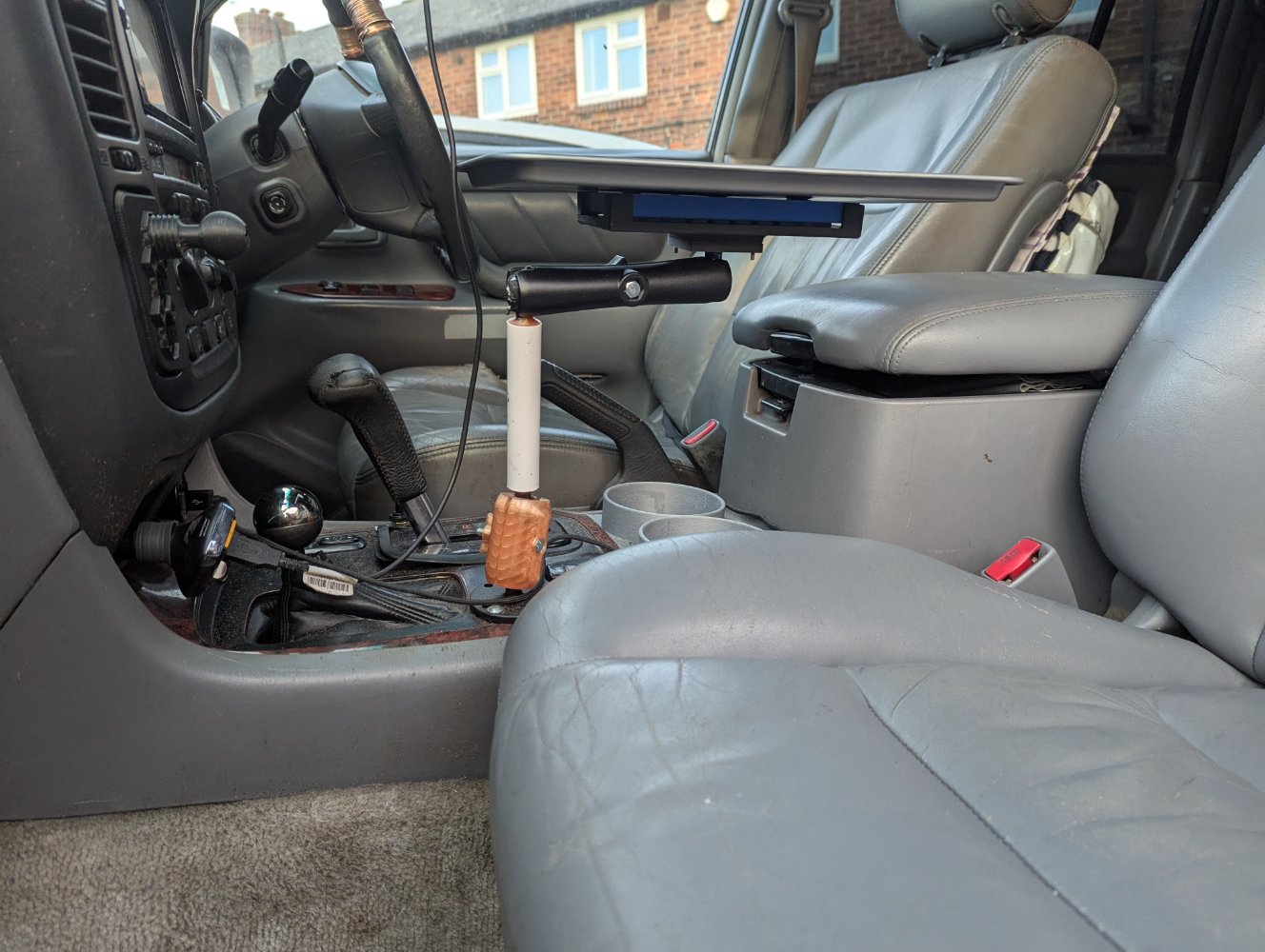

Sandwich/lunch tray.
Mounts to (one of) the phone mounts.
The arm is a RAM style 1in ball system.
Screws into the fascia, then a home-designed socket (the brown one)>
An arm made from 20mm conduit + home-designed clamped-in ball ends>
A long Temu supplied alloy socket>
then the phone mount.
All printed in PETG.
View attachment 487295View attachment 487296
