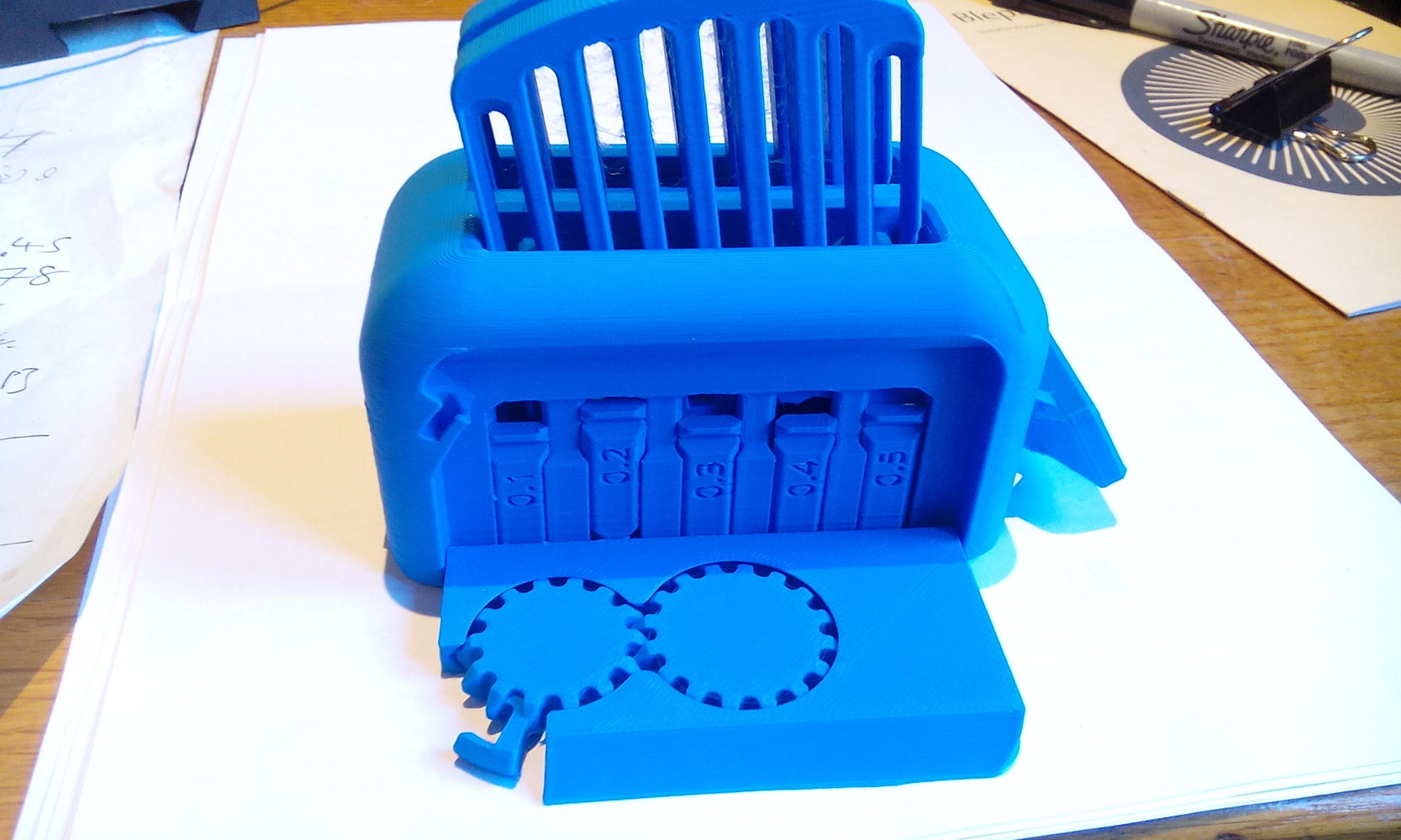

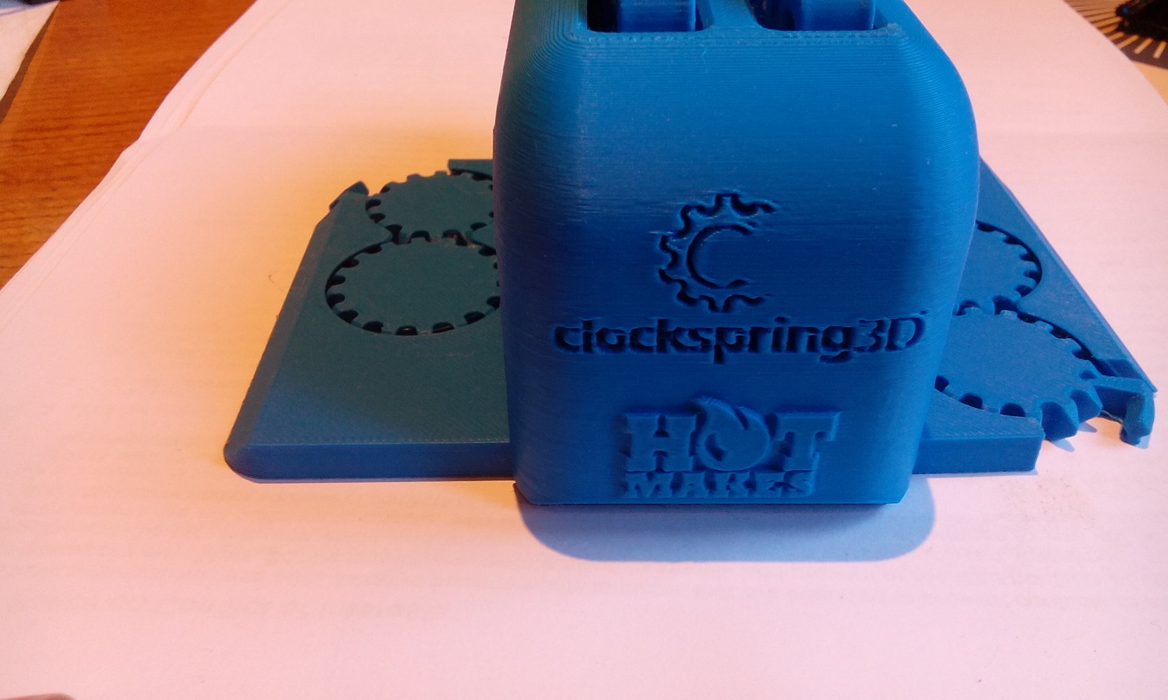

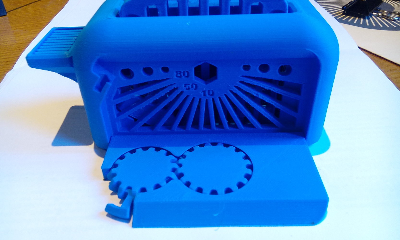

Not seen that file before..Well finally got Orca and Creality splicer working, wanted to give the K2 a proper workout so have printed the Clock spring torture toaster.
Spliced it in Orca, took just under 6hrs to print with a 0.16mm layer height. Probably could have used a .2mm
Over all its pretty good, the gears all work nicely and the apart from the 0.1mm slider the rest were easy to get moving.
For an out-of-the-box printer with no fine-tuning, its bloody impressive.
few little niggles,
First layer was a bit generous and took ages to weed out.
The 80 deg and 70 deg arms have a bit of distortion.
there is a small layer shift line on one corner.
View attachment 483795View attachment 483796View attachment 483797

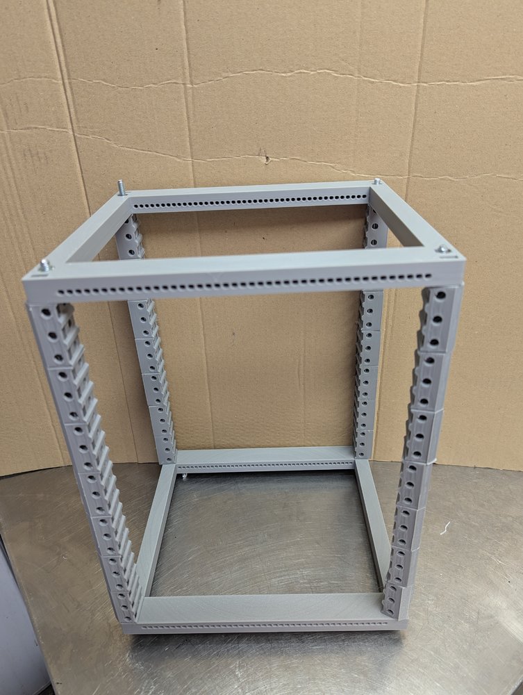

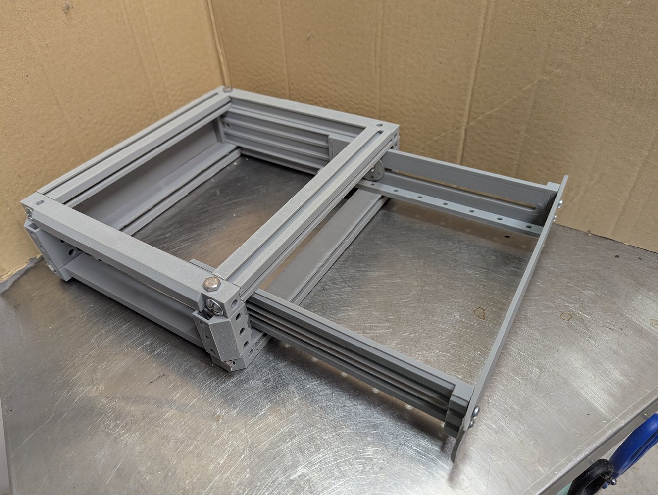

Slowly coming together, one bit at a time.
Now if those can handle a 10 kg load each and are stackable to six high you have a winner
