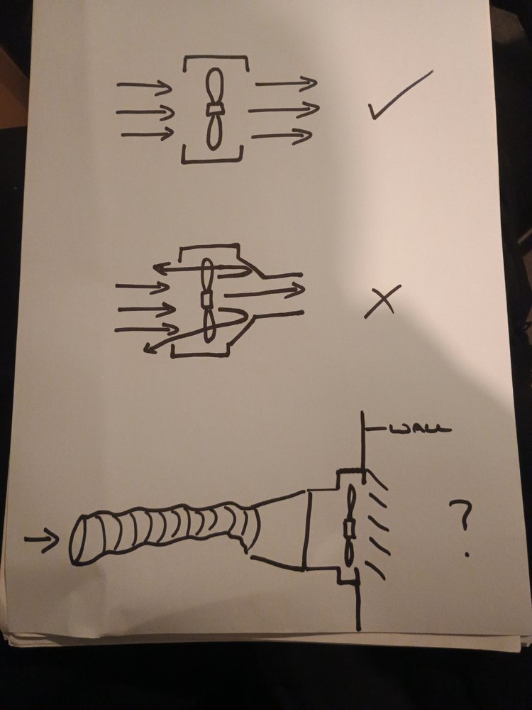

Any suggestions? Bigger duct I guess
Make of this what you will:
For HVAC ducting, there is some guidance, DW144 (copy here http://metalproduct.vn/uploads/source/tieu chuan/dw-144.pdf)
Fig. 98 on page 61 of the pdf (59 printed page) suggests that the included angle for reducing should be between 15 and 60 degrees (your current included angle is 90 degrees - which is OK for expanding). On rectangular ducting, they suggest (Para 10.6 page 41) 22.5 degree half angle which is in the same range.
The proportions of these might be a good starting point:
