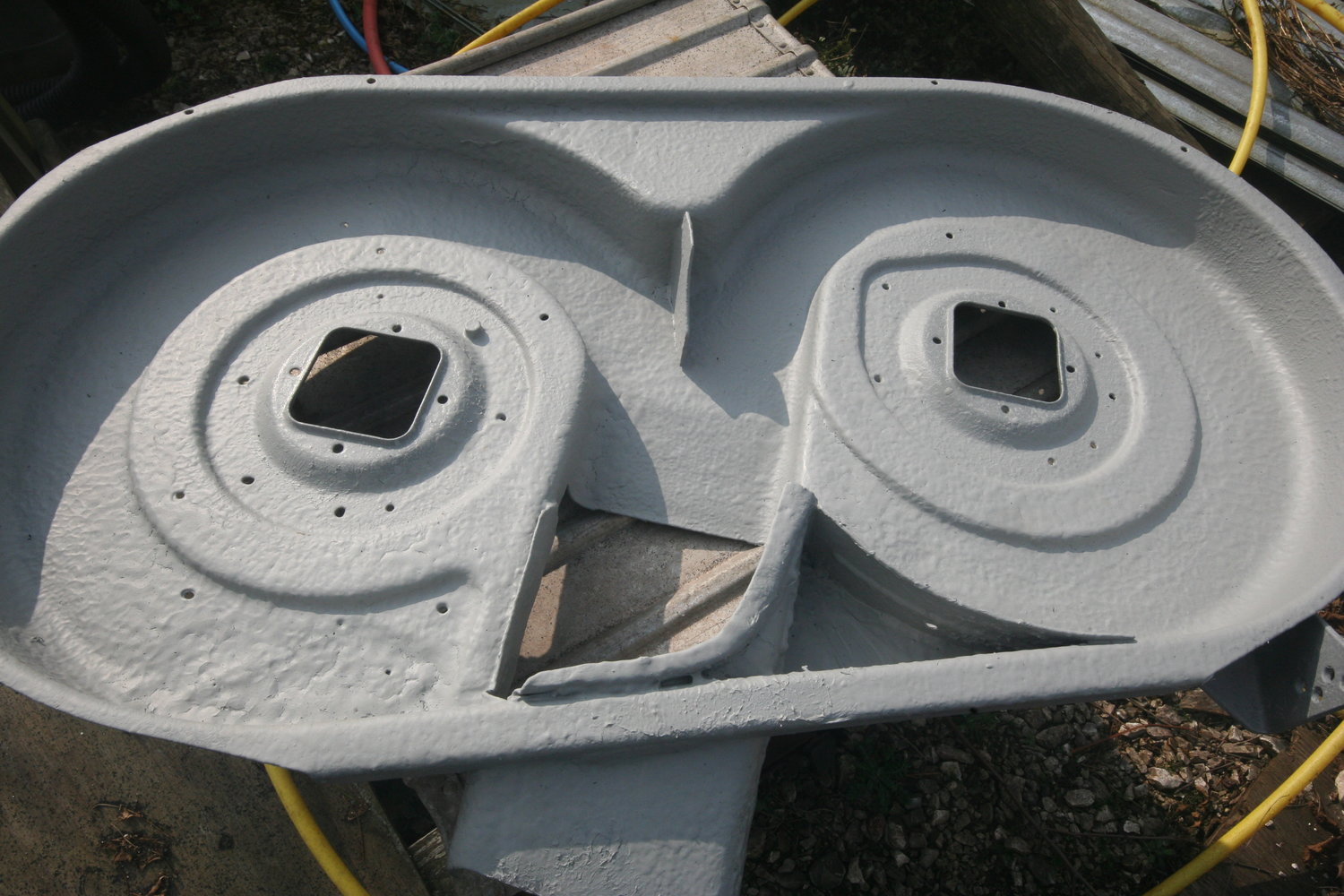

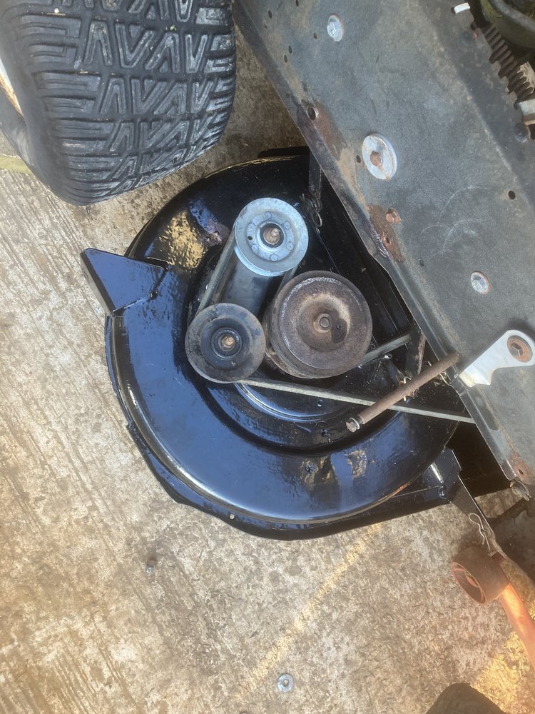

Got a second coat of primer on the mower deck tonight.
This is Jotun 90A again but with some straight 90 that had been tinted to give it a darker shade, which helps to make sure I get full coverage on the second coat.
I used a cheap gravity gun with a 2.5mm fluid tip set up and about 15% thinner added.
Needed 3/4 litre of mixed paint to get full coverage this time.
