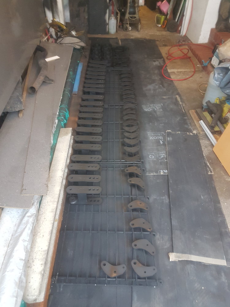

I'd use zinc under everythingAm I just being stupid? For some reason I thought you couldn't use waterbased on top of solvent based, but just been reading an article that says you should use solvent primer under water topcoat for outdoors water resistance?

I would have thought an epoxy would suit all of your needs. The Selemix 7-413 is like an epoxy mastic straight out of the tin but can be thinned down with up to 40% thinners if you want a better finish straight from the gun. You can also apply it with airless kit if you want and it's recommended for wet on wet process, but not if you are putting a waterbased paint over it.
Only slight downside is it needs reasonable prep (like most primers) the Jotun epoxy mastics (and similar) are more forgiving in that respect so it's horses for courses.
Lots of other options in epoxies but the Selemix is hard to beat for the money. (the extra thinning gives a lot of paint per litre)
If I was putting any water based paint over any primer I'd let it cure and give it a sand to be sure of good adhesion, unless there is a system that the paint manufacturer recommends.

So if i wanted to use epoxy primers I have two options as I see it:If you don’t want to sand do an adhesion test.
Doesn’t need to be complicated.
Make up a puck (could be a bolt with the markings sanded off) and use araldite to stick it to the cured top coat.
You could do a test with wet on wet, primer cured but not sanded and primer cured and sanded.
Let the araldite fully cure and use a lever to pull the puck perpendicular to the surface (try not to twist it)
If the top coat comes off the primer you will know that is the weak spot, if the primer comes off the steel that would tell you you’re prep isn’t good enough.
My guess is the cured and sanded would be best, followed by the wet on wet then the cured and not sanded.
If the three samples are similar, don't bother sanding.
The proper test kit uses hydraulic pressure so gives a reading, but knowing the weak spot is very useful.
My initial thing was, I want to have less overspray and use water base where possible. I also want to get away from etch primer, the overspray gets everywhere.
