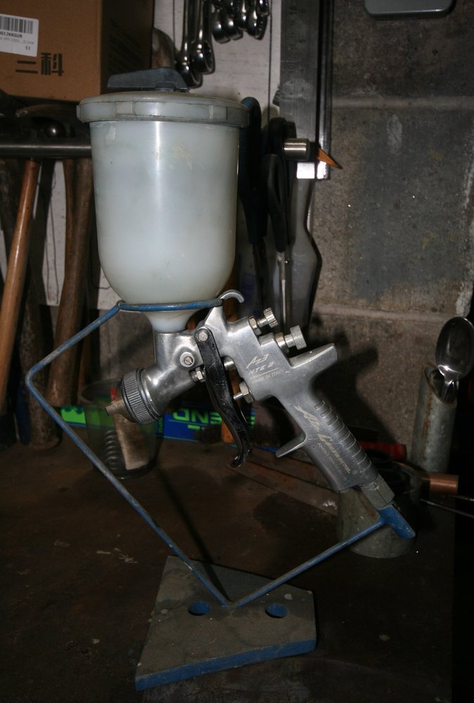

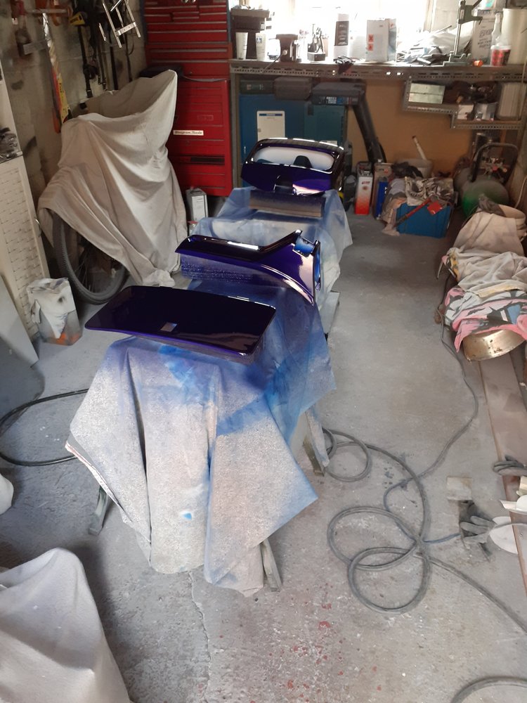

Gun used was an Iwata AZ3 with a 1.5 fluid tip
I'm looking for a good steel paint, what sort of money is that?I love this paint so much. Water based, sprays easily, very forgiving and self flattens to perfection.
View attachment 314493 View attachment 314494 View attachment 314495

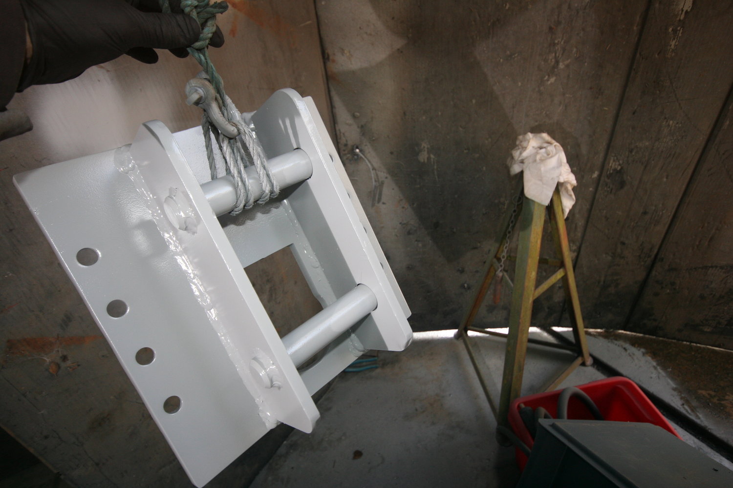

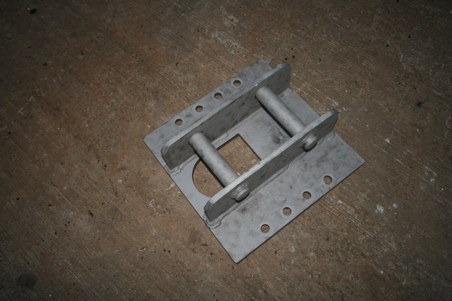

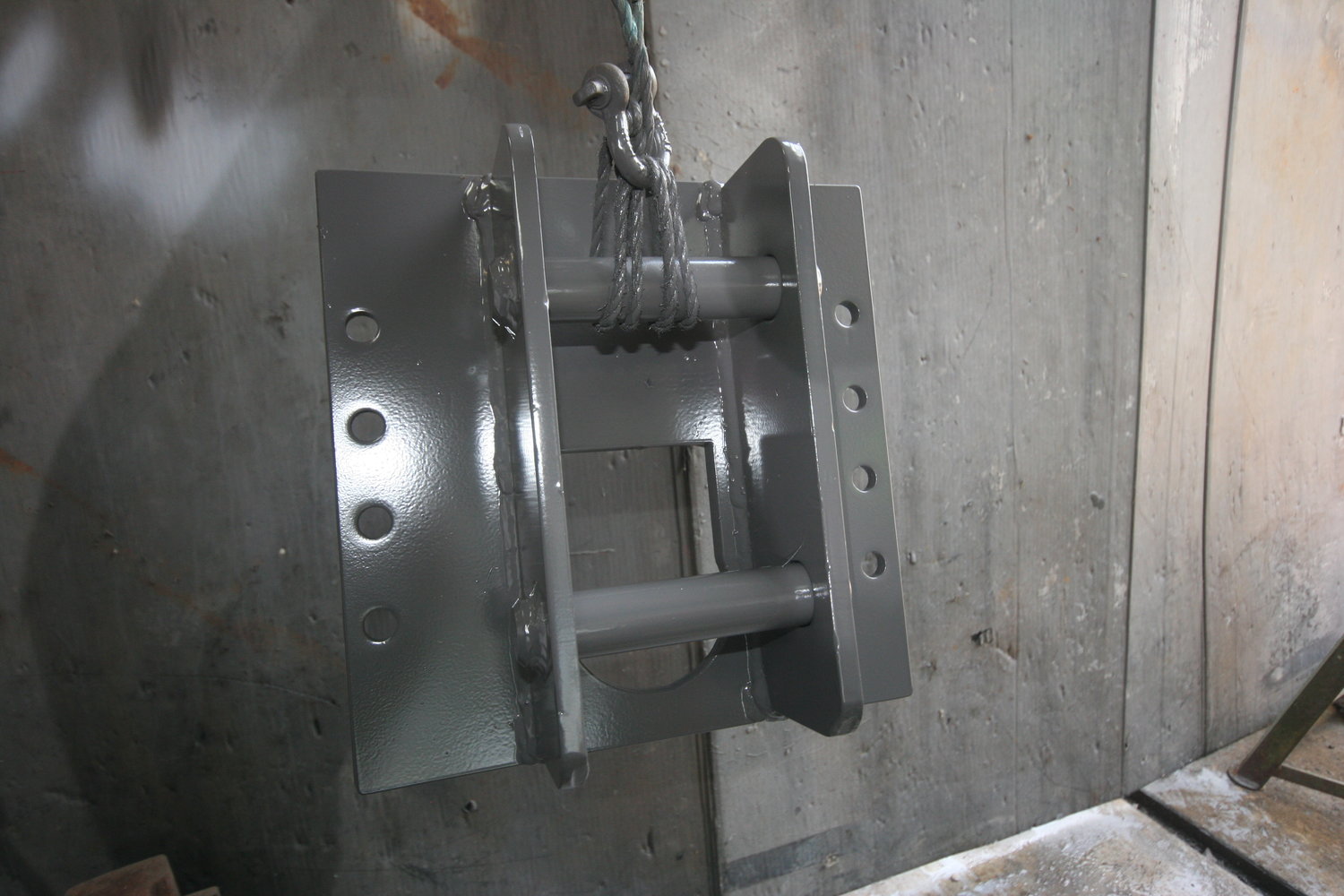

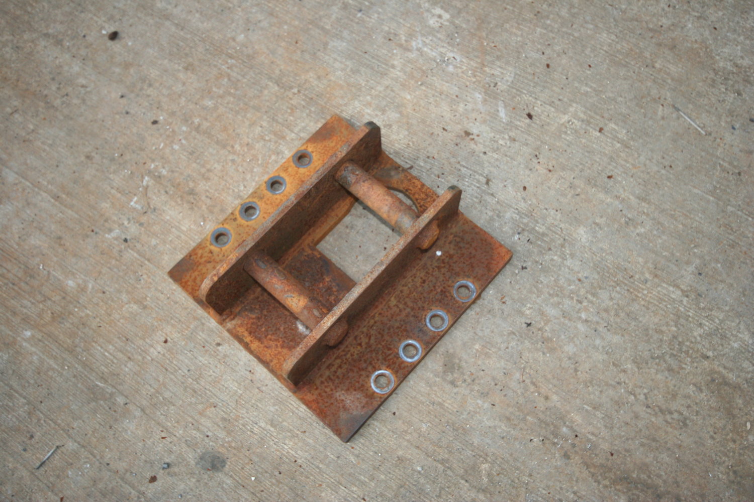

can i spray the jotun epoxy primer like thatNot today, but I painted this rusty quick hitch for a grab on a mini-digger at the weekend.
Quick blast
Then two coats of Selemix 7-413 epoxy primer.

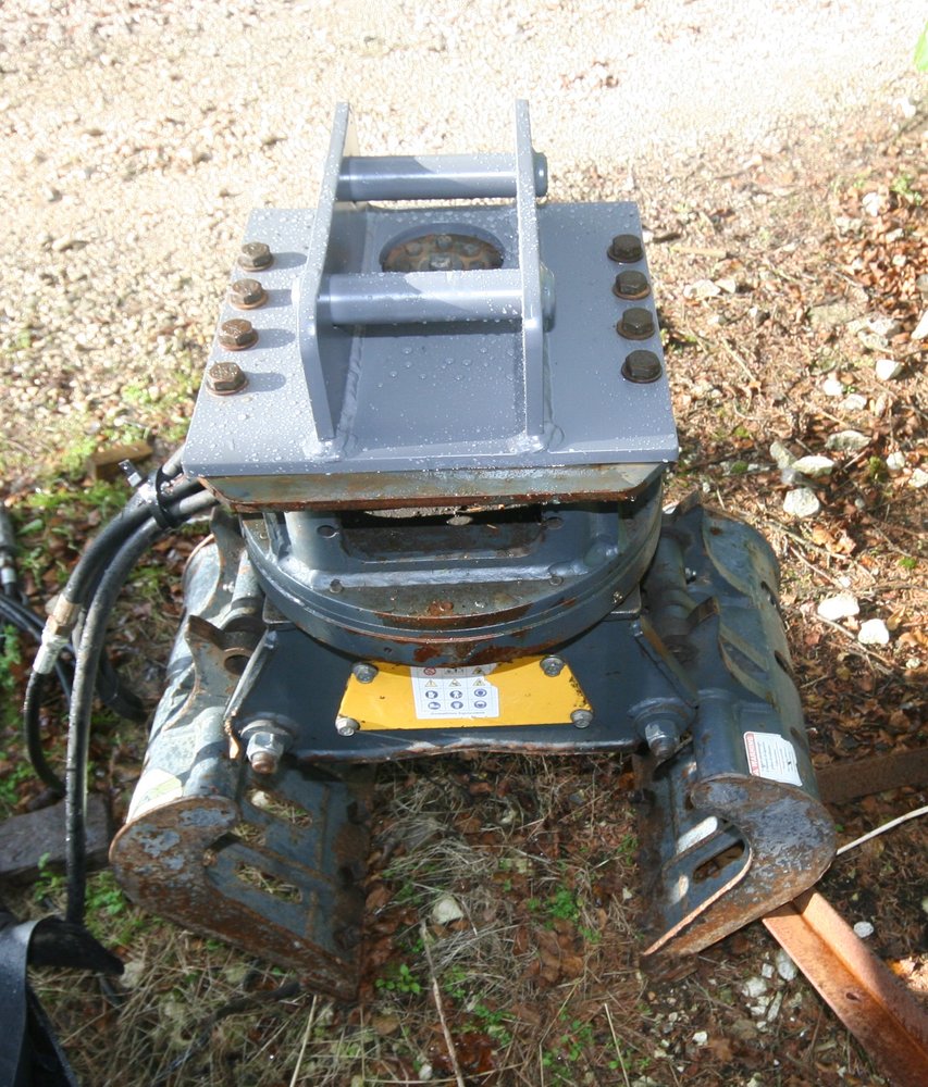

Followed, wet on wet, by three coats of PPG Delfleet 2K topcoat in matte gray, two coats would have been fine, but I mixed too much so put it on anyway.
Back on the grab
FInish is nothing special but fine for what it's for.
Yes, if you overthin it or heat it to make it thinner.can i spray the jotun epoxy primer like that

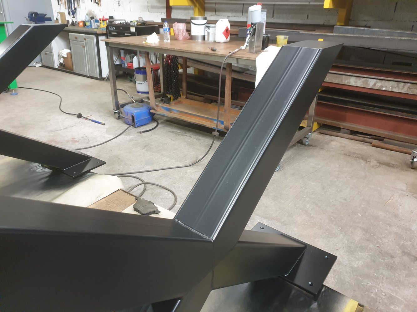

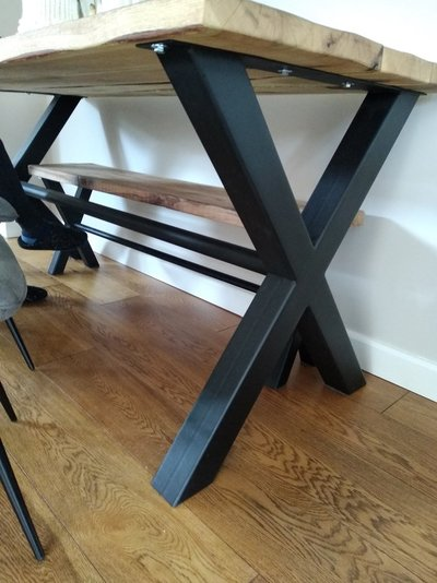

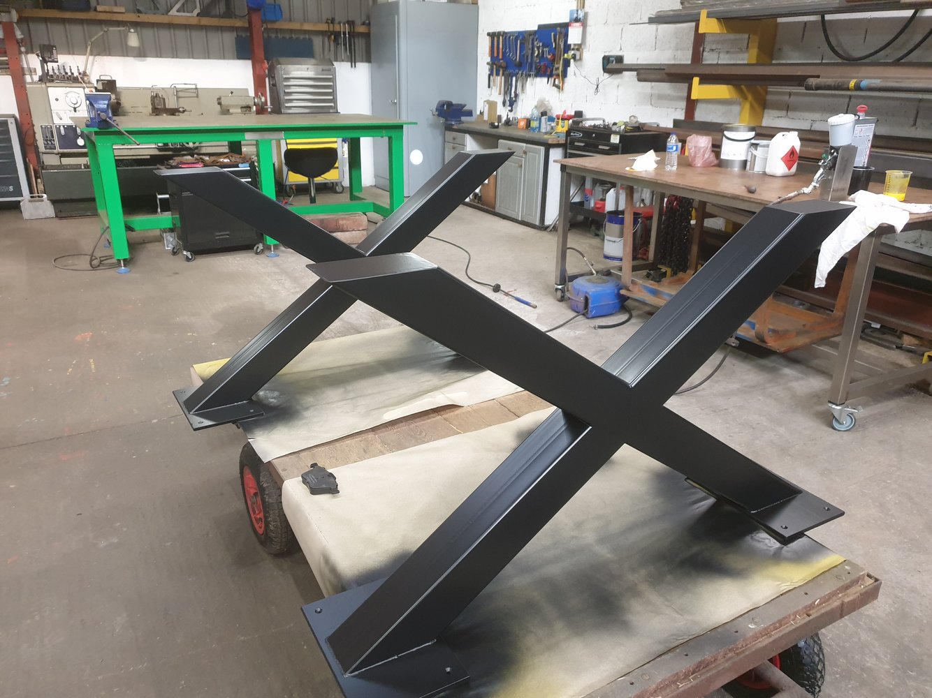

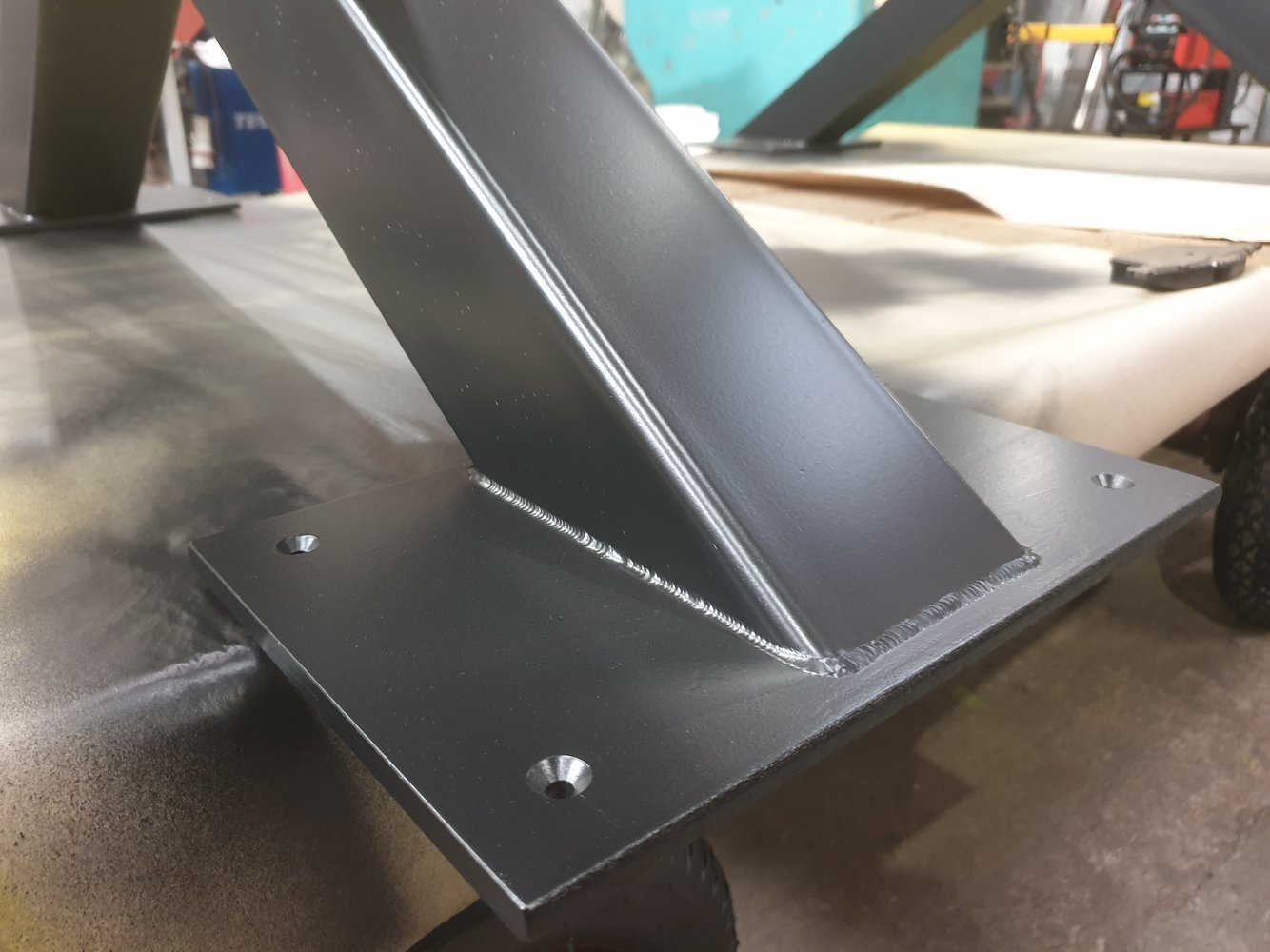

I've made a couple of tables. One similar to this one with the X leg design.
I used Manor Coatings high build vinyl. Satin black. It was recommended to me on this forum by several members. Sprayed on, direct to metal, no primer, thinned with cheap celly thinners. Seems to have lasted well, good satin finish etc.
