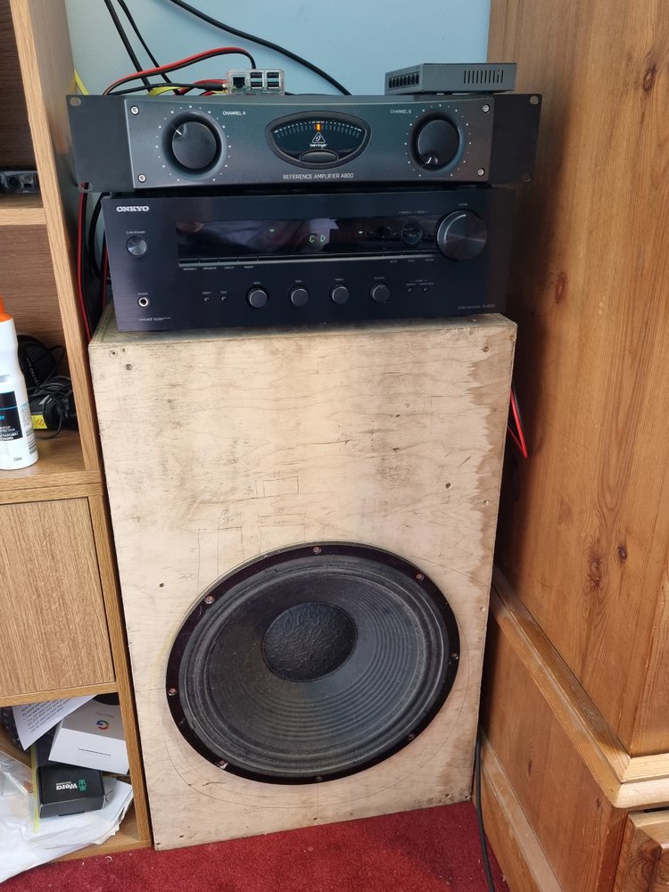

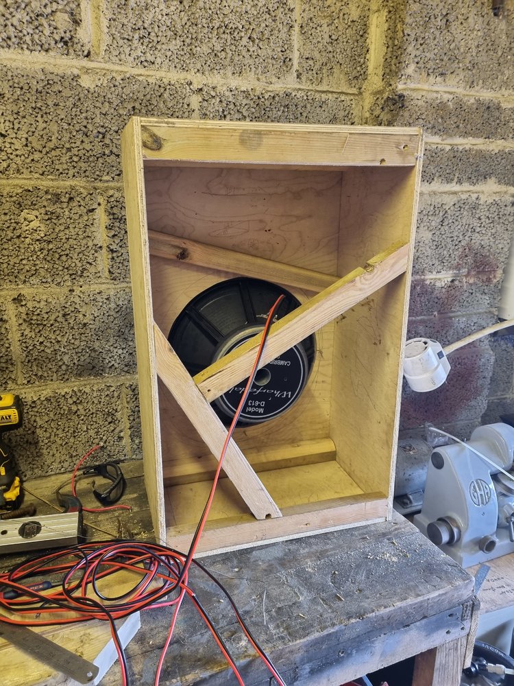

I made a very stiff wooden box.
It's a 15 inch Wharfedale driver, had it nearly three years. Finally found a sheet of ply and an amp with a subwoofer pre-out so that was my round tuit.
Don't have any specs for the driver, couldn't measure anything particularly useful and Wharfedale wouldn't tell me so rather than risk a ported enclosure sounding like crap, it's sealed with the internal dimensions all the golden ratio of each other (That's is, it's 1.618 times wider than it is deep and 1.618 times taller than it is wide, on the inside at least), it's supposed to reduce harmonics or something. The volume is very close to that of thr enclosure wharfedale used. Uneven bracing is supposed to help too...
Still needs some damping material inside, painting, ideally handles and a SpeakOn connector, and possibly a grille but I'll listen to it for a few weeks first I think.
