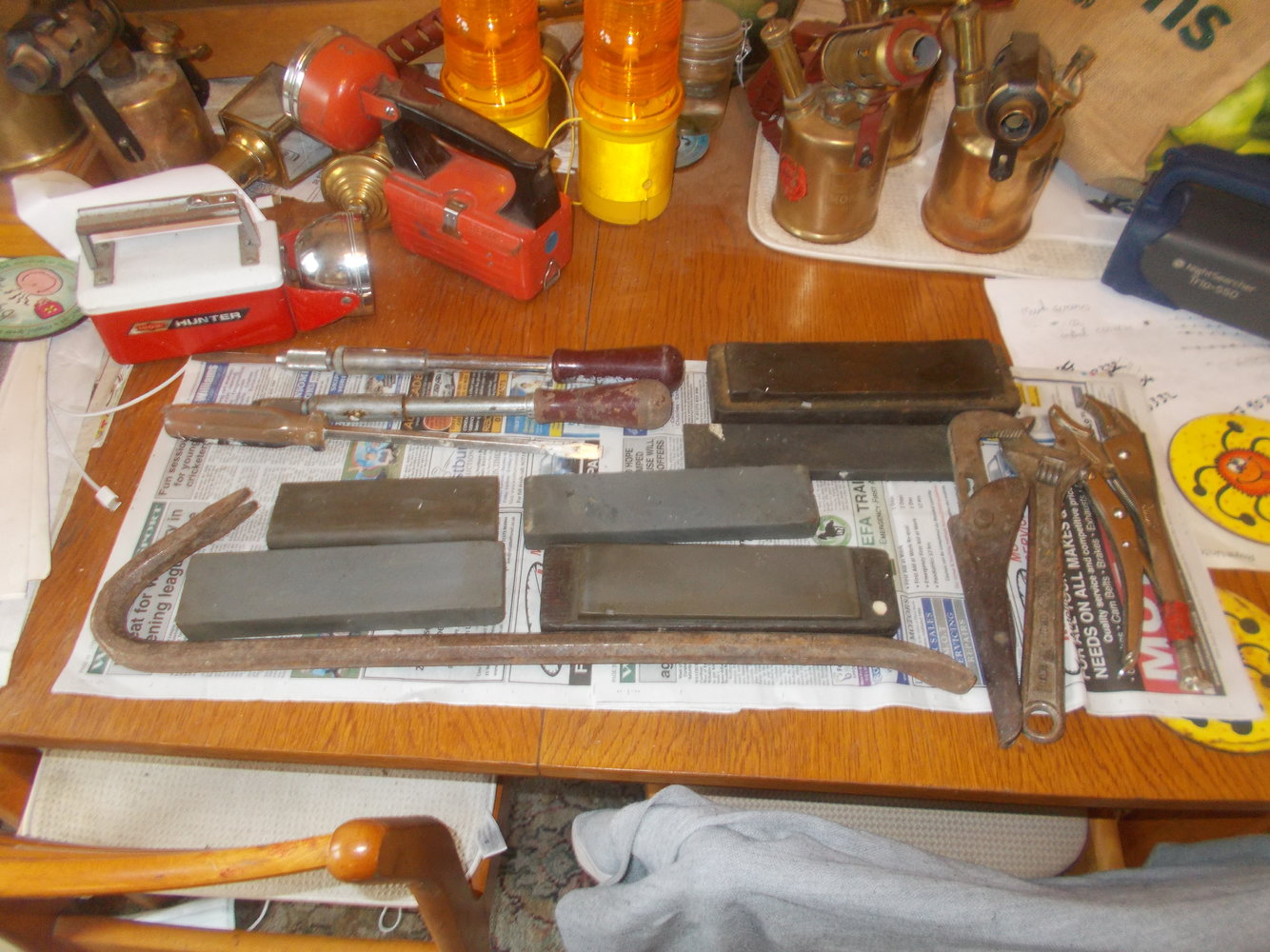

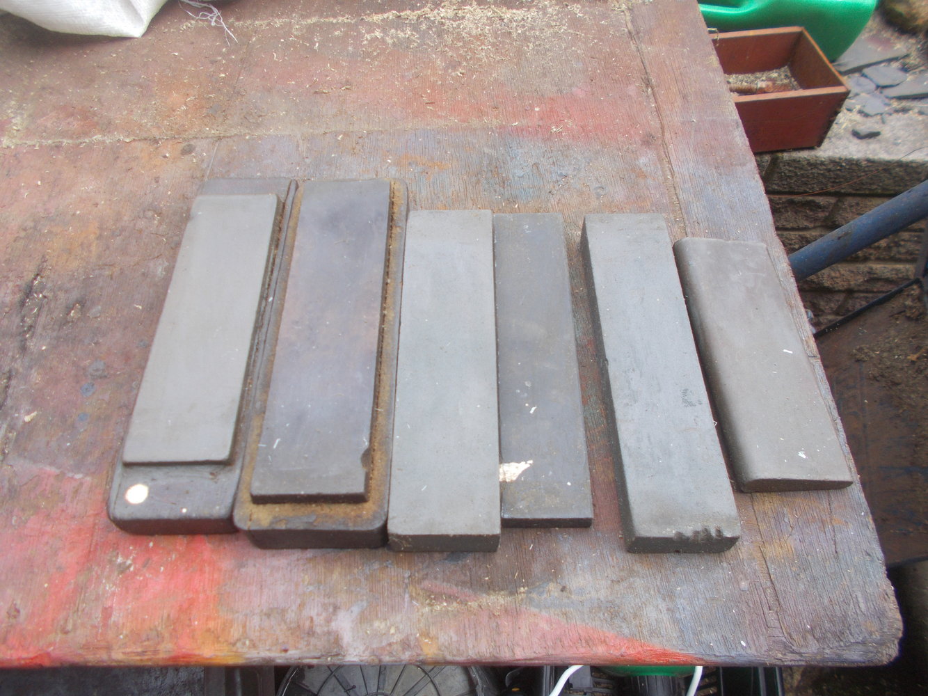

I've usually put 1/2 " of white spirit in a small tray & soaked the oil stone in it for 10 min or so then wiped the stone clean , done the other side then lightly oiled up with oil and a spray of WD 40 . Any cases got the white spirit treatment tooIn the picture below. Top LHS are two Stanley Yankee screwdrivers.

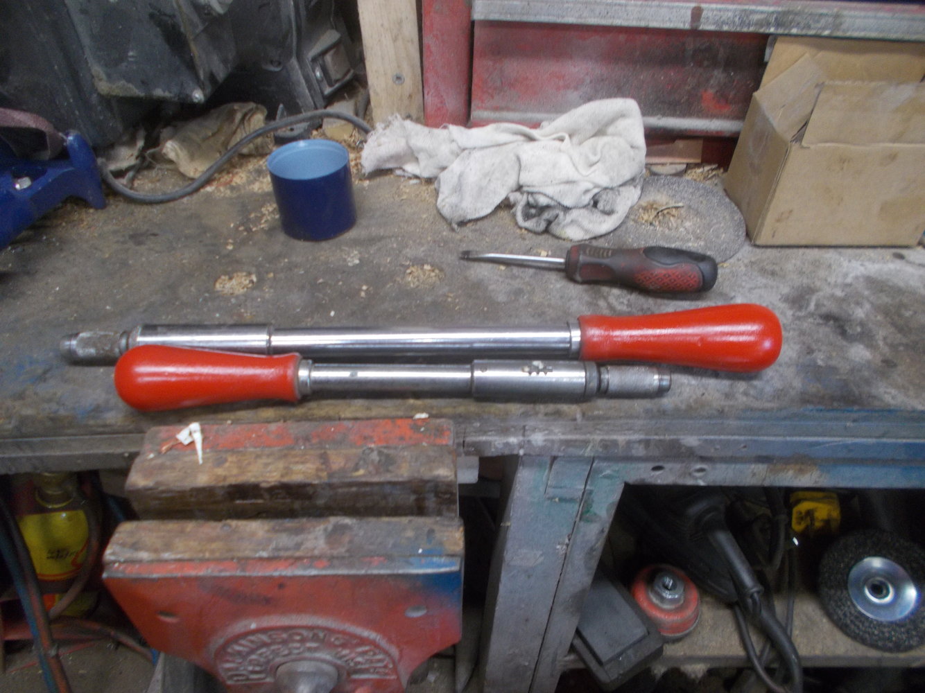

At first glance they looked ok.
The extended, they pumped.
But The bits were stuck fast. Turns out with glue.

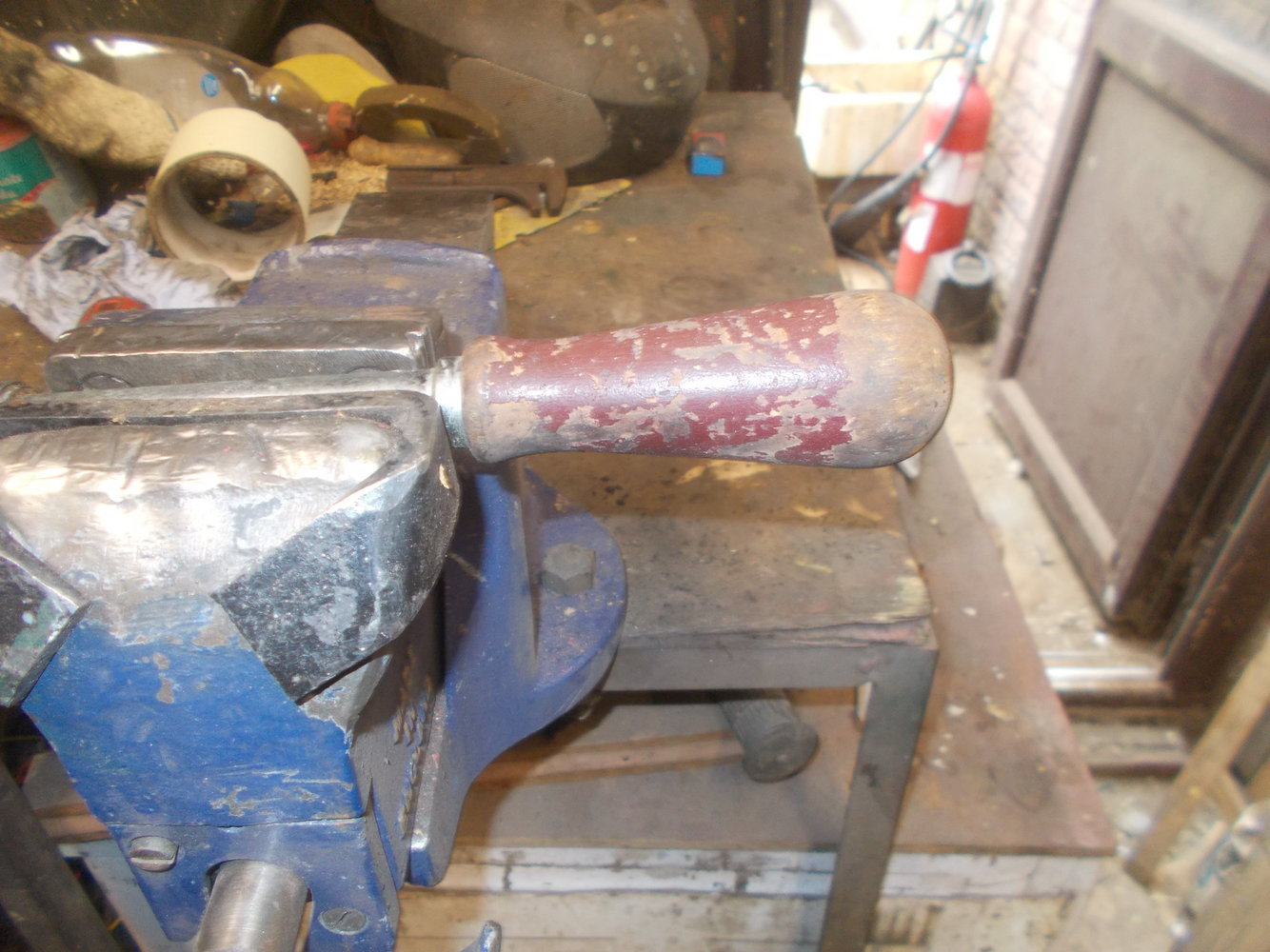

This handle was set up to be striped and cleaned, but what the picture does not show is the split, the filler and the staples.
The other handle was as bad.

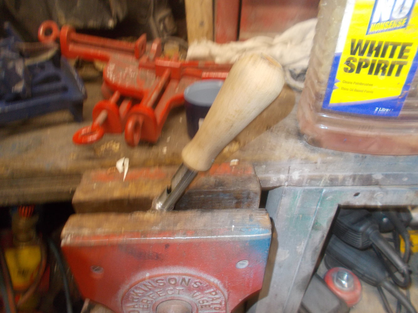

So, some beech, from a friends Fire wood pile was liberated. Turned down into new handles.
Test fitting here.
Fitted after paint.
2 more tools saved.
Everything in the top picture, bar one tool was restored.

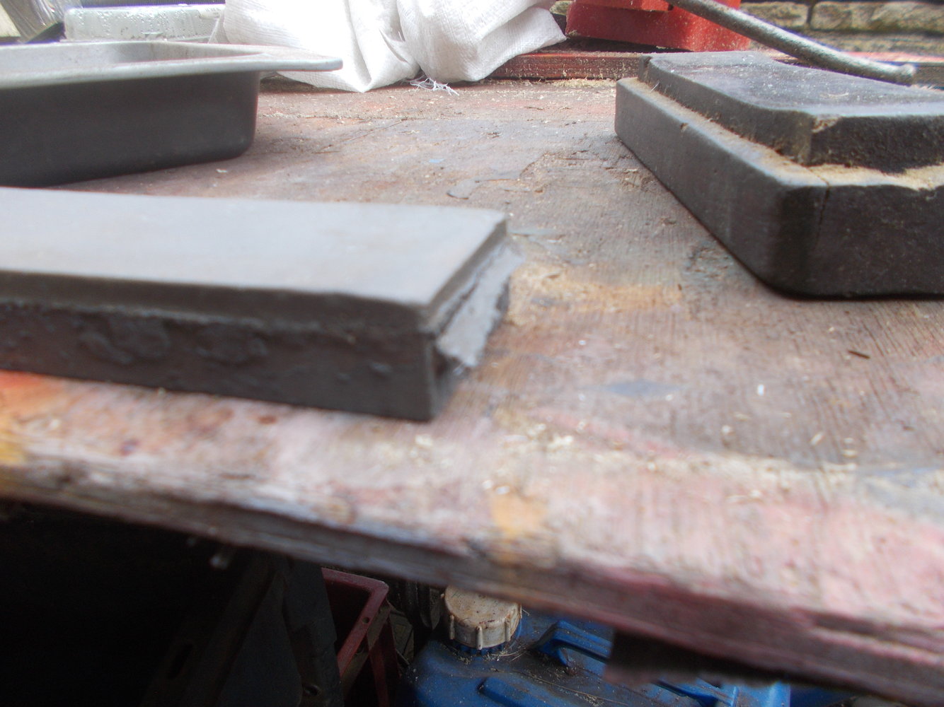

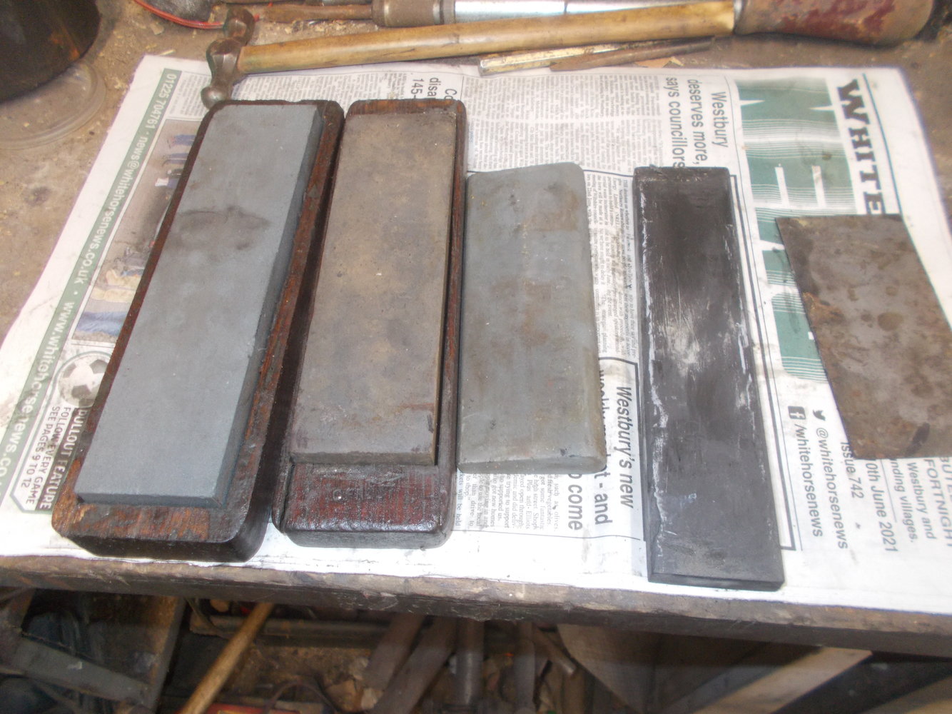

The oil stones were very dirty.
So they were boiled up in washing soda for 2 hours.
The wooden cases were cleaned and waxed.
2 of the stones were curved, turns out they are knife stones, from a kit.

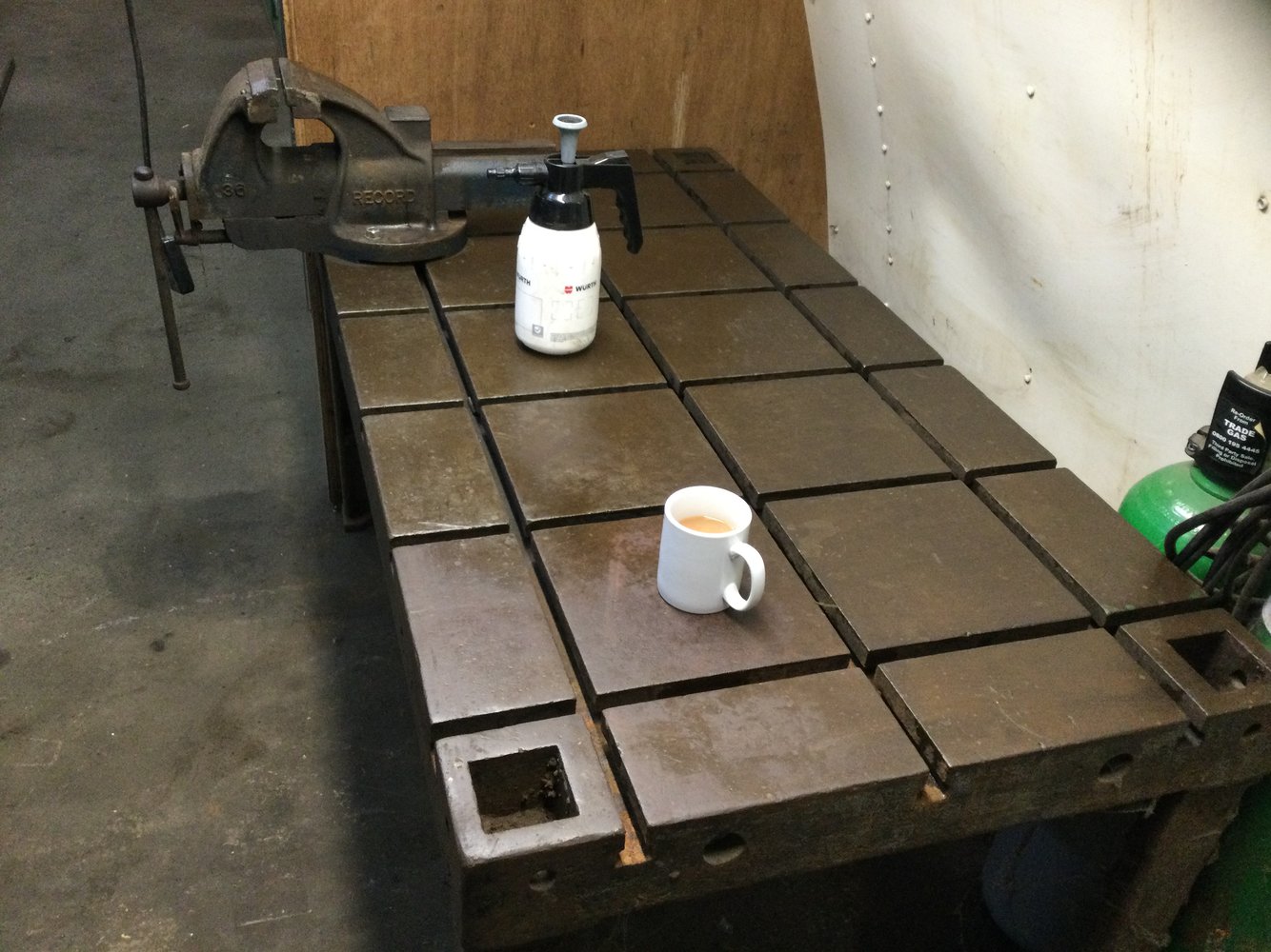

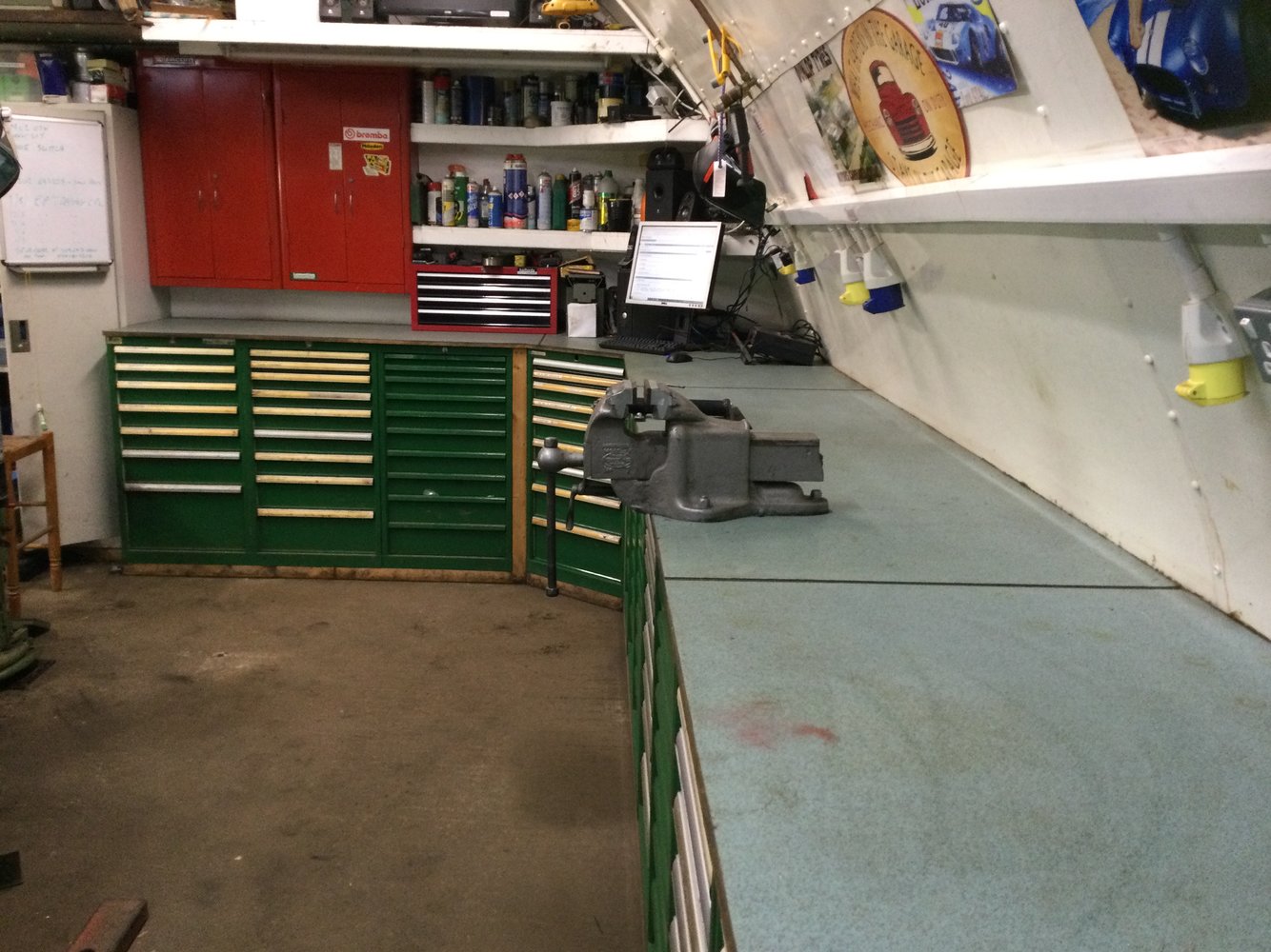

, I could only dream of having clear worktop space like that
