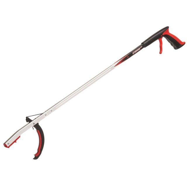

I've recently 3D designed & printed a trigger in ABS - T for my litter picker / extended picking device .Not made, but fixed. Next door neighbours go Litter picking. The grabbers break. I fix them, The one today was a pin lost from the trigger. It took me longer to print my 'FIXED BY DAVE' sticker than it did to put a bolt in it. I don't charge them. I make noise, they don't complain.

What would be the cost of 3d printing a handle please? I normally use a bolt for the pivot as it's more easily replaced if I need to. Easiest ones to fix are these.I've recently 3D designed & printed a trigger in ABS - T for my litter picker / extended picking device .
I measured a bright steel nail for the pin which was a tad bigger than the pin I took out . So I ended up drilling the pinhole to the nail diameter , chopped the nail leaving the head & tapered the free end a fraction then carefully peened it over with a ball pene pin hammer
This time it's been done in 70% density and is far stronger than the old broken original cast part . It took two attempts the first print was a fraction too wide for the channel it fits in ( I'd forgotten the takeoff 0.68 mm for clearance ) and it was a bit too short for a decent pull with my fingers as it was only 50 mm long ( Now 80 mm long ) . Next project for the picker when I've less to do is a couple off line/guide pullies and a full complement of the jaws & magnet retainer plus a nice meaty handle .

What would be the cost of 3d printing a handle please? I normally use a bolt for the pivot as it's more easily replaced if I need to. Easiest ones to fix are these. View attachment 297988
it’s still good. 10 new handles and 5 new jawsHow on gods earth do you manage to wear one out?Mine's had some right use & it's still good.
