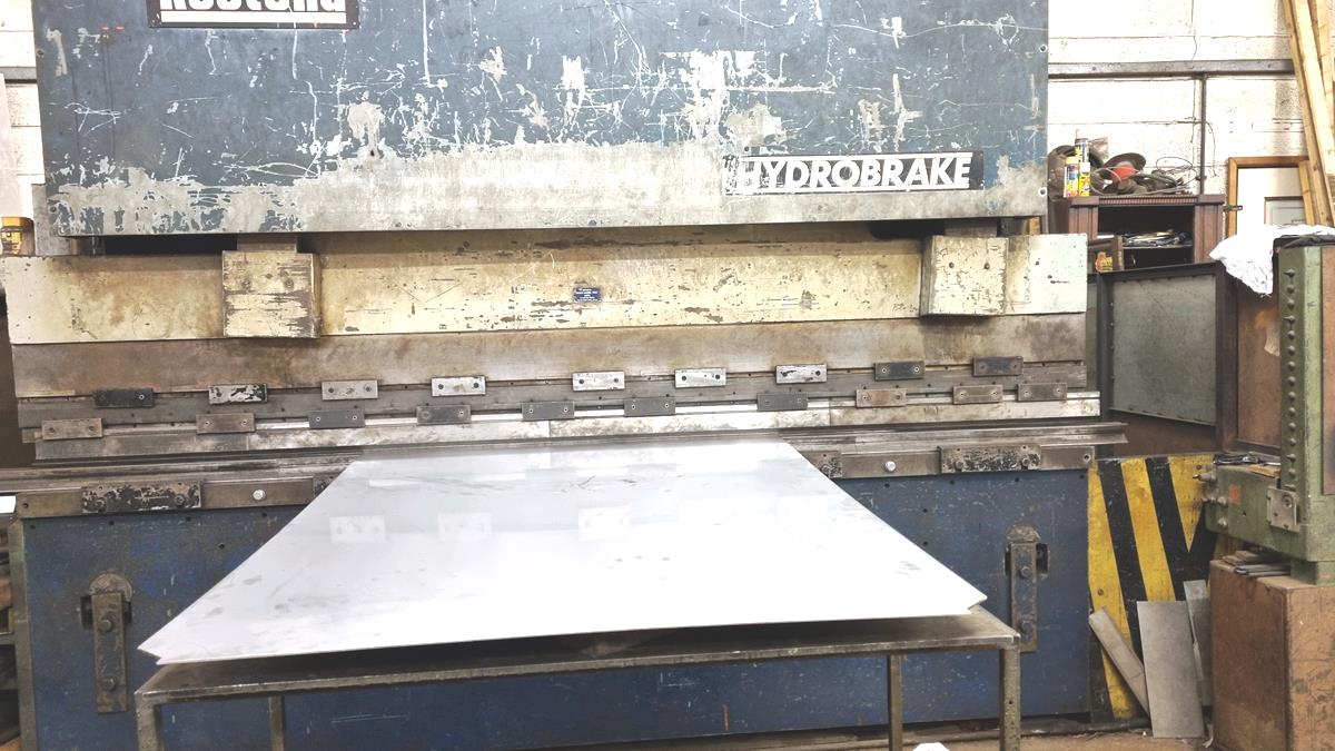

Looks like a 3m x 1.5mWhat size sheets?

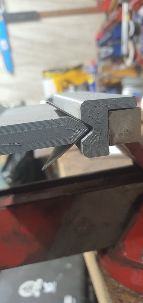

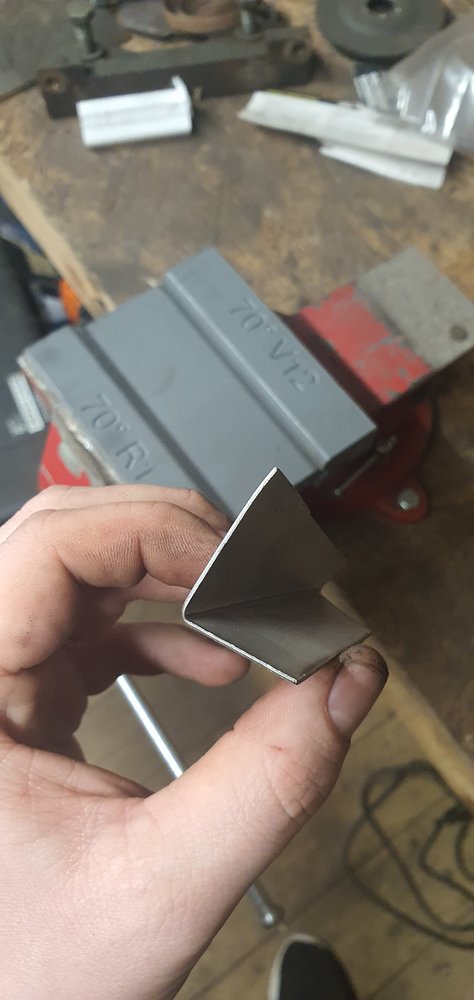

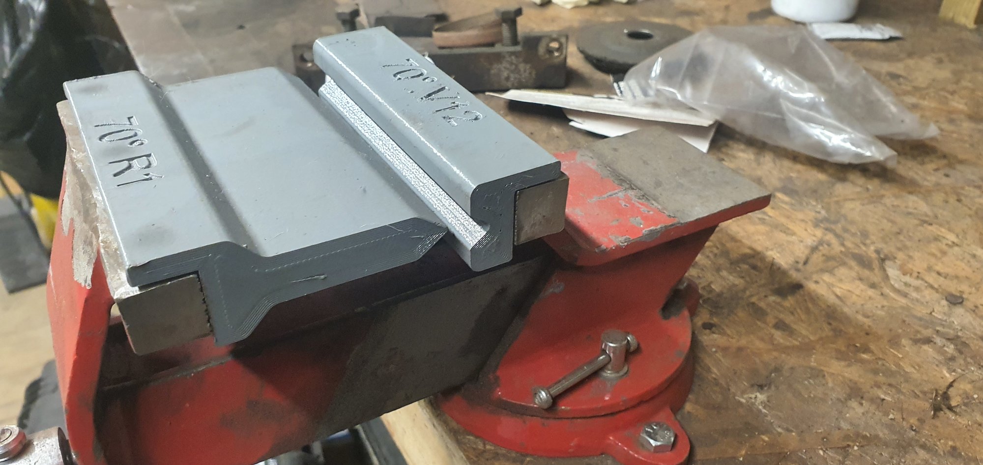

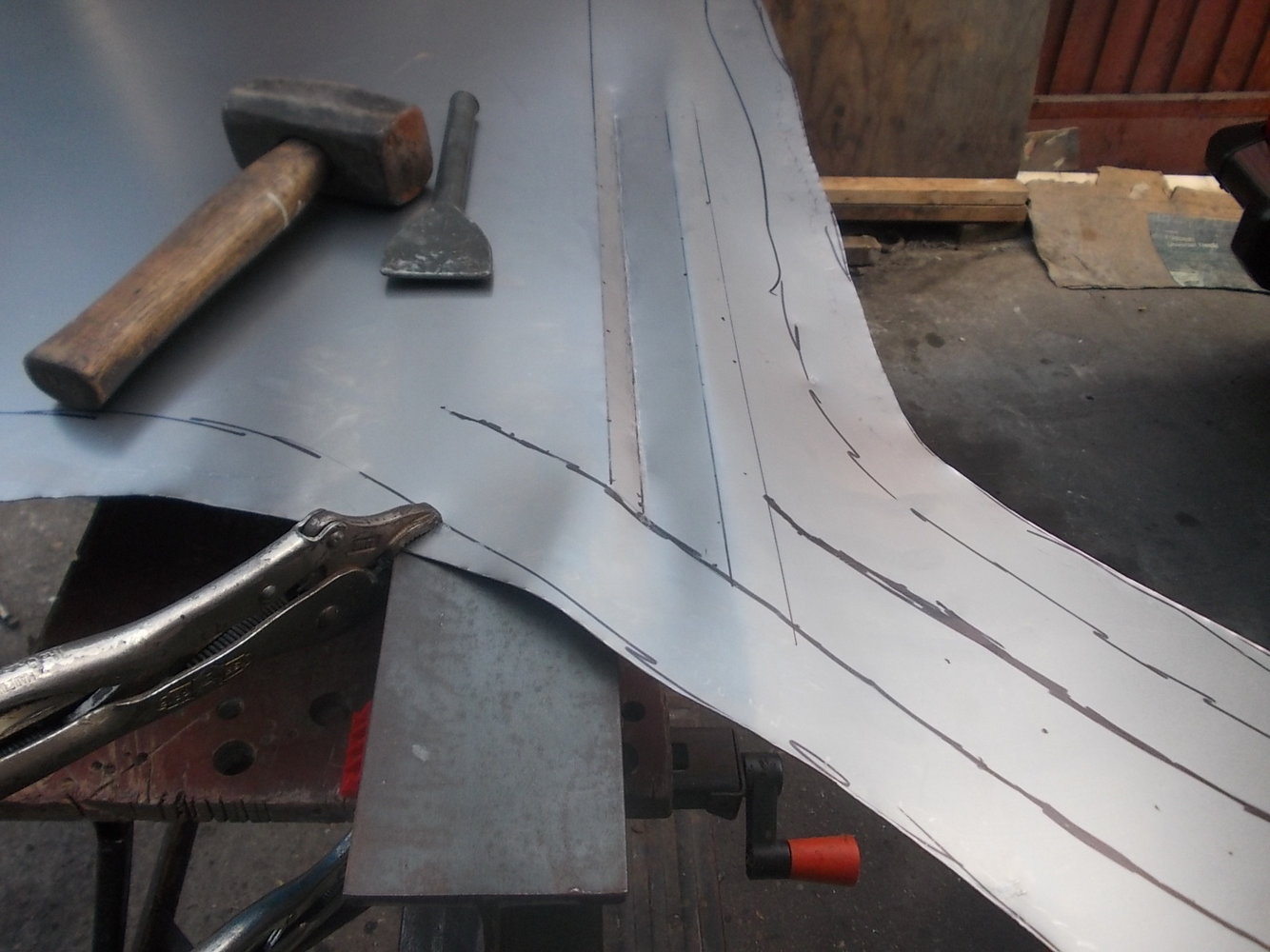

I have to ask why? Material that thin you could persuade over, simply clamped in the vice?

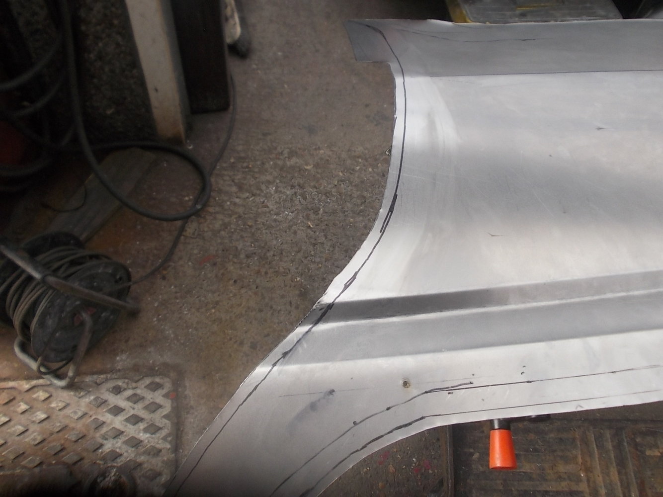

You're right, but I've had a hard time getting the lines perfect when I'm trying to make repair parts that need to line up perfectly but the real benefit was fro. The round nose dies that allowed me to form with a radius in the edge. This was just one die.I have to ask why? Material that thin you could persuade over, simply clamped in the vice?

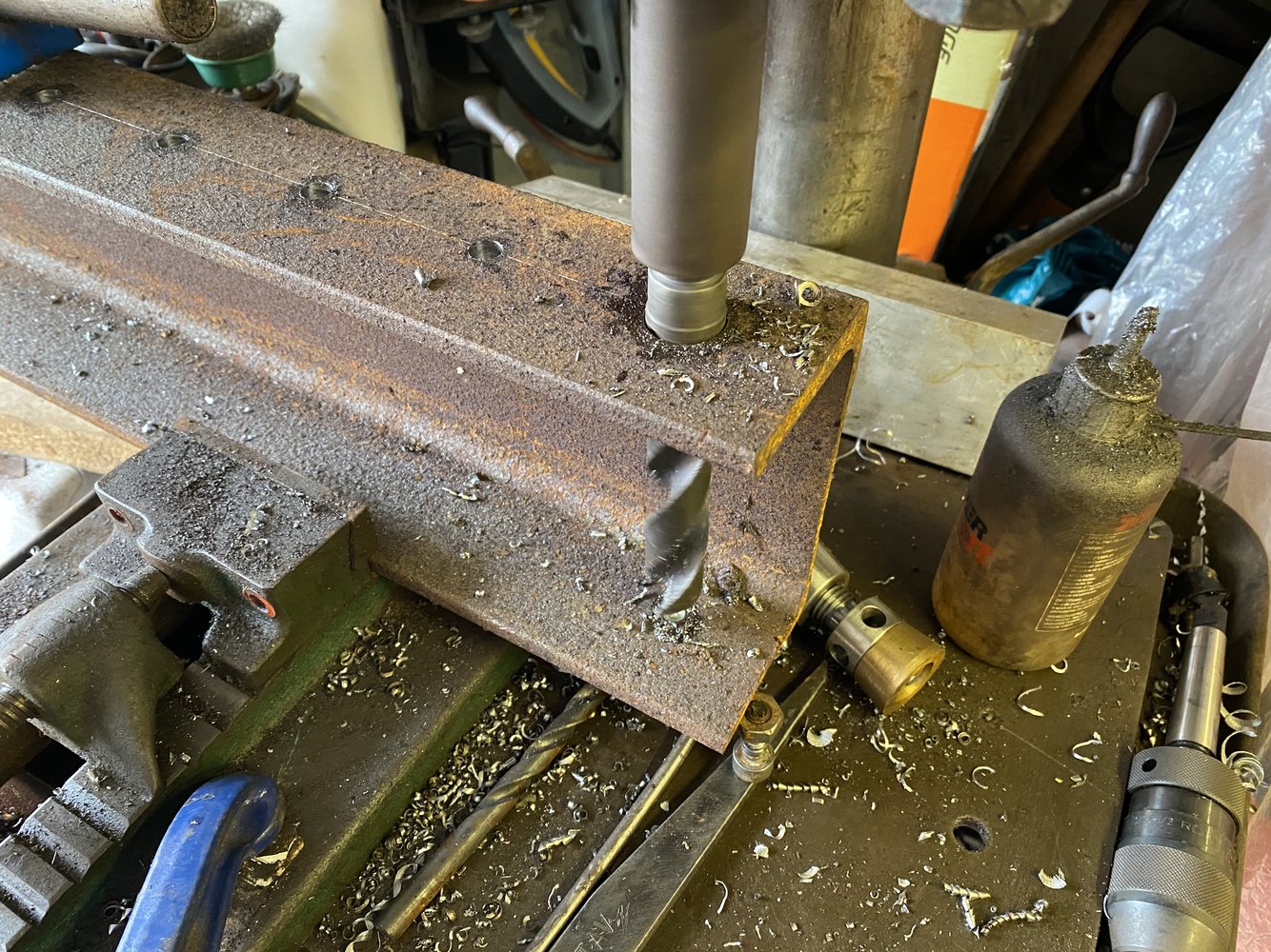

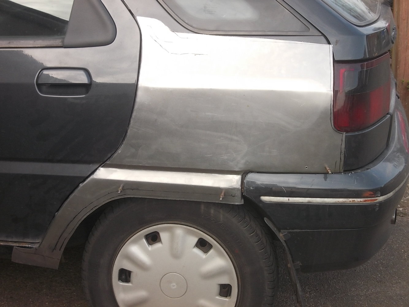

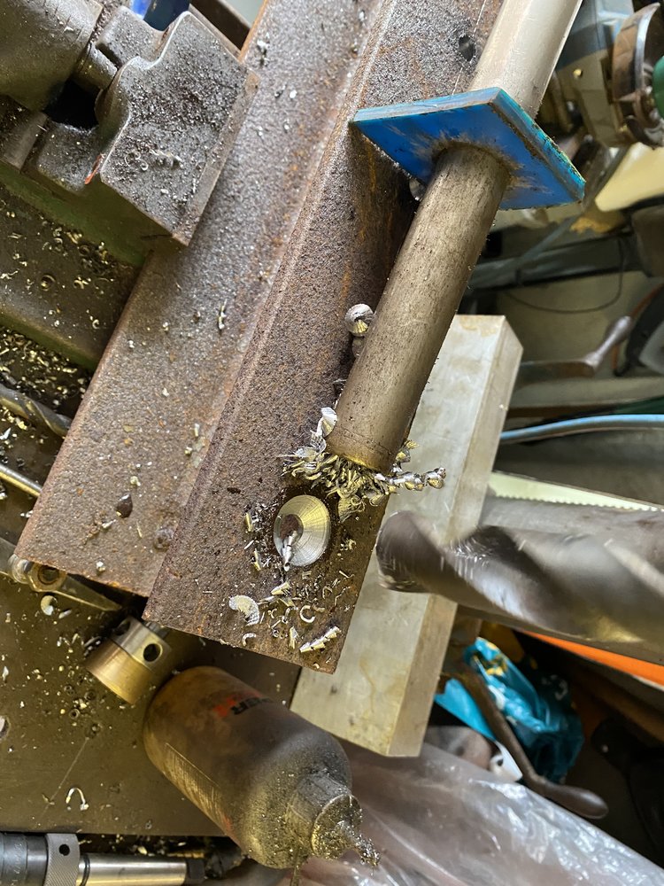

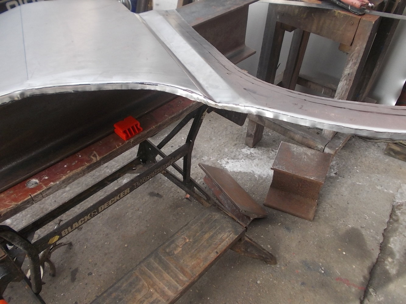

Used a 14mm cutter instead and all was fine.View attachment 282144View attachment 282145swage lines don't line up as the original arch return edge is in the way. once removed it should all line up![]()
