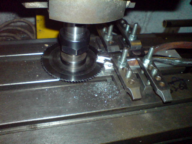

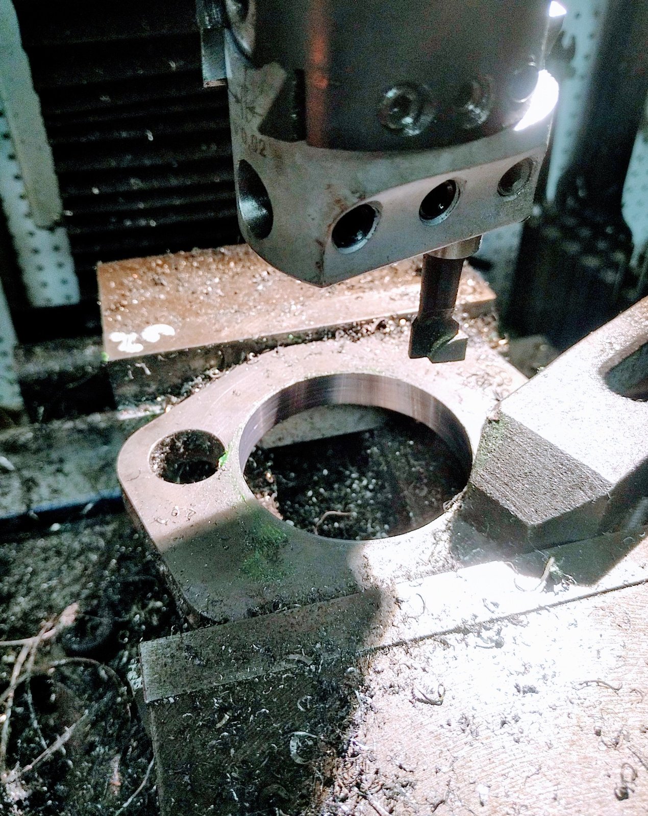

First up was mill an RSS number plate.

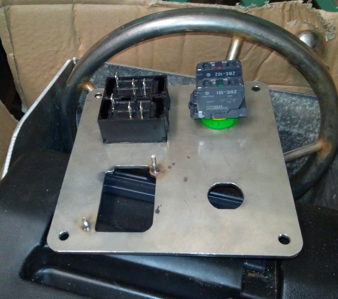

Then welded a couple of 3mm studs to the switch panels I made a while ago, did 2 of them.
Then a repair on a Chinese stainless helm wheel, the spokes had come loose and the wheel was walloping about so a quick tak on eack spoke cured it.

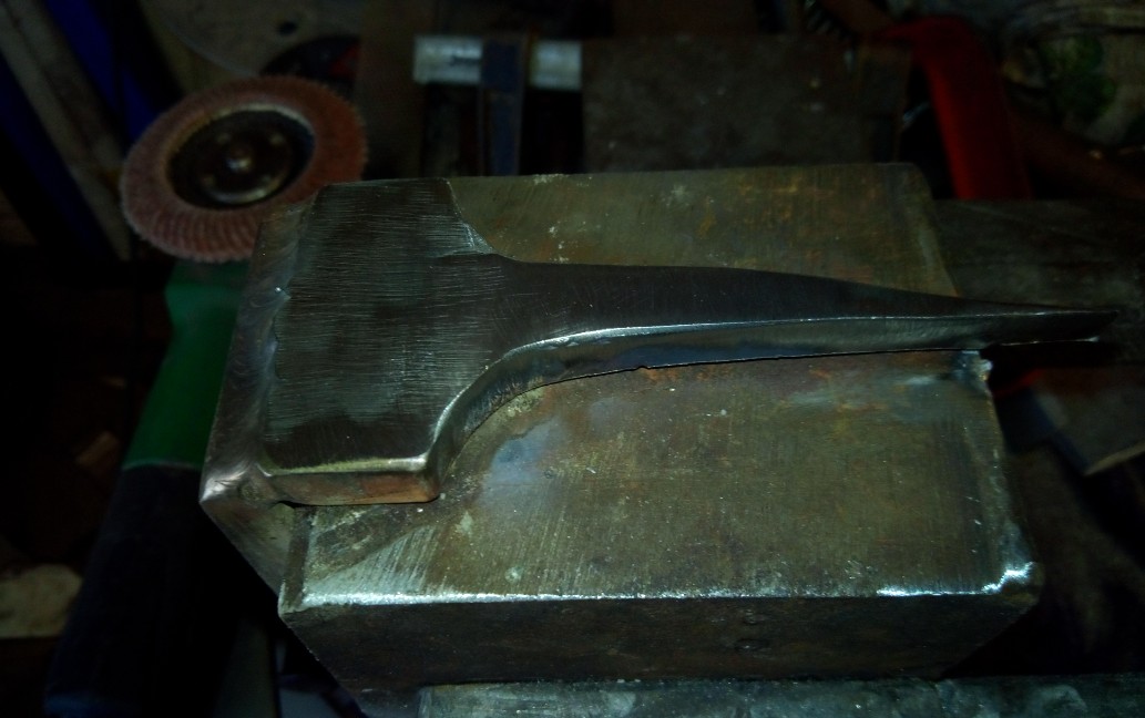

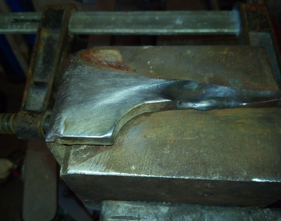

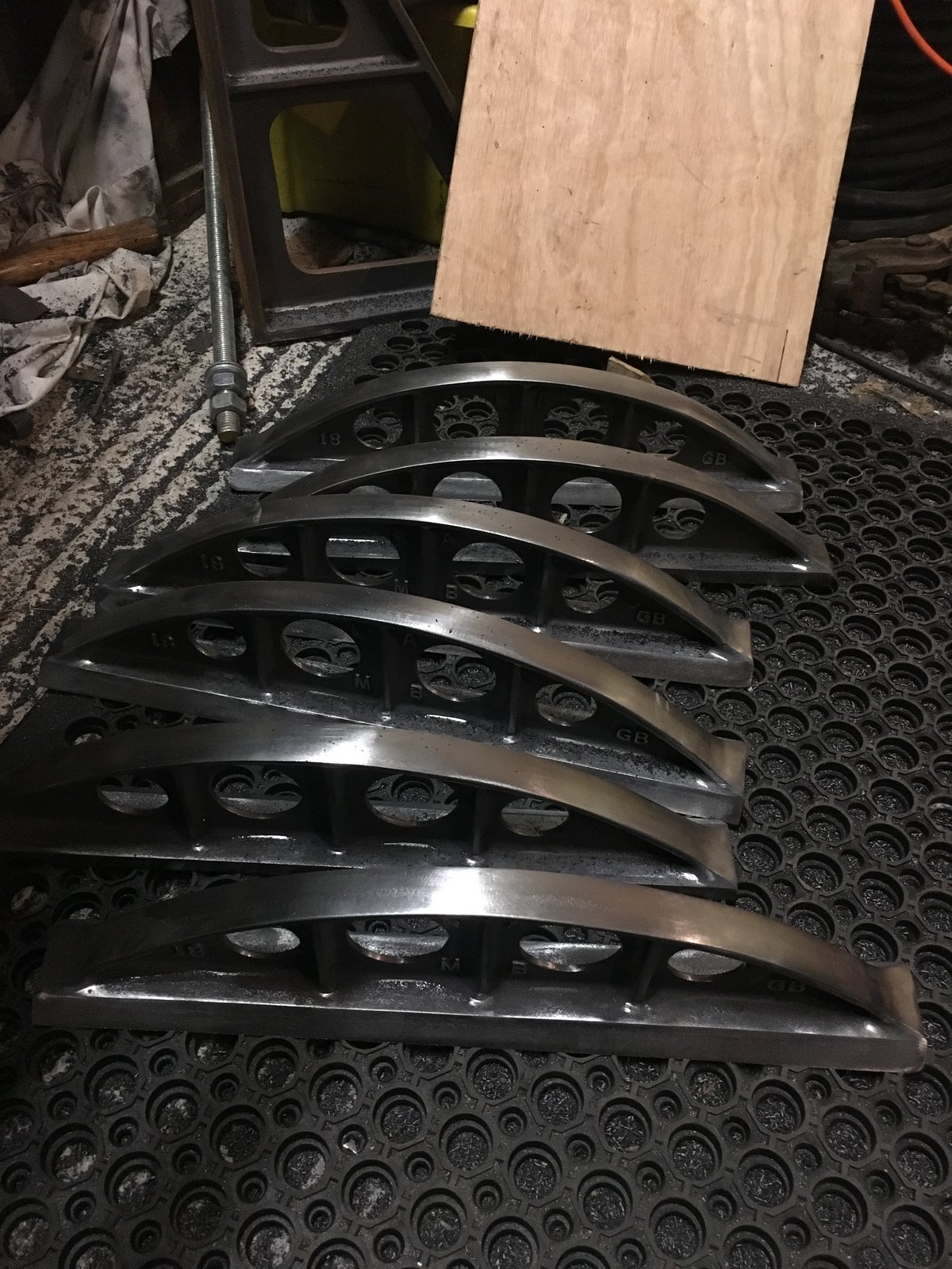

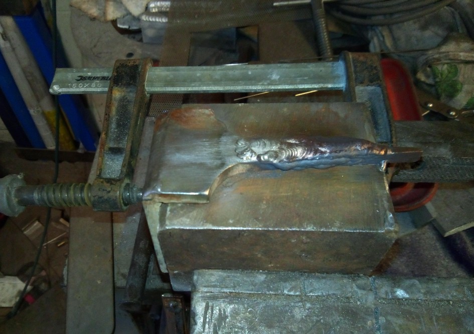

Then a couple of hauler knife wear plates.
Forgot to take a pic of it before I started but here it is with the first weld, as can be seen it is nearly worn through..
All filled up.
Then ground to shape.
Then rinsed and repeated on a second one.

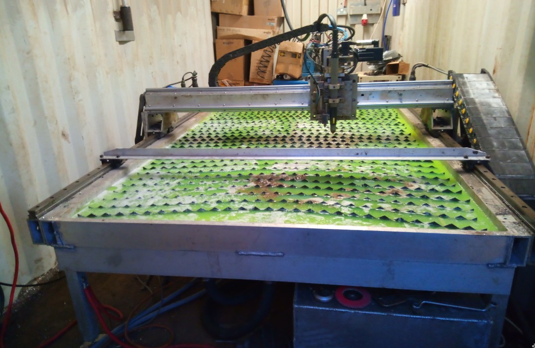

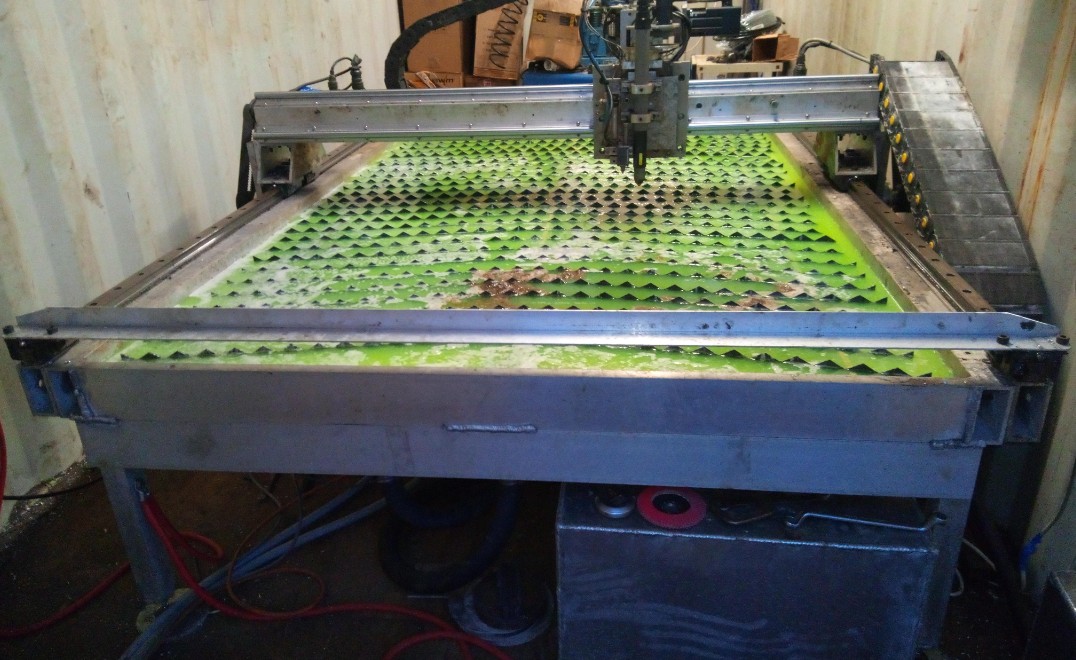

Decided to go out to the plasma table and make a loader slide out of some alu angle and a couple of the knackered trucks. It seems like it will work, I should be able to slide the front edge of a sheet onto it and then push from the opposite end of the sheet and slide it onto the table.
