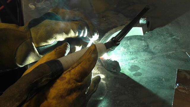

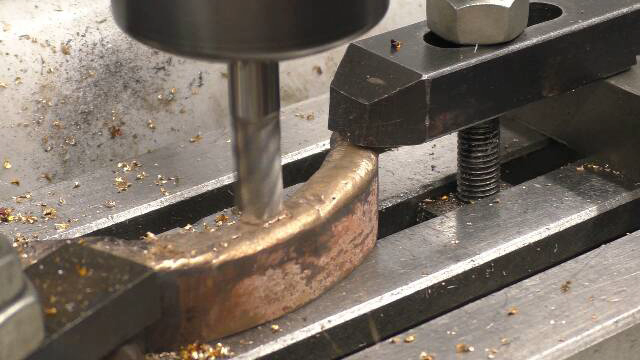

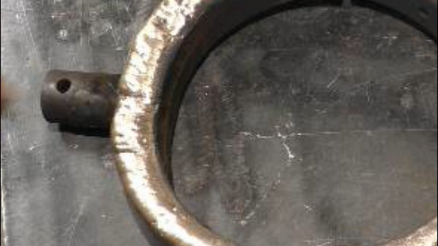

Only tried it once and can't remember the settings I used, came out reasonably good for a first attempt.Silicon bronze, 1.6mm filler I got from ebay a long time back
Supposed to be done on DC, but the arc is too focused, and the puddle is scummy. The cleaning action seems to help a lot, as well as the natural rounding of the tungsten.
I'd say a blunt tungsten on DC pulse would work just as well, if the metal was spotless.
