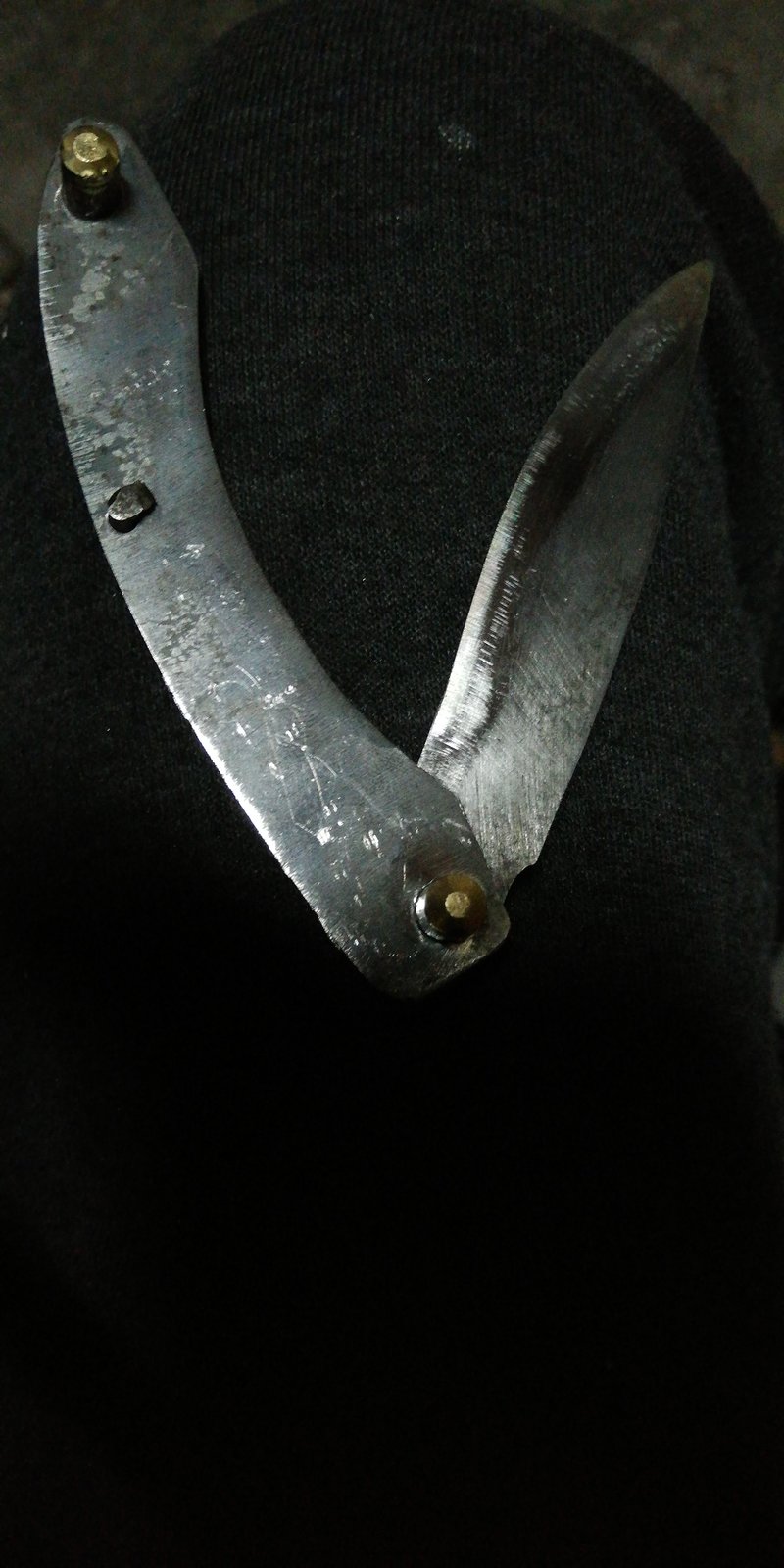

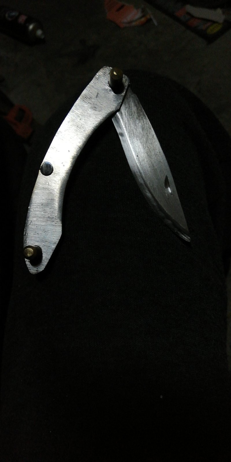

Started making the knife
Better known as "Pattadese" , this (not this one specifically but the design) is the typical Sardinian knife , known in the world because reasons but I know it's known if you don't know it you should .
The other typical Sardinian knife is the "Lepa"
Similar but characterised by a tall an slightly"Bowie" looking blade
Anyway
That's my Pattadese version , I'm making it because my sister asked me to make one for her
The blade is around 10cm long and it's made out of a piece of angle grinder diamond wheel.
Original Sardinian knives are made by forging old Fiat cars leaf springs , I'm not equipped to do that so I have to do this way
Made the spring out of the same material
And mild steel 1.5mm sheet for the frame.
For the handle I'll use juniper ,a typical Sardinian wood (it's being cut in the 50's or 70's) that now it's forbidden to cut
Original Sardinian knives handles are made using bones or horns ,but again I'm not equipped to work those materials
Hope you will like it .
There are things to improve right now it's not a complete part
