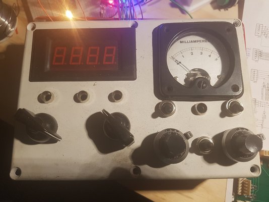

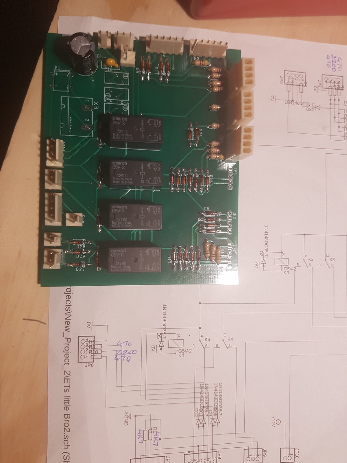

Decided that the Veroboard er.. board in my VFD control box for the lathe offended my engineering sensibilities, still waiting on a few parts from RS for its replacement...
Drawn up in Eagle, board from China in 3 days and very nicely made!
Which will be going into this...
(E.T.'s Little Brother, still needs decent labels or a visit to an engravers - I know which control's what though!)
Cos I can
Gives me 3 selectable fixed speed "multipliers" (VFD frequencies), variable speed (from 1/10th up to 1.6x marked spindle speeds), tacho, motor current meter, fine setting of max and min for the cross-slide remote control of spindle speed and a jog mode using a Tig torch switch on the fwd/stop/reverse lever. As did the Veroboard, but this is much prettier for something nobody will see
