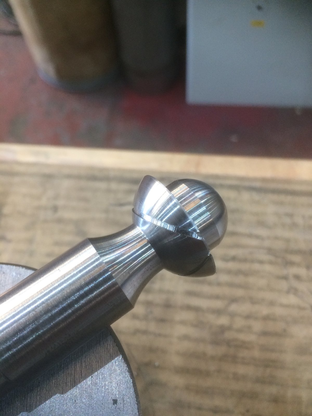

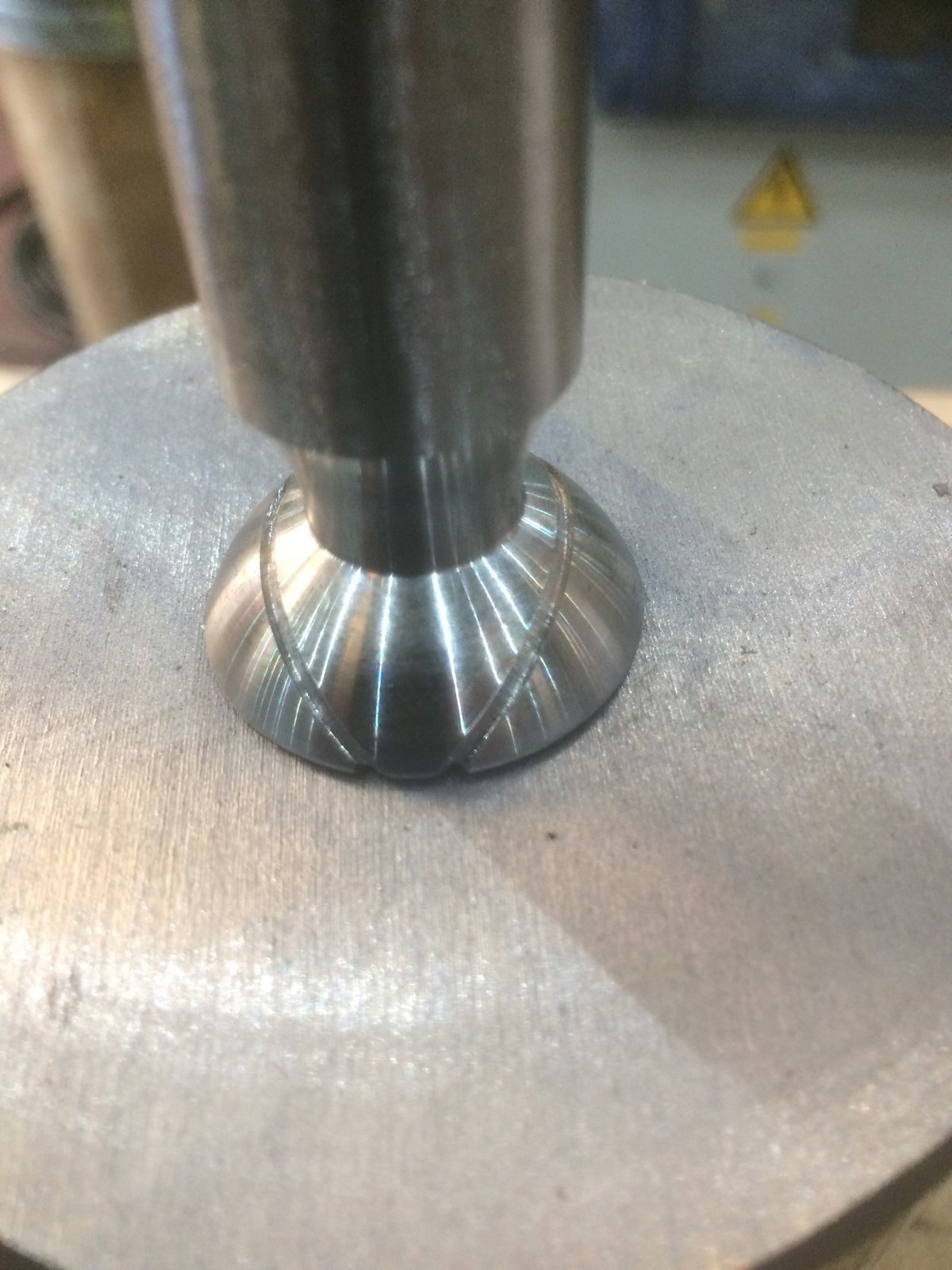

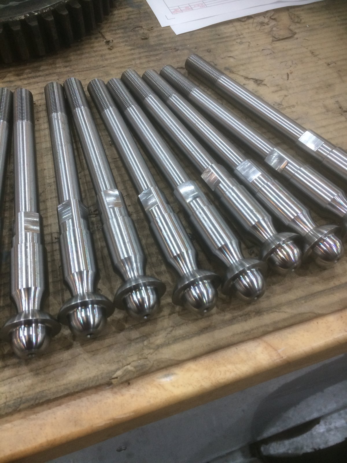

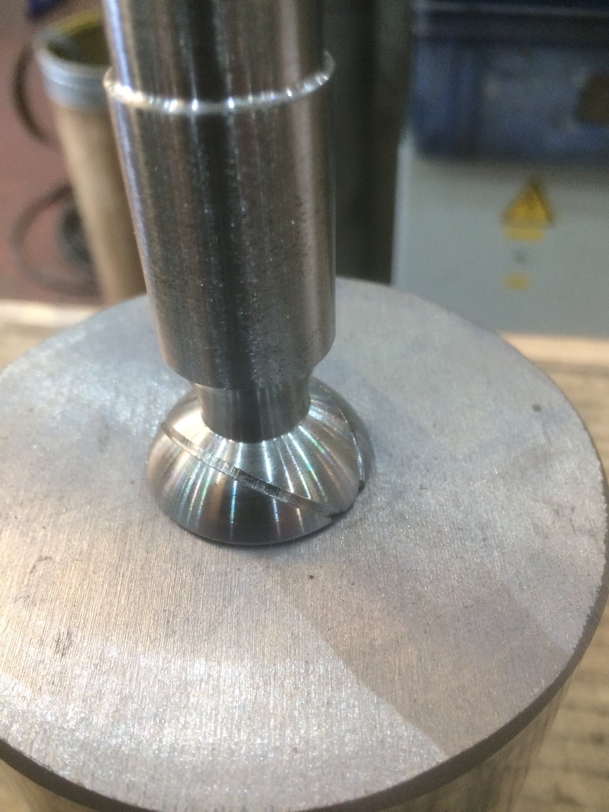

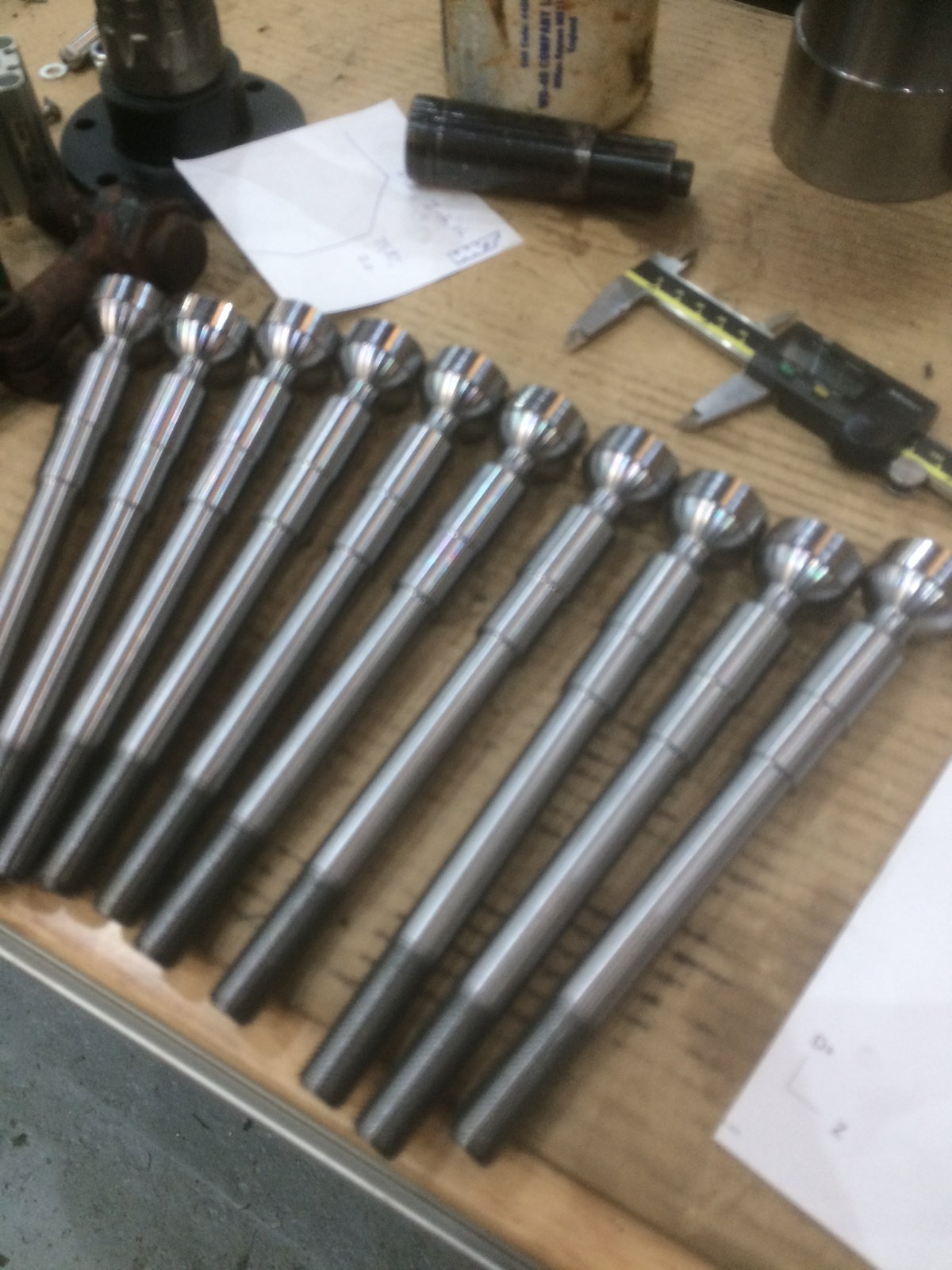

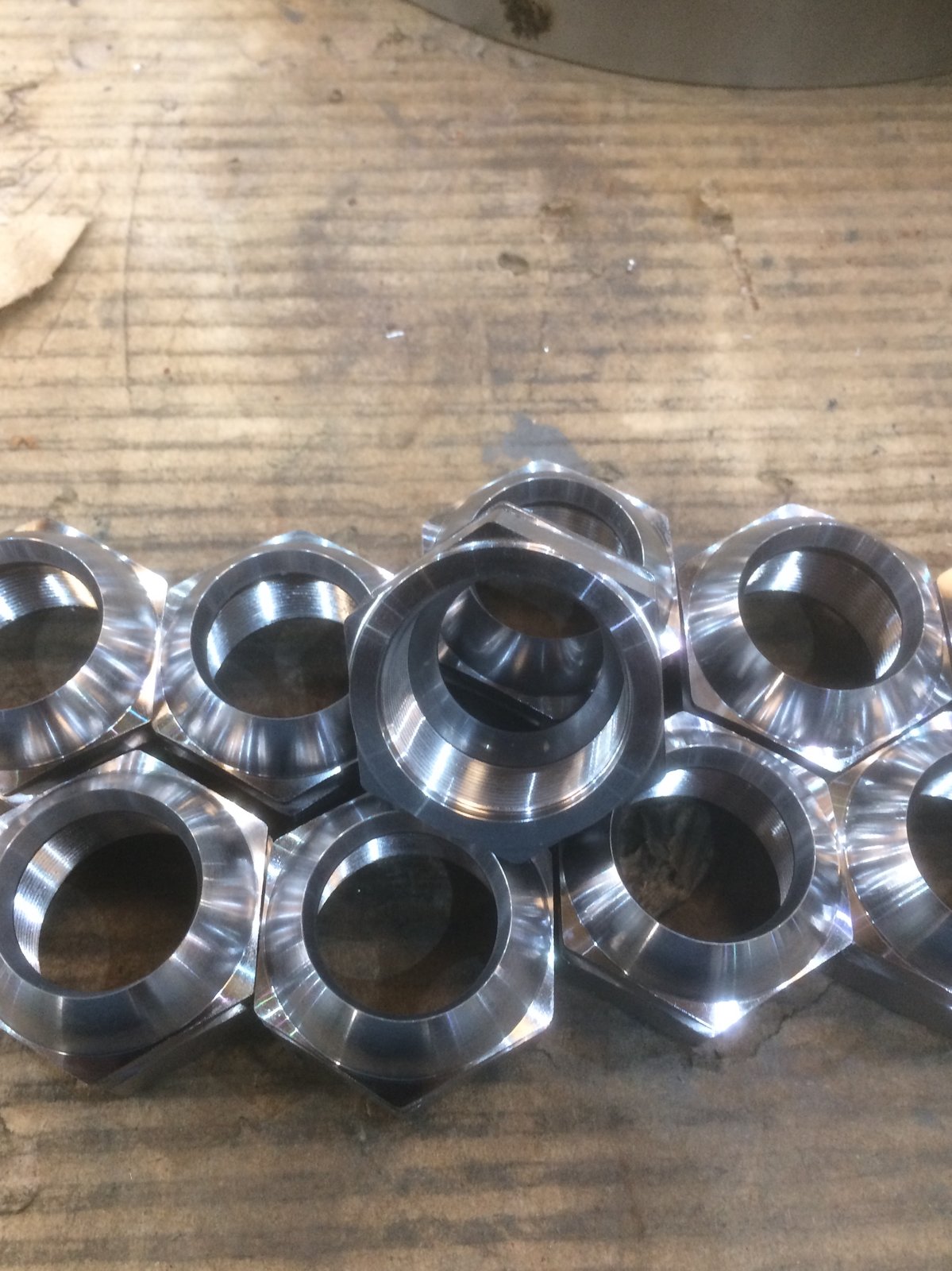

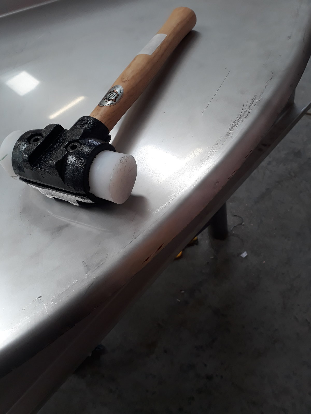

View attachment 181212 View attachment 181213 View attachment 181214 View attachment 181215 View attachment 181216 View attachment 181217 Been making a batch of tie rods and nuts for a vintage car marque. Been a fun project. Eventually got round to doing the grease grooves today. Non event of the year once I got my head around how to machine the two grooves,180 degrees apart ,parallel to the surface of the ball...

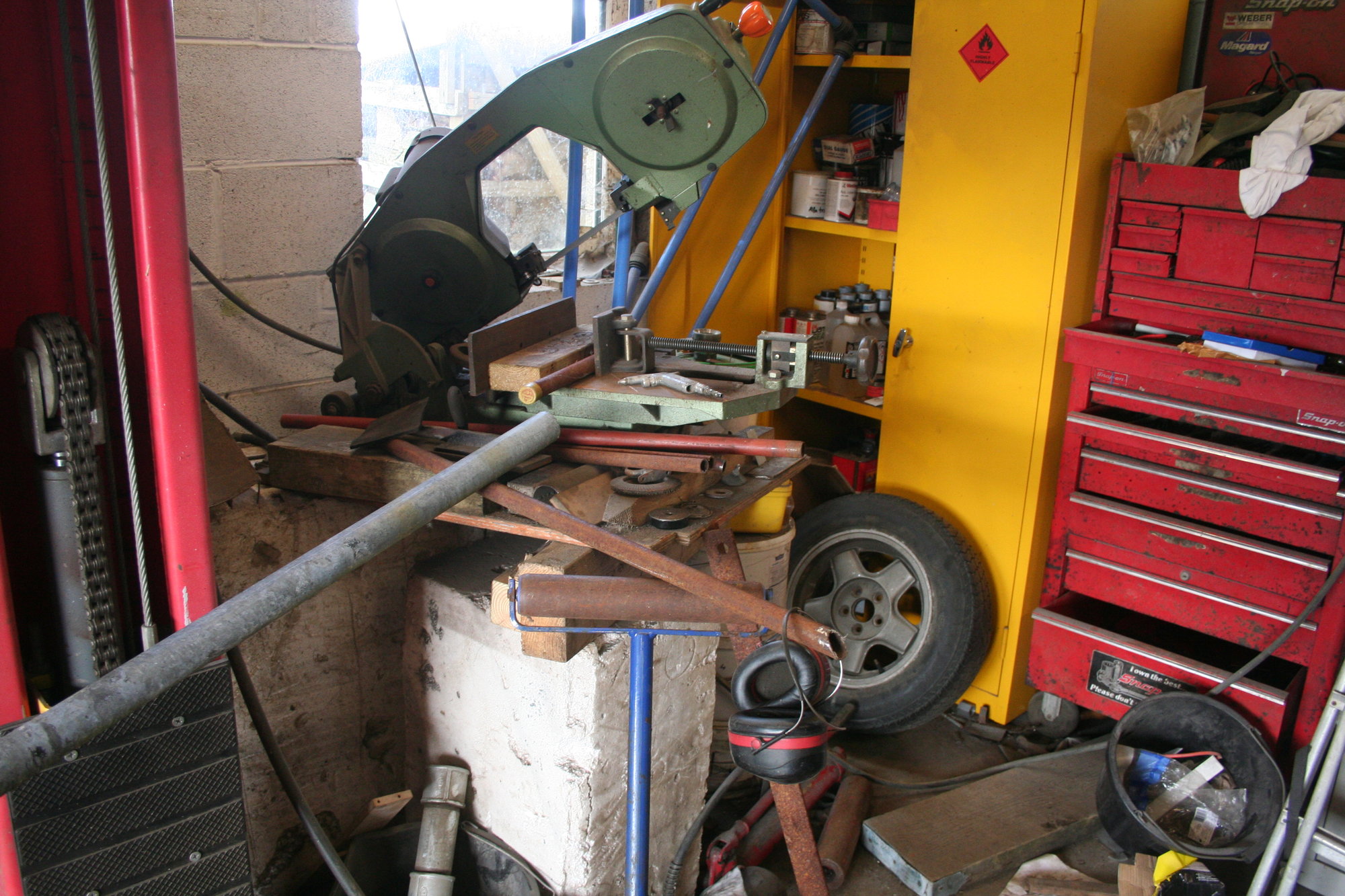

Nice unusual saw,I’m intrigued by that lump of polystyrene,what’s it from?
Yes that would be interesting, mounted off centre on a rotary table and cut with slitting saw perhaps?First class job.
Interested to see how you set up for the grease groove if you have any pics.
