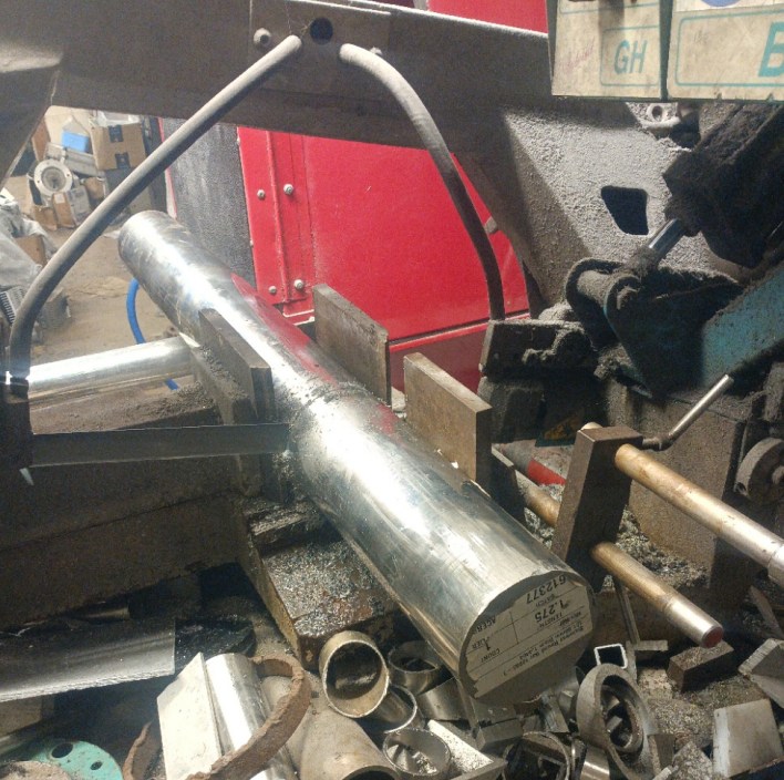

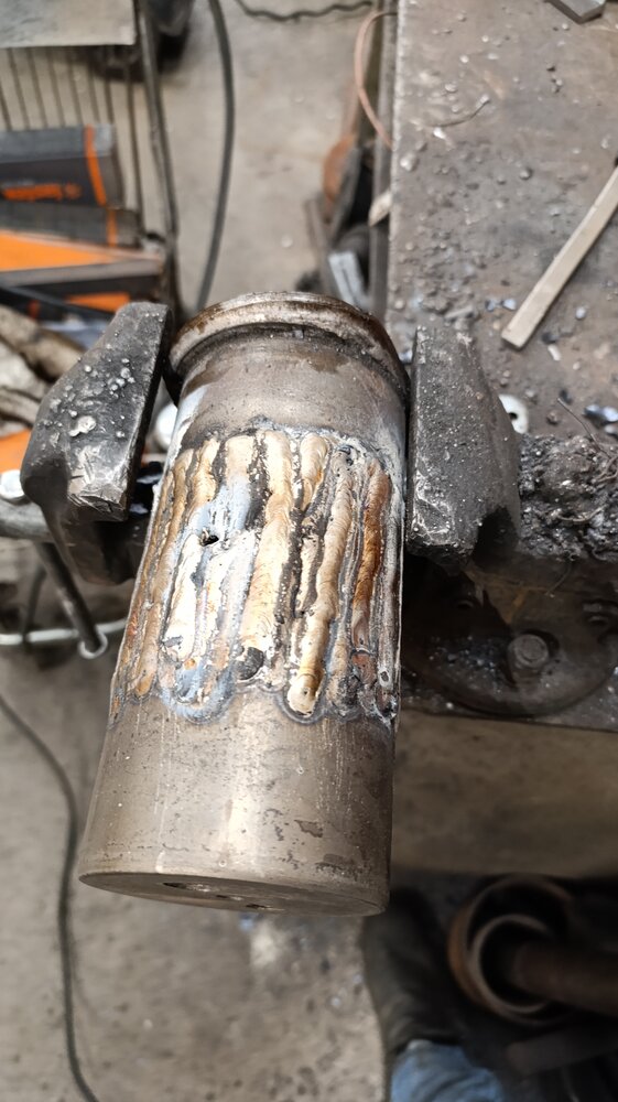

Built up material on the yesterday demolition thing pin
It had 0.9mm below 0 in some spots
Plus the bushes had worn out as well up to 0.8mm out of tolerance.
So about 2mm of play between parts
Problem is that they need the thing quick, not 90mm induction hardened bar .
So I've had build up material on the middle of the pin so they can use the thing till OEM replacement parts will arrive.
In reality since it's case hardened plus it has been welded it will most likely snap at the first use.
Useless waste of time and 309 electrodes.
