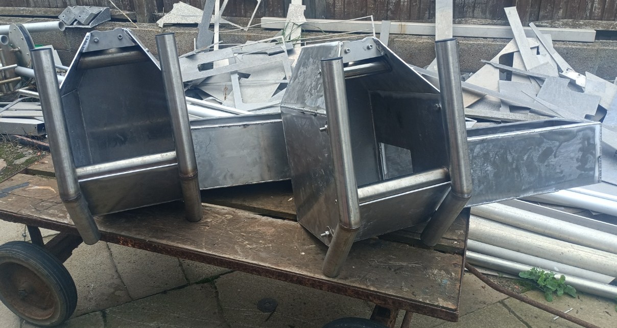

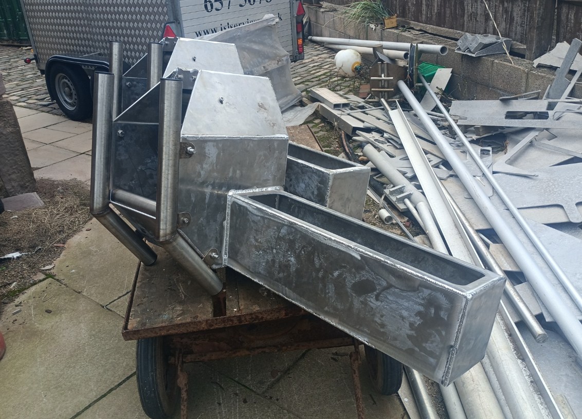

A couple of mackerel stripper boxes. Normally I make them out of 1.5mm stainless but I decided to try 3mm aluminium and bolt on the stainless tubes rather than weld. They are a lot lighter and as the stainless is the part that will wear they should stand up fine.

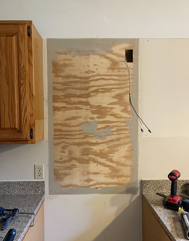

The new range required a vent hood with a minimum 500 cfm rating, so I ordered one that goes up to 680 cfm (321 l/s). To mount the vent hood, I wanted to provide a secure mounting area, which involved removing a section of plasterboard, blocking out the existing studs, and installing 1/2" plywood.

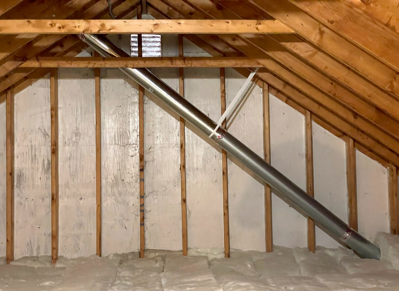

The old range hood was the recirculating type with no ductwork, so I had to install a duct that went up through the attic and out through the roof to a vent cap at the back of the house.

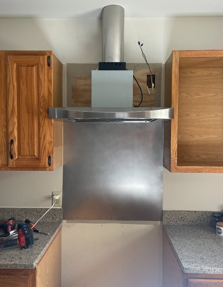

Here's the new range hood mounted on the wall, with a section of stainless duct attached. I already had a piece of stainless steel sheet that happened to be 30 inches wide, so I decided to use that as part of the backsplash for the range (shown partially installed in this photo):

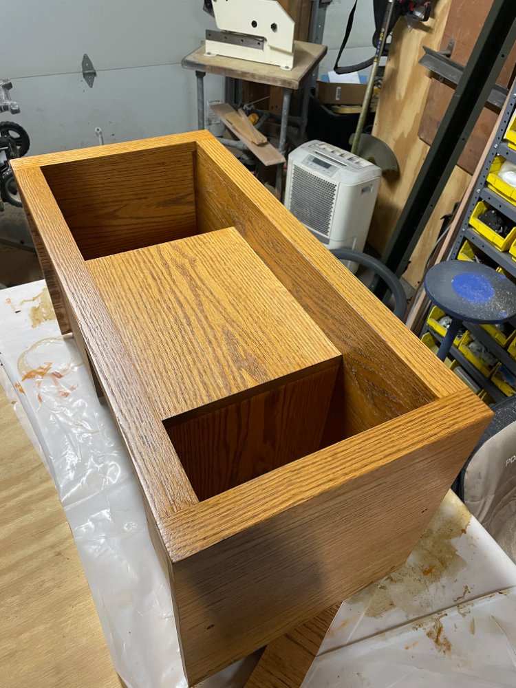

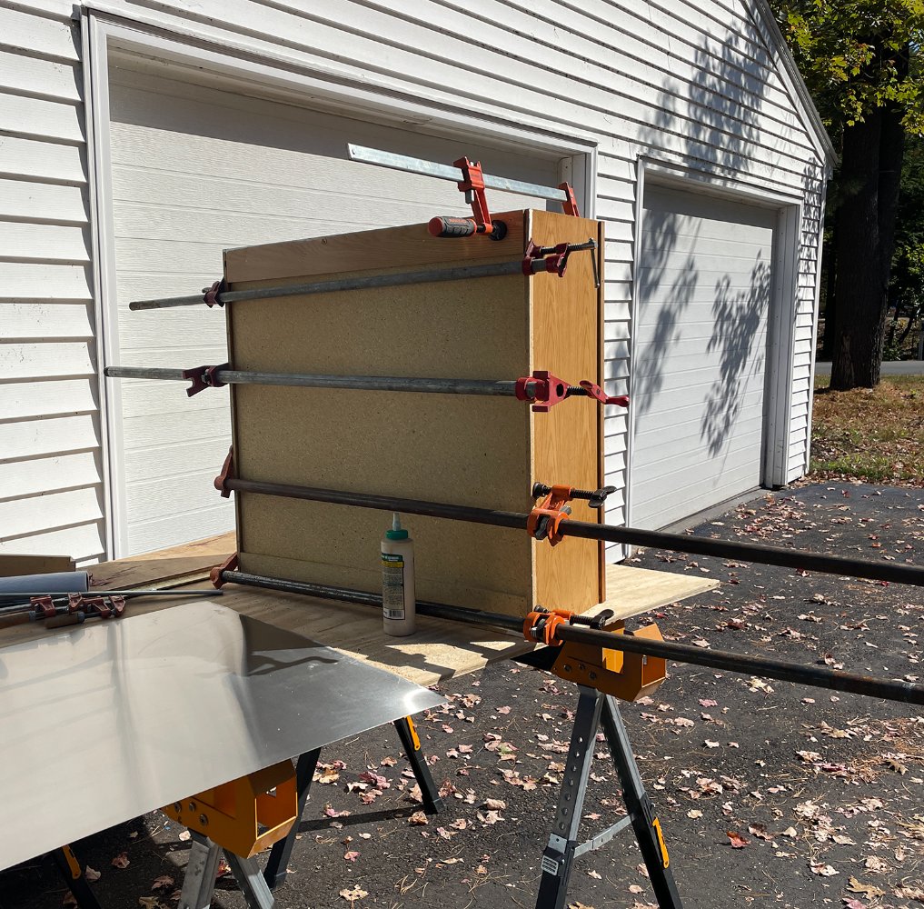

The original cabinet above the old range hood was several inches too tall for the new setup, so I bought some oak planks and made a new open-front cabinet from scratch. I decided to use my biscuit jointer (and some screws) to connect the pieces, rather than my Kreg jigs. I had to experiment a bit to get the stain colour to more-or-less match the existing cabinets. It's not a perfect colour match, but close enough.

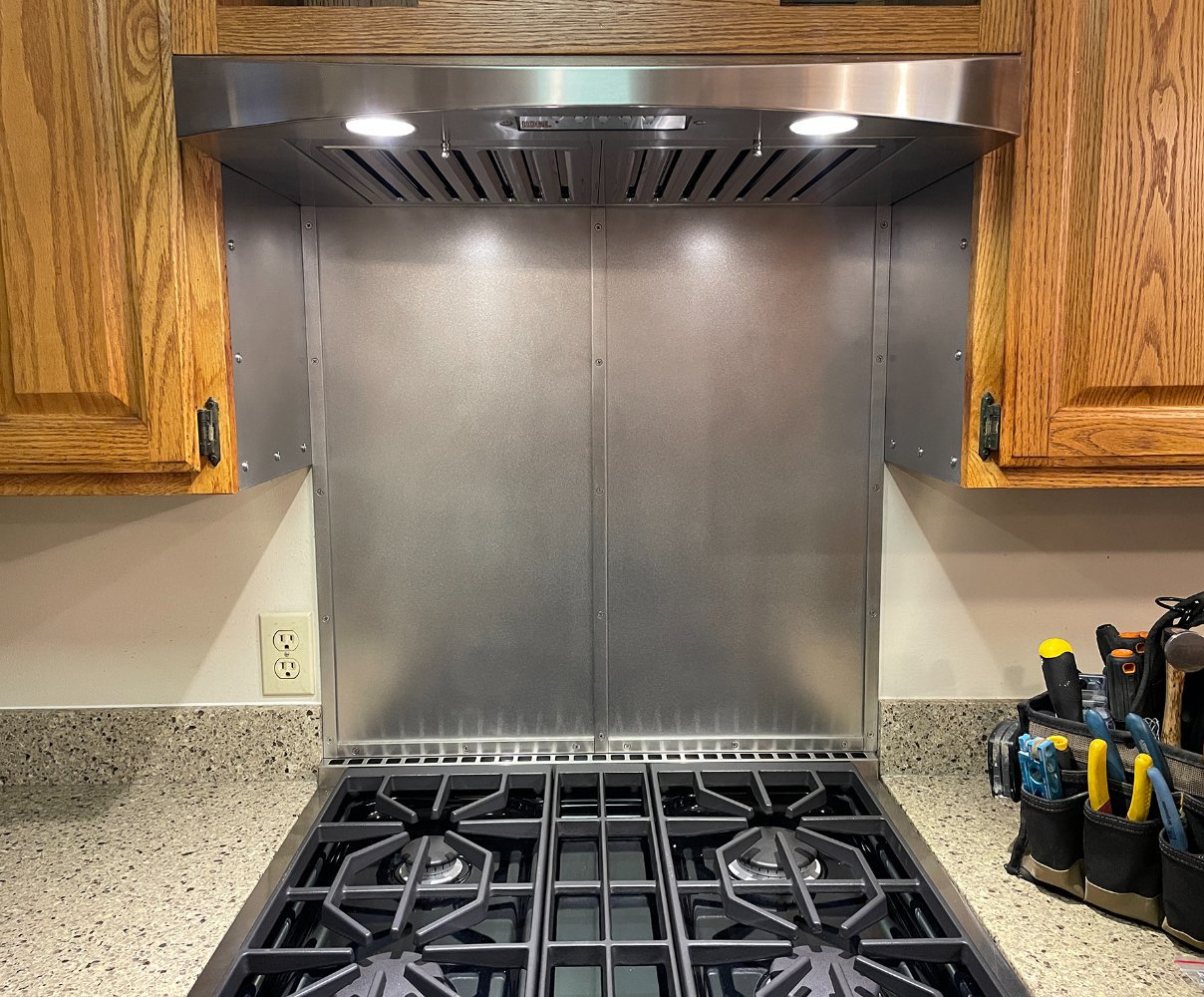

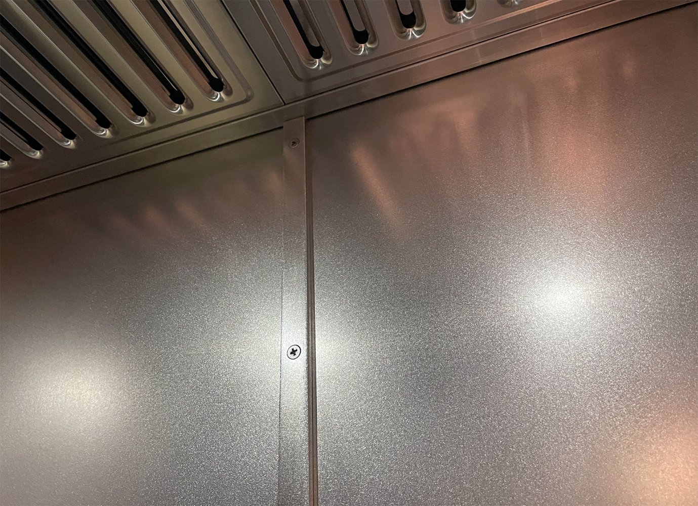

To finish the backsplash, I cut some 1/4" x 1/2" stainless bar stock for trim pieces and mounted them with countersunk flat-head screws. I also installed stainless sheet on the sides of the cabinets above the range.
I didn't like the harsh light reflections off the shiny stainless steel, so I used an orbital sander to create a textured surface on the steel. The reflections of the lights are much softer now.

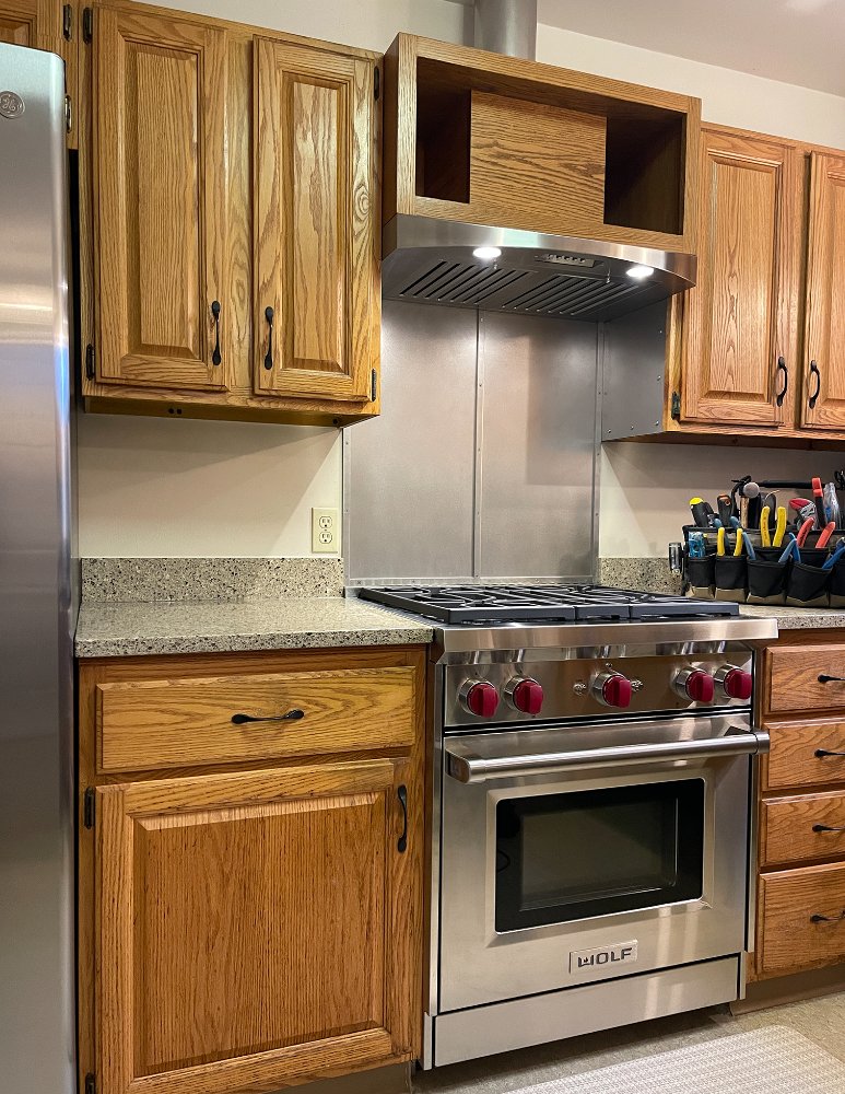

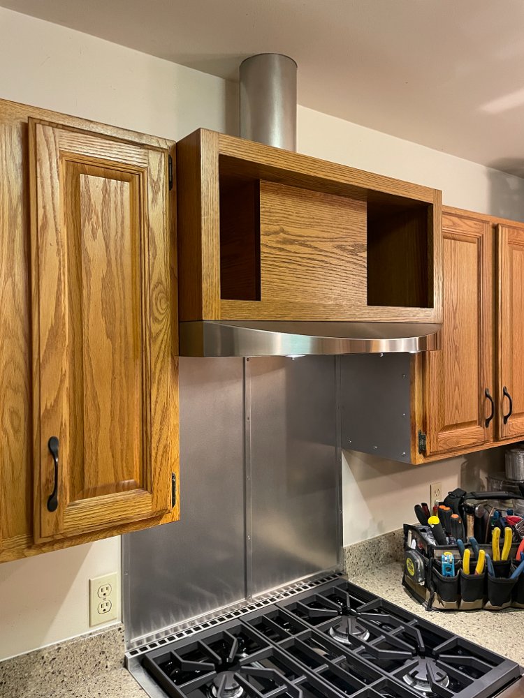

Here's the final vent hood and cabinet setup, with the range temporarily in place. I installed a receptacle in the cabinet for connecting the range hood. Note that I designed the cabinet so that the hood can be easily removed if necessary. I was pleased at how quiet the fan is. My wife wanted the open-front look for the new cabinet above the hood, but if she changes her mind, I can always install doors on it.

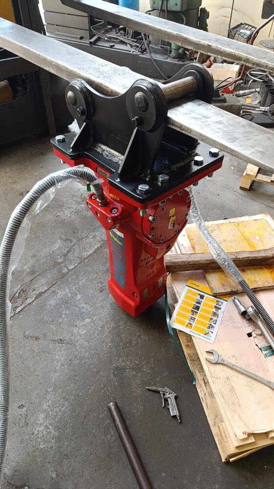

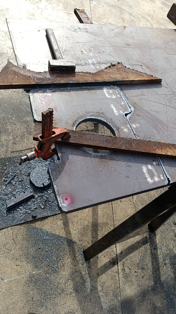

Flame cut this 20mm plate

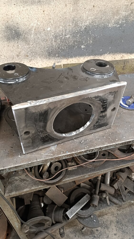

So it can be welded on this
Wich I've flame cut as well, clipped the sides and cut the hole.
Already welded.
Tomorrow I'll finish it up and install on a brand new hammer
I'm loving the old British Enfield President torch I've got a year ago roughly.
But the lever is kinda in the way when using the circle cutter tool
