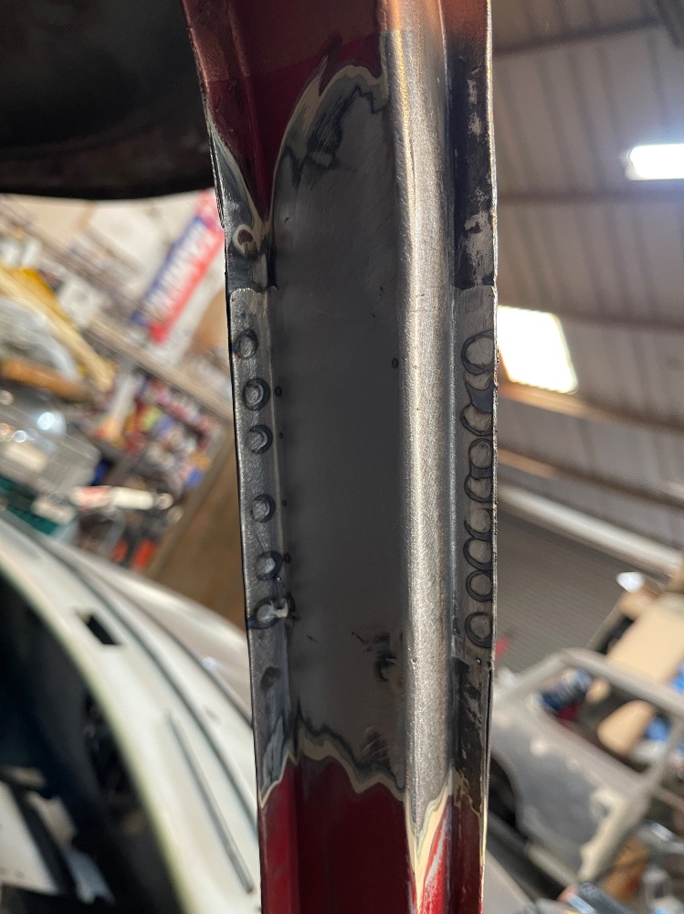

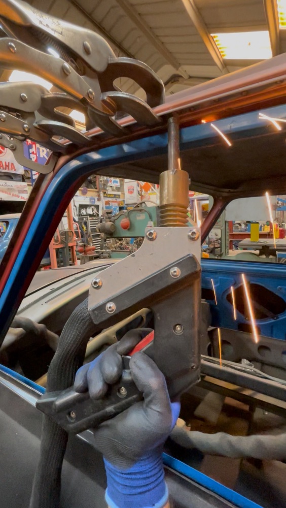

The single sided spot welder looks interesting, is it an add on to a machine or a whole new bit of kit?I made a pair of new drip rails fit the Mini and used the single side spot welded to get the attached.
Replaced a manky section of the RH A-pillar.
And welded up some worn Austin 7 clutch plates.
