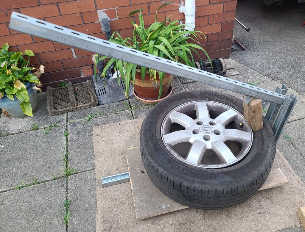

A makeshift bead breaker to change the valve on SWMBO's CR-V. I normally break beads in the vice but it doesn't have the throat to get round the tall tyres.
I bought one of the laser 'tyre on' valve changing kits to try tackle this but the cone's only really suited to steel wheels, not alloys where the valve seat's recessed. The unistrut breaker worked a treat though and doing it myself, I got the opportunity to clean up the scabby bits in the valve stem bore. No more weekly air top ups!
