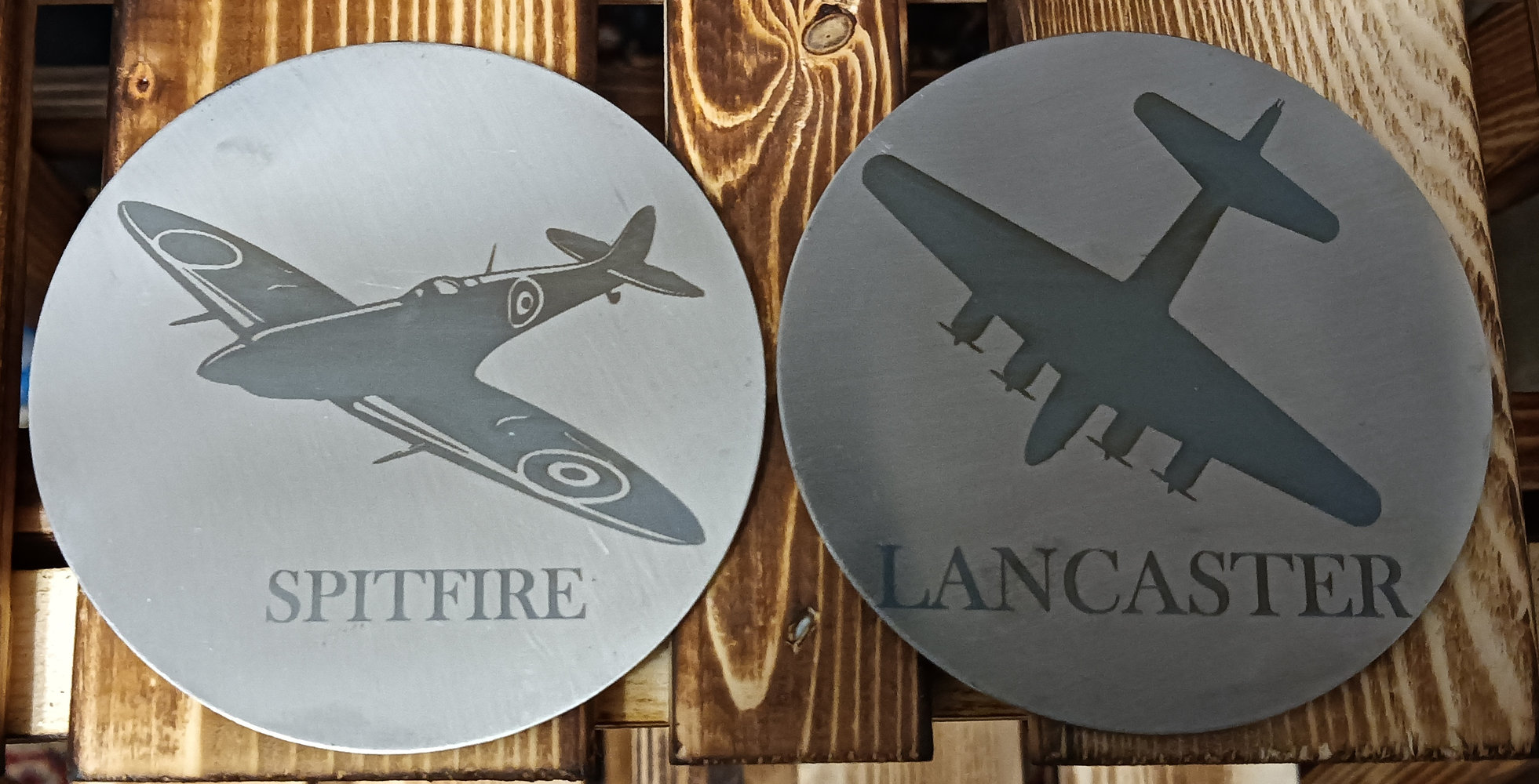

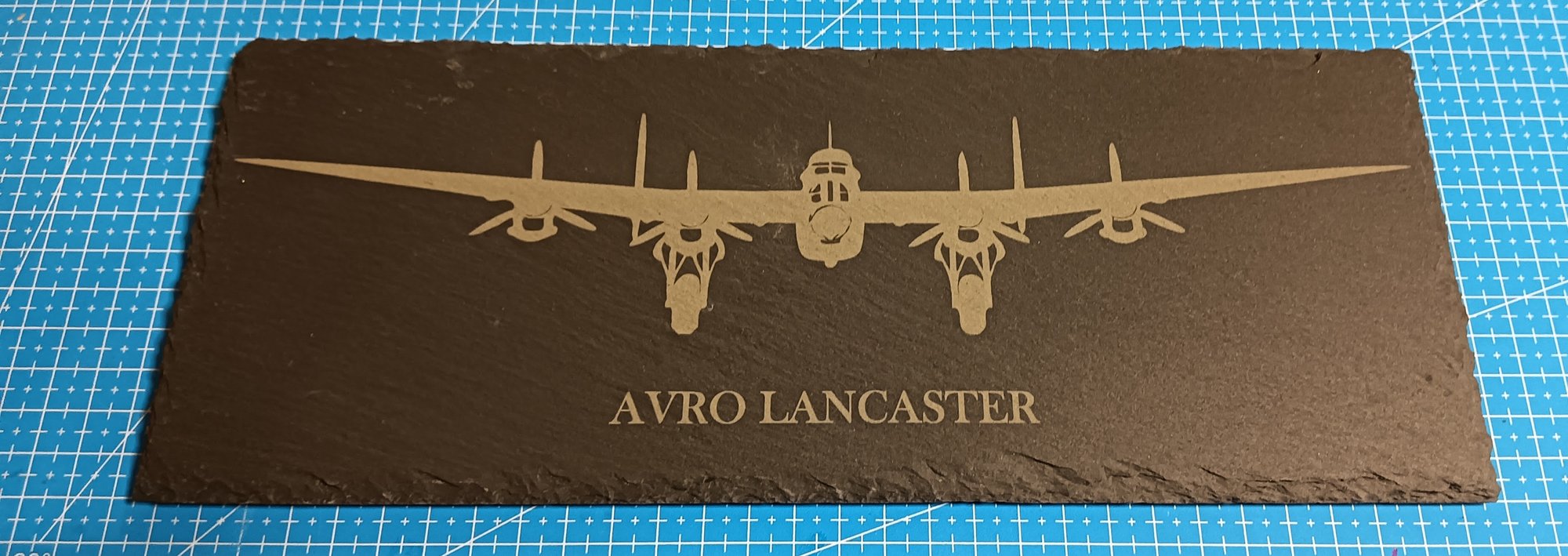

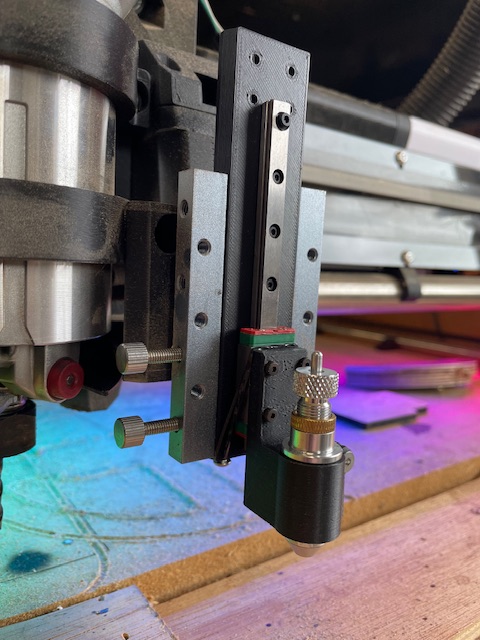

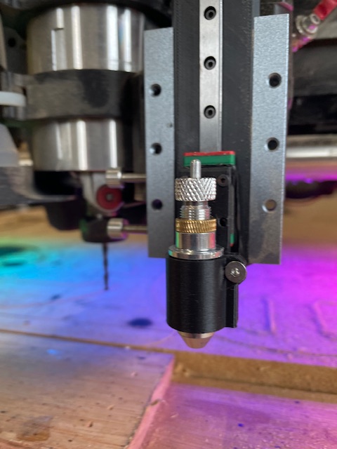

Cheers, it should allow me to clear the conservatory and run the lasers without disturbing the MrsThat's looking good.![]()

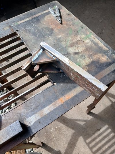

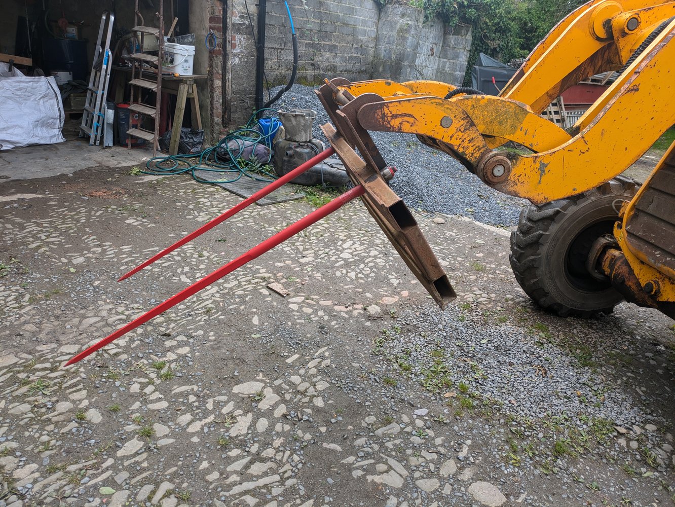

Bale spikes finished, need to turn some bushes ideally to properly locate the locking pins so for now won't bother with welding the locking brackets back on.
Should say that I wanted the spikes as close to the top as possible as putting the bales of straw into the mezzanine in the stable there isn't a lot of headroom. Where they are means there's 10mm plate front and rear, 3mm box and also the 20mm thick hooks to weld them too. Any higher and there'd be a lot of gusset etc. This way I should be able to spike the bales such that the headstock is completely hidden so I've got as much clearance as possible. Ideally I'd lose a couple of feet off the width but the width is useful when used as pallet forks.
These were bought individually but I had fun trying to find some long spikes. Ideally wanted something about the 6-8ft mark but I know why they're not common. These were 100mm the longest I could find at a sensible price.The last time i made one the bale spikes came with tapered bushes that you welded in.
