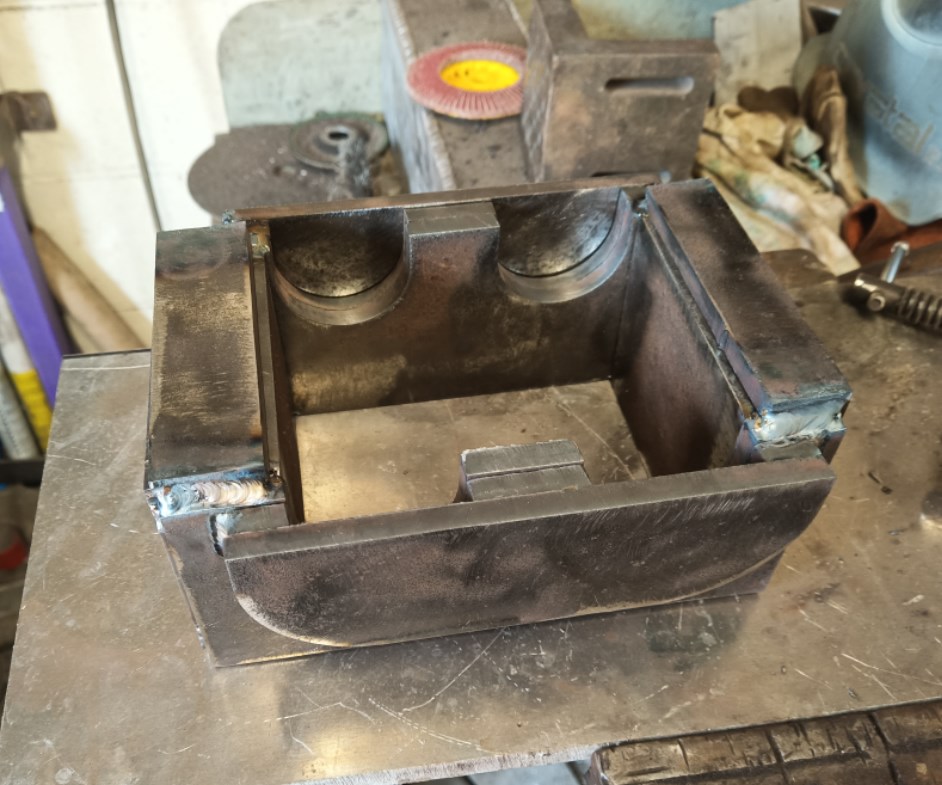

Nice one!Plasma cut some 8mm steel.
Edge quality from the Jasic still impresses me
Got it tacked up.
Fully welded and rollers made and fitted ready for a test.
Not collapsed so far with 5mm stainless and there are no marks or scrapes at all, seems to be a success, now to design and adjustable one
