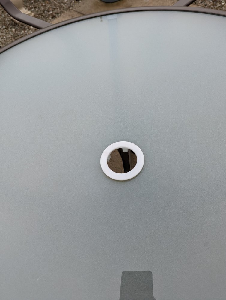

Mine got a bit of old car radiator hose taped around the umbrella pole in a similar situation . . not wasting engineering materials on that!Proved to my wife that a lathe is an essential tool after the plastic centre broke in our glass topped patio table:

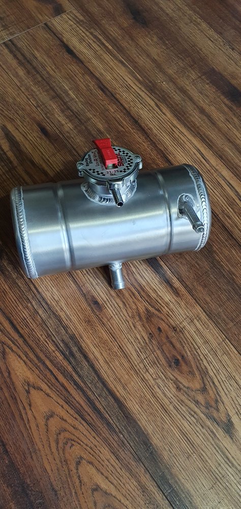

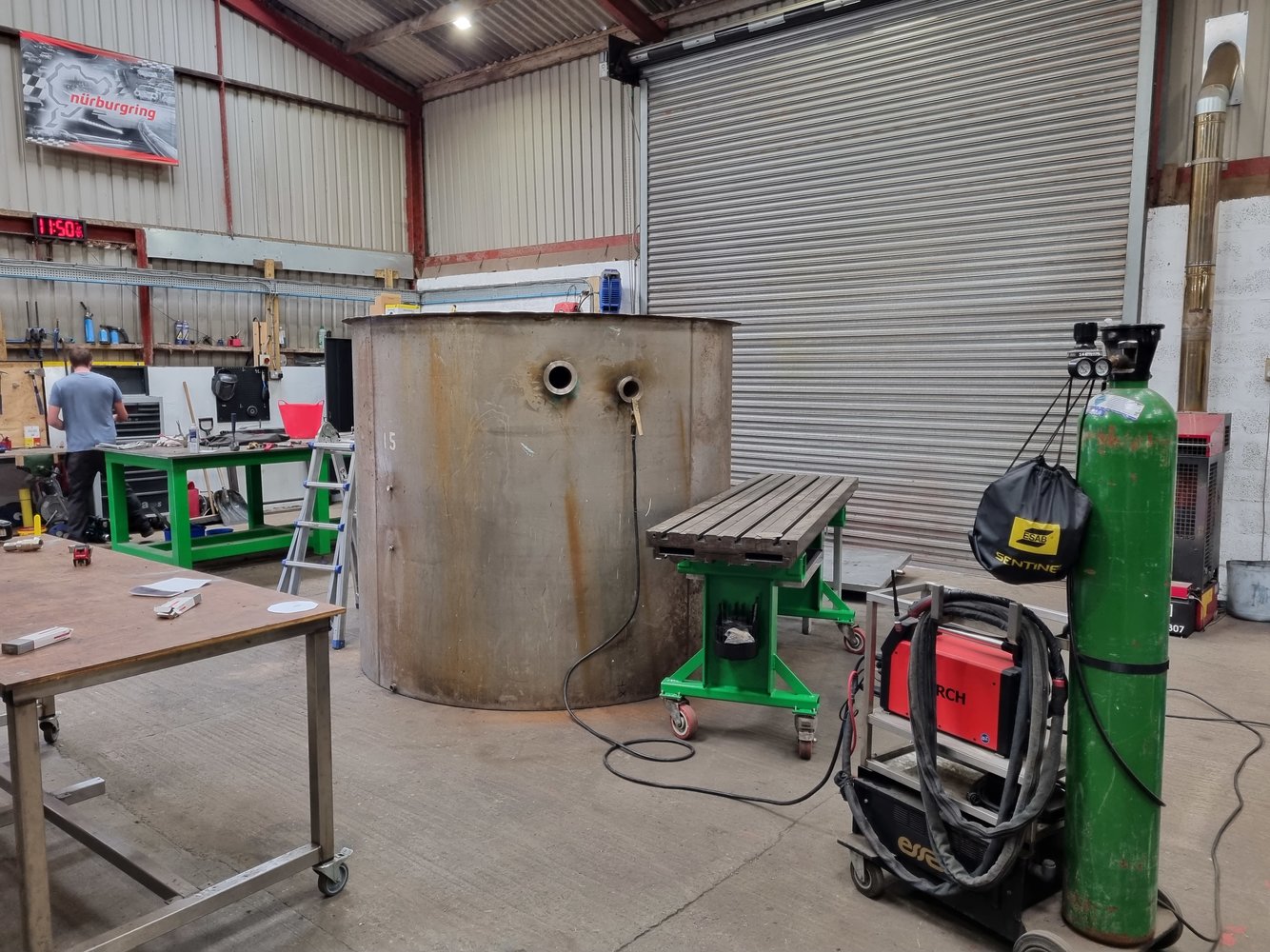

Is the welder's table made from an old milling table?Made a lid for an old stainless steel tank, out of recycled stainless steel trays and some box section. Added and removed some nozzles as well. Gonna make a great water storage tank.
Yes i believe so... Maybe a planer or grinder.Is the welder's table made from an old milling table?

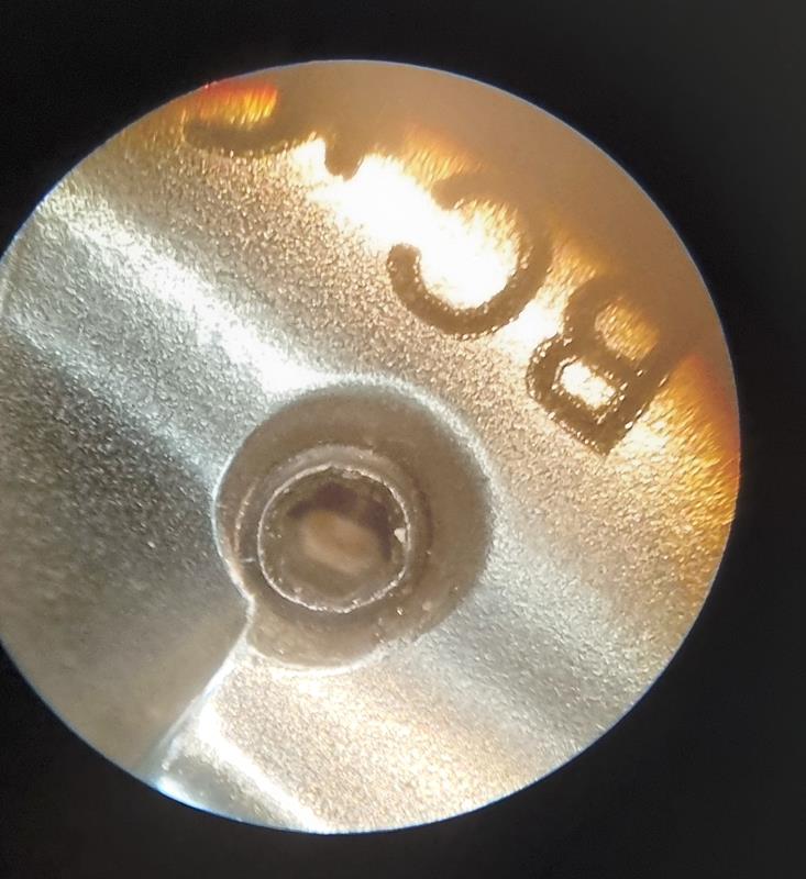

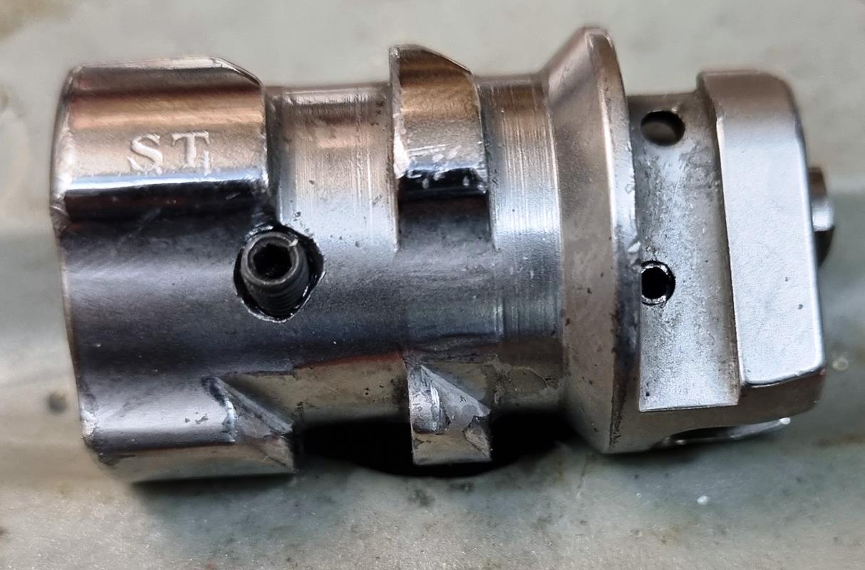

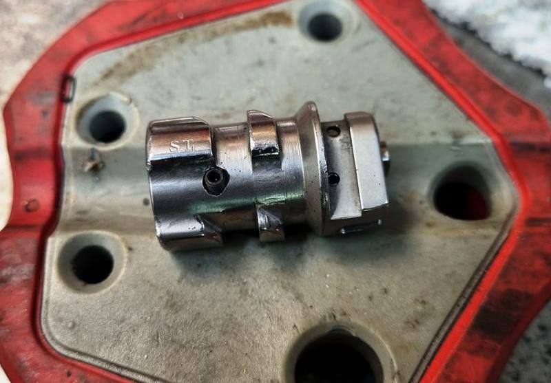

Well, bit of a long story this one, it is a bolt head from a Mauser M3, lovely guns and beautifully engineered.
This is how it should look, this is the view down my microscope and the grub screw is 3mm dia. it holds the ejector in place:

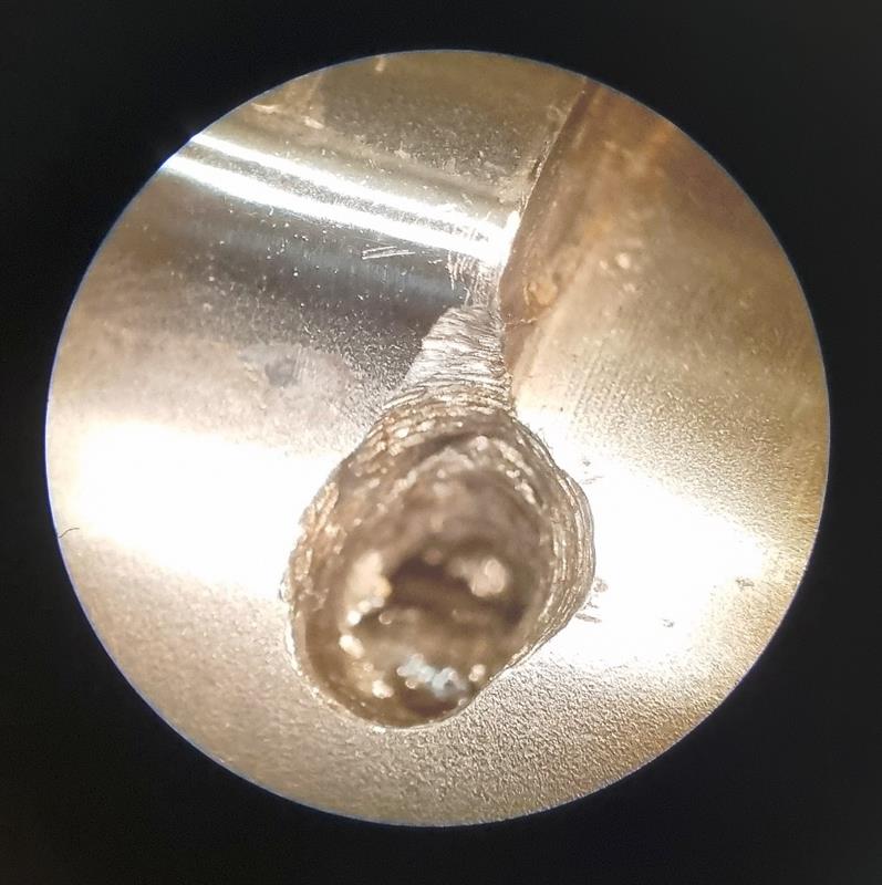

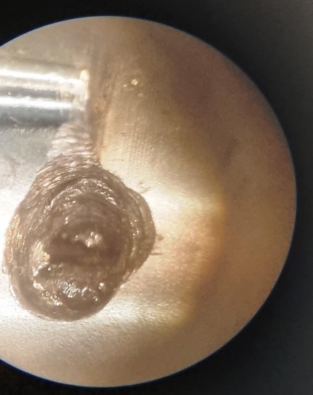

Customer had complained that it wouldn't eject properly so this is the view of the one presented "with a problem":
WTF!
This is the same bolt head with a pointer atr the edge of the hole:
It is always the same tired old Sh1t "Oh I have absolutely no idea what could be wrong I hear this every single time, I have taken to telling them: "look, I am not going to hit you, just tell me what you have done, it will save me time and you money". They still deny it.
Someone on here has (privately) asked me why I get involved, but I do like a challenge :-)
Some short while later:

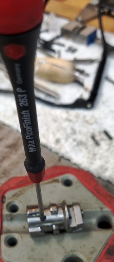

I carefully picked, hammered, battered and coaxed the ruined grub screw out and I was able to get a good quality tap to clean up the threads and insert a new grub screw:
NOW I can replace the ejector and make it work properly. How do you charge for a job like this? You cannot really but I get a great deal of satisfaction from having succeeded, I don't always succeed and that is the nature of it.

You could have justified buying a 3D printerProved to my wife that a lathe is an essential tool after the plastic centre broke in our glass topped patio table:

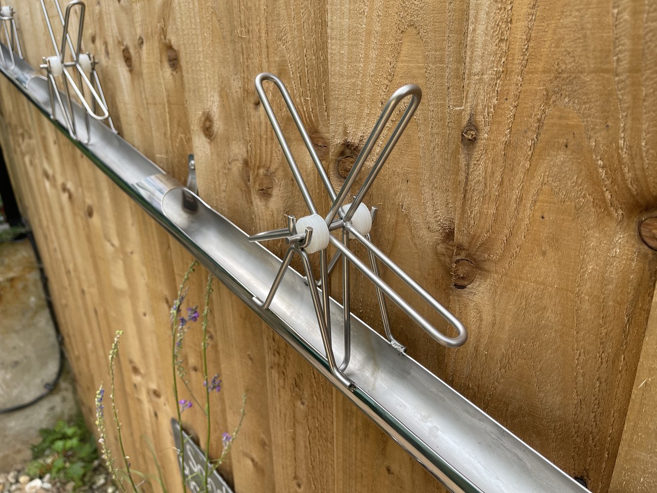

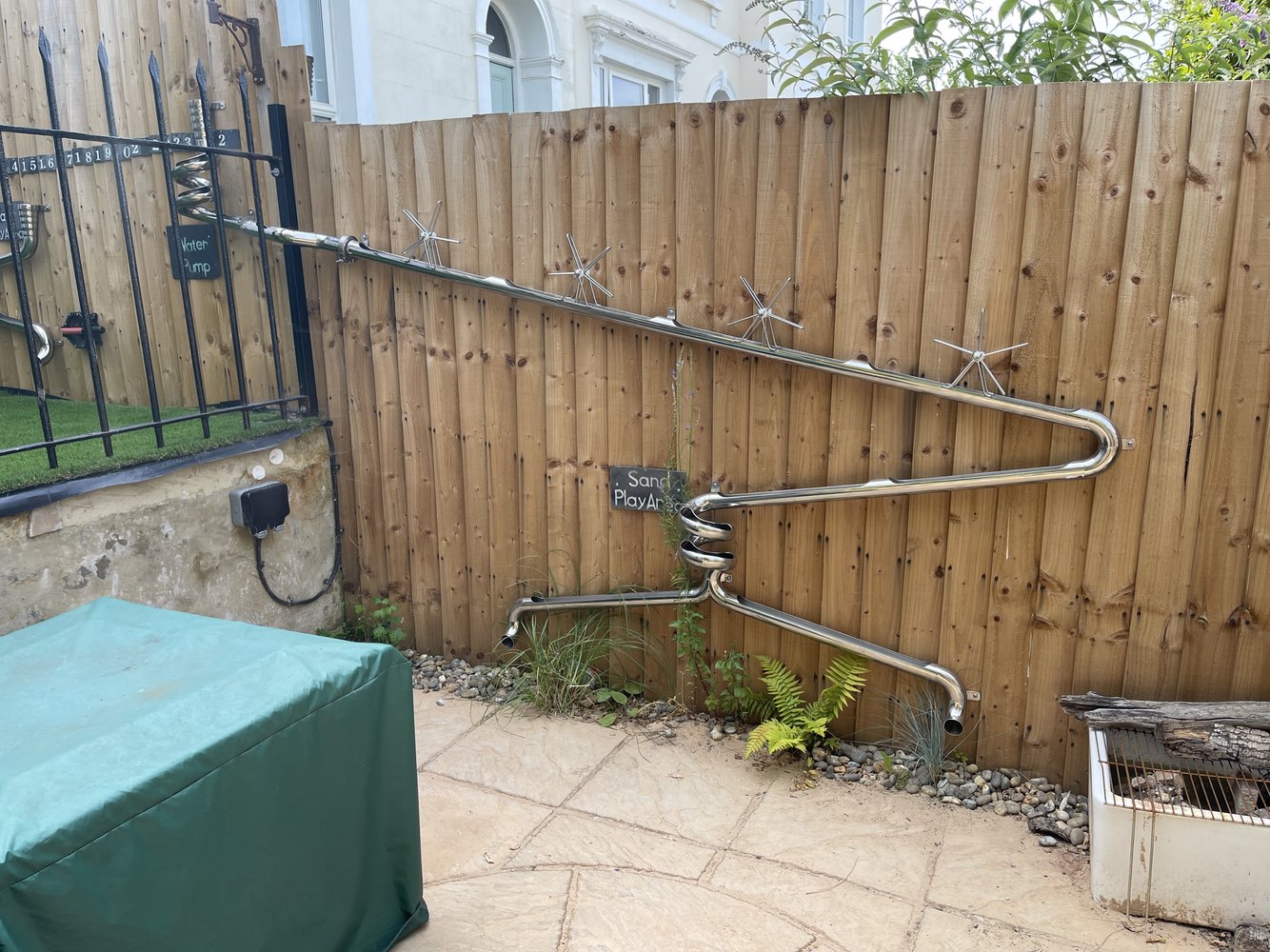

Right now show us a vid of it working you know the rulesThe grand complication is complete and installed! It only took 37 hours, 7.2M of 2” 316 tube, 26 sanitary elbows and 7M of 5mm 316 rod.
