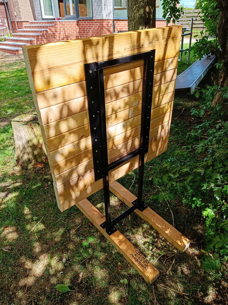

20mm bar, those links must be huge!Cut off the rusted bars and welded some new 20mm bar on to chain links for end weights. Last time I used the mig at the place I did them, I just used the stick this time as I don't have Argon mix and actually don't even have a mig torch as I just use push pull guns. I also have a few boxes of 4mm electrodes so good to use some up as I hardly ever do steel stick nowadays.

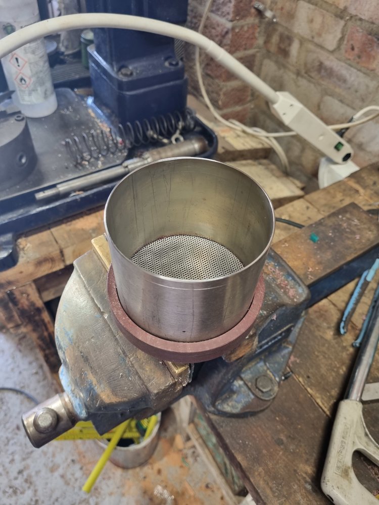

I of course had to try filtering something so had a rummage around and found a cute little side arm flask, a bung that didn't fit it and a narrow stem funnel (Exactly the type you wouldn't use for filtration). Cut a circle out of a coffee filter, filled it with cutting fluid, fired up the pump and it pulled it through in less than a second.

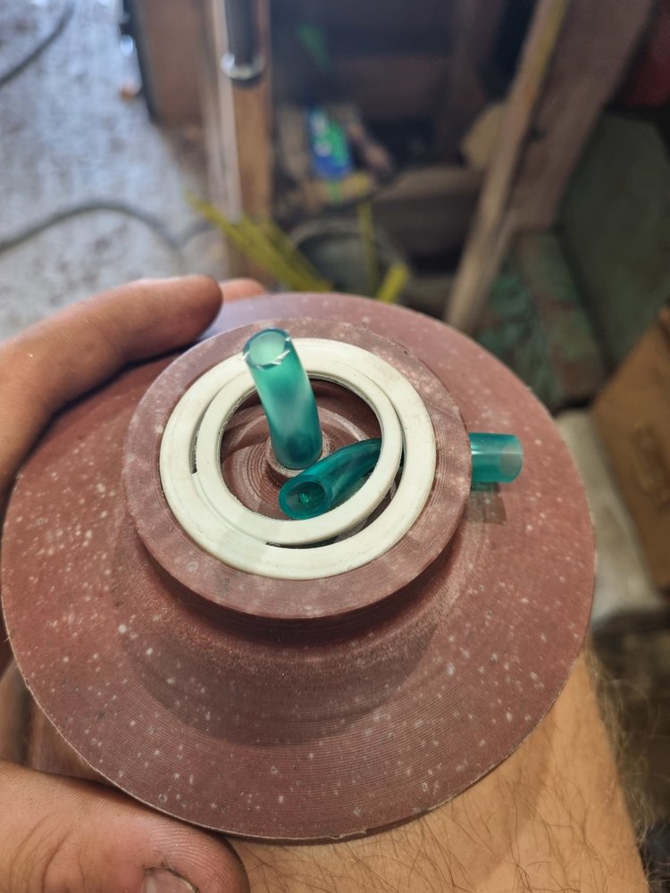

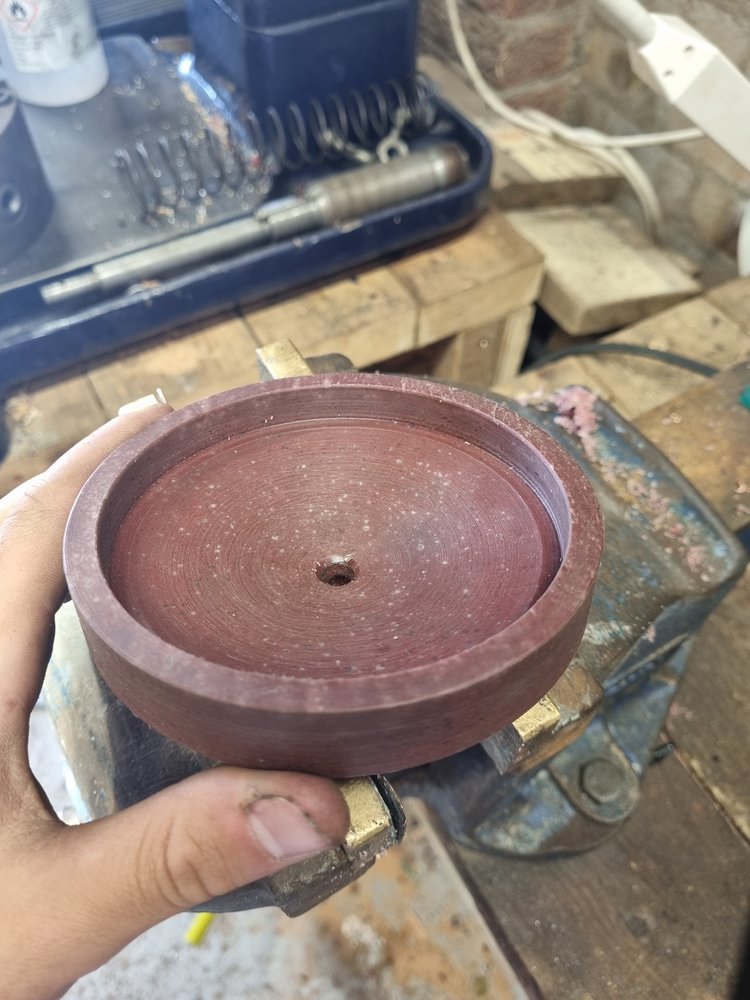

Looks like my cunning plan is gonna work, next job will be to make a big special Büchner funnel, something like this:
Stay tuned.![]()

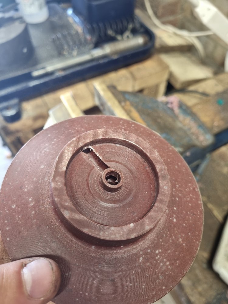

It turns out I didn't have the material thickness to get the bottle thread on the funnel but I thought it would work without it, the vacuum should pull the gasket tight.
