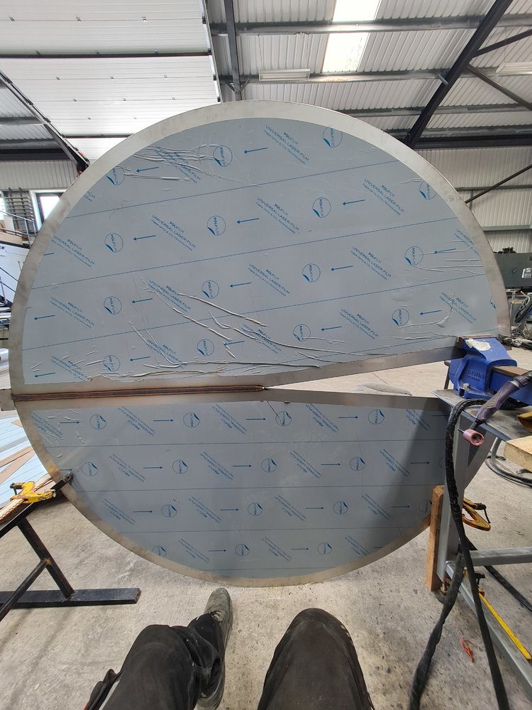

Tedious. 12 (24 semi circles) of these this week. Sheets plastic coated, marked and cut out, then joined. Ready to be formed into cones.

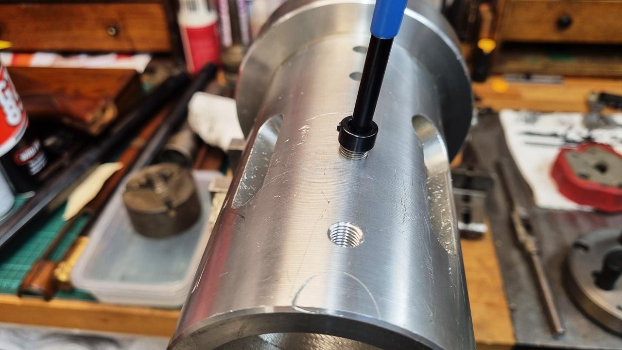

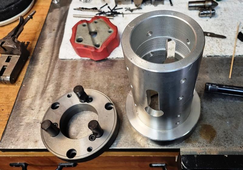

For mounting and adjusting rifle bolts - doing something accurately to the end of?Started this some years back and discovered a) it isn't quite finished and b) I need it for next week (yesterday would have been better), can you tell what it is yet?
Couple of clues:
I helicoiled it because the bolts will be constantly adjusted:
Test fit up:
I have bought some long Stainless steel screws as I will be boring the ends out and adding some brass buttons on the ends. I went to see my favourite grinding company yesterday but they don't have a fixture to hold the Bolt as you cannot remove the handle, so I will be doing it myself using my own lash up.

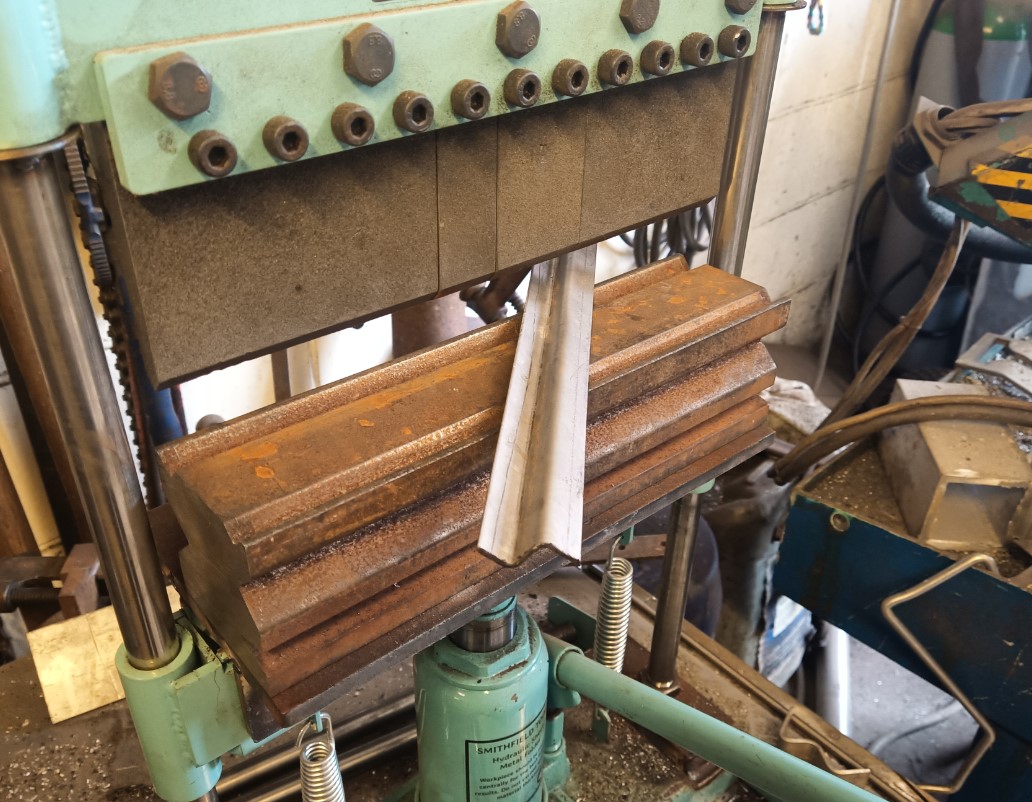

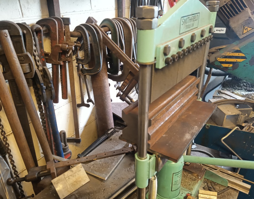

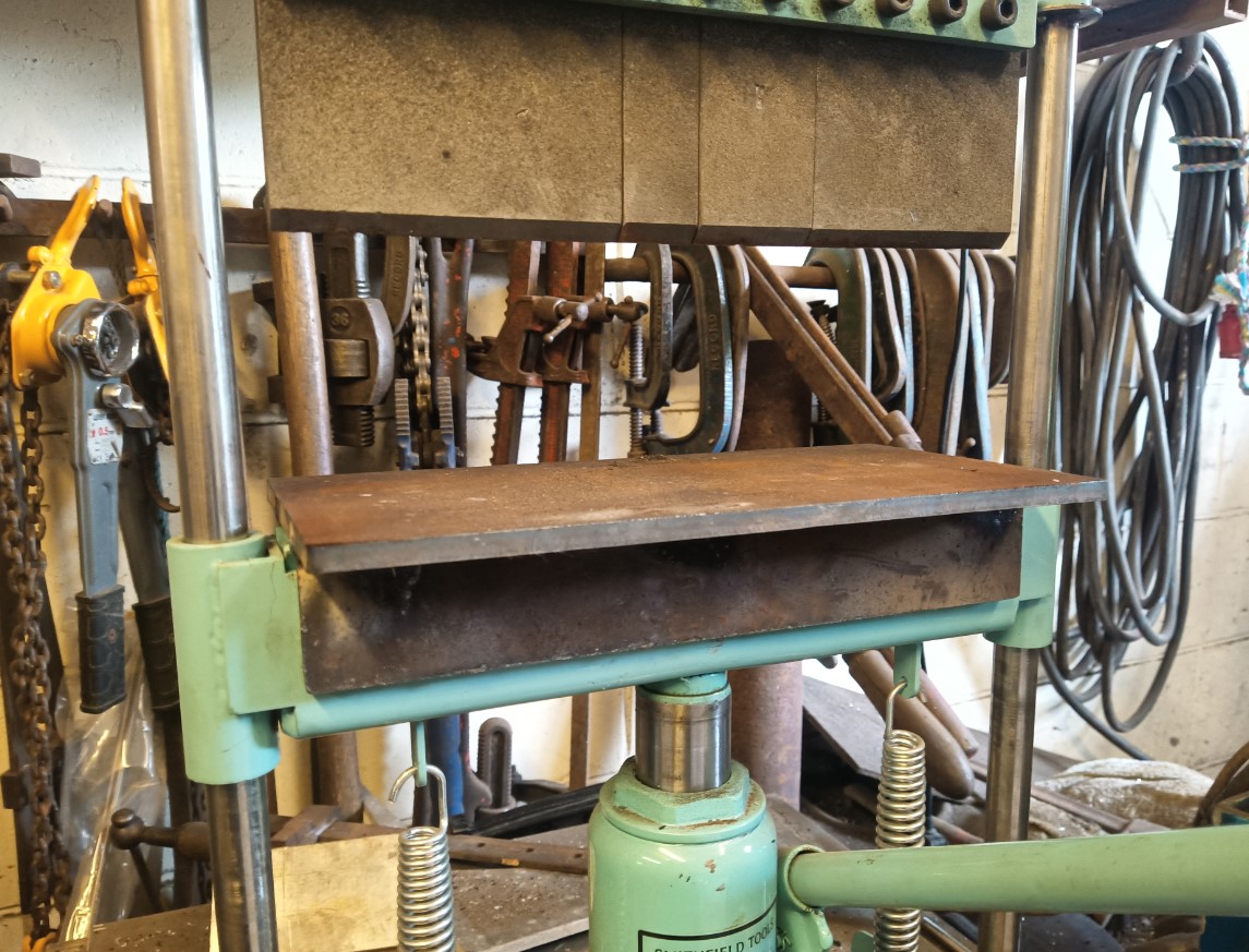

NiceThreaded some stainless M20 x 1.5 each end and welded on a couple of washers to make extensions slides for the wee brake, pic shows new with one of the originals.
Once fitted I cut some 10mm steel to make up a table that sits over the brake.
That allows me to slide the tooling to any of the vee's
View attachment 355467View attachment 355468
Tested it out and works great.
