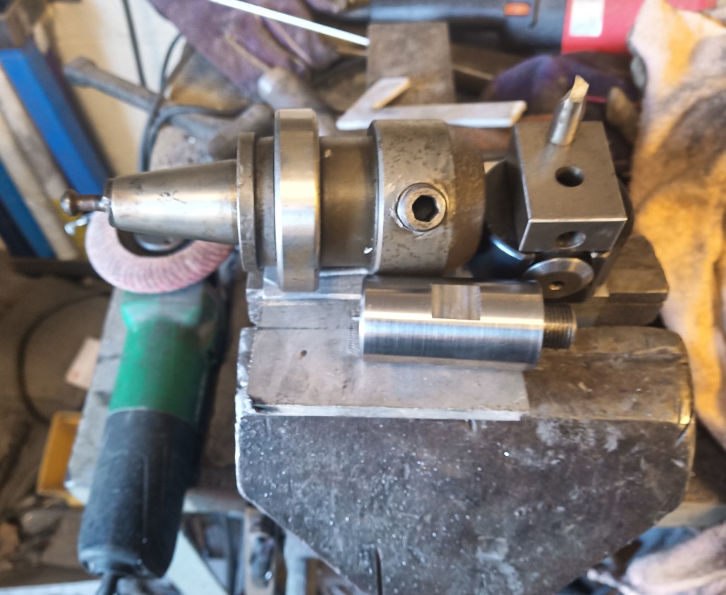

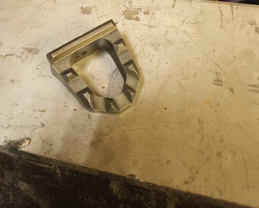

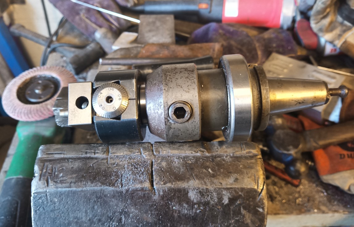

I have only had the Hartford Super Spacer for 25 years or so, bought it at a roup. The indexing plunger is supposed to be spring loaded but it was missing the plug and spring and also the lever itself could pull out due to the dog point being broken off the screw. It works fine and has done so for all those years but I have always been promising myself I would sort it and today was the day
Took out the screw, was going to make a new one.
Instead I took the lazy option, I bored out the end, threaded m5 and put a set screw in then turned the threads off.

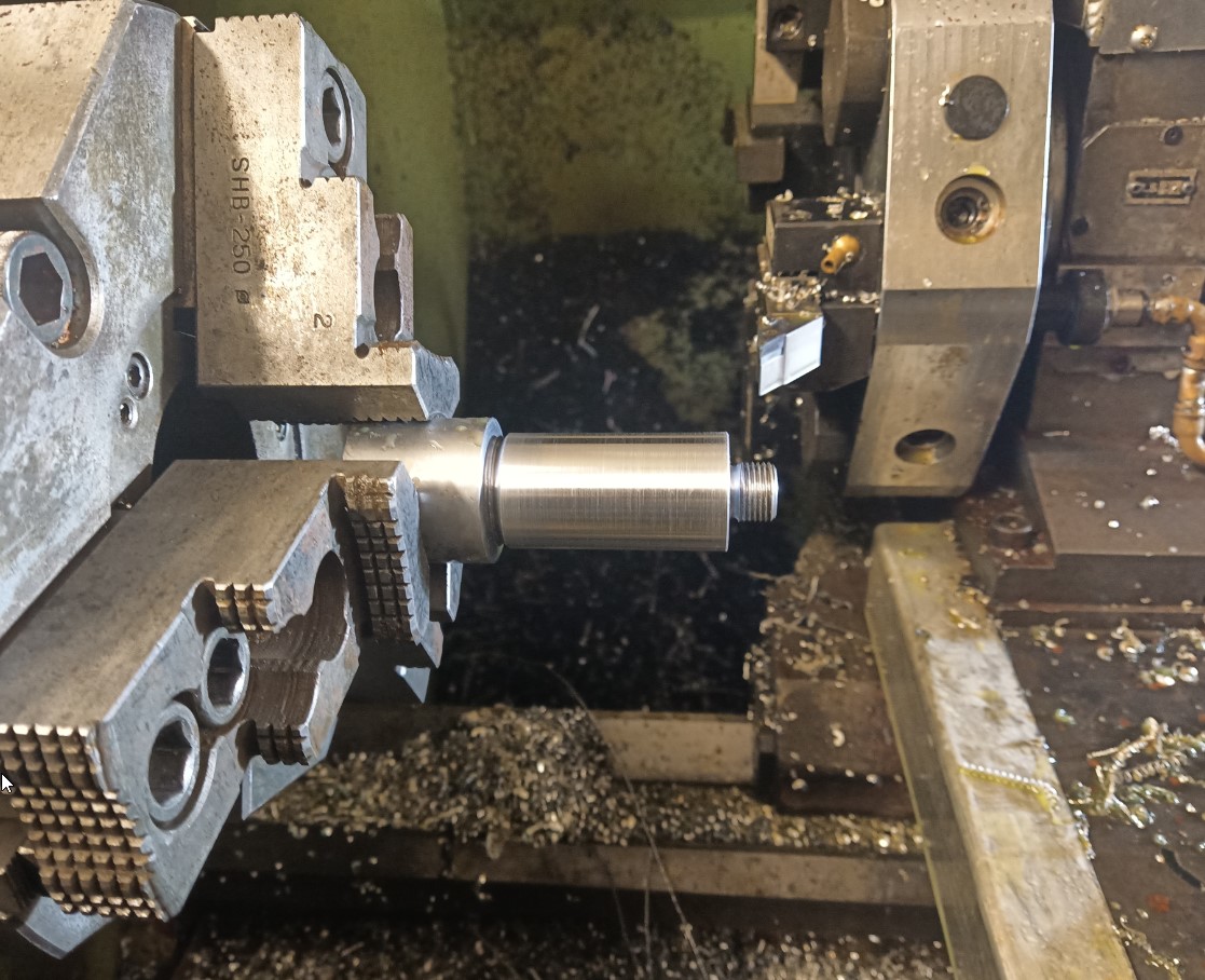

Next up was the plunger spring and cap. Found a spring and put a bit of 8mm dia stainless inside it to act as a guide then turned a thread and bored out a bit of 1" dia steel, it is a UNEF thread, 1"-20TPI.
All back together and working great, shame it took me 1/4 of a century to get round to it

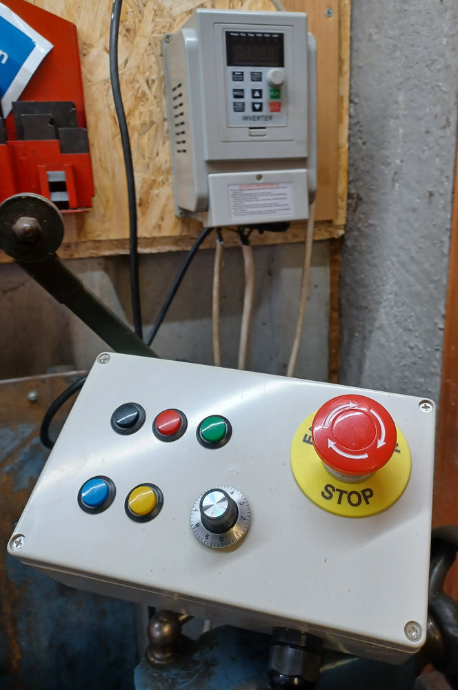

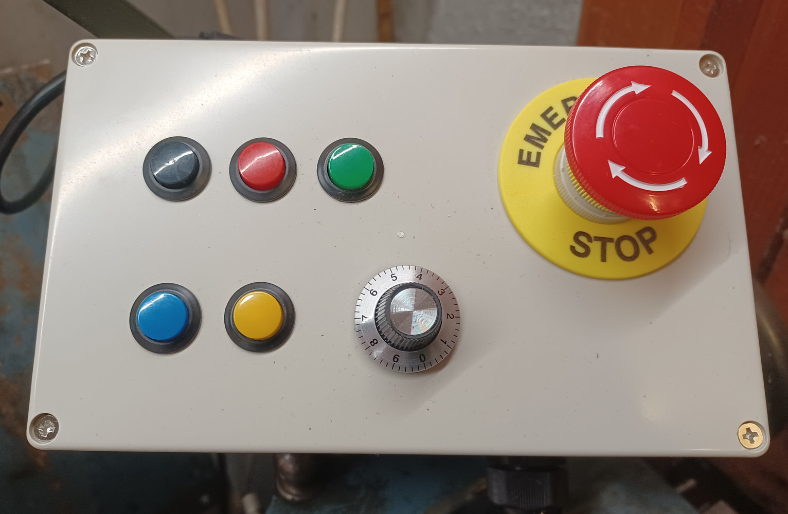

The top three are reverse/stop/forward and the other two are jog reverse/forward in that order
The unit is listed as 4000w...
